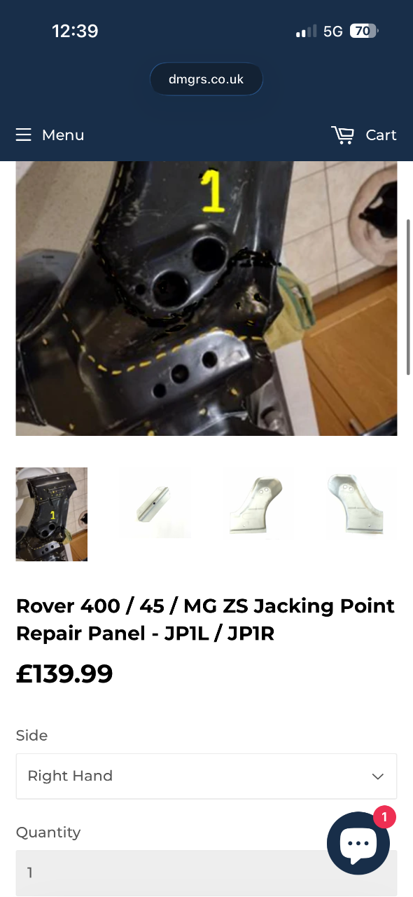

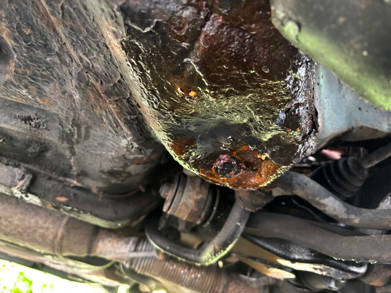

Anyhow. MOT day today for it. Failed, obviously. Thought it might. Being sat in storage really didn’t do the brakes any good, handbrake was jammed on when I went to collect it and we had to free it off, and the front discs are obviously warped. Needs new discs, pads and the OSR caliper freeing off slightly. Garage wanted £373, but it’s January and I don’t have that so for now it’ll go in the garage and I’ll sort it when it’s a bit warmer. Honestly I’m mostly grateful there’s not even a mention of rot on the fail sheet.

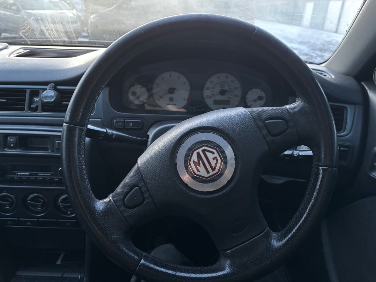

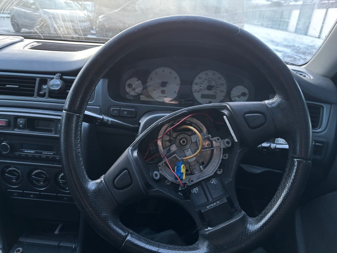

Haven’t really left the house for a bit. So I had to do… Something today. I’ve been fed up of the Rover 45 steering wheel on the ZS since the day I got it. It’s not the right colour and it looks silly. That was changing today:

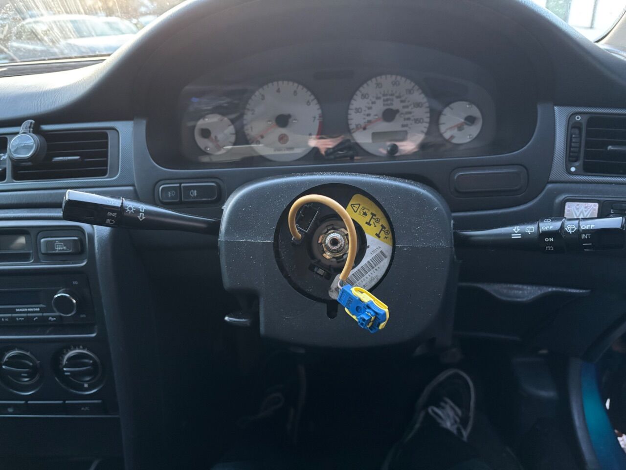

Even with the battery disconnected, I don’t like dealing with airbags. I also dropped it. Whoops.
Old one ready to come off
Needed some convincing with a rubber mallet and some wiggling but it eventually popped off the splines and left me with this:
The above freaked me out at first because it moved independent of the steering rack. I was worried I was meant to align it. Turns out it’ll do that itself as I discovered when I refitted the new wheel:

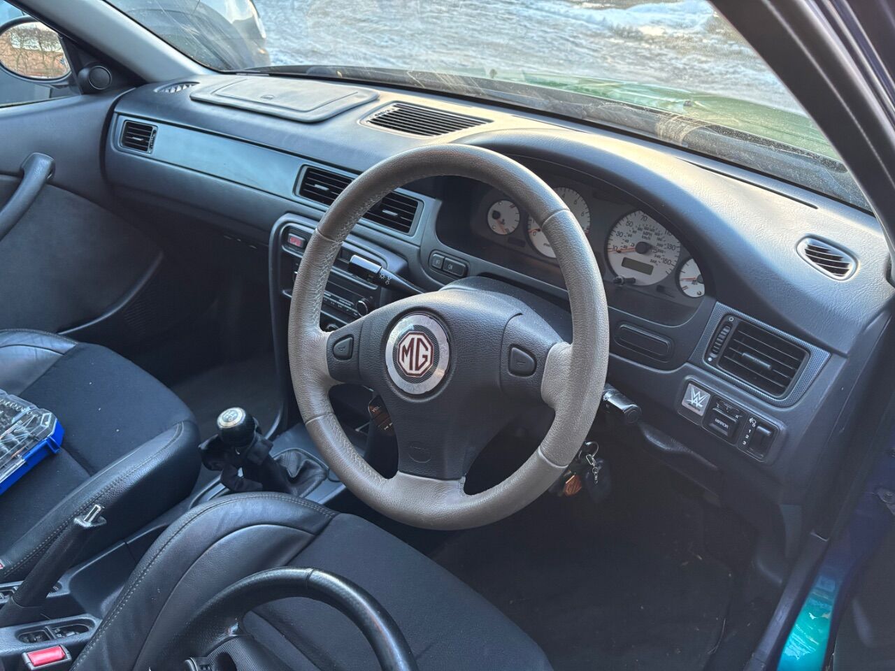

All back in, a couple of splines out but it’s something I’ll sort in a few days when it’s thawed out and I can drive it up and down the garage block to check if it’s straight without having to slide on the ice.
The smallest things seem to make the biggest difference don’t they?

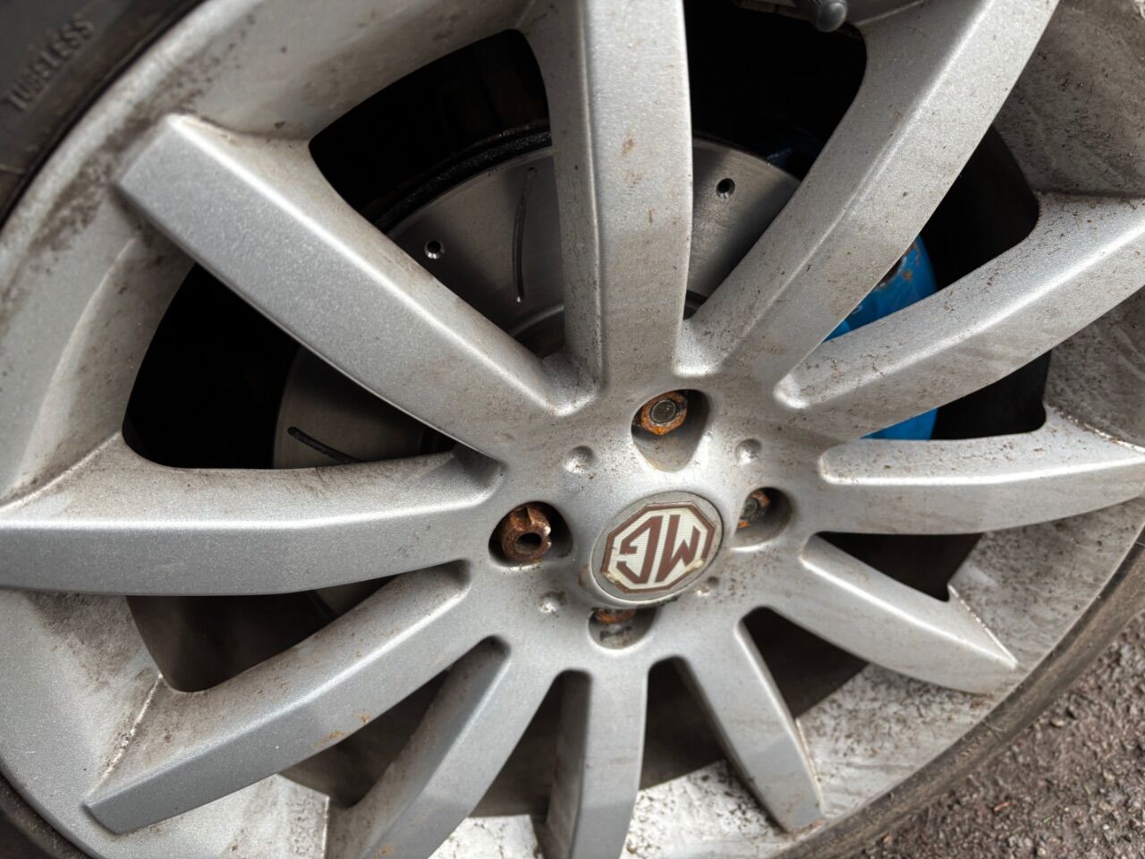

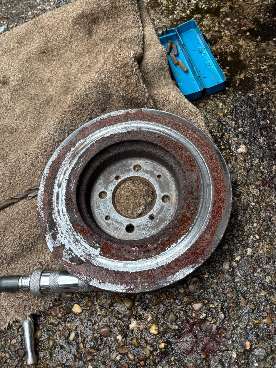

Went to sort brakes on MG. They don’t actually look too awful here (I mean they’re still well overdue replacement but they don’t look as bad as they actually are):
Getting these off ended up with me breaking two slider pins. We had to go to GSF to get new ones, who oddly, have them on the shelf. For any ZS180 owners, rear calipers are the same as a Honda S2000. Only thing is the S2000 and the ZS have entirely different part numbers for certain things (not the sliders mind). Find an S2000 reg plate for use on the parts sites.
Anyway. Pads out. And then they immediately fell apart:
Despite them looking thin there there’s actually about 3mm left on the old pads. Not entirely sure what’s happened here.
Here’s what I mean about the discs looking far better than they are…
Anyway loss of light stopped play so the aim is to do the other 3 pads and discs either this weekend or next week. On the upside though while we had it apart I discovered the car was polybushed:

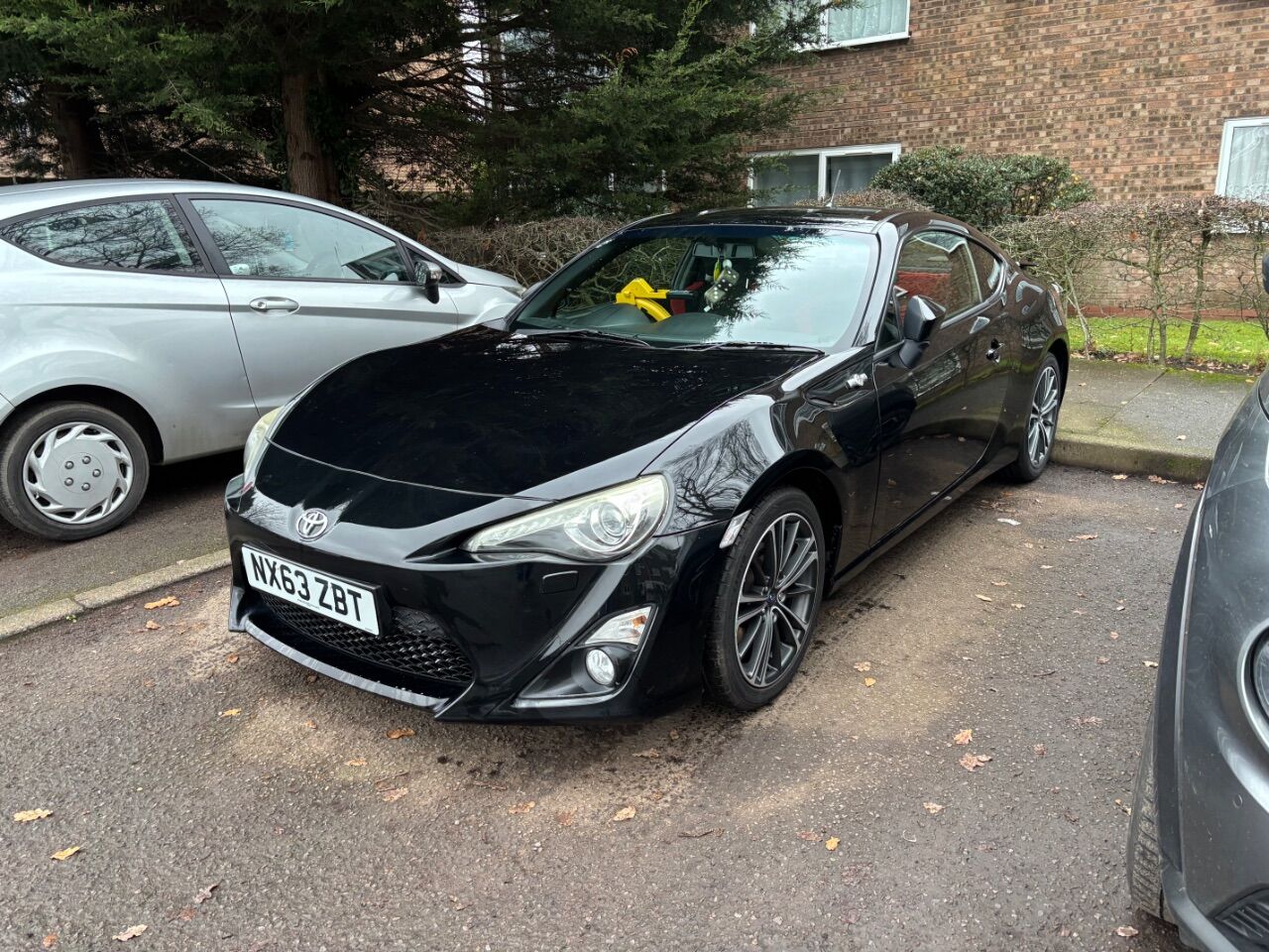

TOYOTA NEWS:

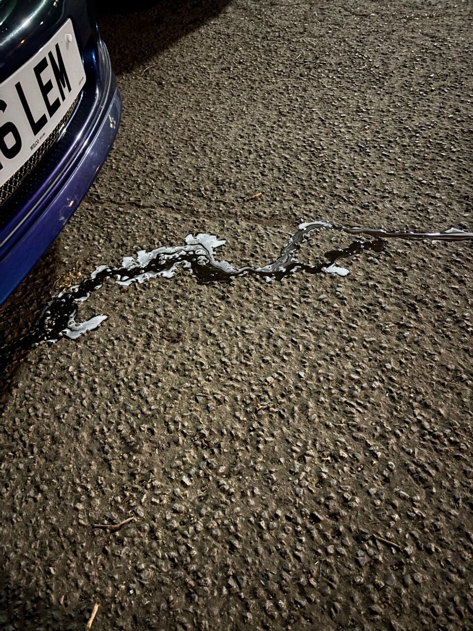

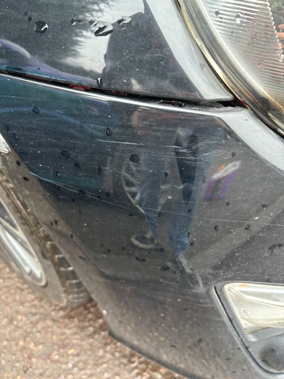

Some wanker did this. Honestly, I’m more annoyed that they’ve broken the bumper mount. I hope their DPF fails. Not the end of the world as my valeter has said he’ll give it a once over while he’s sorting the ZS.

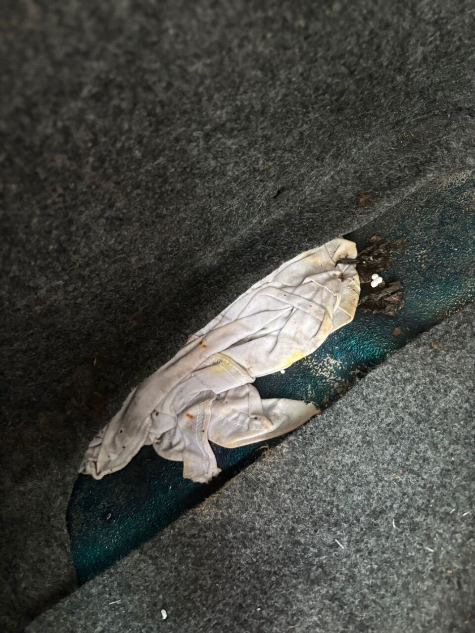

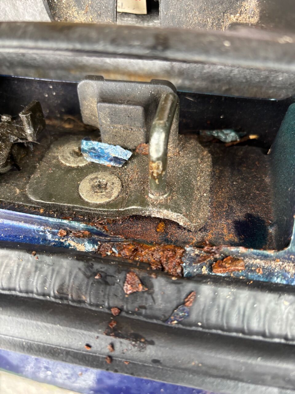

I’ve had a leaking boot since I got the car. Hence why there’s an old shirt shoved down the side of the boot:
Not perfect though, as the box for my tyre inflator can attest:
So, a NOS boot seal was ordered:
Upon removing the old one, it turns out the only thing holding the latch in was the old seal:
Fitted the new seal but I think I’ve disturbed the latch and now the boot won’t open. I’m not messing about with that in case it needs a patch or something, so either the garage can have that job or I’ll deal with not having a boot until it’s warmer and not raining so I can be arsed to be outside with the car.
Annoying regardless. But shit happens I suppose.
  • Sad 4
  • Imhotep changed the title to Imhotep's ever changing fleet - MG ZS180, Toyota GT86 - MG boot seal and big rust. Now temporarily a 4 door!
Update:
Boot is open again, and now opens and closes every time. However I will be getting that repaired, it’s a nasty bit of rot and the metal there is so weak you can pull chunks of it out.

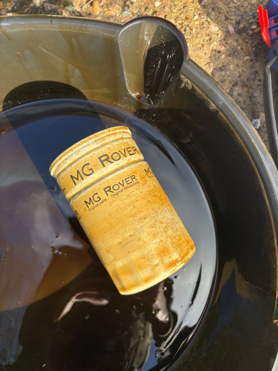

Servicing day today. Noticed in the handwritten history it hadn’t been done for a bit so I did the lot, plugs, oil, filters etc. helped as always by @Heidel_Kakao and by helped I mean he did the important stuff and I got in the way.
Anyway, I went for a service kit from DMGRS so I could get some OE stuff for it. Plus the service kit was £102 posted, I couldn’t find plugs for less than £70 (what on earth is going on with the price of plugs at the minute?!)
Anyway, oil drained. Safe to say it’s been a while:
OE MG-R filter! I don’t think they’ve been available for a while now.

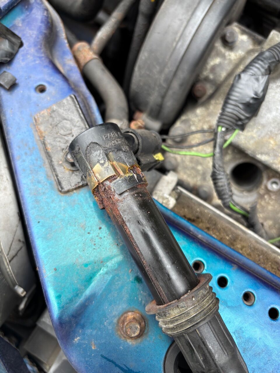

We removed the old coils and they immediately fell apart, so I had to pinch 3 coils from HK’s ZT-T until I can get new ones to swap them back over:
Plugs didn’t look too bad, just very old, and I discovered the front bank has a leaky rocker cover. I’ll look into that.

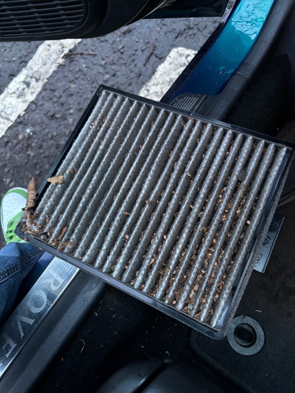

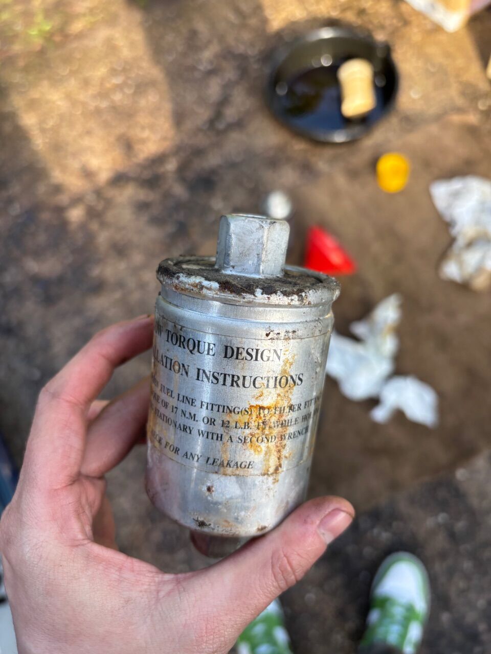

Fuel filter and pollen filter had both very clearly been neglected:
All that and the air filter has been sorted. I did however find an area of concern while under the car in the form of the jacking point. Thankfully DMGRS sell what I need off the shelf, just needs a welder:
