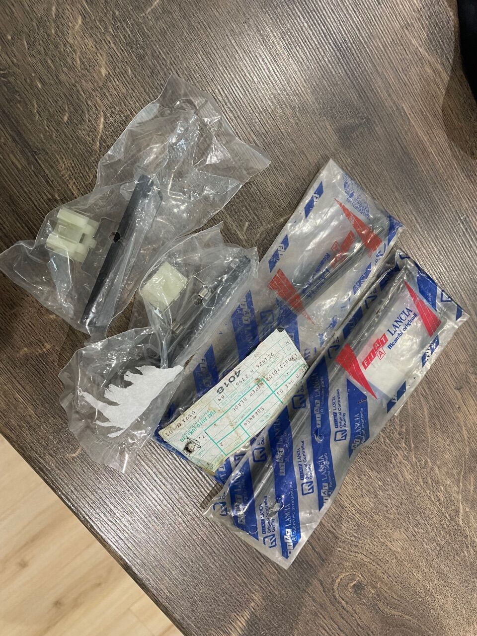

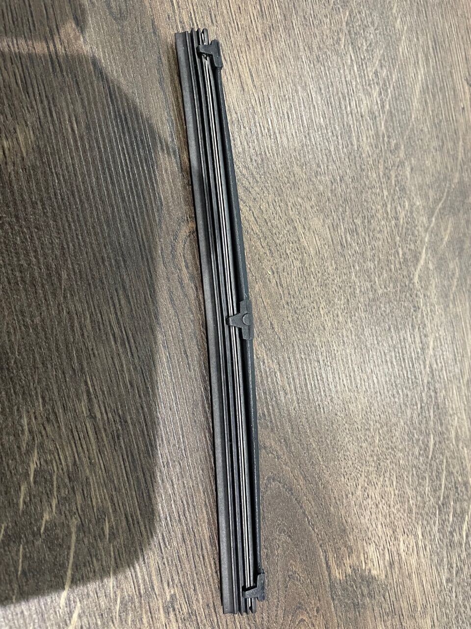

Simon_punto Posted March 20 Author Posted March 20 More new stuff arrived, due to age and fragile plastics. the number plate lamps snapped, when I was changing a bulb and cleaning them out, so ordered 2 new ones. also got a tip off, of new genuine old stock headlamp wiper blades. I couldn’t hit buy it now quick enough. I’d changed the blades over with refills from Halfords as the originals were split, but it didn’t work too well. At least this has the proper genuine blades now that look correct now. Lanciaman, RayMK, rainagain and 7 others 10

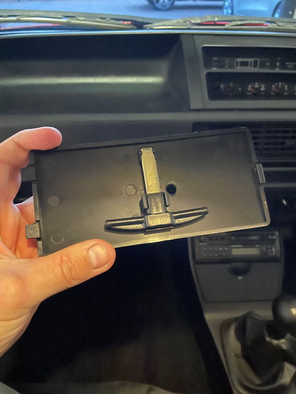

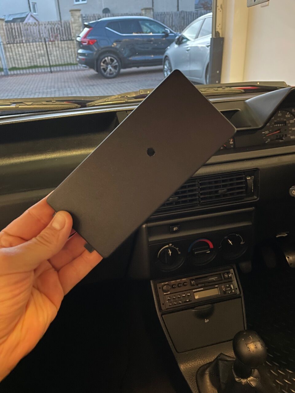

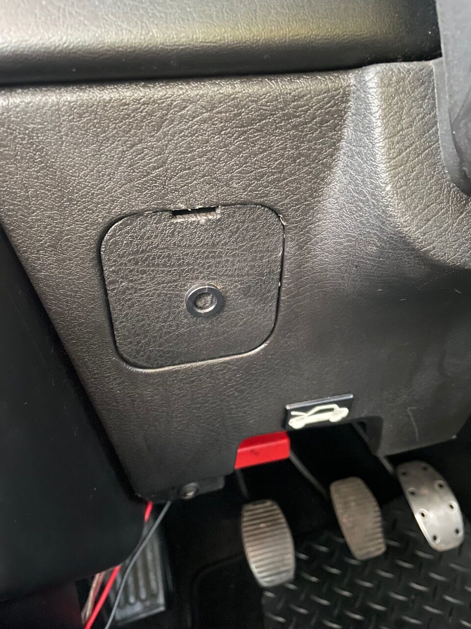

Simon_punto Posted March 26 Author Posted March 26 So, I’m looking for a bit of advice please. I'm trying to go through the car and replace trim parts that are either missing/ have been vandalised in the past. There is a certain part in particular I cannot find as it comes as a whole unit- it’s the cover that goes over the electric sunroof emergency windy thingy- see photos below. It has no part number and I have checked that to replace it I have to buy the whole assembly with lights/ buttons etc. what’s even worse that there is absolutely no need for a hole to be drilled into it, and it’s not even centred 😫 anyway, I plan on filling the hole, sanding it down and either wrapping/ painting the panel to match the rest. Can anyone recommend any wrap/ paint that would match and give a textured finish, to look like it does now? also, more (fucking expensive) parts coming from Italy, and Netherlands. I have found some unicorn parts to recommission the headlamp wash wipe- I hate things not working and everything must be just so. It’s the washer jets, piping etc that clips onto the headlamp wiper arms to squirt fluid onto the lights. The wipers work but there is no piping there just now. It seems I’m going down the same slippery slope as I did within the Punto- talking of which I think I’m going to tax it and MOT it start of April and use it a wee bit, as I haven’t touched it since November. And the cee’d daily continues to impress, cheap to run, cheap to tax and amazing on fuel. That offsets my two polluting old Fiat’s, even though the inefficient 2.0 petrol Tipo that costs £30 a month to tax can enter Dundee city centre, but my 1.6 diesel, £35 a year cee’d can’t. makes perfect fucking sense 🤔 IronStar and 500tops 2
cobblers Posted March 26 Posted March 26 On 26/03/2025 at 12:22, Simon_punto said: anyway, I plan on filling the hole, sanding it down and either wrapping/ painting the panel to match the rest. Can anyone recommend any wrap/ paint that would match and give a textured finish, to look like it does now? Expand "Monofil Vario+ Texture Black" is a paint designed to mimic the texture of plastics. Its a tenner a can but it goes a long way and comes with a few nozzles to set the texture. We use dozens of cans of it a week at work, it's good stuff. You can get it on amazon Have a practice on some scrap to find a way to mimic the texture of your dash first - cort1977 1
Simon_punto Posted March 26 Author Posted March 26 On 26/03/2025 at 12:30, cobblers said: "Monofil Vario+ Texture Black" is a paint designed to mimic the texture of plastics. Its a tenner a can but it goes a long way and comes with a few nozzles to set the texture. We use dozens of cans of it a week at work, it's good stuff. You can get it on amazon Have a practice on some scrap to find a way to mimic the texture of your dash first - Expand Thanks so much- I’ll go check it out

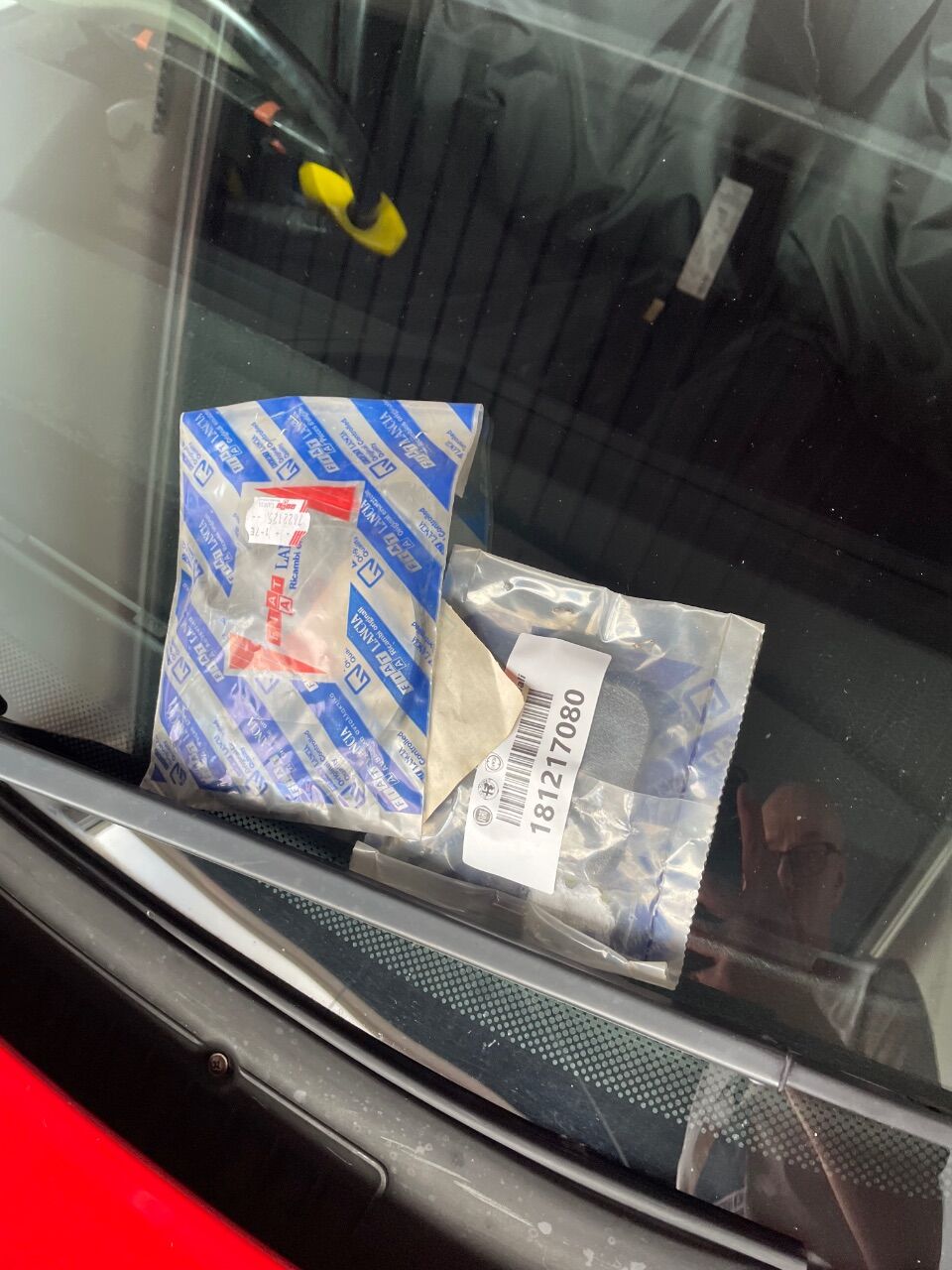

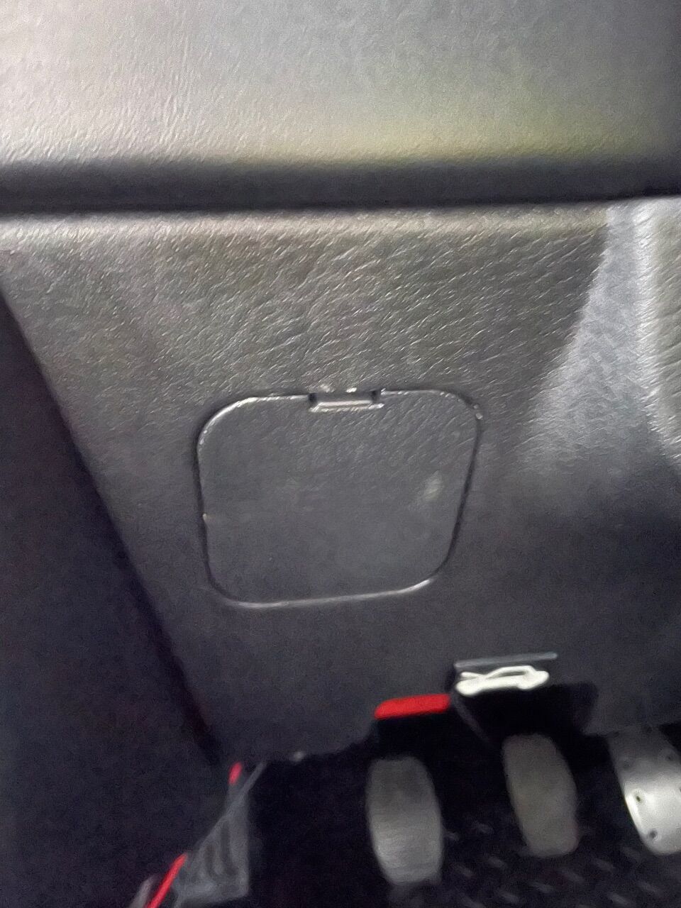

Simon_punto Posted March 30 Author Posted March 30 One of the jets for the headlamp washers arrived so that was fitted today, using the correct clips, routed properly and plumbed in. No ideas if it works yet as the other one isn’t here yet but at least it looks right. also a plug for the dash arrived as mind had another unexplained hole in it. Someone likes making holes in this car in the past. next update should be a video of the washers working fingers crossed Burnside, 500tops, Wibble and 6 others 9

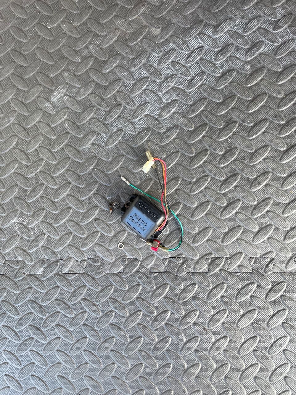

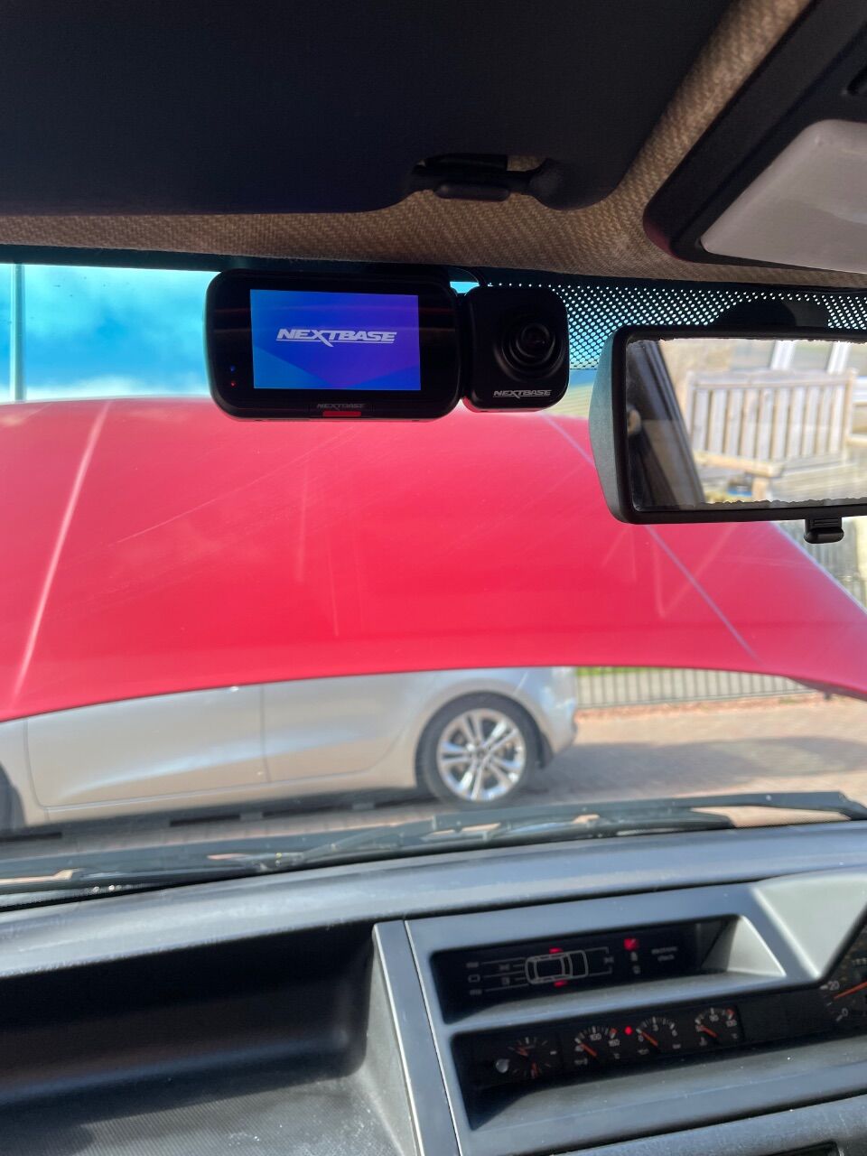

Simon_punto Posted Saturday at 12:42 Author Posted Saturday at 12:42 I have spent a wee while on the car today. Fitted the other washer jet, just waiting on a t piece arriving from Fiat, and fitted a dash cam hardwire kit. i have a nextbase camera in the ceed, and one in the xc40 which both have a snap on/ off quick release thing so i had a spare mount and hardwire kit that i put in the Tipo today. It was straightforward enough and will just switch the camera between cars as I can’t drive 2 cars at once. wiring is a disaster in the car, pulled out unused toggle switches and bits of broken Clifford alarm. Dare not touch anything else in case I immobilise the car 🤦♂️ also need to find that bloody leak Wibble, Matty, RayMK and 1 other 4

IronStar Posted Monday at 21:40 Posted Monday at 21:40 On 05/04/2025 at 12:42, Simon_punto said: wiring is a disaster in the car, pulled out unused toggle switches and bits of broken Clifford alarm. Dare not touch anything else in case I immobilise the car 🤦♂️ Expand On 30/03/2025 at 15:43, Simon_punto said: also a plug for the dash arrived as mind had another unexplained hole in it. Someone likes making holes in this car in the past. Expand These are probably correlated. Fake killswitches, holes for the alarm LED blinkers, maybe a long-gone handsfree kit as well.
