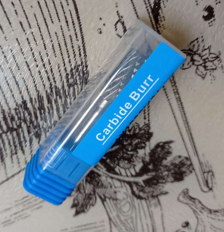

tooSavvy Posted February 7 Author Posted February 7 RightyHo.... All ducks now aligned 👍 When Kev attempted to fit my *ElCheappo fleebay discs we discovered a significant difference/problem with the bell I.D. being 137mm but Astra is a 139mm hub. Simple plan = get a burr, mount in pillar drill, lash up MDF form/jig to hold disc... Introduce inner bell to burr & rotate until whole inner circumference has been shaved 1mm deep. Having a brand new Astra wheel bearing means 100% 'pre-fit' testing of compatibility. This job would have been SO much easier with my having access to a decent lathe... Will post piccies 🔧☕ 🚙💨 loserone and Jim Bell 2

tooSavvy Posted February 11 Author Posted February 11 I have had, in my stash, the 'lip spoiler' for AVAS' tailgate.... The task of fitting it is straightforward.. BUT.. complex = fitting two differing curved surfaces together with a suitably shaped 'filler blade' 🤔 I have fretted muchly, doing it right & not looking like a lashhupp 😕 The indirect benefit of acquiring my burr/cutter [for brake discs] is I'm able to consider profiling two pieces of nylon plate stock/through drilled to suit the task 🎉 Of course..... I have been thinking of profile matching but shrank from hand filing/surforming/coarse grit paper >> a carbide cutter will allow me to simply cut to a stick-on mask/light fettling to finish 😁 🚙💨 privatewire and Dave_Q 2

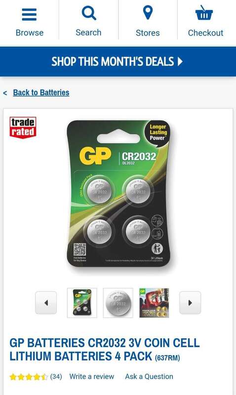

tooSavvy Posted February 12 Author Posted February 12 Car wouldn't 'plipp' yesterday..... Took penny battery out of the key [non folding] and warmed it in my hands.... Working 🤔 £5... Screwfix. GuddGudd 😁 🚙💨 auntiemaryscanary and privatewire 2
