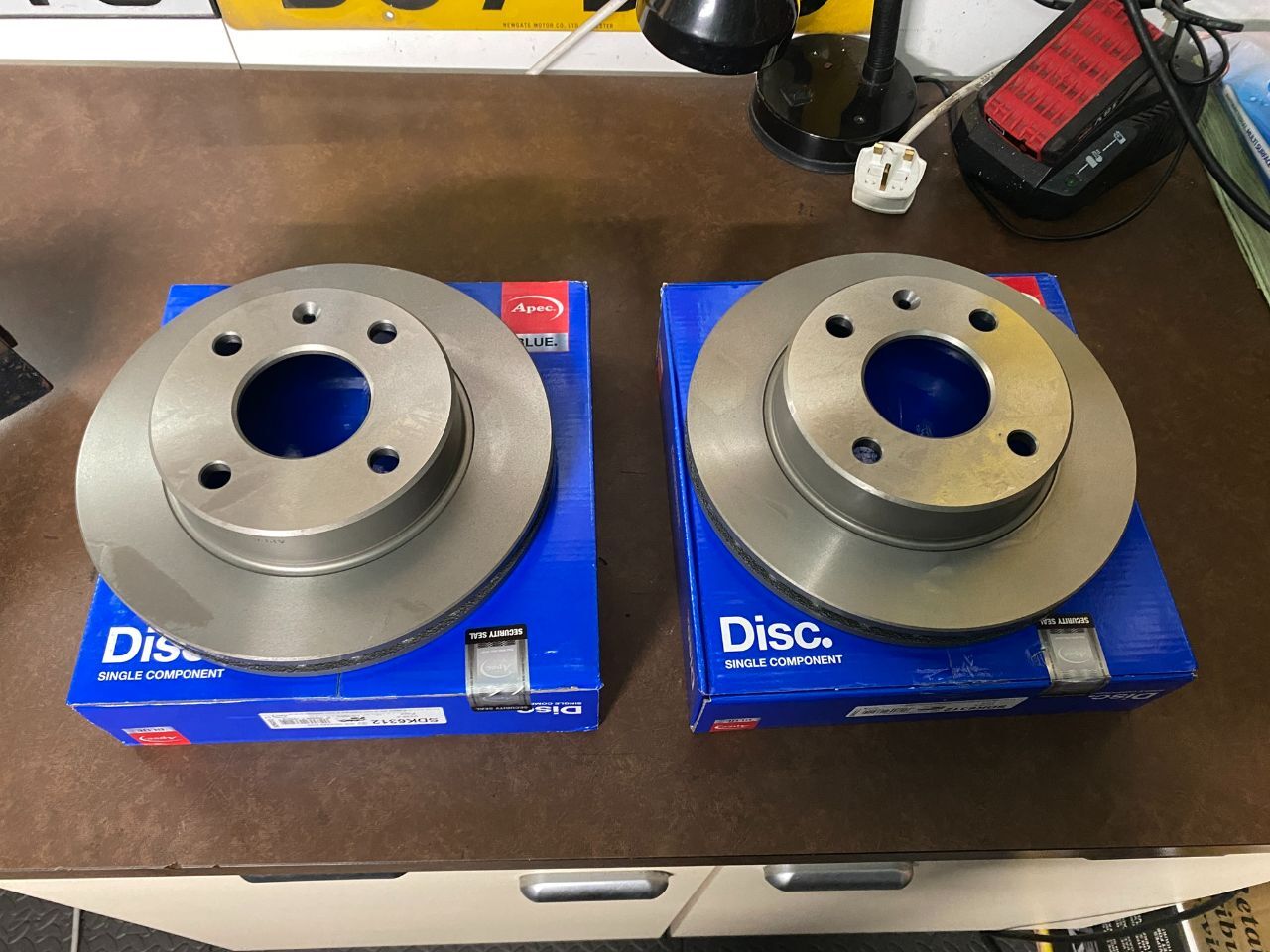

I came home from this morning's autumn drive in the MGB, had my lunch and the postman knocked twice and left a package on my doorstep.
Looks promising.
Ever heard of Apec brake discs? Me neither.
At least they're the right shape and size.
The discs were covered with a greasy protective coating, which needed cleaning off.
I started on the offside.
With the brake disc removed, the hub's mating surface was exposed. There was some surface corrosion.
Old disc v new disc.
Don't look very different, do they!
I locked the hub with a crowbar and cleaned off the corrosion with a wire brush attachment on a drill.
I got the corrosion off but a fair bit of pitting remains. There's nothing I can do about that, unless I remove the hub and have it skimmed. Or replace it.
The brake pads weren't particularly glazed but I rubbed them down with 80 grade sandpaper.
I fitted the new disc. The old discs were so fresh that the caliper piston didn't need to be pushed in to get the new disc on.
I did the same on the other side.
The hub was just as rusty.
But it cleaned up a little better.
I also cleaned the carrier, where the pad was stuck first time I removed it.
And I fitted the new disc.
With the wheels back on and a change of clothes, I took the Sierra for a test drive.
I did two rounds from M40 J3 to J4 and back again. On the downhill section of the motorway I applied a fair bit of force and slowed the Sierra down from 70MPH-45MPH a few times and the same at lower speeds on the slip roads. By the time I got home and got out, I could smell the brakes. I didn't cook them, just gave them a good workout. I am pleased to report that there is no more brake judder. The steering wheel is rock solid whenever the brakes are applied. Win.
It's hard to say whether removing a bit of surface corrosion from the hubs made any difference. I suspect that the old brake discs, or at least one of them, was warped and fitting new discs solved the problem.
The thing is, the brake judder only started occurring fairly recently. I never drive the Sierra hard enough to cook the brakes and I certainly never drove it through deep water or in the rain, so why did the disc/s warp? Who cares, problem solved.
Thank you to everyone who contributed to this thread this week, your advice and words of encouragement mean a lot to me.
