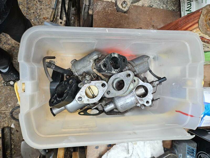

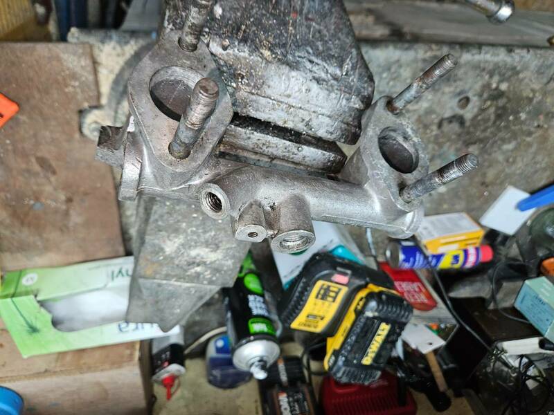

The minor , it is a 1098 and when we re-built it we fitted a high lift cam , raised the compression ratio and did a bit of head and combustion champer porting but  it still has the original single HS2 carb and pea shooter exhaust, my son has been using it like this for a year and  it's certainly much better than it was (he was using for towing canoes over xmas). We have though bought a pari of twin SU's off a MG1300 and a LCB type exhaust, soI started stripping and cleaning  the SU's, the first parts are in the ultrasonic tank, now I did come accross one problem though, the heatsheild we bought for it was intended for Midget but the carb spacing on a midget appears to be about 20mm different to the MG1300, I'll probably cut it and rivet it back together narrower.

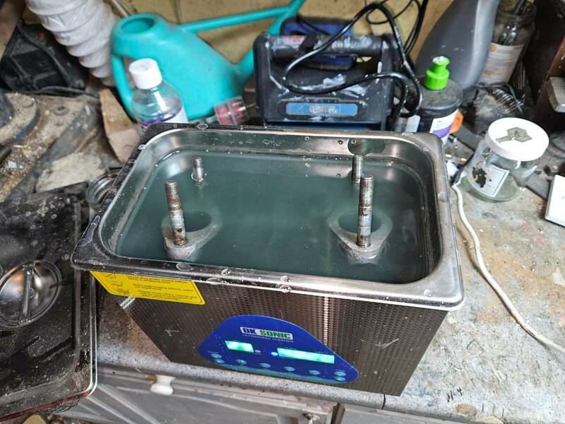

Carbs stripped from manifold and difference between carb spacing on MG midget vs Mg1300
20240106_171936.thumb.jpg.f0281e6f74e50f1ac47b0fdbdf2fcf97.jpg20240106_171854.thumb.jpg.772c072fd7026d771de134e6535ba16c.jpg

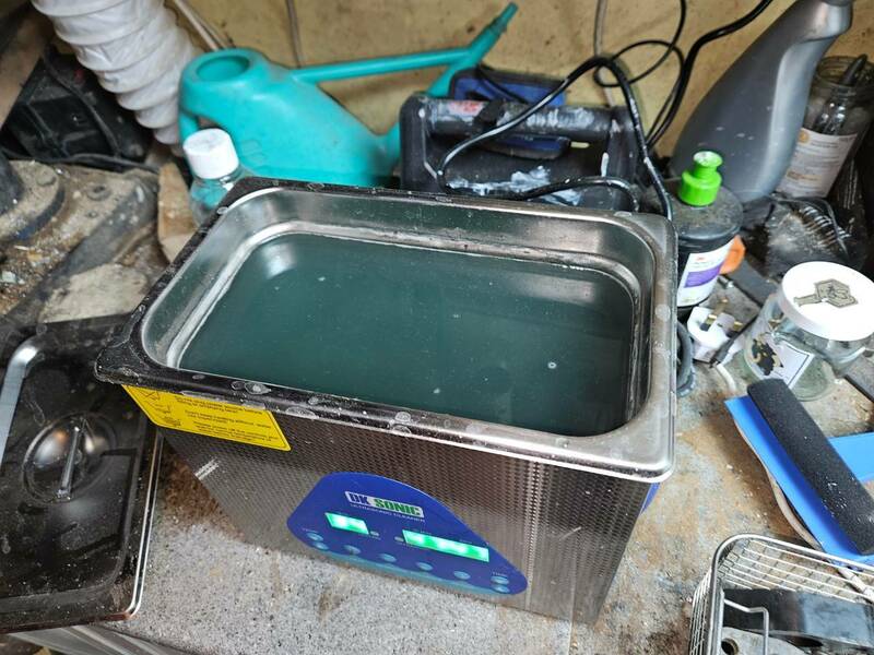

In ultrrasonic tank20240106_172511.thumb.jpg.cc14cb1d9234d5e552345aa24c86ba0d.jpg
fluid was clear before20240106_182500.thumb.jpg.3d71c49861c5cd2c60253a9ed08d9094.jpg20240106_182324.thumb.jpg.4efcb41a045e70612742d488f377fbaf.jpg
manifold afterwards.

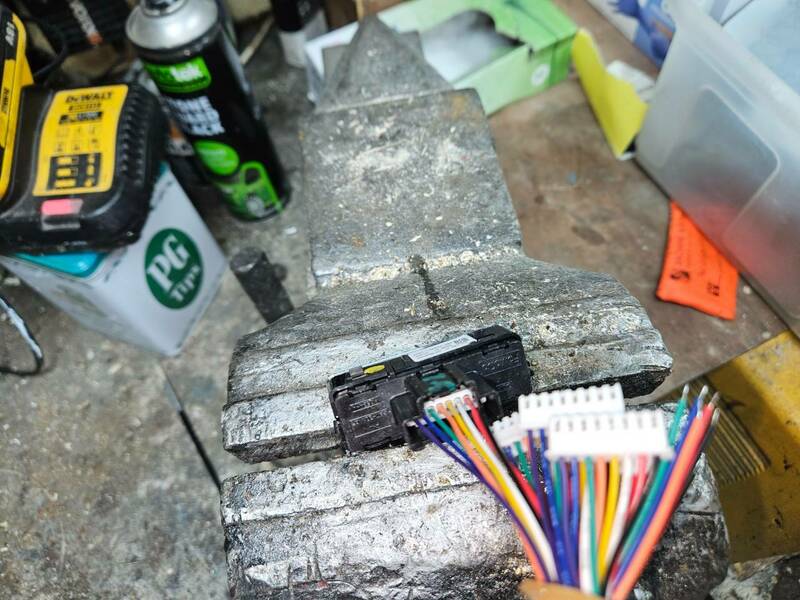

Spent most of today with the family at the Harry Potter Studios, when I cot home a selection of connectors I ordered had arrived.  One of the things we want to do to the fiesta is fit mk7.5 heated seats, the seats and switch are easy enough to get hold of but the wiring connector for the switch is a problem, I thought computer ones looked similar and lo and behold they fit.
obviously don't lock in like the originals but they are a nice tight fit so I don't think that will be a problem, Using a multimeter and 9v battery I also worked out the pinouts.
Now just need to make a loom to go to each switch, decide where to put the switch (replacing credit card holder is favourite) and of course get some seats, that will be another summer project.

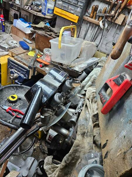

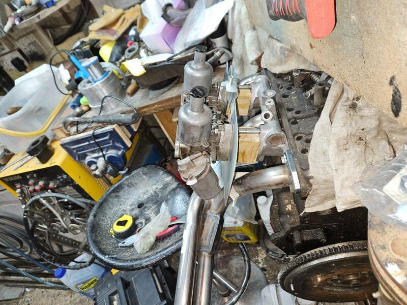

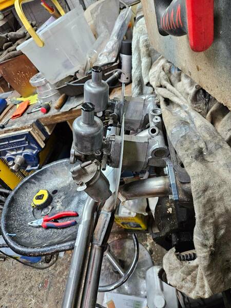

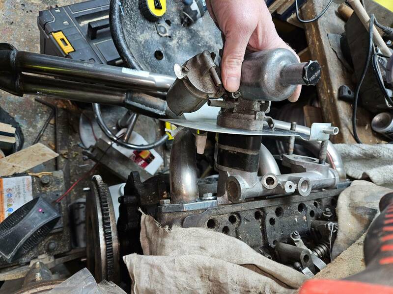

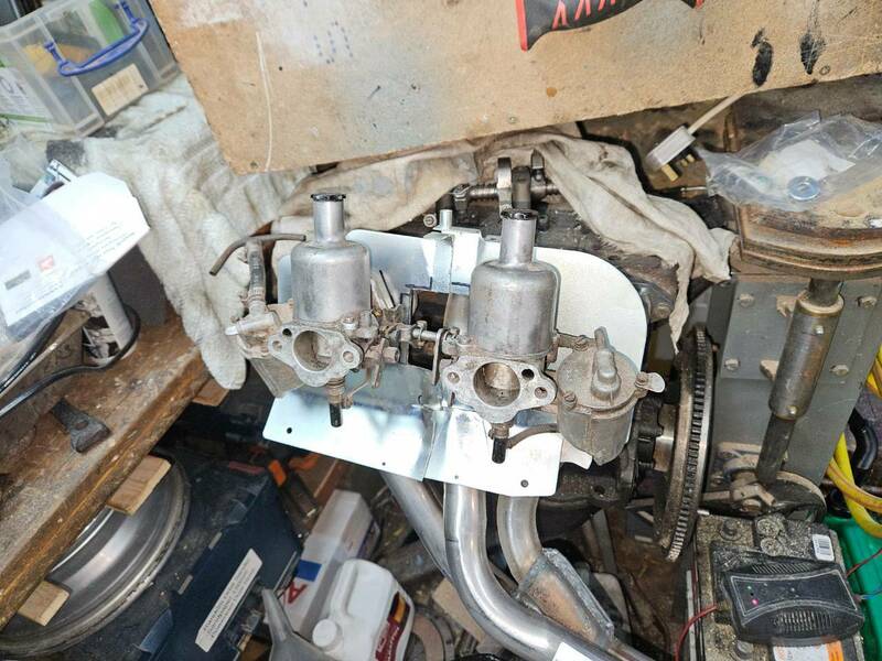

Tried fitting the manifolds on a spare minor engine today.
manifolds fit OK but the carbs foul the exhaust.
that is with the spacer combination that came with the MG 1300 set up.
Options seem to be a new maniflow fabricated manifold at around £240 or lengthen the studs and make some thicker spacers which will cost around £30, I'm going for the later! using the spacers I have this seems to work.
which is a 50mm spacer behind the heatsheild and the std minor plastic block in front of it.
I think a big stack of the plastic spacers is asking for trouble though so I'll buy a 50mm square alloy block to make the main spacer out of.

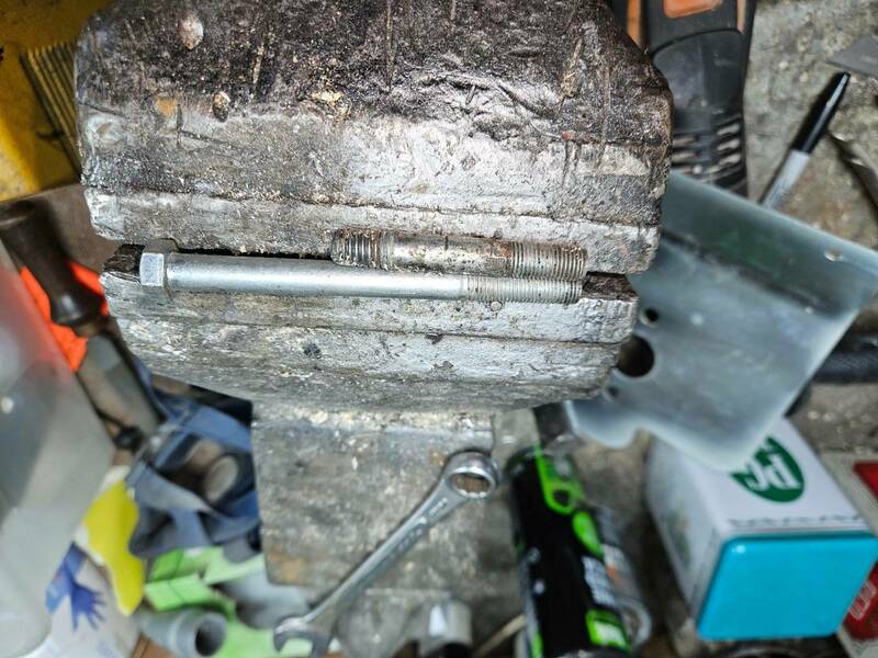

For the stud it needs to be 3/8 UNC one end a 3/8 UNF at the other, digging around I found these 3/8 UNF bolts.
Which I can cut the head off and tap the other end to UNC, they are series Landrover front bumper bolts so 4 new ones were less than a fiver.

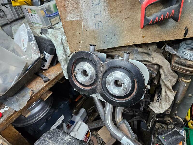

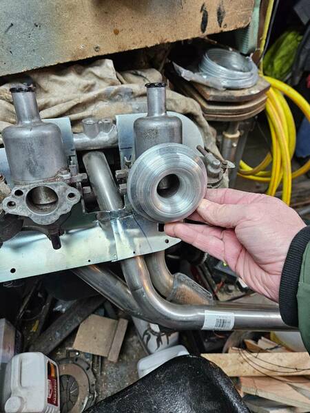

Had a bit more of a play with the minor carbs today, cut a couple of 50mm spacers, made a couple of longer studs and mounted the carbs.
cut some of the heatsheild away to give clearance for the linkage.
I think I'll probably cut the centre out completely and replace it with a lowered section.

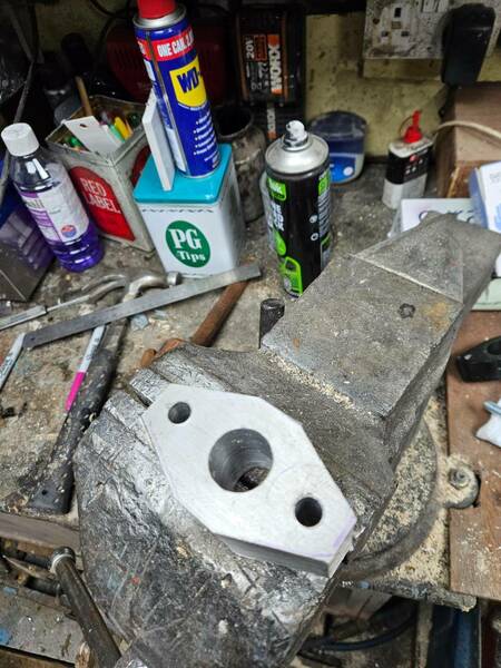

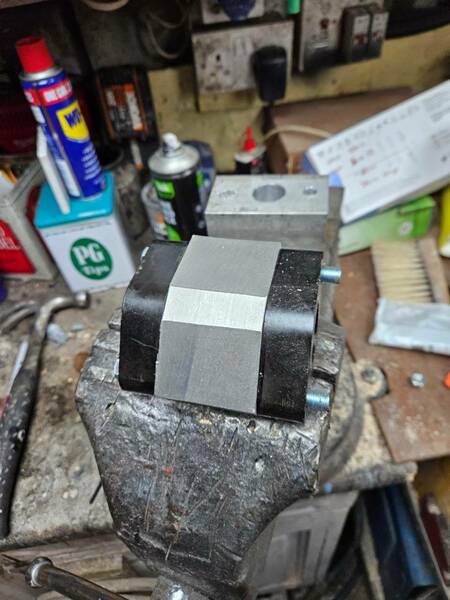

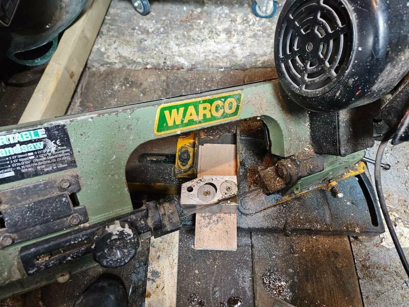

50mm square block of aluminium arrived today, so I set to making the spacers for the carbs, went to cut it to length with my 2 years and 1 month old evolution saw to find it's packed up, turned out the stator has gone because this wire rubs on the rotor.
sent them a letter expressing my dissapointment and that I don't believe this is reasonable, we'll see how they reply.

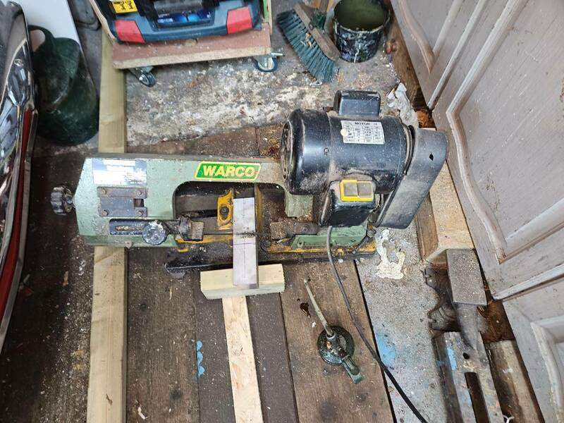

so I dug out my old metal bandsaw,and cut it up with that.
drilled some holes in it then used the bandsaw to cut the sides at an angle.
to give me this.
checked the holes are square and parallel.
The bore is currently only an inch so I will either need to get a 1 1/4" drill or bore it out on the Lathe round my dads, the outside will probably be tidied up with the belt sander.
The studs I've done by hand are not true so I will do the new ones on the Lathe too.

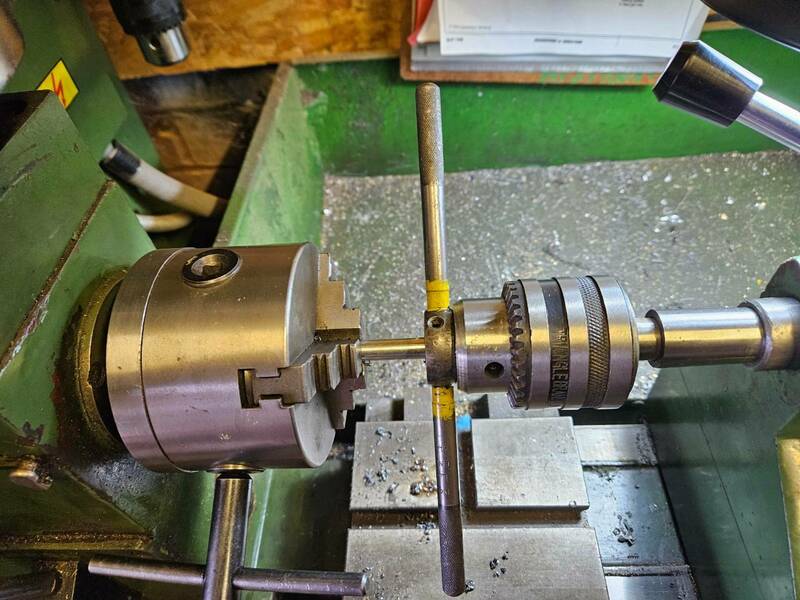

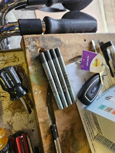

today spent 3 hours standing in front of a lathe.
firstly the studs, I'm sure we have a die holder to go in the tailstock somewhere but I couldn't find it so started the die square using the chuck in the tailstock.
I have now tried them and all 4 are true.
next up boring the spacers out.
had to take it slowly as the 4 jaw chuck in not that rigidly mounted but got there in the end.

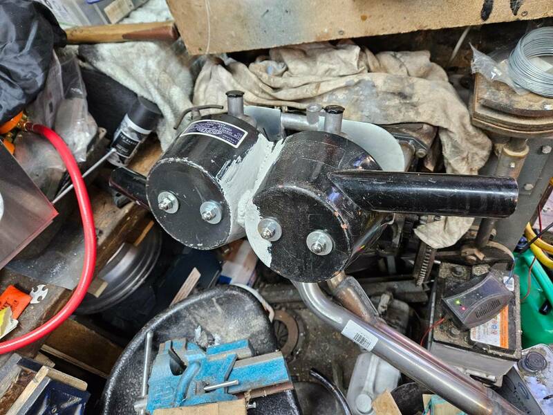

Then onto the air cleaner mount / intake trumpet, a bit rough but I will tidy them up with a drum sander on the dremal.
this is the 2 of them in the air cleaner backplate.
unfortunately the tool dug in so one has a groove in it, I'll probably coat them w5ith epoxy and sand that smooth.
one in place on the carb. will need to drill the mounting and vent holes this week.
when I got home I trial fitted the studs and spacers, all good.
Only thing which worries me with this is icing I'll add a spigot to the heatsheild so the air cleaner can be ducted to pick up hot air if need be.
It does get used in the winter a 150 mile round trip today to pick up a 110 year old canoe today.
Filled the groove in with epoxy mixed with alloy filings  and cleaned up the intakes,  using files and a sanding drum, then drilled them and fitted with some bolts.
Eventually they will be replaced with lengths of studding which will also hold the aircleaner on.
Next up will be finish the heatshield. I may also look at bracing the lower carb fixing down to the block, there's a lot of mass hanging off the not amazingly strong manifold to head joint.
Also checked the air cleaner fitted.

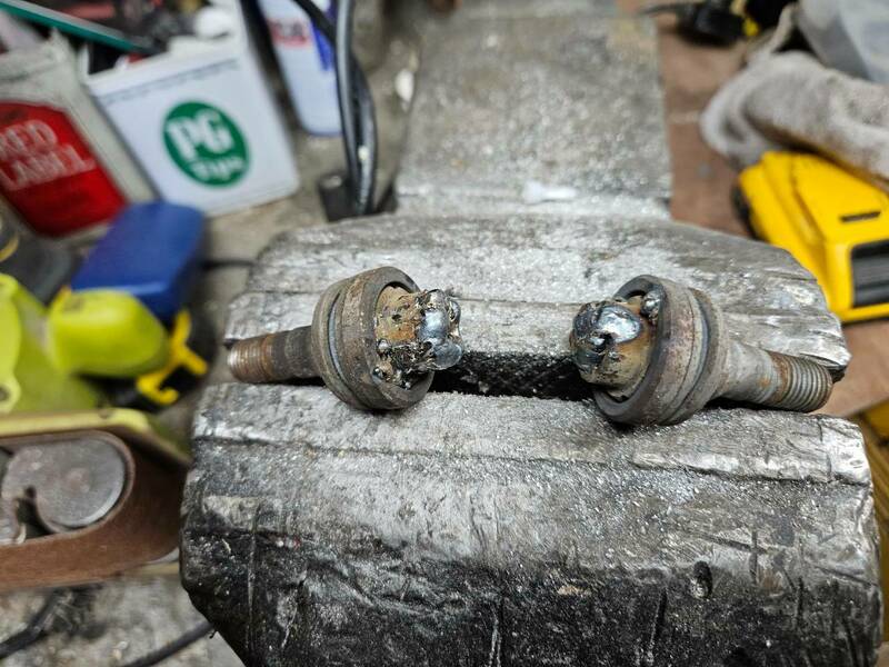

Spent my lunchtime today on the Father in-Laws car, this, a proper Shitter.
For years he had an old Doblo but now has a dodgy foot so wanted an auto.
I told him to get something non turbo petrol with a conventional auto ideally VW or Ford . He bought a  dv6 automated manual Shitroen from a dodgy dealer.  Already its cost him the best part of a grand to get the electrics and leaking injectors sorted, and  a recent service highlighted it had locking wheel nuts and no key....
So that was my task for the day, blobs of mig and hammering sockets on got them all off and replaced with normal bolts.
And tomorrow I'm apparantly driving it round to surrey,  I've checked my AA is upto date!
