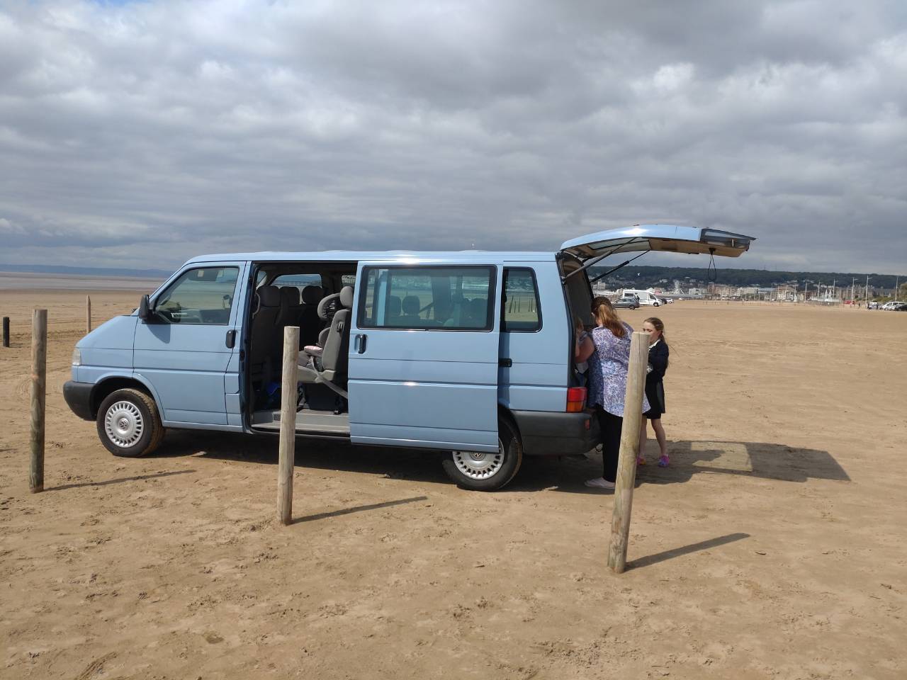

BorniteIdentity Posted September 26, 2024 Posted September 26, 2024 Just now, Andy F said: Another year with the Caravelle another MOT pass. Needing attention to the rear brake compensator again (will source new one) and needing a new centre exhaust section and back box. All fitted yesterday so it's out and about again. It completed a fairly epic voyage last weekend with the band. Bourton on the water - Cheltenham _ Worcester - hairy Dog Derby for a gig on Friday. Then on to Nottingham for an air b and b before heading to Equinox festival near Grimsby on the Saturday. Then reverse journey on Saturday afternoon. Getting on for 400.miles. pretty much trouble free except the exhaust on the journey home sounding rattly and blowing. I'm not sure if the release bearing on the clutch is wearing so will get saving for a new dmf and clutch. Clk is going well too, although the Gloucestershire torrential rain meant it has leaked and I drove to chipping Campden with soggy bottom when the T4 had its MOT this week! That Caravelle has been much loved over the years; the vicar who had it before me treated it like another child. Please stick up a picture or two and I’ll text him; he’ll be delighted to see it still trundling. Andy F 1
Andy F Posted September 26, 2024 Author Posted September 26, 2024 doug, BorniteIdentity and Matty 2 1
Andy F Posted September 26, 2024 Author Posted September 26, 2024 Handsome old bus in my opinion @BorniteIdentity Here's my current view, between Northleach and Sherborne on the A40 before an afternoon of teaching the trombone. fairkens, BorniteIdentity and doug 2 1
BorniteIdentity Posted September 26, 2024 Posted September 26, 2024 We had some right laughs in that van. Absolutely the very best of times. The reason it’s done so many miles is the previous owner would drive all the way down to Cannes three or four times a year with his family. It was very much loved, and so nice to see it still making memories today. Safe and happy travels! Andy F and Matty 2
Andy F Posted September 27, 2024 Author Posted September 27, 2024 18 hours ago, BorniteIdentity said: We had some right laughs in that van. Absolutely the very best of times. The reason it’s done so many miles is the previous owner would drive all the way down to Cannes three or four times a year with his family. It was very much loved, and so nice to see it still making memories today. Safe and happy travels! Brilliant, it makes me smile every time I drive it. It really only gets used for long journeys, so hopefully it will happily soak up many more miles without too much wear. If you have any more history (photos and stories ) do please share. With a new exhaust it is much quieter than it was, so it must have been blowing for a while. Things I want to do; retro fit cruise, and sort the stereo out. Its got 4 speakers, 2 on the dash and 2 pretty much in the boot. The passengers in the middle always ask for the tunes to be turned up, and the other rows always complain it's too loud! It's been a long time since my teens and fitting bangin' stereos but I'm quite looking forward to reliving my youth haha.
