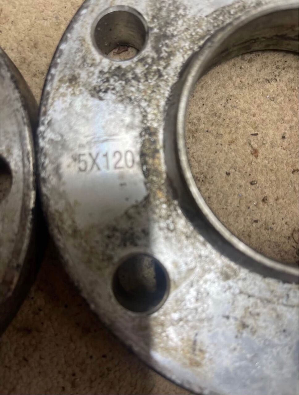

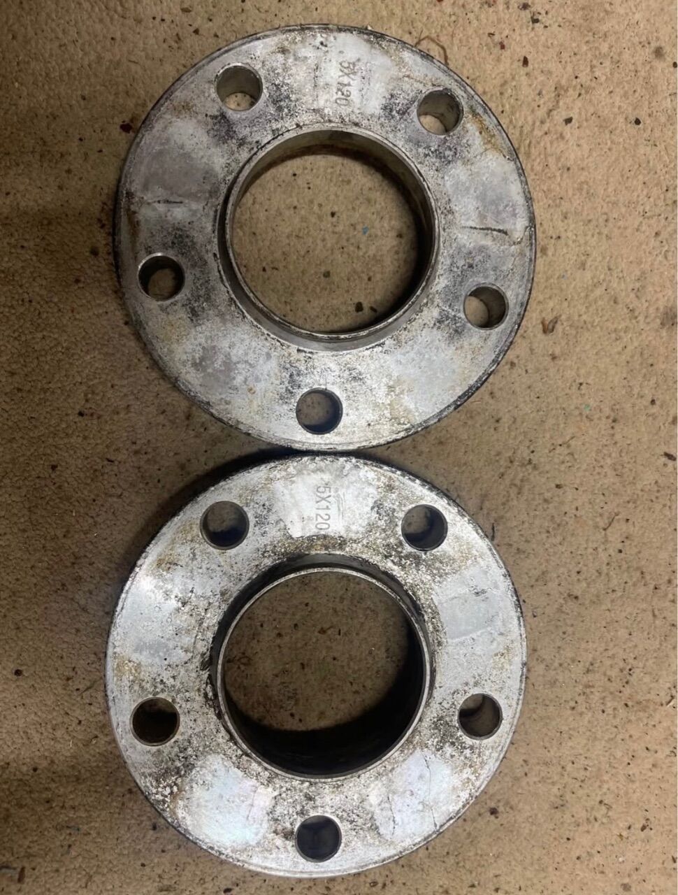

5x120 wheel spacers
20mm thickness.
I will include 9 long wheel bolts (no idea where no 10 has gone)
I would like £20.00 please.
Collection at St Mary Hoo area of Rochester.

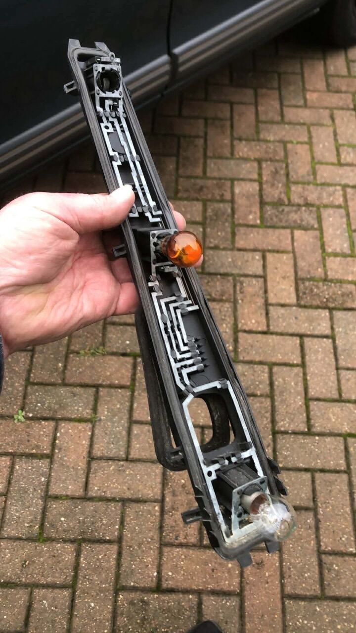

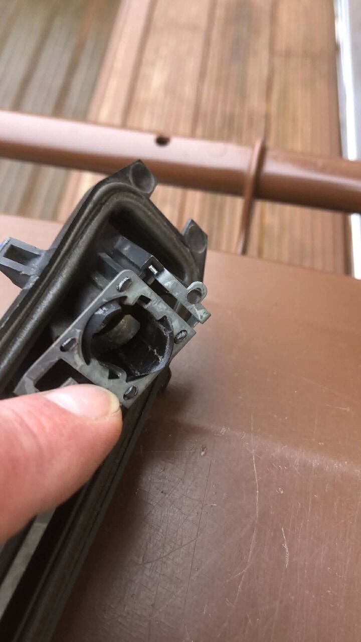

I noticed one of Pedro’s rear lights was not working.
So a quick lightbulb change meant removing the complete unit (Torx screws) to unplug it.
New bulb fitted, tested before reassembly.
Works.
Reassembly…. No Worky. Bugger.
Disassemble.
Inspect.
Fault found.
A part of circuit broken.
Now go to garage.
Soldering iron, melt plastic and reassemble.
Refit, Test, Success.

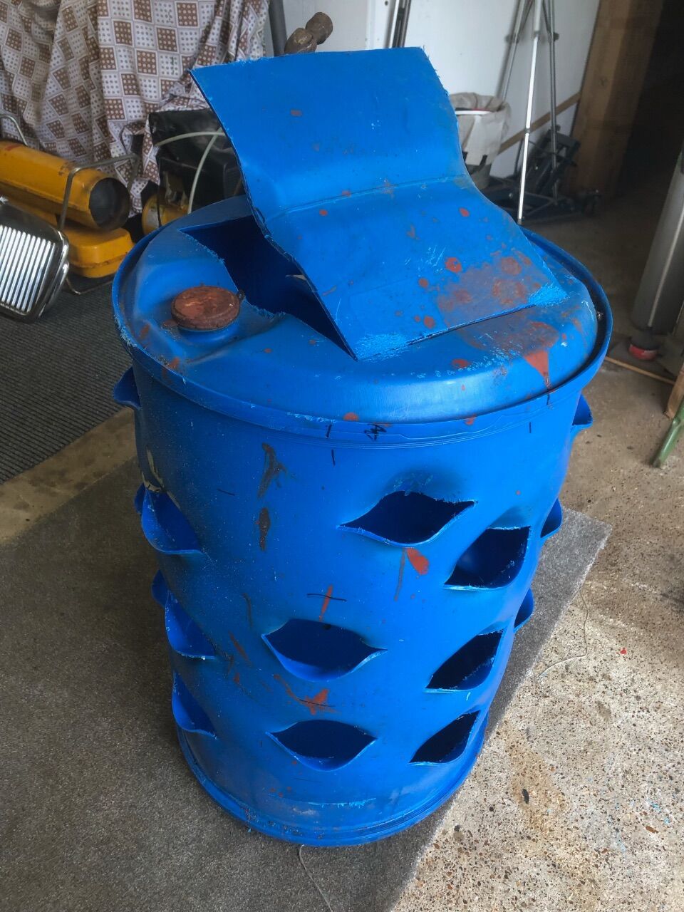

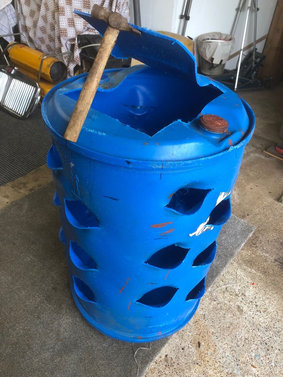

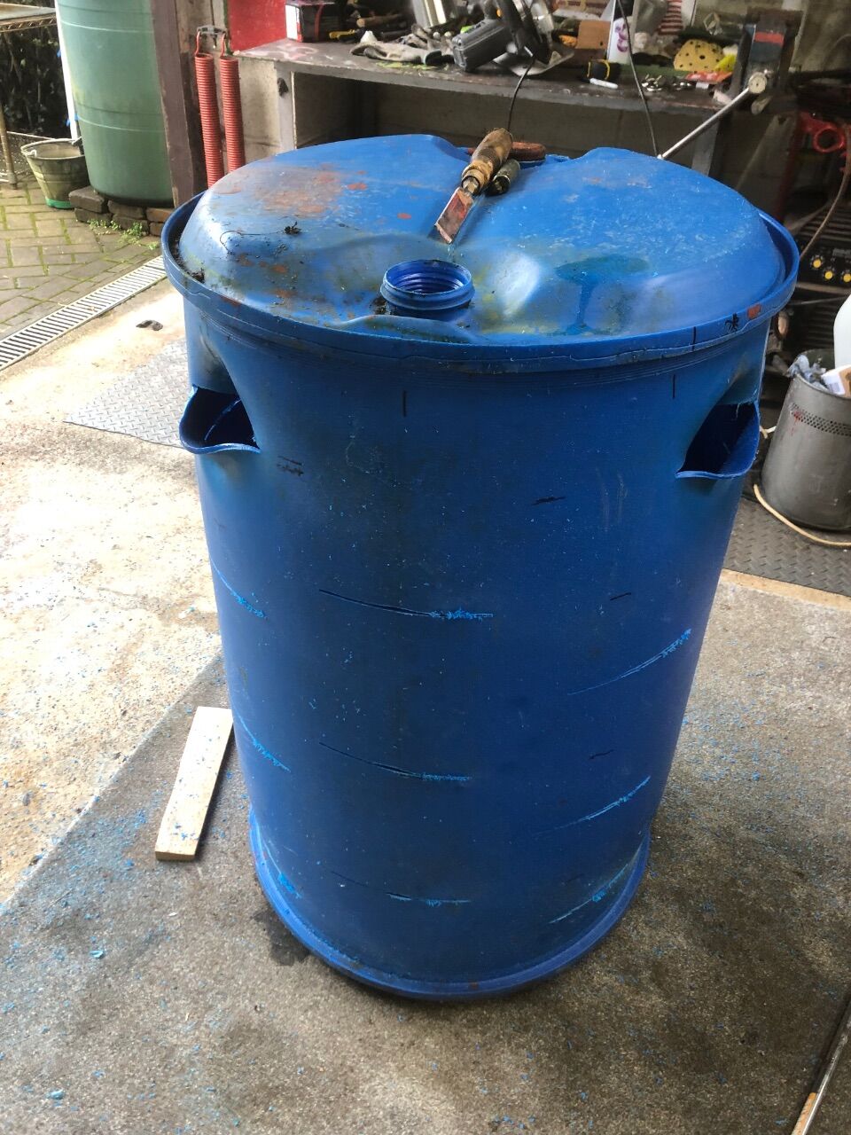

Vertical Strawberry planting for Sarah.
Her 92 year old mum is struggling in the garden now to go to ground level and then getting up again.
So why not raise the beds up to her level.
I also have collected and traded a load of scaffolding poles and fittings so that I can create a upright space with wires like a washing line for the  Raspberry canes to be grown on.

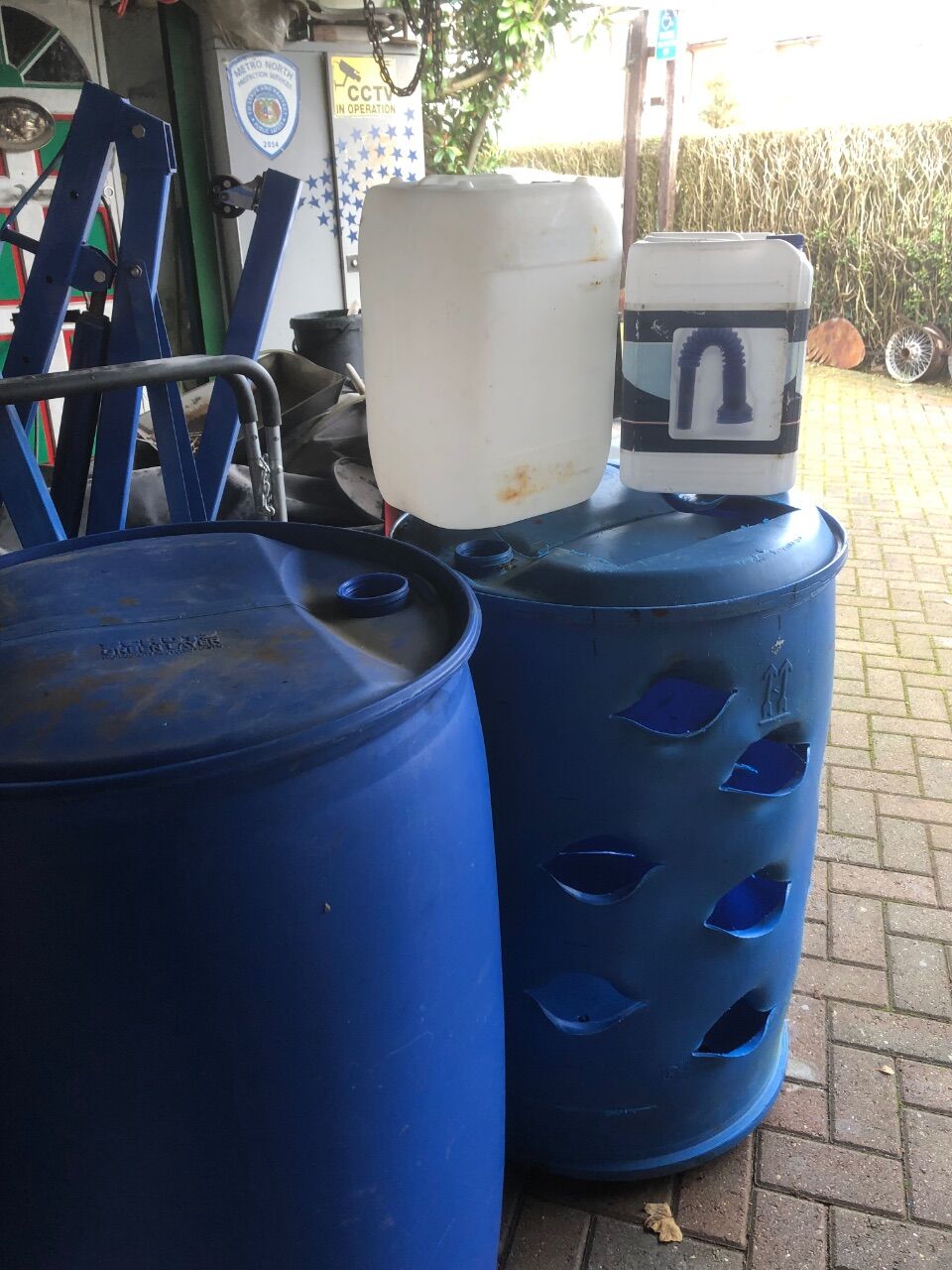

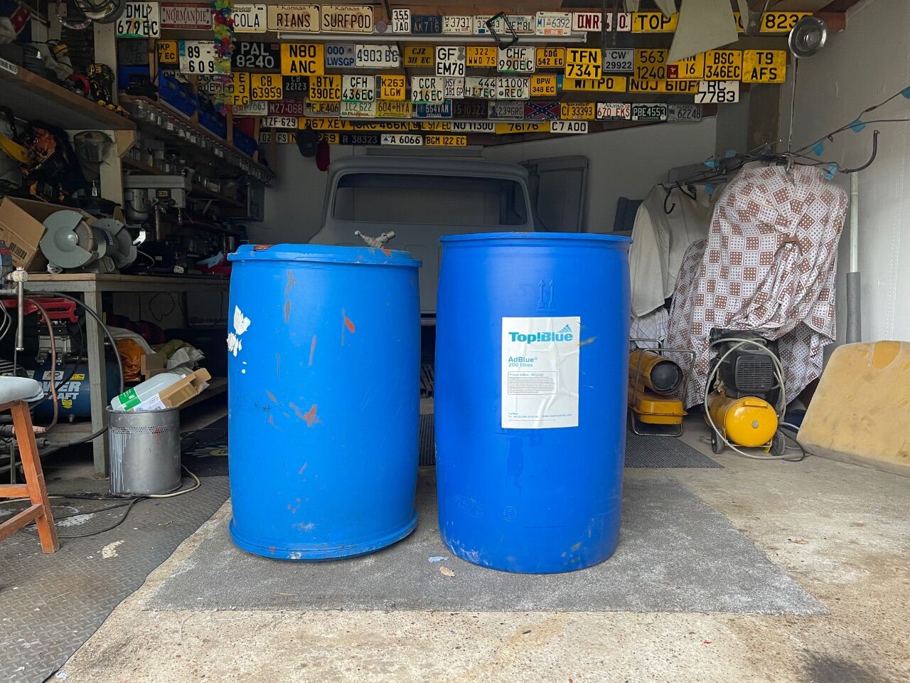

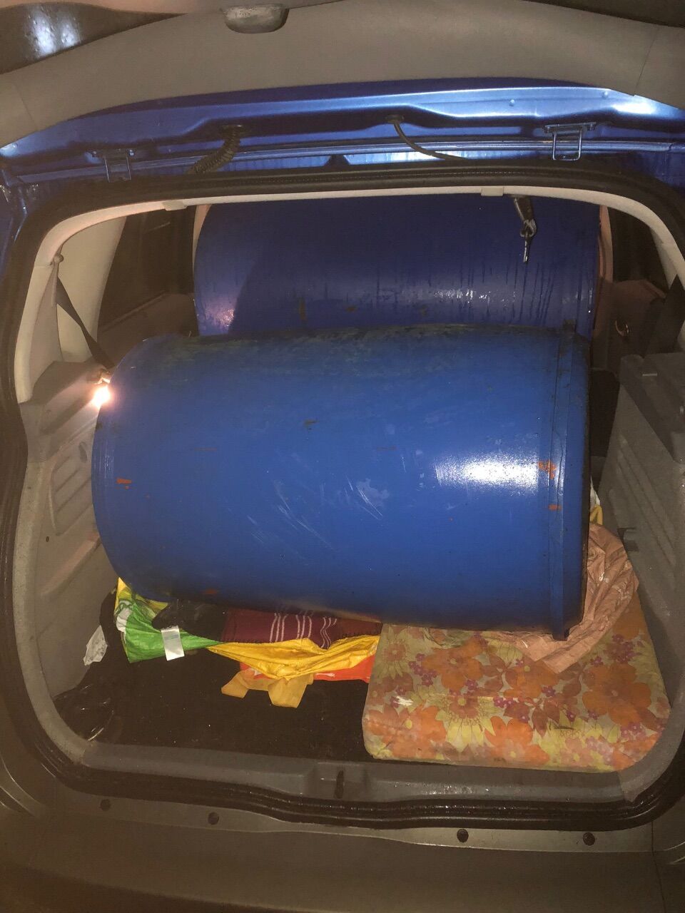

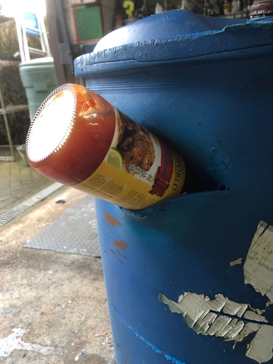

I got two 200 liter drums.
Plan, Measure, cut, Melt, Ream, Shape, Repeat.
VIDEO.
Second drum to be done later as other jobs are also in line.
Messaged Sarah with Video and photos.
I had two empty containers to put inside the drums to displace some space so she doesn’t need as much soil inside drum
She needs to find some more  surely I don’t have to do everything
Happy girl.

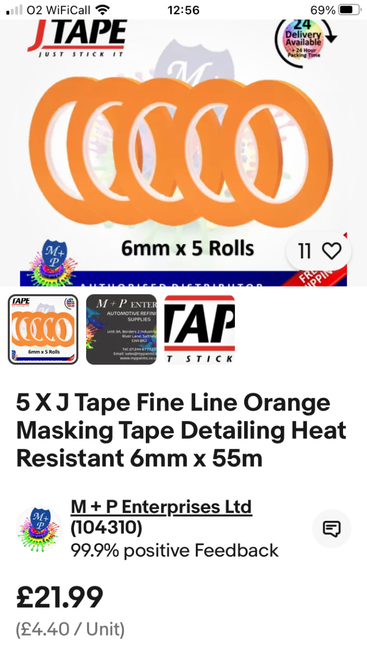

Hope you have plenty of fine line tape
Ttfn Glenn
I actually don’t have any.
But I have time to order and buy.
Low tac tape…..??
Experience, opinionz??

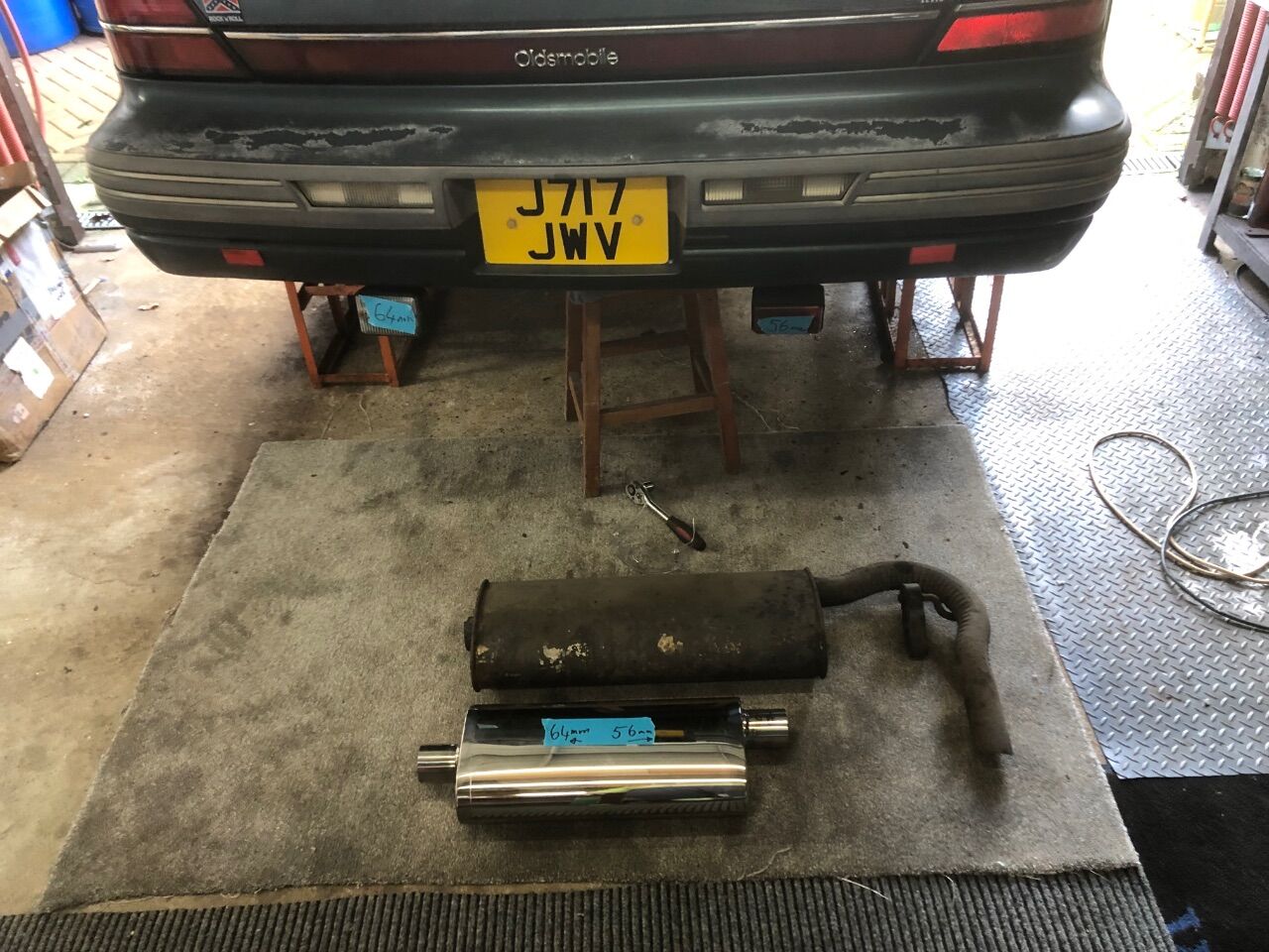

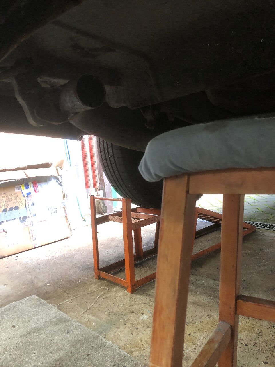

Oldsmobile reversed down to the garage.

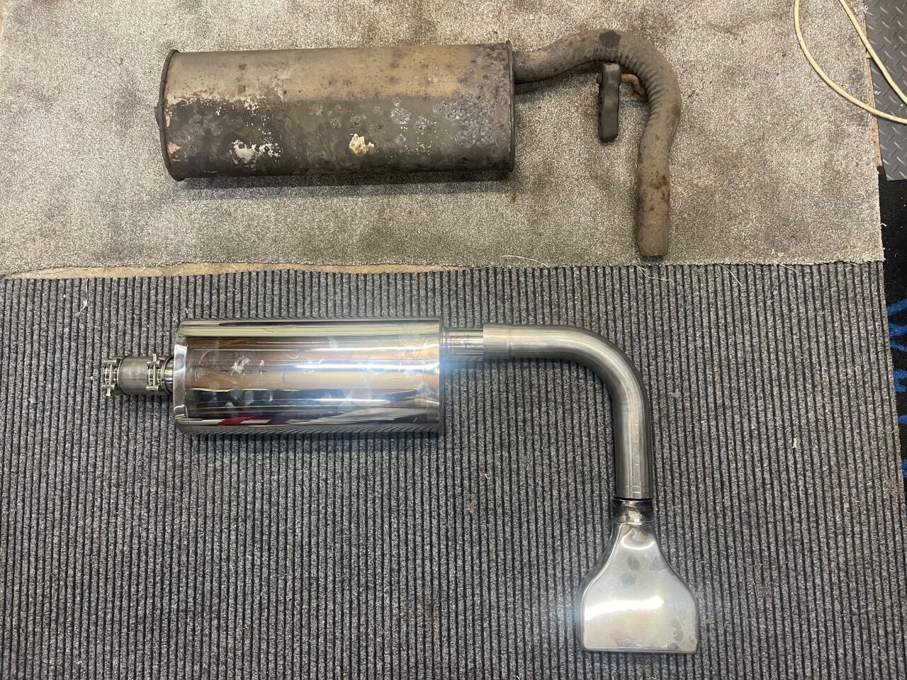

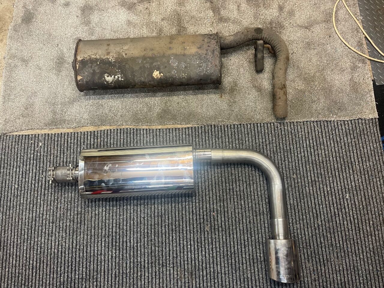

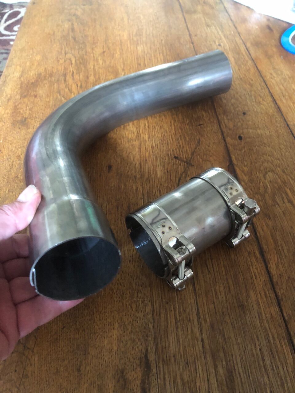

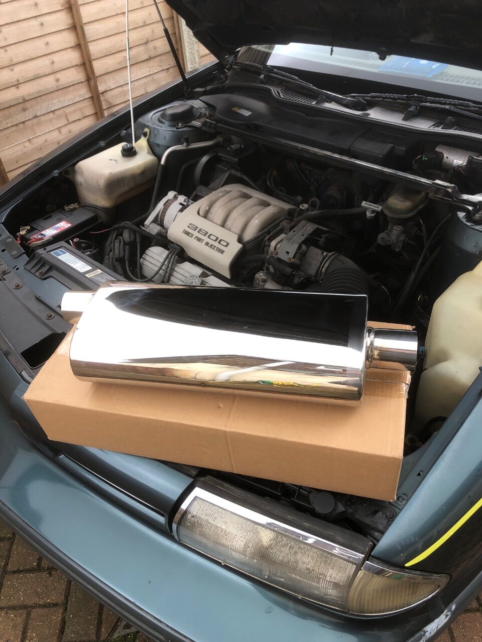

Up onto some ramps and off with the original silencer which had a few leaks.
Then test fitted the new silencer.
It was a fail because I need some pieces to connect the new silencer to the original pipe and also a new exit tip.
Ordered off Ebay.
90’ bend £13.00
Short 65mm dual slip over connector and clamps. £23.00 delivered.
Delivery hopefully Saturday.
I made a 90 second video of engine sound with leaking original silencer and then engine minus silencer.
I loved it there for a few moments. Not sure a road trip would be fun though.

As your new silencer is basically straight through , will it actualy 'silence' anything ?

https://ebay.us/m/A06PcX
The stuff I used, did the job needed. Can't give a review as such because I haven't used anything else as don't do much painting
Think I bought it solely on low price, but no complaints
Might be an idea to get a couple of different widths if you want to do tight curves
Ttfn Glenn

x5  Ordered.

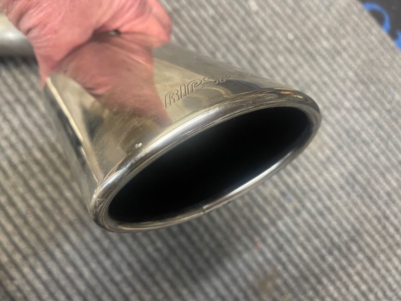

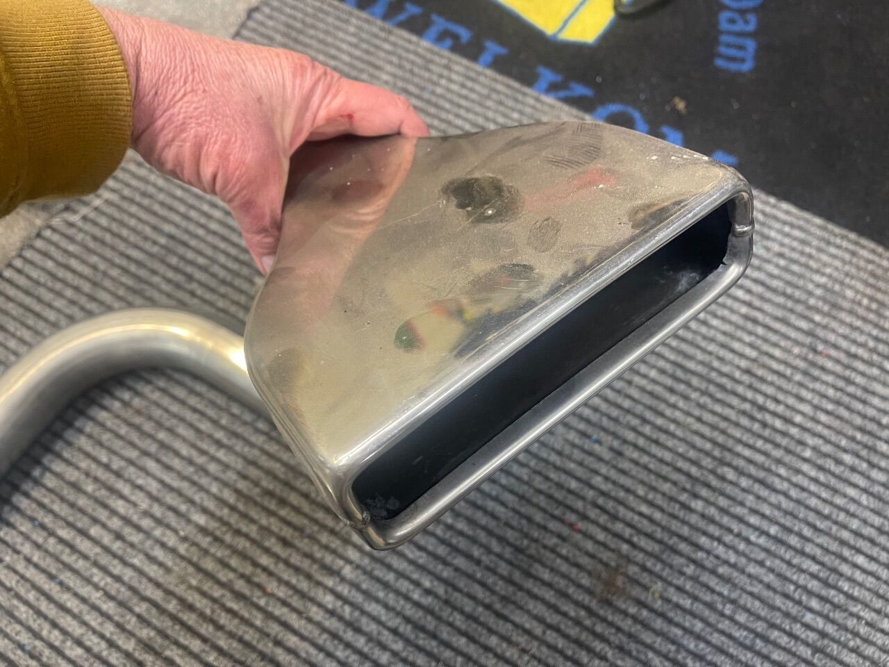

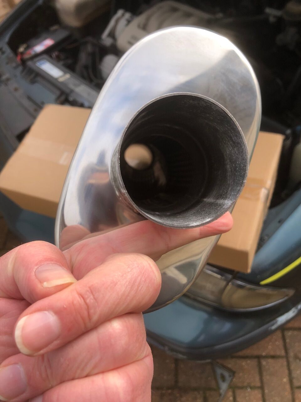

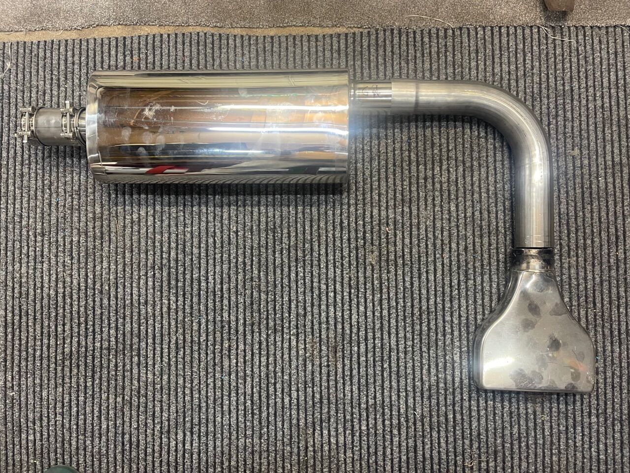

Ended up just laying the pices out.
Then remembered I had a couple of sets of tailpipe tips.
One set Corvette tips, planned as side exits, a bit like a NASCAR Boom tube, on my 66 C10 Resto.
I actually think the oval tip suits the car much better.
The original tip just dips down to the ground.
The exit bend and tips were not slipped together.
Opinions?

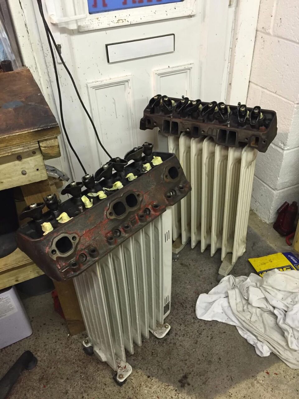

Facebook and the internet never forgets.

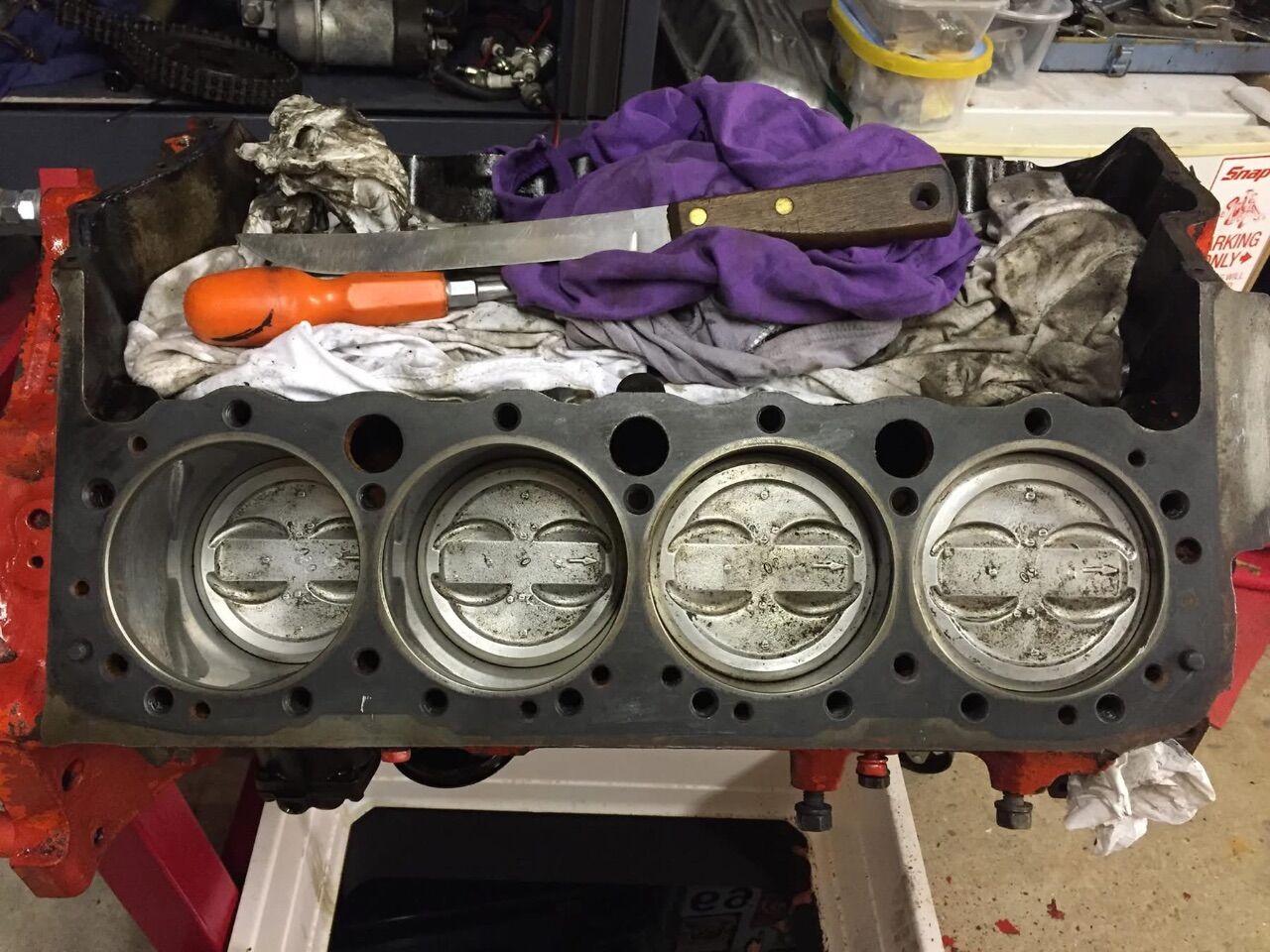

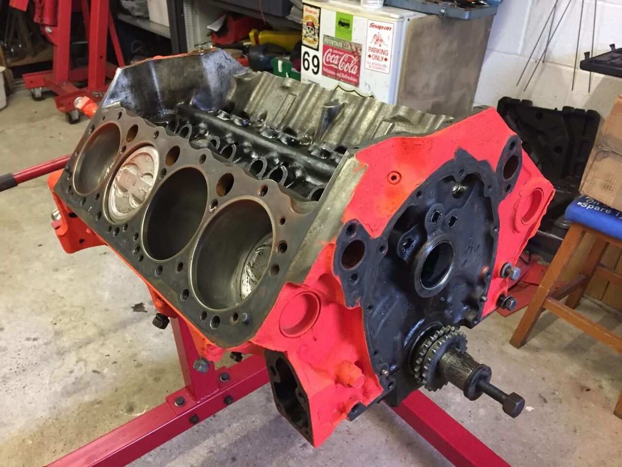

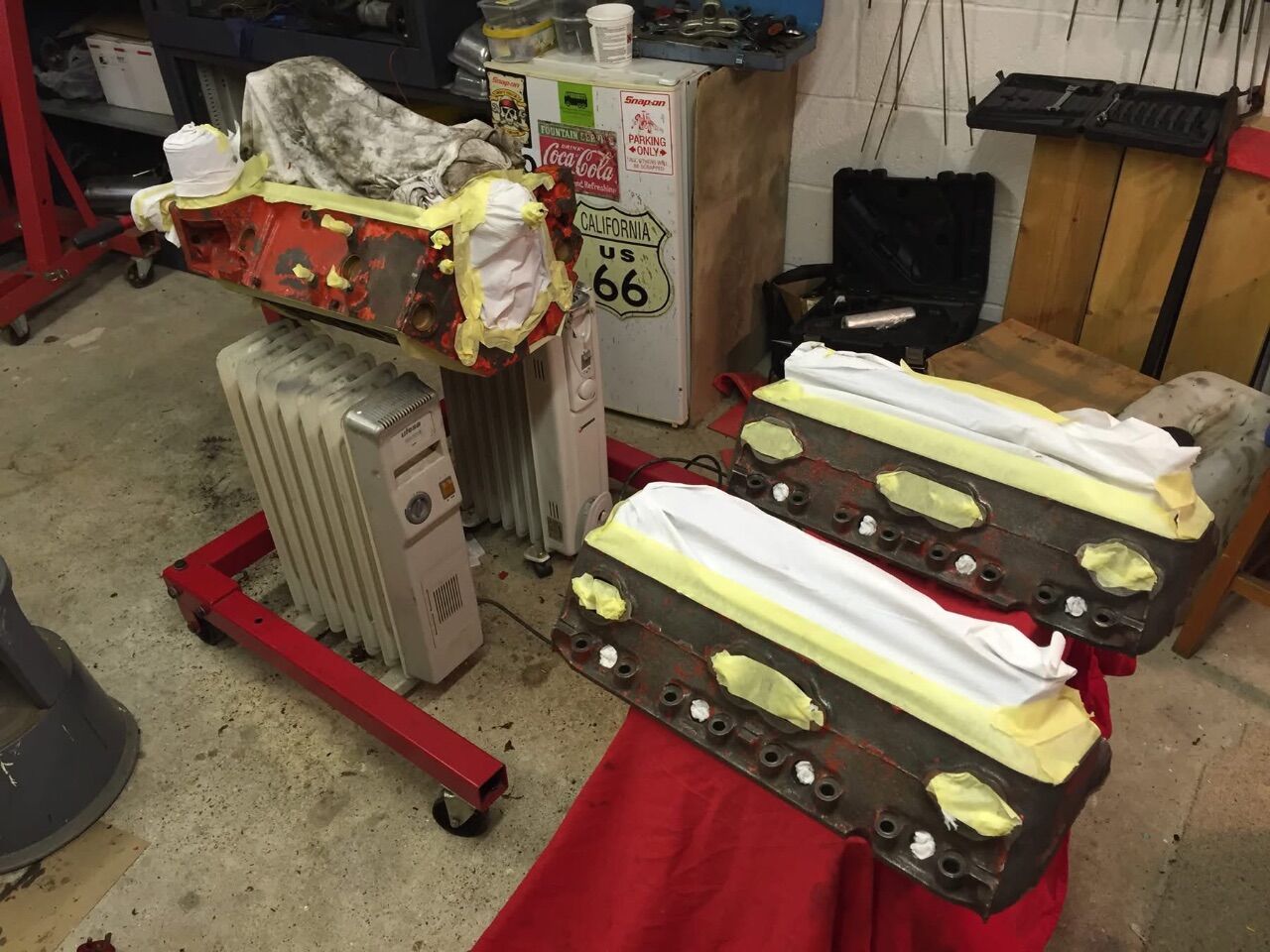

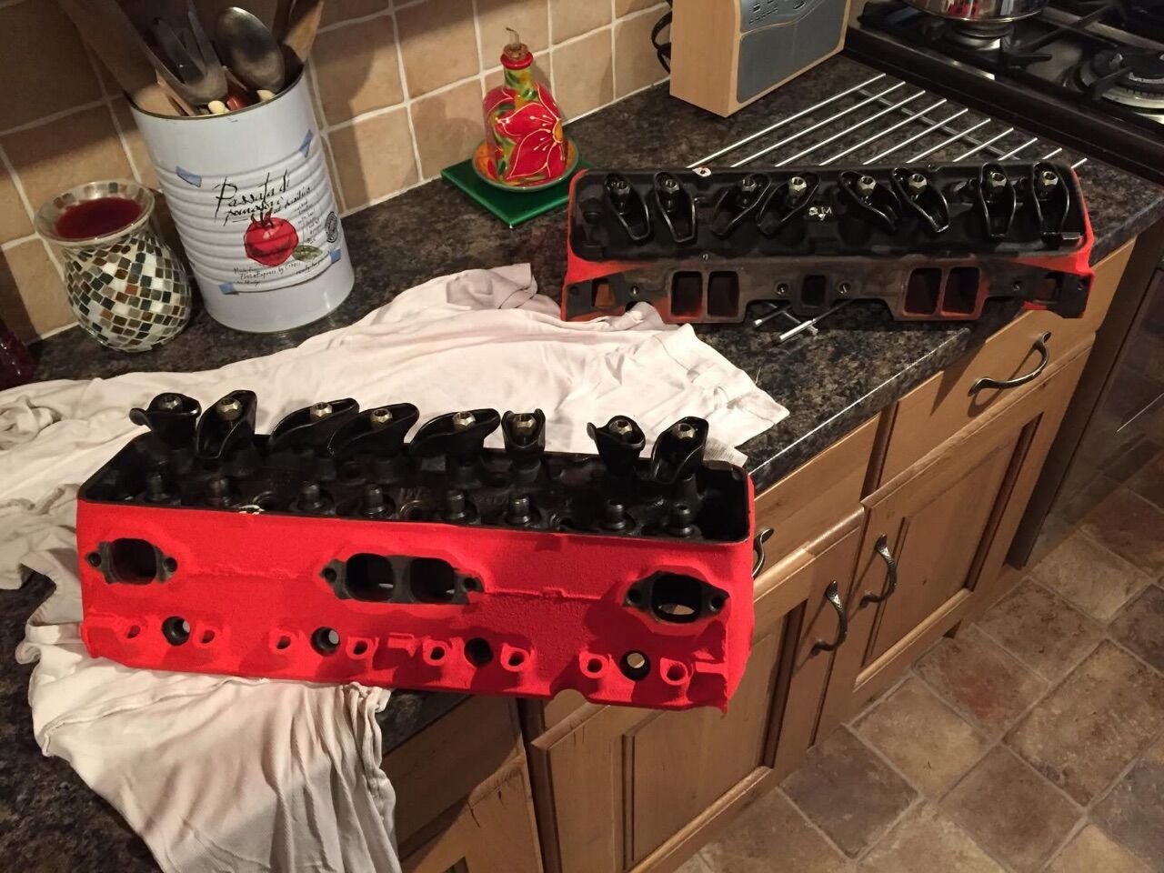

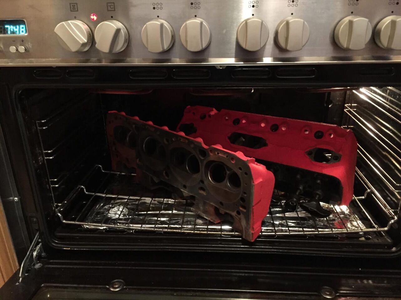

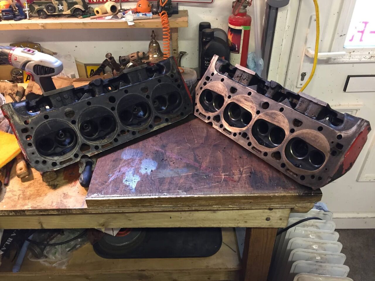

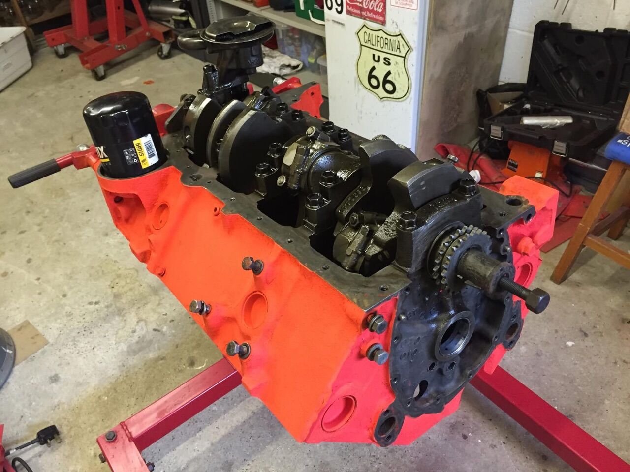

10 years ago @pauly and I rebuilt the engine with a slightly naughty cam in the expectation that it would be back in the truck before the year was out.
Of course, all that was out was my marriage. It hit me hard as my commitment to it was complete.
Many other distractions, Covid  and builds later I am back on it.
Waiting for winter cold to dissipate so that I can get back to the C10 Resto.
Some photos, including baking the VHT paint in the kitchen in my oven. (Not the reason my wife left to get married a 5th time)

One vote for the 'letter box' exhaust tip/end ... 😇

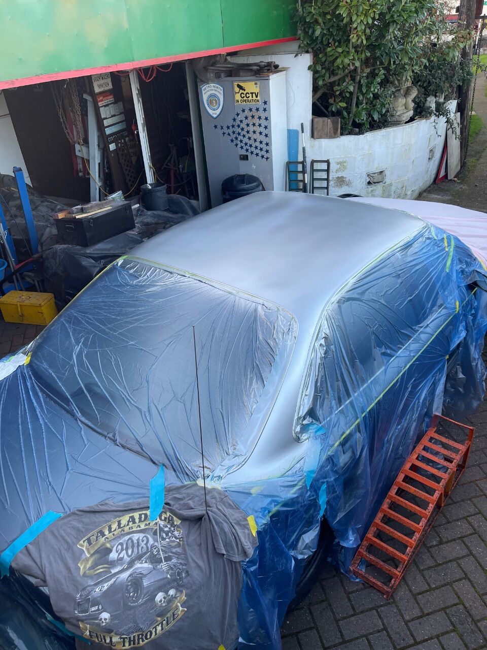

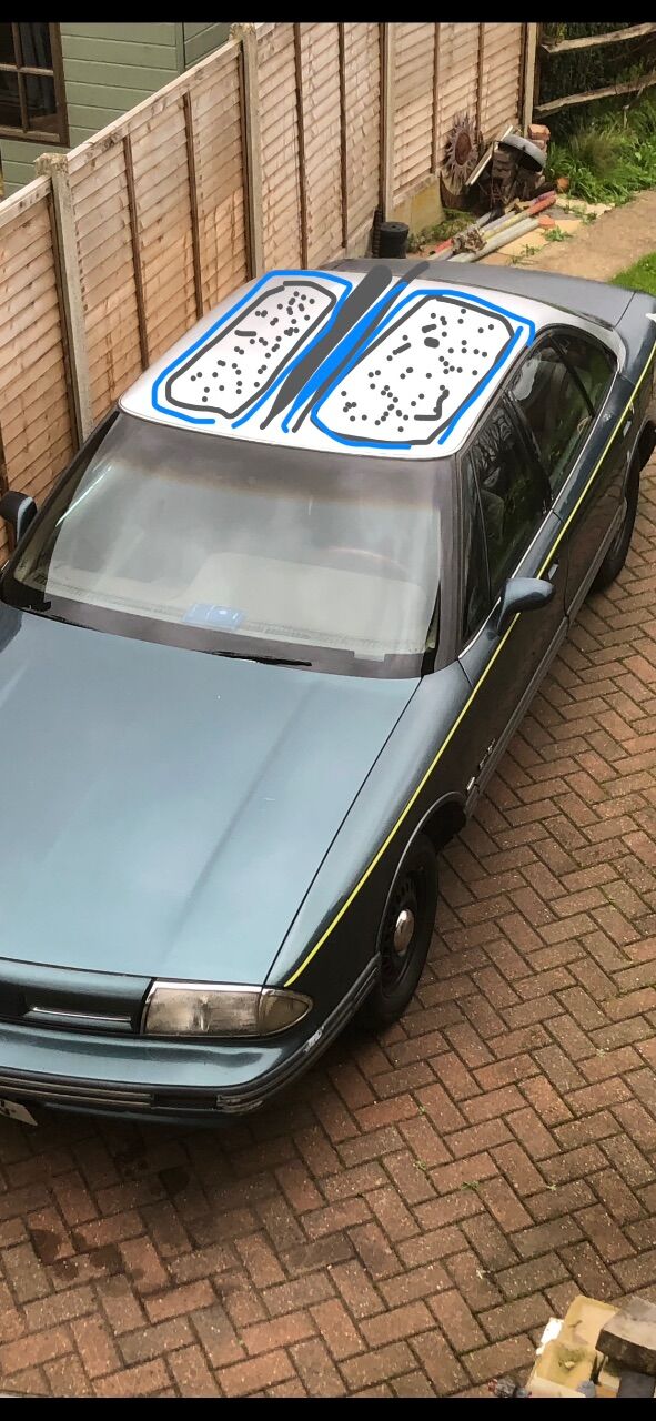

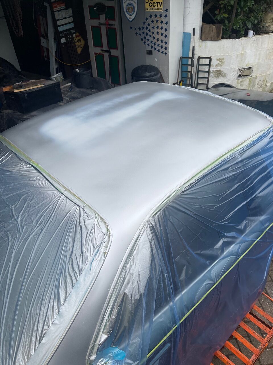

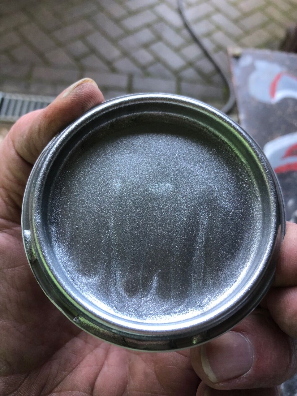

Remember the silver paint and rattle cans that I bought last week?
Wednesday was 16’C outside for a short while. Opportunities ehhh?
Took some 600 grit to the roof. Got old damage sanded back, removed silicone above the front windscreen,  paint hates silicone.
Cleaned off, masked car, panel wiped, mixed paint and painted it by 3.30pm with a gun.
Big mistake? Well, yes and no.
More work generated.
The wind (breeze)  blew up plastic onto the C-pillar wet paint. So I fixed it too good with more paint 😉 So I will have to fix it differently with some lowrider paint technique.
After 4.30pm the temperature dropped enough to make some of the silver paint react on the roof. I will have to repaint that.
The total cost of paint, cans and mixing cups was under £50.00 or $52.00
500ml of Silver paint was £38.00 including tax.
I used 250ml with 20% thinners/reducer.
Pictures below.
VIDEO:

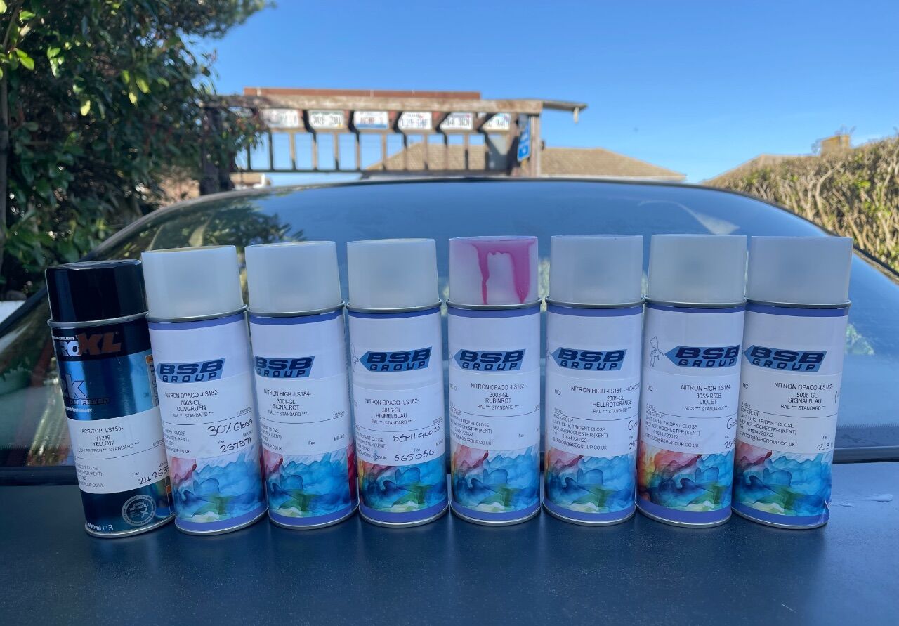

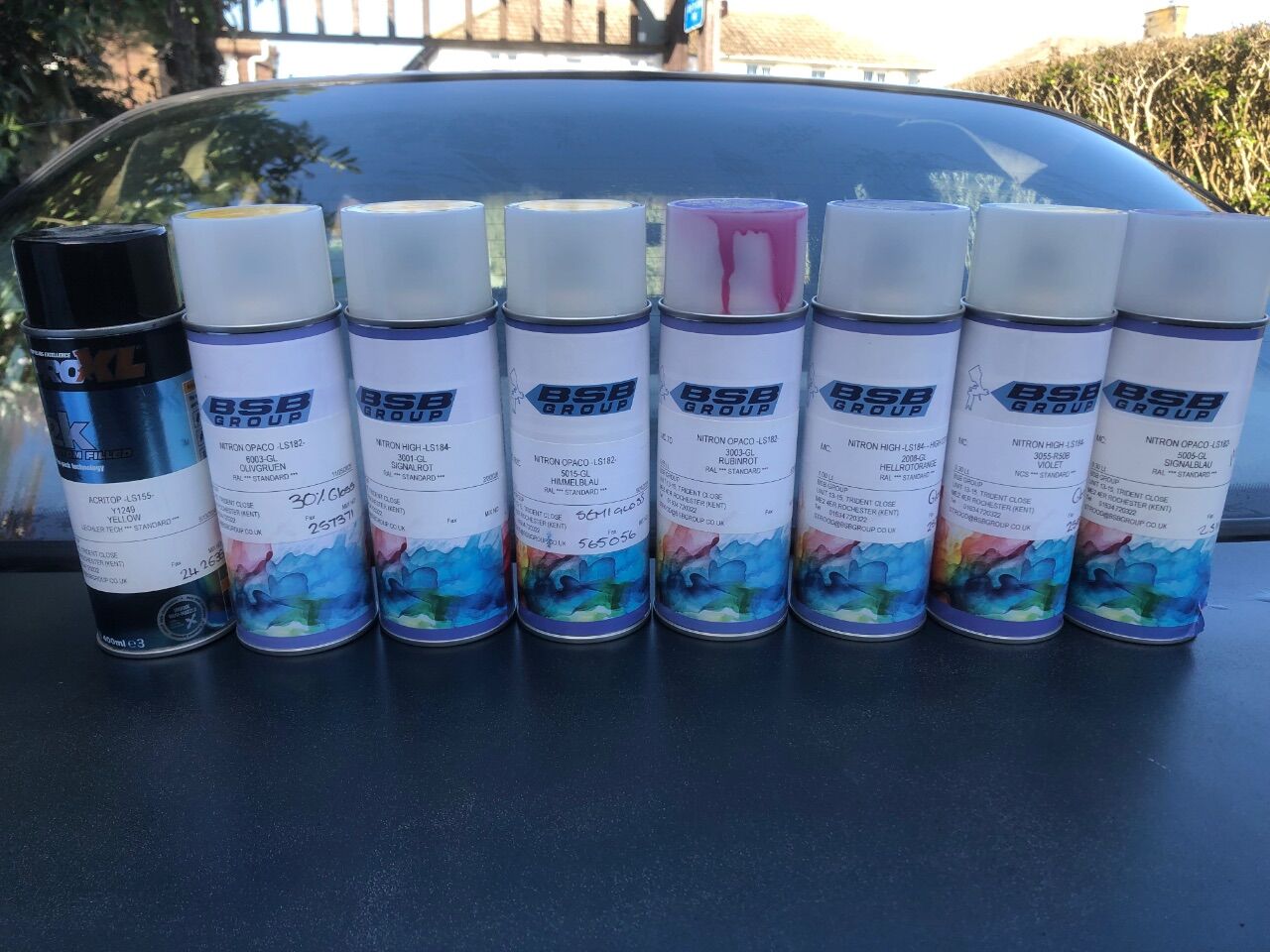

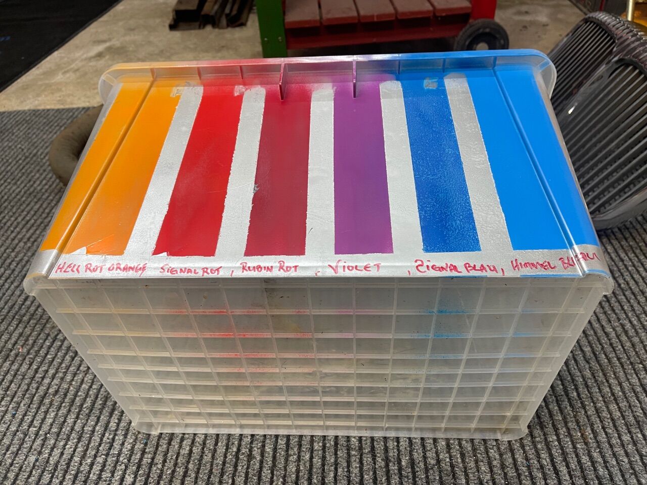

On Thursday, Kevin came around to visit.
I wanted to check what colours the rattle cans were, so created a Silver backdrop, masked some bands to show silver contrasting stripes. Thanks to Kevin suggesting that I should do that.
So now I know what’s in the cans.
I will probably use some of them for the lace painting too.
After all I have already paid for them.
The first 6 colours are definitely useable for this paint project. That last two are lovely Olive green and a cammo desert sand colour. I will use them another day.
Next day unmasked and colour palette created.
