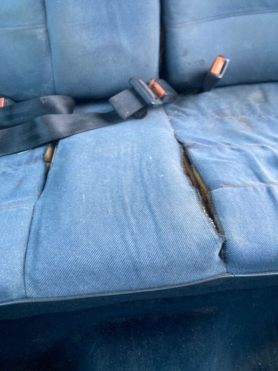

Drivers seat is knackered and so is the backseat.

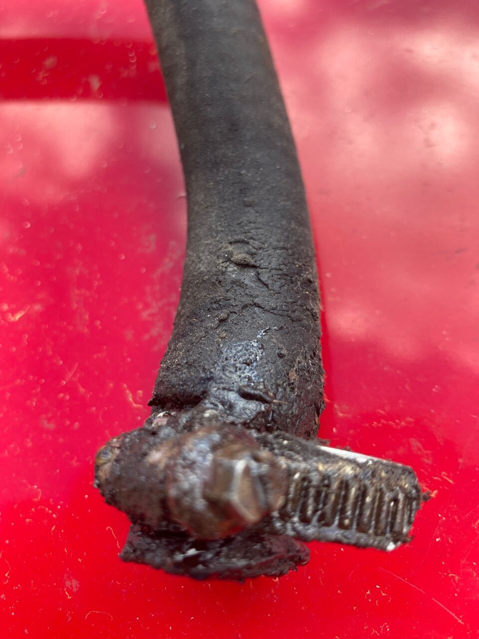

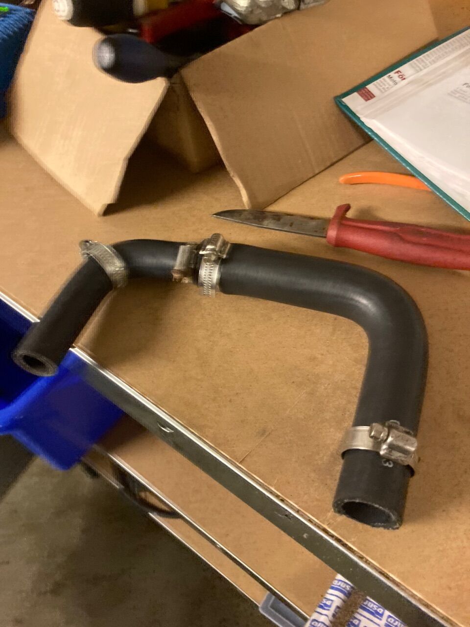

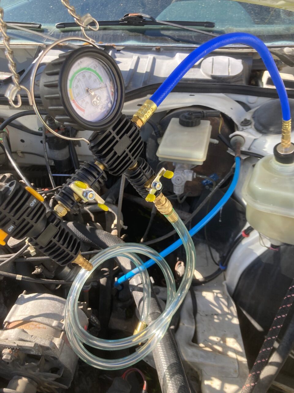

Audi 100 1,8 Avant: Quite a productive day today. The previous owner told me that after changing the timing belt and doing some stuff with the cooling system he had overheating issues. I know that these engines are notoriously hard to bleed so I thought I would try to vacuum fill the cooling system.
This took some time because I found issues with a couple of hoses. One disintegrated when I touched it, another one was leaking.
I fixed the leaks with som universal hoses. Filled the cooling system and tomorrow I will see if it still overheats. There are no signs of a failed head gasket. No oil in the coolant and no coolant in the oil. The car smokes but it looks blue to me. Tomorrow I will check the spark plugs and see what they can tell me.

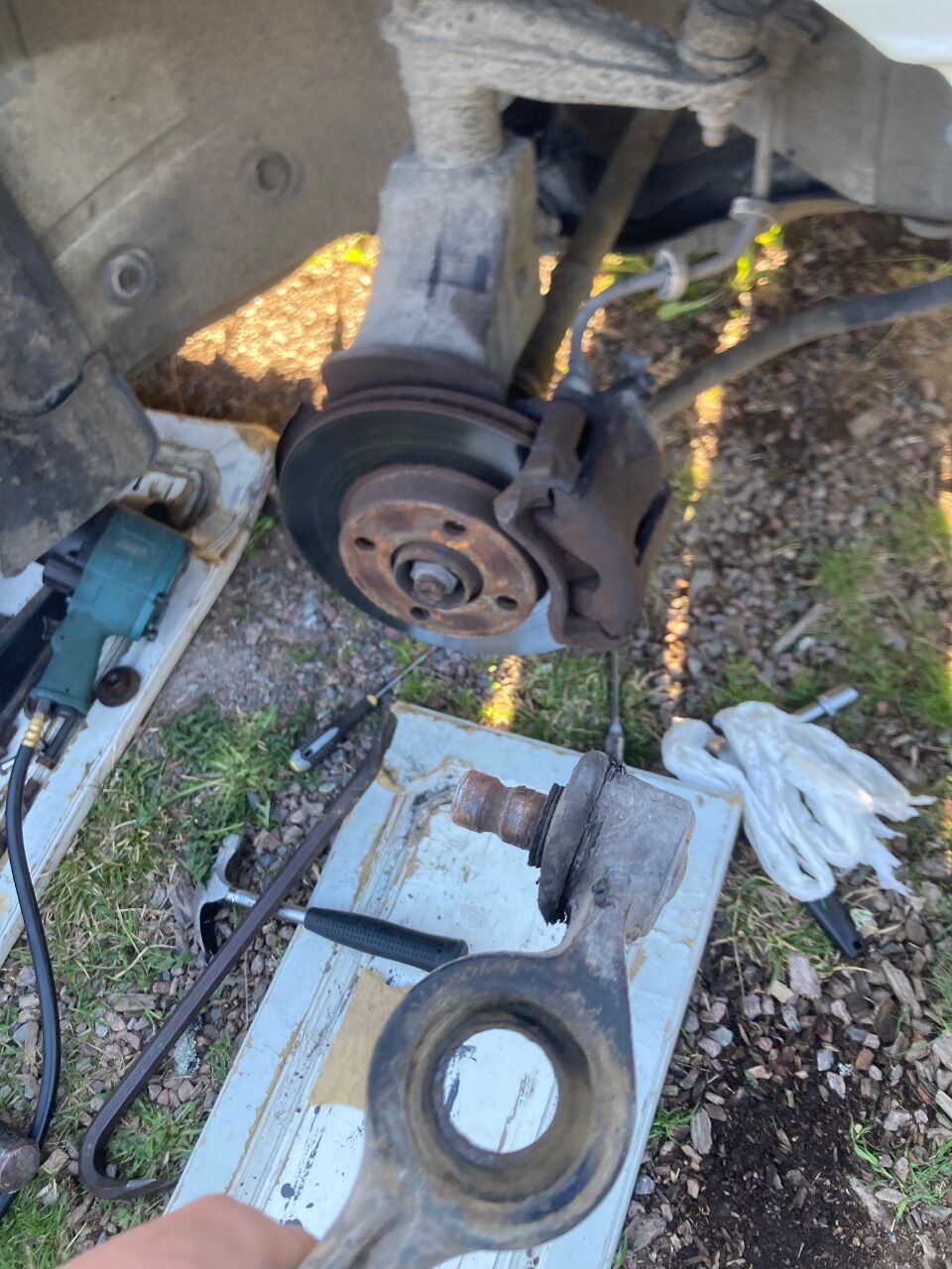

So after that I continued with the knackered ball joint. You can’t change just the ball joint, instead you change the complete arm. I’ve done it 4 times the past 12 months so it went relatively smooth. It was done in about two hours.

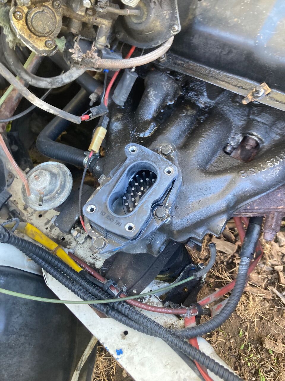

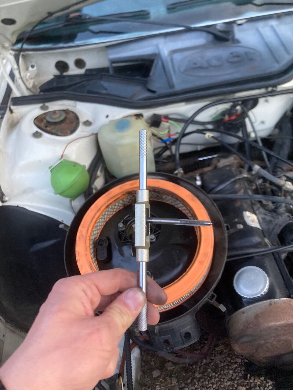

Then I had a bit of disaster. Checking why the air filter was loose I found this sleeve (or whatever you call it) in the carburettor.
Just pure luck that it got stuck, but where is the nut? 😱 I’m not sure I want to know 😱
All the bolts that hold the air filter was loose and the threads in the carburettor was stripped. I can buy a new carburettor but for the same price I can get around 5 second hand ones. So I think I buy a couple of used ones. Maybe i try to re-thread the carburettor.

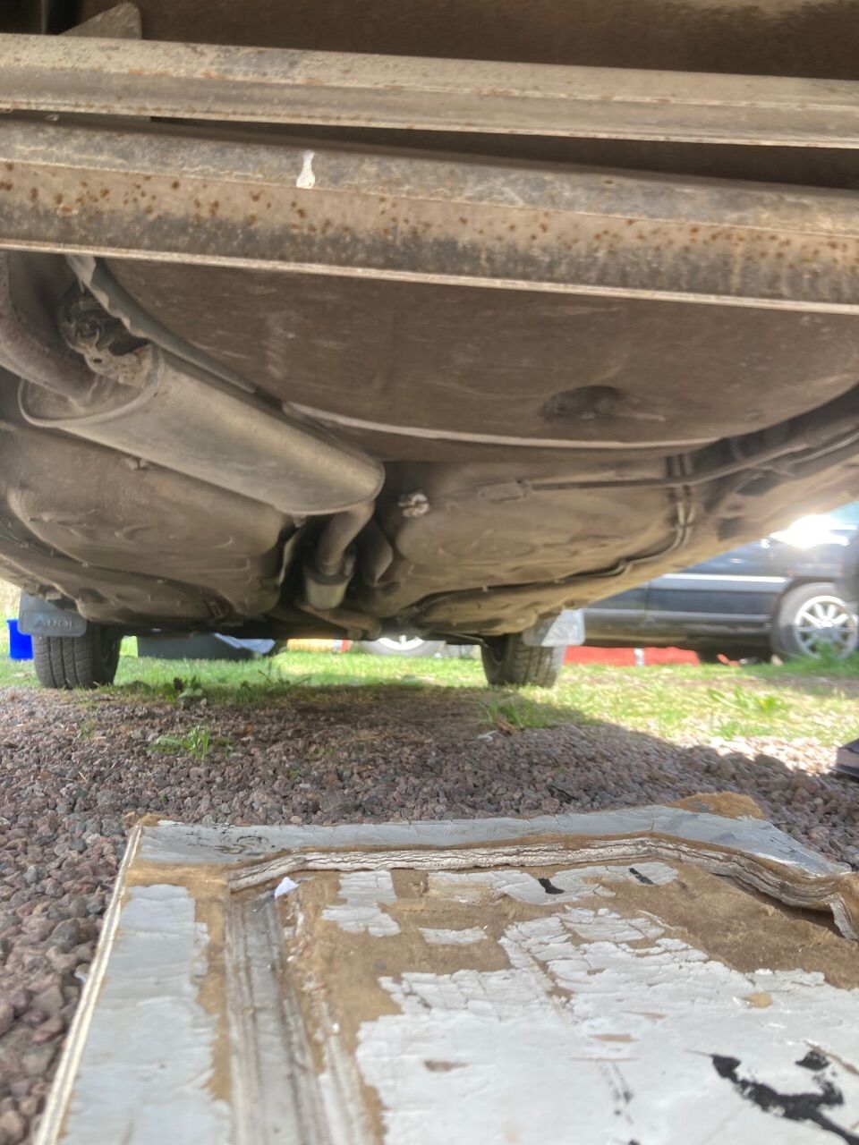

Audi 100 1,8: I also managed to change the last part of the exhaust system. Really simple operation, took like 10 minutes. IMG_5810.jpeg.1b675070f66ca900f110a33b02a78998.jpeg
Here is a picture on the underside of the car. Between 1994 to around 2022 it spent it’s life in a salt free environment.

I also tried to clean up the threads in the carburettor that holds the air filter , nope not even close. The threads are completely destroyed. So I ordered a second hand carburettor. IMG_5822.jpeg.56037552c85ad06cb102b18cedb45176.jpeg

Not uncommon on these engines. I did spray starter fluid on the carb mounting and the engine reacted immediately so I will order a new one.

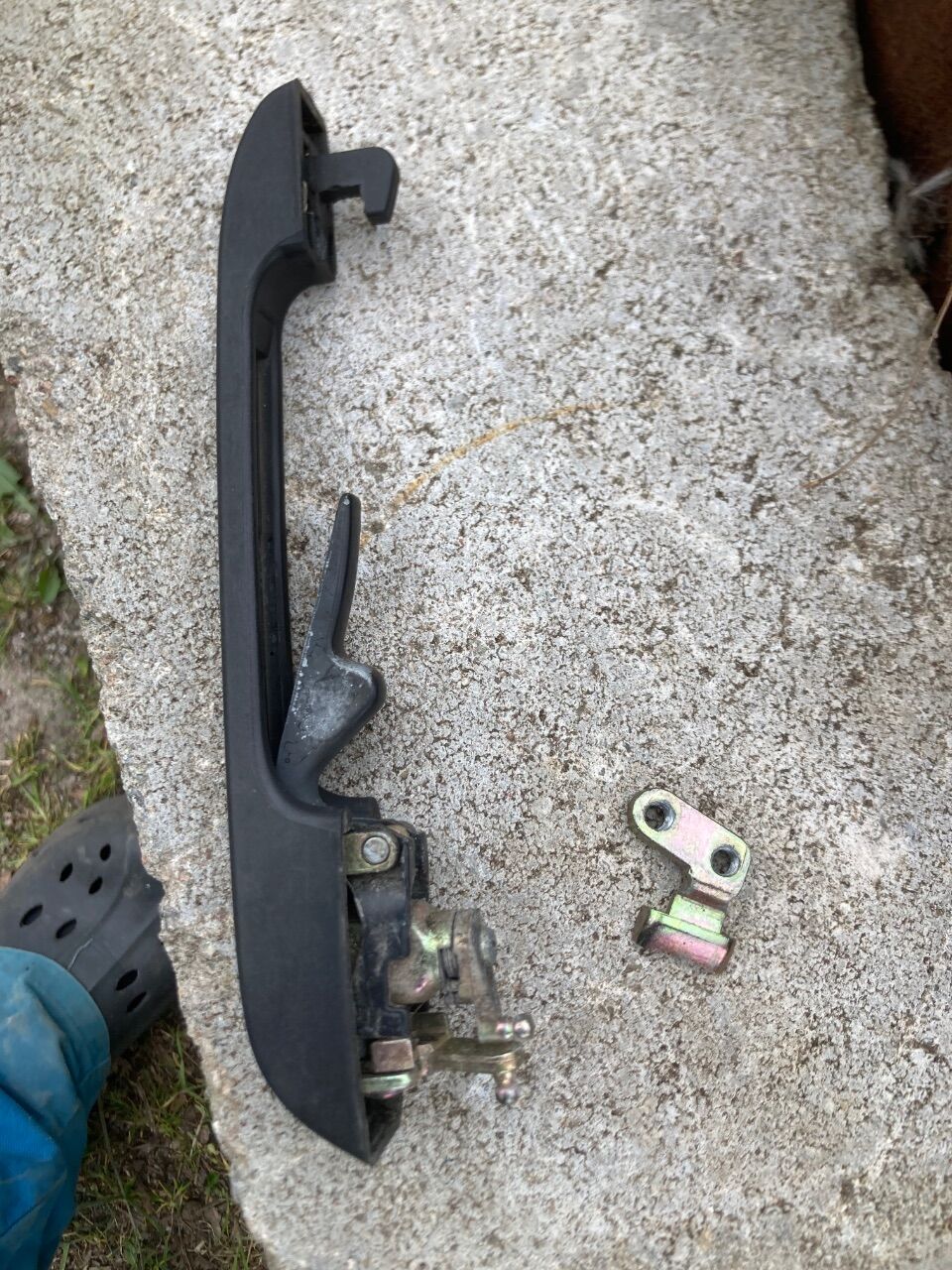

Audi 100 2,3E: new door lock fitted as the old one broke. Quite straight forward job and I had the cat to keep me company. Used this car as my daily for a week until I started to hear a knocking sound when at full lock. Drive shaft boot had gone bad and all the grease had disappeared… just great!

Audi 100 1,8 Avant; second hand carburettor fitted together with a new carburettor mounting plate. The car now runs better and worse at the same time. Better att low load on low revs but I don’t think that the seconds stage kicks in on full throttle and it still has a misfire on lower revs that I will have to adress.  Also changed a couple of badly corroded spark plug wires but that didn’t do anything. Main thing with the carburettor swap was to get a carburettor with fresh threads för the air filter and that was achieved 👍

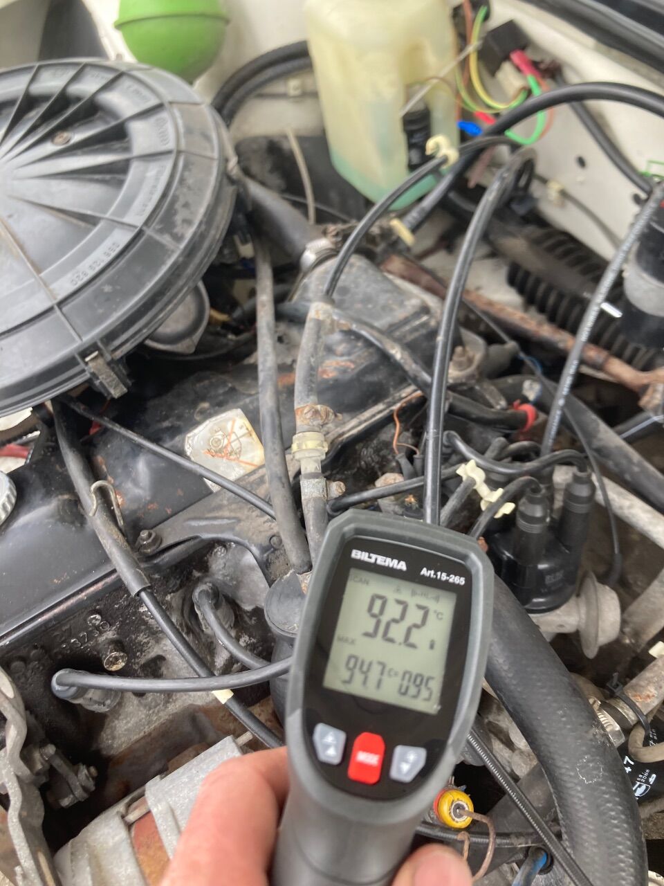

The strange behaviour of the temperature gauge seems to be down to an electrical problem. Temperatures measured just fine with an IR thermometer. 92 degrees with the engine just turned off is fine by me. Temperature down at the thermostat housing was around 87 degrees with the engine still running.

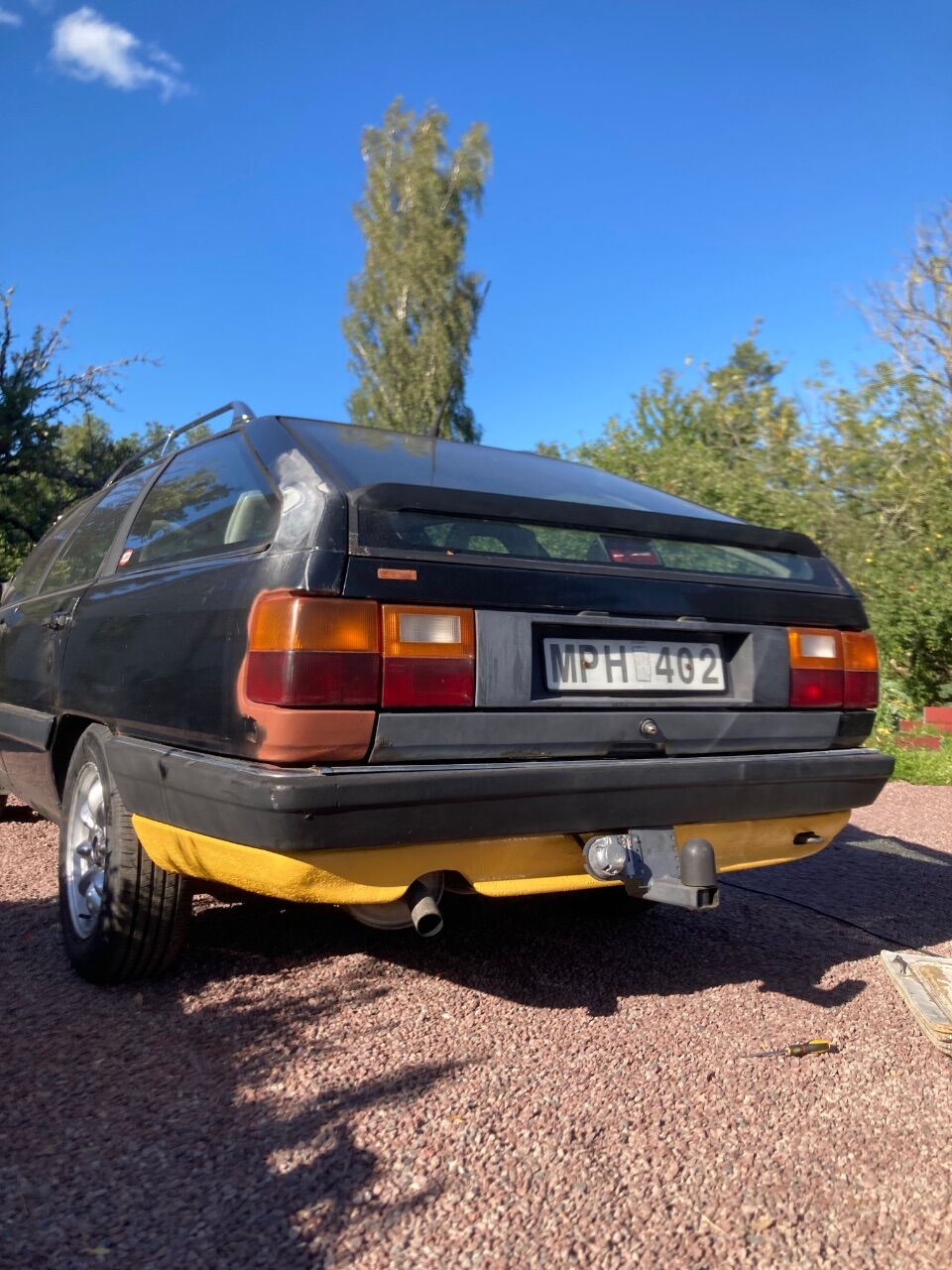

Audi 100 2,2 1984 went on its final journey and when I saw the car getting loaded I realised that I should have saved the rear bumper… IMG_6065.jpeg.8b5237168b87c1140b4ff48e0173fcb7.jpegIMG_6064.jpeg.724276a7fefb10552cf2992af98e1ae9.jpeg
Audi 100 1,8 Avant: I have sorted the misfire issues. It was as easy as changing the distributor, rotor and spark plug wires.  Spark plugs looked fine so they stayed. Also changed the steering wheel to a nice one from the  2,2. To celebrate the smooth running I gave the car a top speed test. After quite a while with my foot firmly planted to the floor i reached an indicated speed of 87 mph (140 km/h). So my suspicion that the vacuum controlled second stage doesn’t kick in is probably confirmed. The car thanked me shortly afterwards by blowing a hole in a coolant hose…

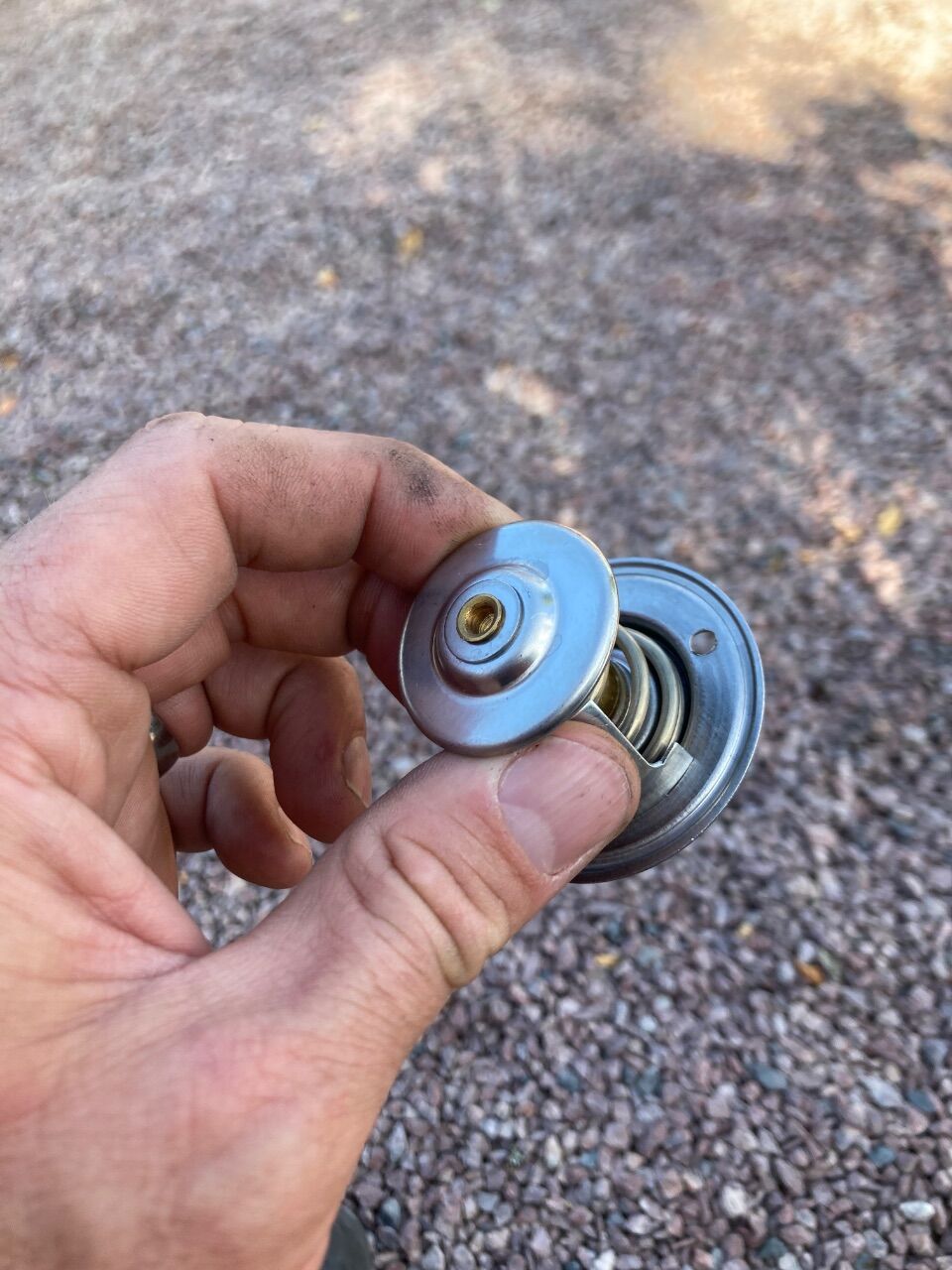

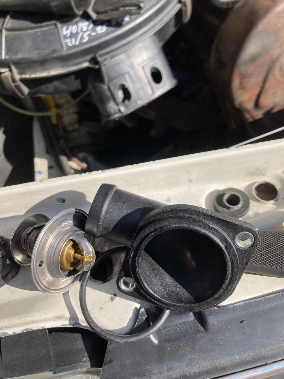

Audi 100 1,8 Avant got a new thermostat housing. The old one was leaking and looked quite sad, at the same time i changed the thermostat. Drilled a small hole in the thermostat because some random dude on YouTube said it makes bleeding so much easier. IMG_6275.jpeg.06673c1b980bb64705b4bd55cfe447bb.jpegAlso I found out why the second stage on the carburettor didn’t kick in. When I changed the carburettor I had made a mistake with the clip that holds the throttle wire. So I could not get full throttle and therefore the second stage wouldn’t open. Still not shure about the condition of the vacuum membrane but the car is a little bit quicker. No pictures as this mistake was quite embarrassing…

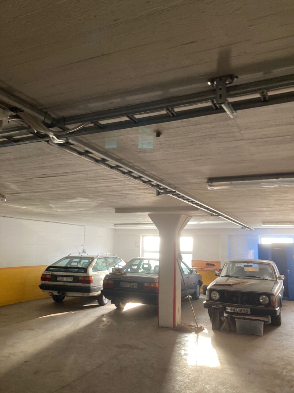

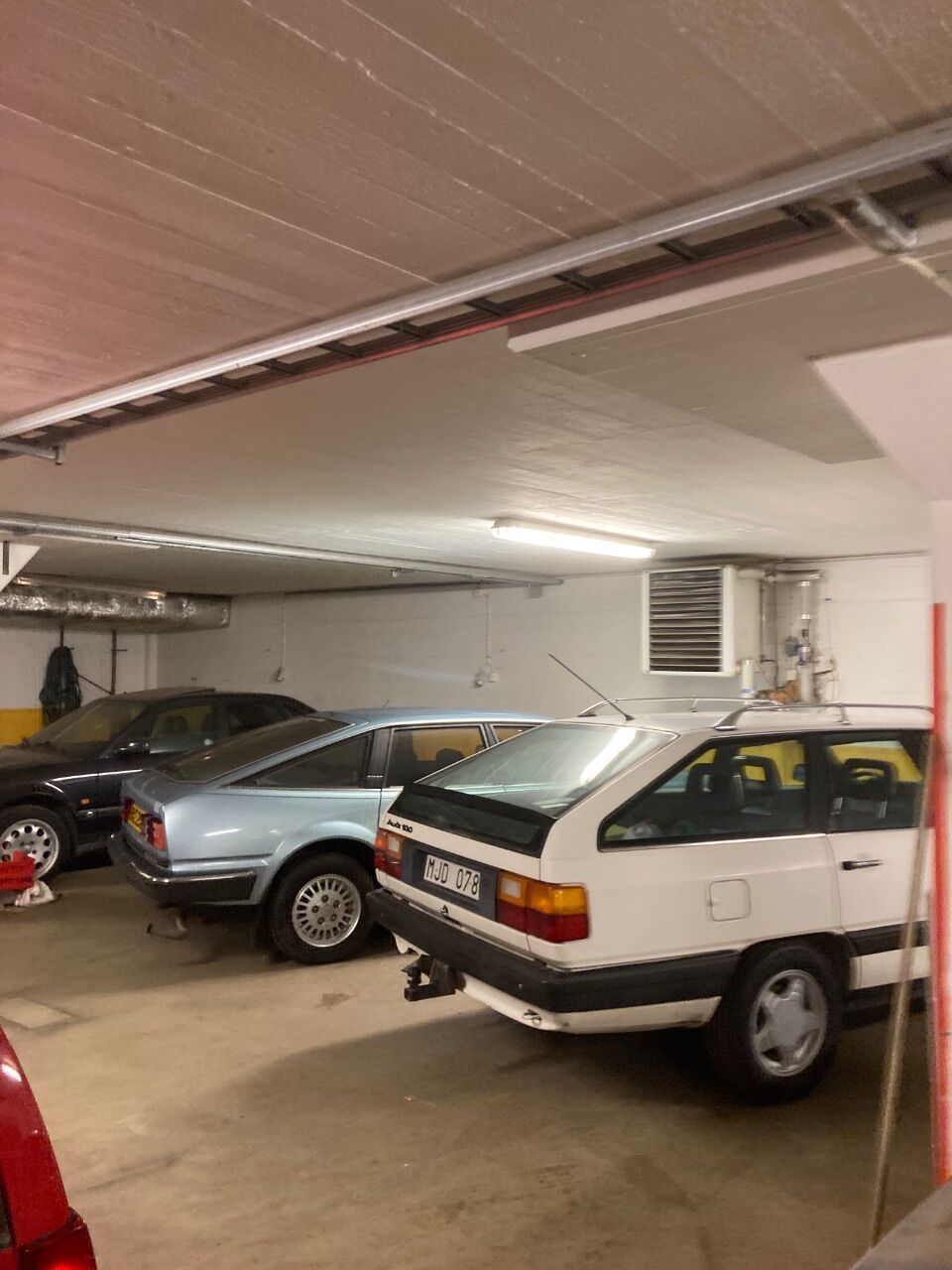

Finally som late news, lost my storage space in May that i rented for the Diesel. Advertised online and managed to score more than twice the space for the same amount of money. My neighbours Volvo has a Chevy small block by the way.IMG_6316.jpeg.13e7a0df9f8b1d82e4938b841d182a2c.jpeg
Wow! Are you going yellow? Bold!
That looks like a nice storage!

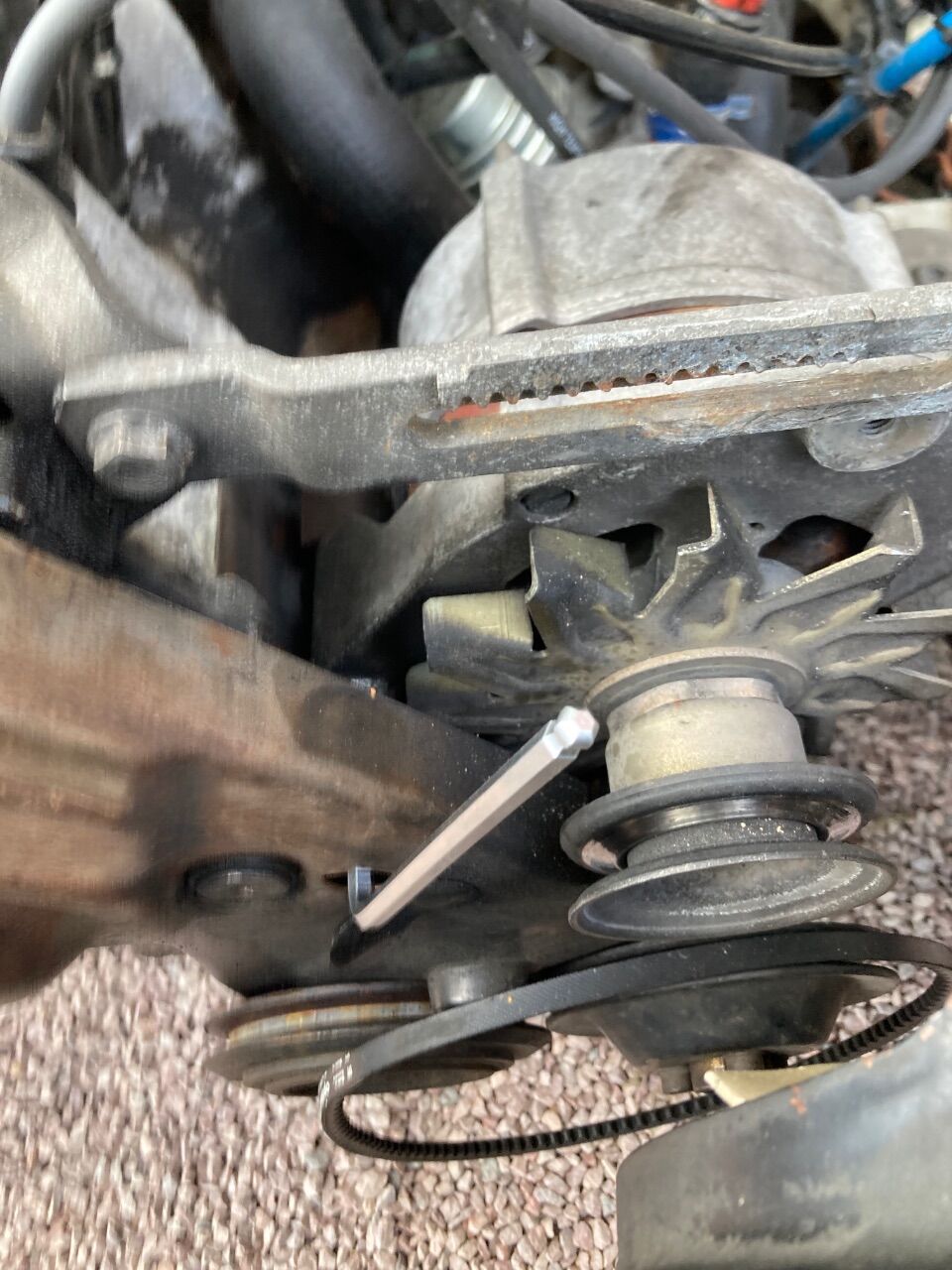

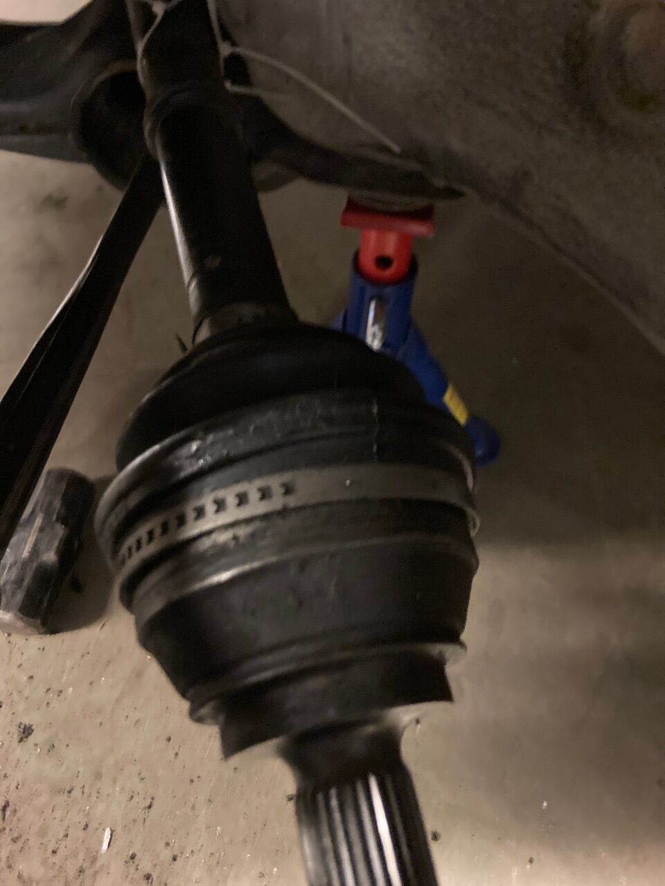

First fail is about the Audi 100 Turbodiesel. Read up on the flickering charging light and most said the same thing: the carbon brushes. So I ordered a new set complete with voltage regulator. Easy job to change but no difference. Still a flickering charging light. Well there was one difference, charging voltage i now down to 12,8 volts 🤯🤯🤯 The generator I drenched in oil from a newly developed oil leak, can this be the cause of the problem???
Second fail was a high pitched bearing noise from the Audi 100 1,8 Avant. Not of the belt screaming type but it’s quite loud when the engine is hot. I removed the belt to the generator and water pump and the engine was suddenly silent. upon examination I found quite a large bearing play in the generator. I decided that a second hand generator from the local scrapyard was just what the doctor ordered. No, not even close. Sound is still there. Water pump or maybe the cambelt tensioner. The later is still considered a possibility even though the sound stopped when I removed the belt.

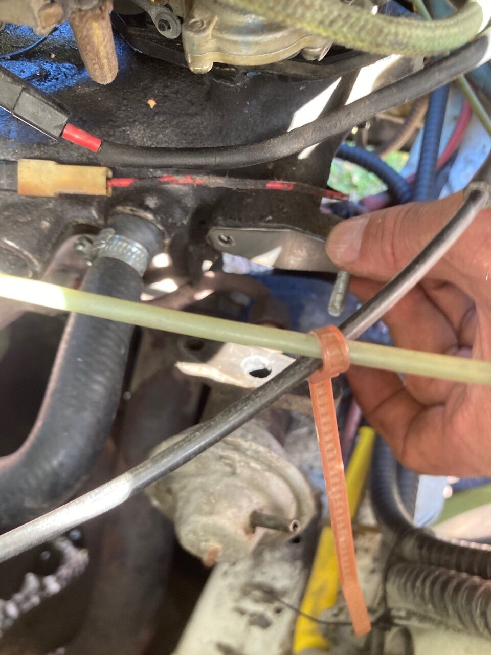

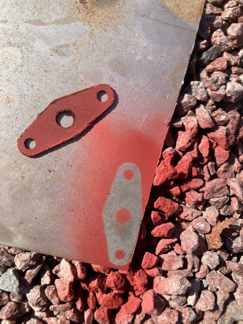

Fourth fail was me spending an entire Sunday searching for why the 1,8 Avant runs really bad on engine brake and on low load. Got a lot of good advices on a Swedish Audi 100 Facebook group, so I went to work full of confidence. Things went really well, I found a broken vacuum hose, did an EGR delete, found more suspicious vacuum hoses and changed a leaking membrane on the carburettor. After all this work I started the engine in what I thought was about to be absolute triumph. I was soon taken down too earth again… 🤯🤯🤯
Making a template for an EGR blocking plate with the help of an old gasket. It was a perfect fit.
This is the substitute for the leaking vacuum membrane, sourced from the old carburettor.

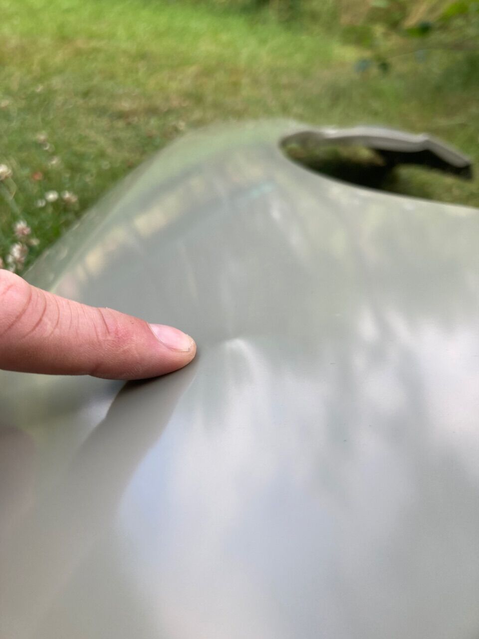

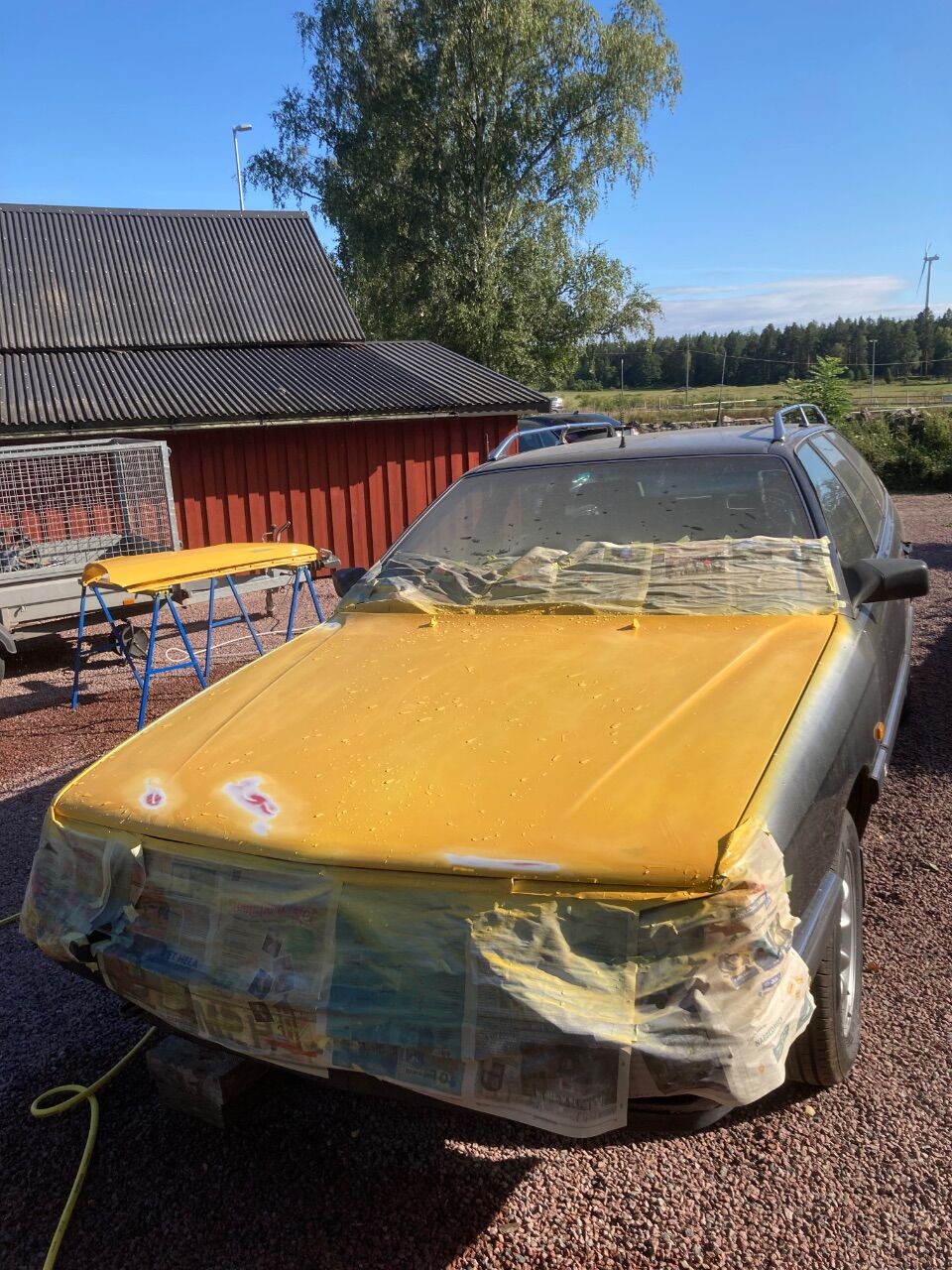

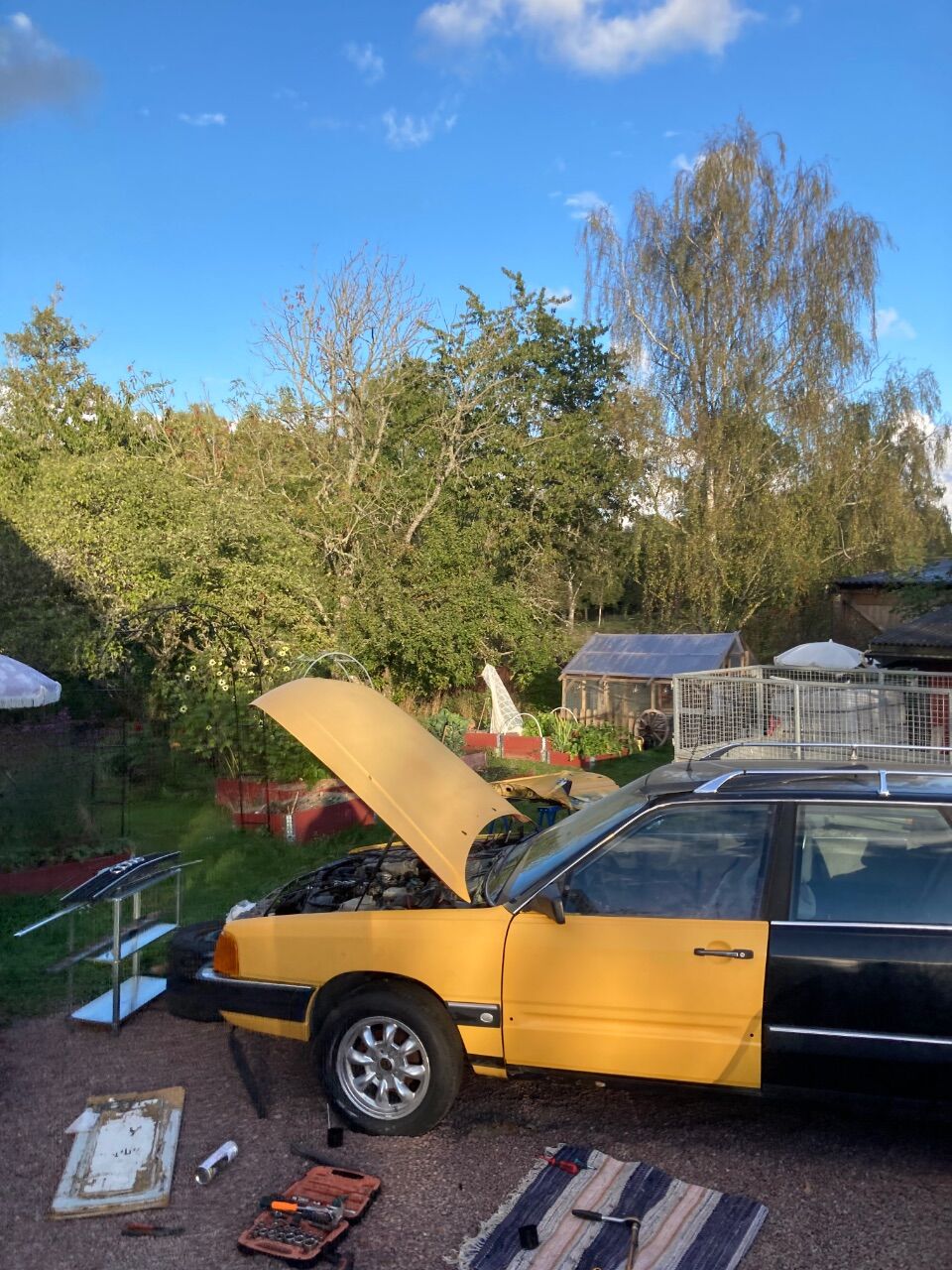

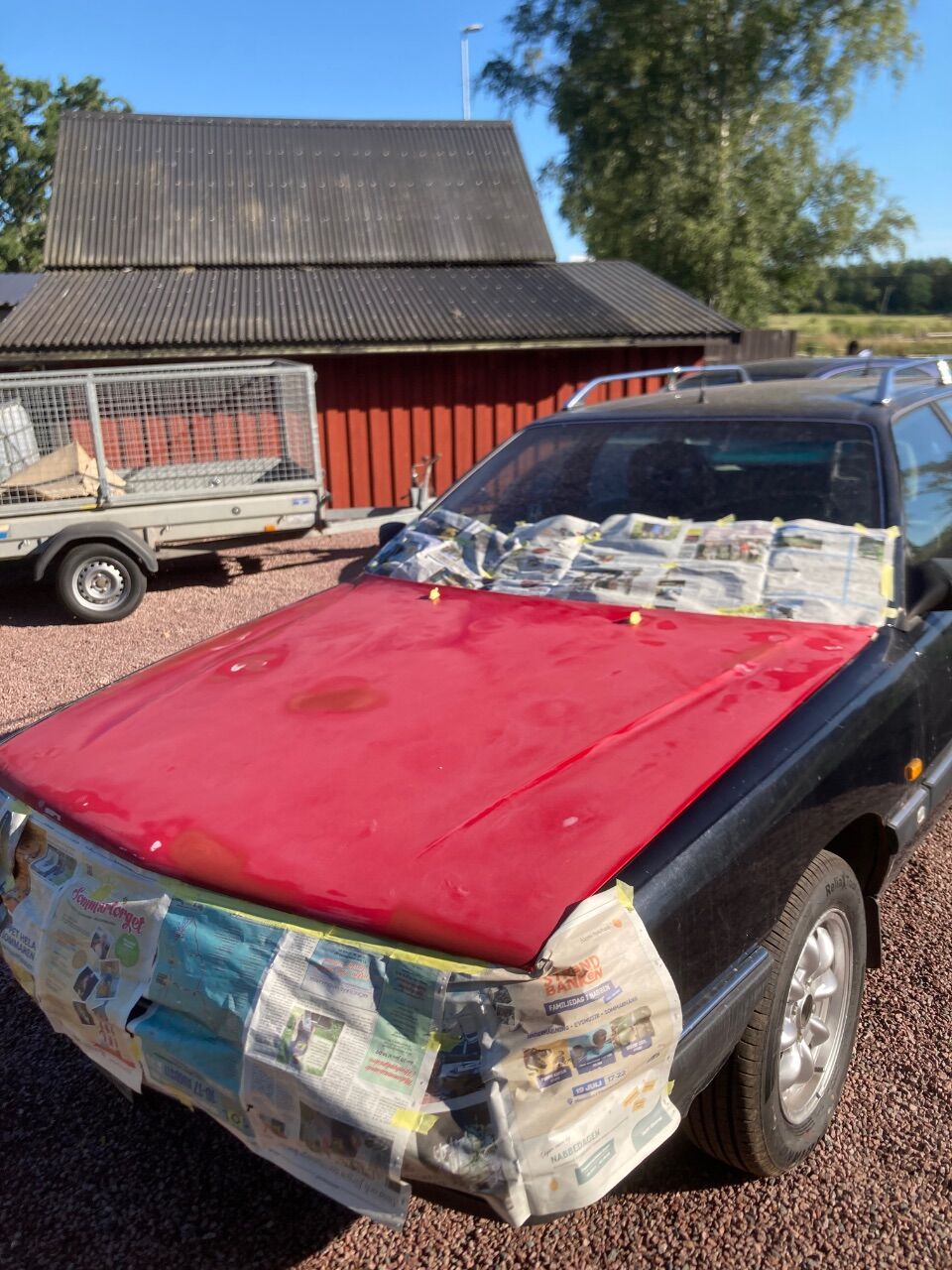

The only success was me continuing the process of making the Turbo diesel yellow. Here’s some pictures during that process. I’m not looking for a show winning finish, looks good from two meters away is more what I’m going for.
Epoxi primer.
I mixed the paint the first coat to thin so i got some paint runs. Second coat went on fine but I don’t have any pictures of that.
Brush was used on the lower part of the car.

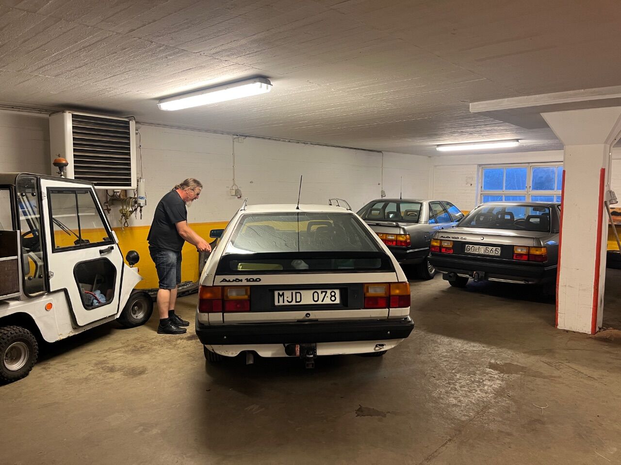

I’ve just visited @Nibbler and had a look at his Audi 100 collection. IMG_6363.jpeg.02979e772bc6727155d4cc492327ca7e.jpeg
One happy 100 owner heading for a hundred of them.
