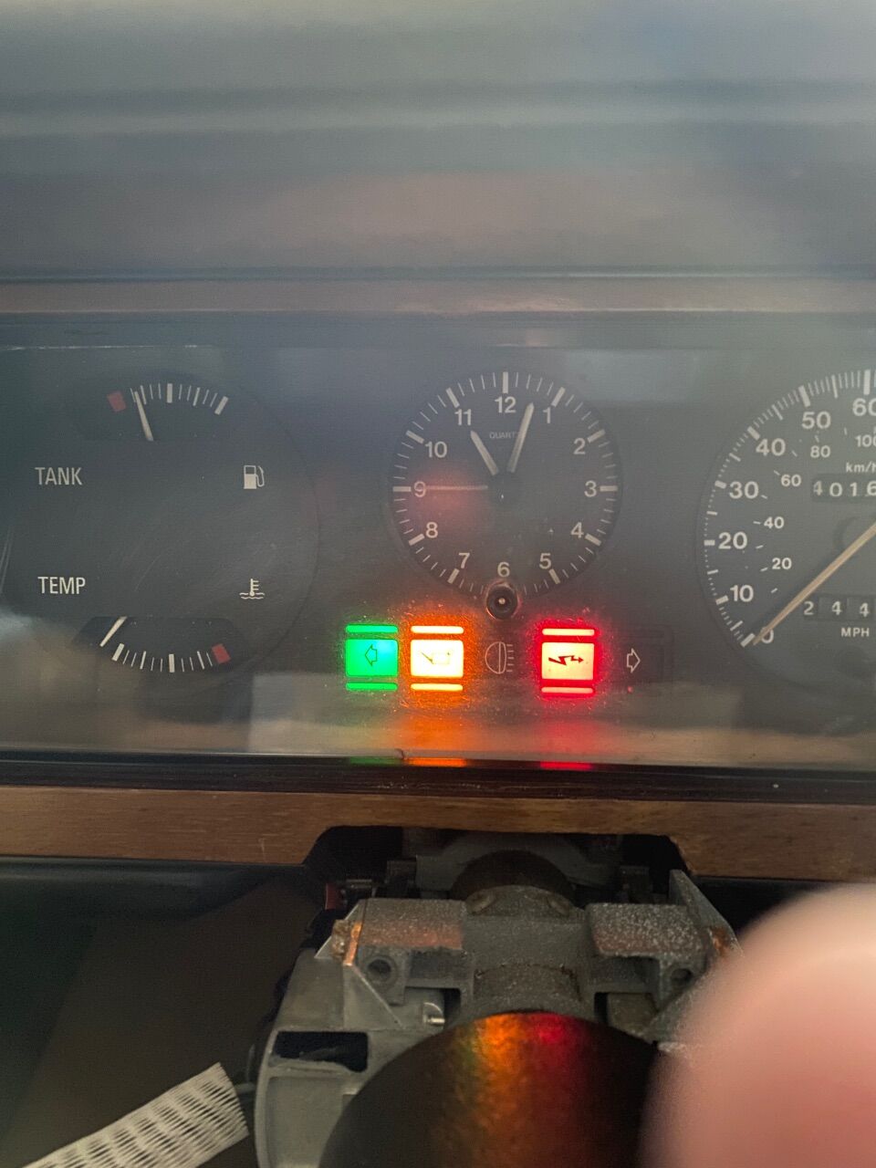

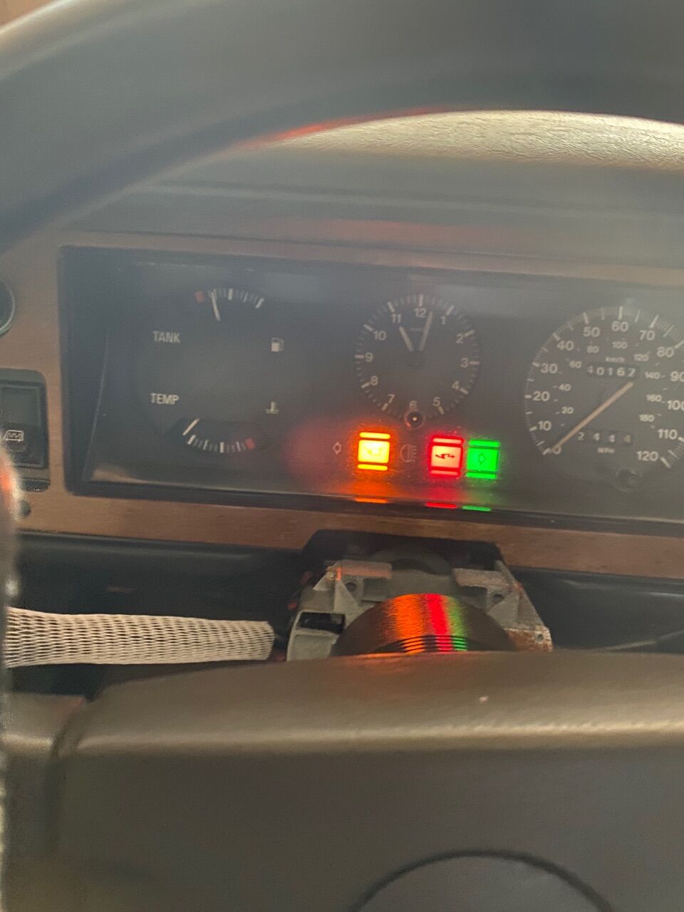

Wibble Posted Sunday at 15:32 Author Posted Sunday at 15:32 Freddy and I have been having fun* prepping the Cortina for tomorrow night. It’s parked in the garage, with passenger side right against the wall, so all bar that side is now clean and shiny and glass cleaned inside and out. However, we still have no indicators but do have hazards. I’m sure it’s the switch and I have a new one which I’ll swap over this evening. Staying with lights, we have dipped and main beam but no side or tail lights. We do have brake lights though and as it will be daylight, as long as we can get indicators working, I’m happy to go anyway. Freddy has also been round it with a fine brush and some paint, touching in little bits that will need doing properly at some point. Might have to give it a blast of ozone to tonight too, smells a bit musty. I’ll report back later on results of indicator stalk swap. Popsicle, Dyslexic Viking, Shite Ron and 7 others 10

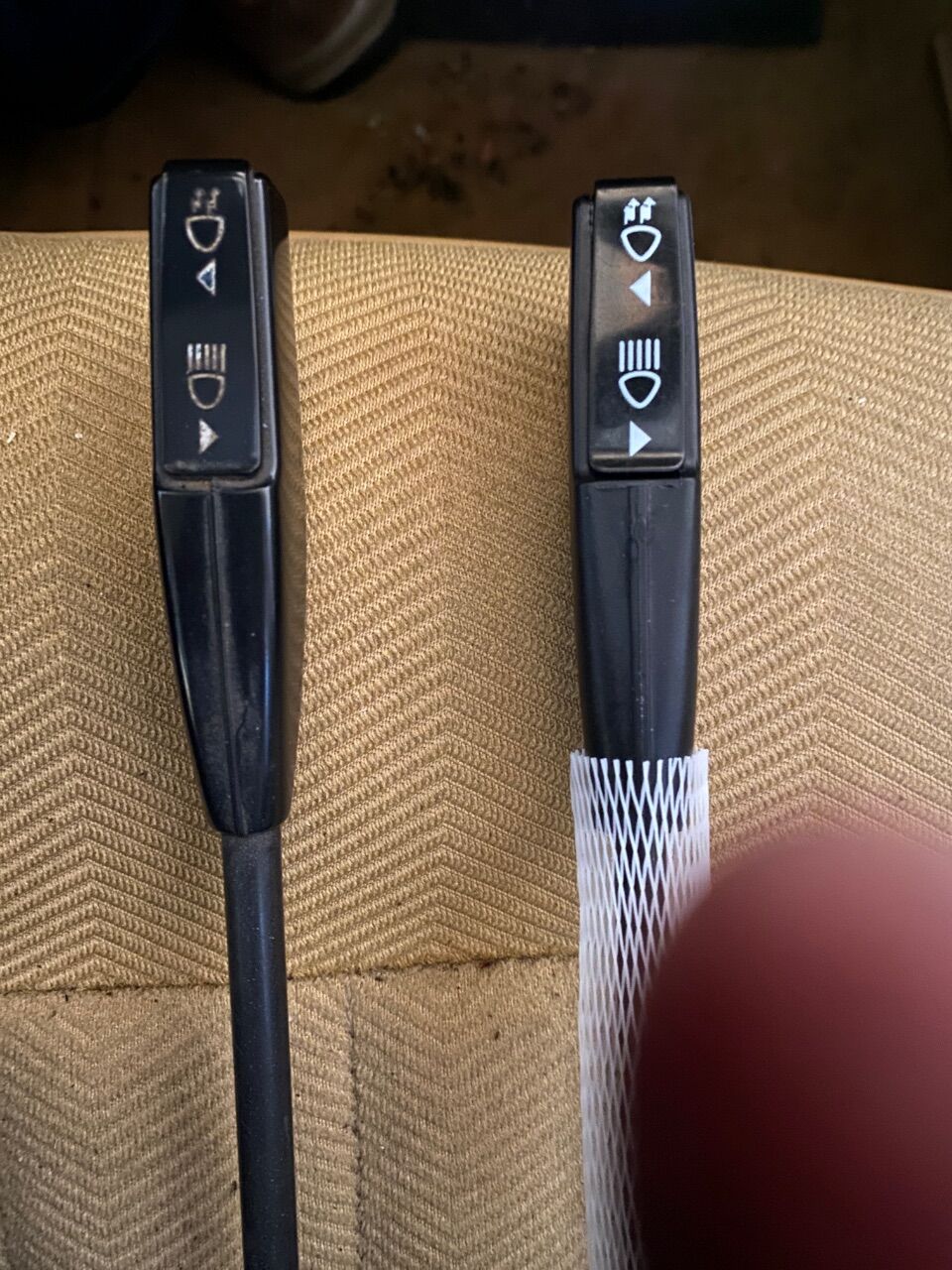

Wibble Posted Sunday at 18:06 Author Posted Sunday at 18:06 Spot the difference: Why so many more pins? No idea but it works: Looks like we’re good to go, subject to final fettling tomorrow🤞 Tickman, mercedade, Matty and 16 others 17 2
High Jetter Posted Sunday at 18:23 Posted Sunday at 18:23 16 minutes ago, Wibble said: Why so many more pins? No idea but it works: Had the missing pins become detached in the old switch at some time?
Snake Charmer Posted Sunday at 18:31 Posted Sunday at 18:31 Hope this goes off according to plan for you. 👍 Wibble 1
Wibble Posted Sunday at 18:47 Author Posted Sunday at 18:47 18 minutes ago, High Jetter said: Had the missing pins become detached in the old switch at some time? Nope, it all worked fine last year, left , right, flash, main beam and horn. There are two badly soldered wires on the new one too, as in the photo, which the original doesn’t have. The wiring plug connected easily too, so no idea but it all works so I won’t dwell on it, just a bit of a mystery. High Jetter 1
