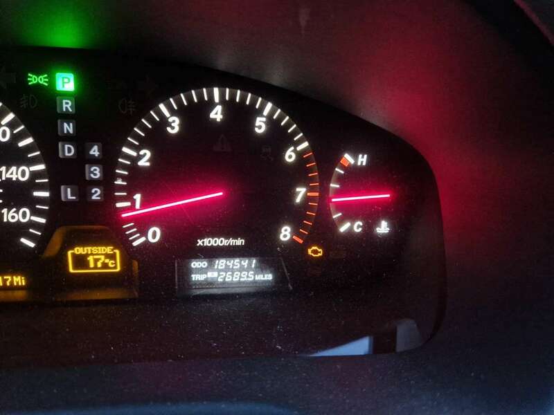

The final score on the door:
I forgot to reset the trip counter on the way out, and so its only counted up from calais on the outbound route. I reckon we've done just over 3,000 miles in total.

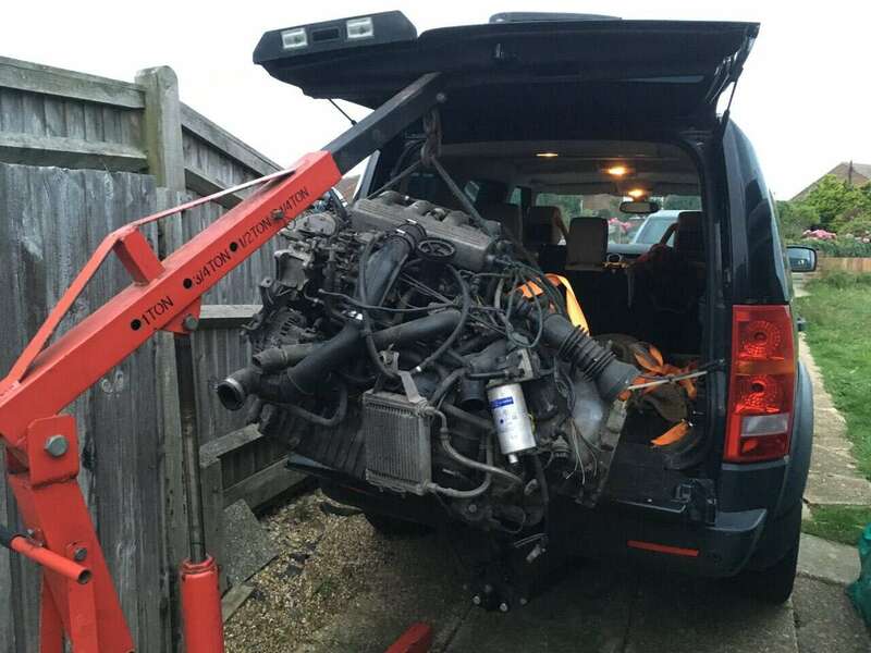

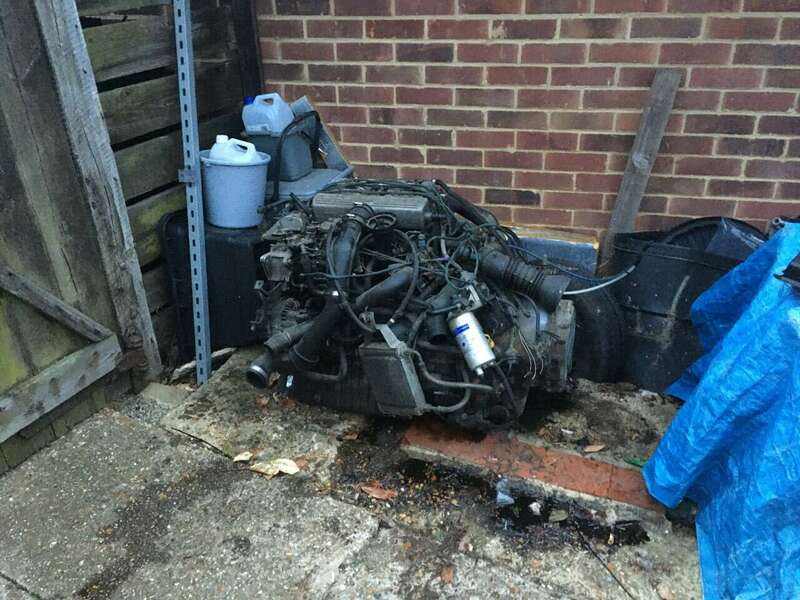

Cast your minds back to when I collected the XM, and I also brought home a spare engine and gear box with them. They’ve spent a fair amount of time sat in the back of the landy and tonight I decided it was time to unload the Disco so that I can use it for stuff.
Target home for the engine:
Car shunting to make room for the engine crane:
Things you shouldn’t put in the back of a car you want to keep clean #127:
Danger mode activated:
And after a lot of swearing, it’s in its new home:
I definitely didn’t* spill loads of ATF all over the driveway.

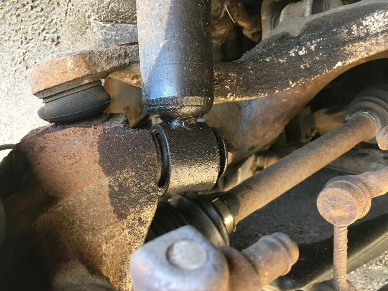

The front suspension is getting noisier by the day so I need to get under there and have a poke around at some point and work out what's borked. It went through the MOT without issue so I'm fairly confident the front end isn't about to fall off, but it's definitely not right.

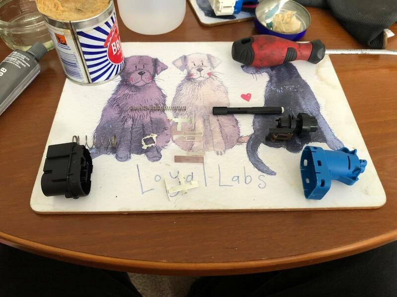

LS430: I ordered some replacement parking sensors from China, and so on the day they arrived the air suspension went into arse dragging mode...
A couple of hundred quid later and I have a quality* used item. Looks right to me:
Phail:

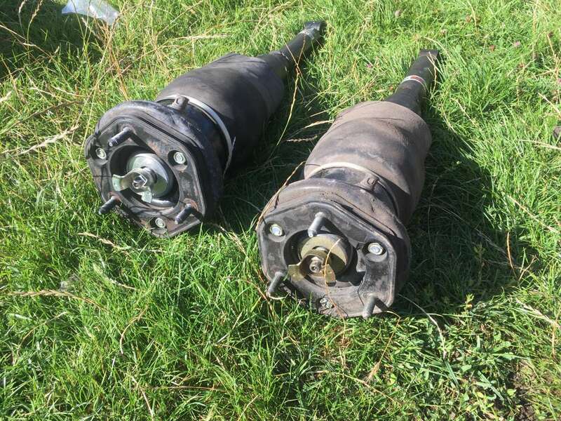

Whilst the Lexus was laid up with a knackered air strut, I did daily the Disco for a bit. Here it is showing solidarity for it's fallen air suspension comrade, with an arse up face down salute.
Apparently this is due to the replacement compressor not being the right one or something, and needs coding out. It settles by the end of the road so it's somewhat on the 'at another time' list.
It's really not good when you're counting on a Land Rover as your backup daily 😅 It is a nice place to be though, so we'll forgive its faults. I need to do some maintenance work on it soon, the drive belt and tensioners need replacing by the sounds of it and I don't think it would do any harm to change the oil and filters as I have no record of when they were last done. Cam belt roulette is obviously on the go as well, so I should think about that soon.

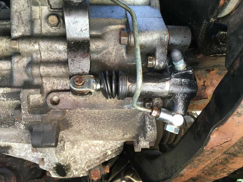

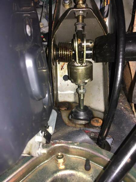

New clutch slave fitted:
Biting point is still in the floor. Bollocks. Need to have a look and see if there's something painfully obvious that I've missed, such as bleeding the master cylinder...

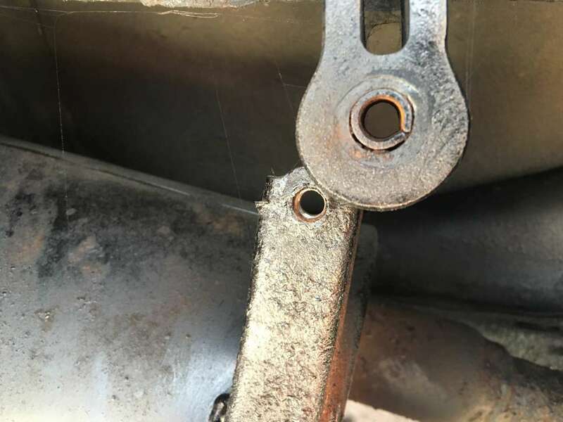

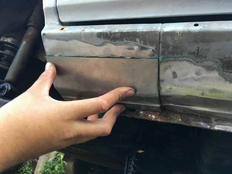

I decided to have a look at the rust then. The offside sill was causing a problem when it was last presented for a ticket, and after removing the plastic and doing some grinding these were my main areas of concern.
I decided to start with the worst bit, but my helper suggested first I procrastinate a little:
A missing bolt from an exhaust hanger was an ideal distraction:
I did desperately look for more simple jobs, but sadly none were found so I had to start on what I was meant to be doing.
I'd been hoping to get away with just making a patch for the outer, but as always there's more to be done. I will repair that inner bracing panel, and I will repair the patch of sill to the right which is also holed. Whilst the surrounding parts were there I made my first patch panel:
Wit a mm or two shaved off that'll drop in nicely, once I've got it adjusted to size I will add the bottom and rear lips to it so that they can be spot welded like the original panel.
Part of me feels like this is overkill and I should have just bodged an MOT style patch on, but knowing that I will likely be selling it on here I wanted to do my best of it to be a long lasting repair.
I suspect I won't get to look at this again until the weekend, but I'll try and keep the momentum up and get it done as I'd really like to run the Proton as a daily for a while. I do really need to move it on though as I'd like to put the money back into other projects as I'm burning through the pot of car money at an alarming rate lately!

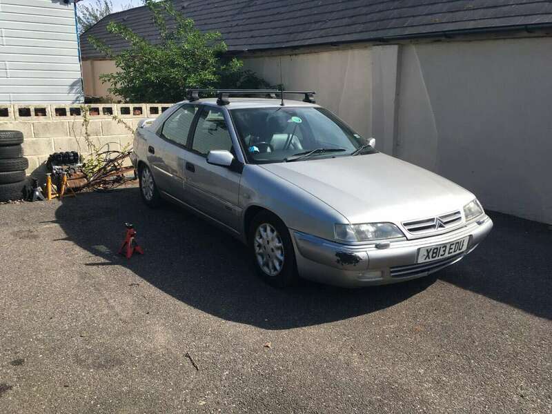

Ken’s Xantia was attacked with a welder and underseal. It’s now booked for a retest Tuesday.

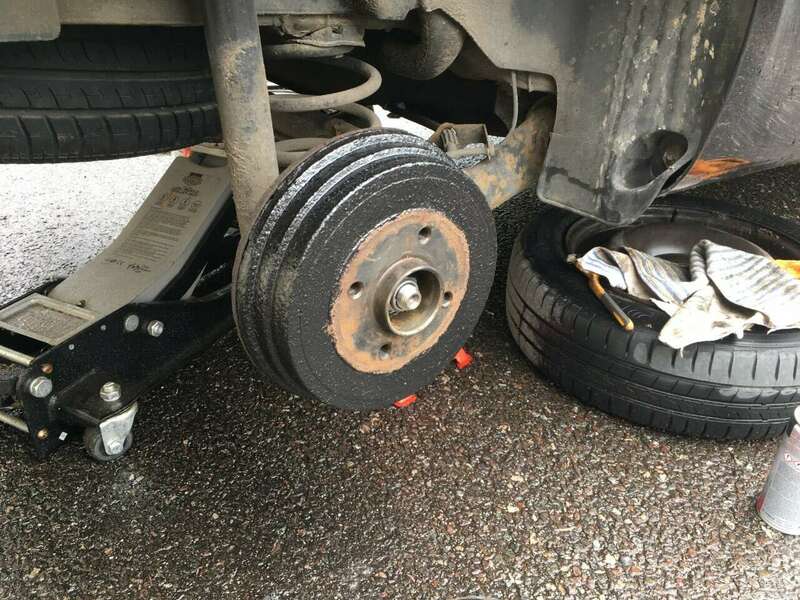

I tackled the rear brakes on the Clio, the last job needed before I sell it.
Yep, they’re done.
New shoes:
Old drums painted with hammerite:
This is where I fucked up. I should’ve bought new drums, but I didn’t realise the drums were such a cunt to adjust on these. There’s no adjustment hole on the drum or back plate, so if they’re lipped you can’t get the adjustment right. I should’ve ground the lips down to get the adjustment right. The brakes and handbrake work but there’s more travel than I would like, so I’ll get to revisit this during the week. I can’t wait…

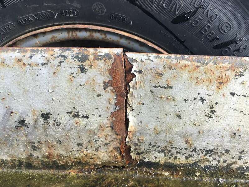

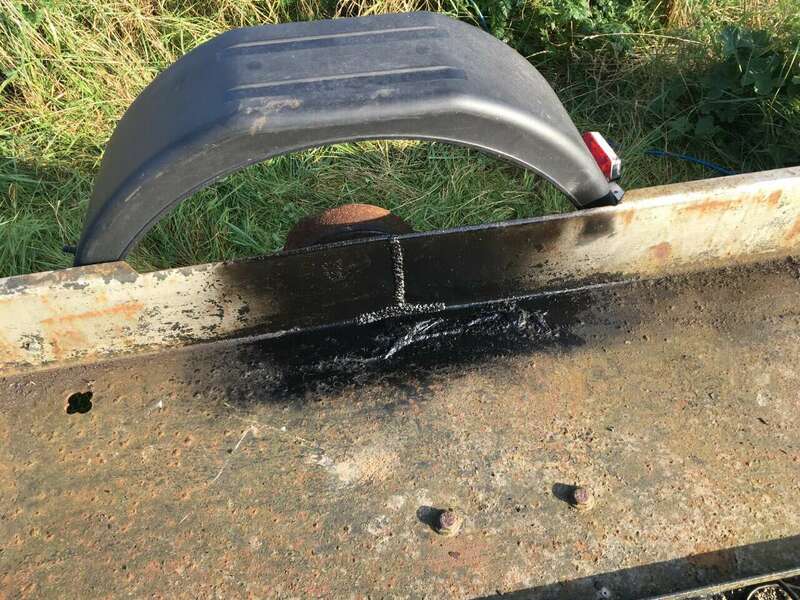

Yesterday’s excitement (bar the welding) was my mum getting pissed off that I couldn’t pick up hay bales as required - when hitching up I found a big bastard crack in the side of one runner:
The amount of movement from me standing on the rear of the trailer was mad. The runner would banana so much that the wheel lifted off the ground. Anyway, to keep the peace I went to sort it today. Note how I didn’t realise how long the cracks were, so I got to drill the end holes twice:
Clamps and a lump hammer provided precision alignment, and then I just started blasting.
Straight enough:
I was giving it some enthusiastic encouragement with a BFH and all the welding stayed put which is encouraging.
Then some structural paint was applied:
It’s like a new trailer, that’s seen decades of use.
It’s solid now at least, the bed isn’t making banana shapes anymore and I’m fairly happy it’s ready for some more use.

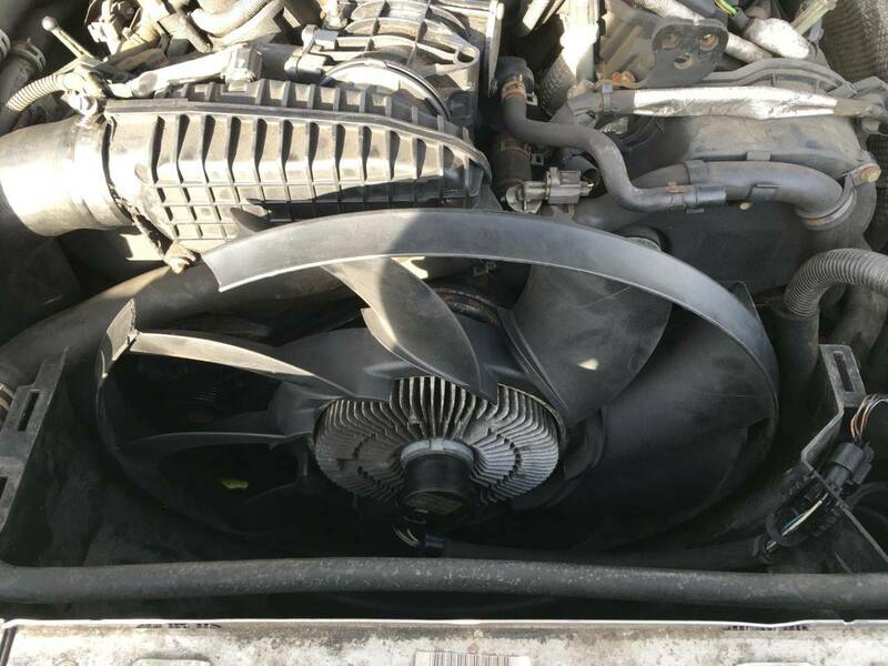

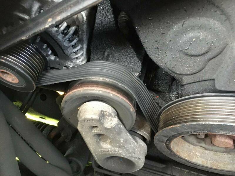

The car which has mainly received my attention is the Disco 3. It had a nasty noise from the drive belt, which sounded like a borked tensioner.
There is an engine under all the dress up:
There's also a broken fan:
That's not we are here for though, so file that under ignore.
The water pump pulley is a wanker and has the bolts in a triangle pattern - my homemade tool is for the square pattern found on everything else I've encountered. Luckily Screfix had a thing that was kind of right for about £25, as the land rover specific tools were pricey and took a week or so for delivery.
A bad fit, a calculated* risk, and somehow nothing got fucked.
Speaking of fucked, here's the tensioner:
Here it is replaced with nice new Chinese shit.
It actually sounds half normal now.

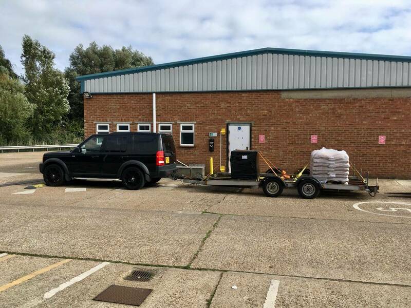

Let's have a load of pellets for good measure too:
I really need a flatbed trailer, those lips around the edges and high wheel arches are a pain in the arse for loading with a forklift. I'd have liked the pellets further forwards, but the pallet started to collapse as I nudged it up the skids...
No action photos of the other load, which was somewhat anti-climactic:
I got told the roofing sheets were 'huge'. Felt like a bit of a twat turning up with the trailer for 2 metre lengths.
To round up on the Discovery, it is currently sat on the front lawn in disgrace. A combination of shitting it's canbus system when driving through a puddle at the weekend, and me breaking the new brake switch I fitted to it. Upcoming work is to clean all the electrical connectors in the wheel arches and scuttle, pack them with dielectric grease and hope for the best. A new brake switch is enroute and will also be fitted soon.

So you may be hoping for a welding update on the Proton. I was too. But sadly I've been kicking the can on that one.
So have some clutch related updates instead.

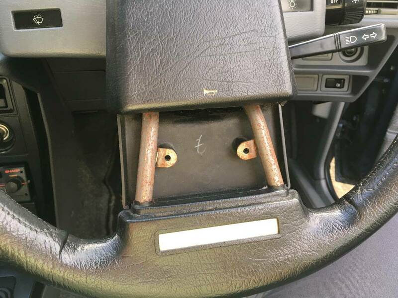

Despite replacing and bleeding the slave cyclinder, the clutch biting point was still wank. It was right in the floor, and the pedal felt like it had a lot of travel before the hydraulic system worked. Engaging gears was an arse clenching experience. I bounced it off the owner's group and got a fantastic selection of exciting scenarios; fucked release bearings, shagged master cylinders, wrong slave cylinder, poor pedal adjustment.
Now why didn't I think of that?
The lock nut shows how much I had to adjust the rod by. I may dial it back in a tiny bit.
I can't photograph a biting clutch, so instead marvel at the three identically shaped pedals.
The biting point is where you'd expect it to be now, if not a little high. I think dialling the rod back a few mm will get it perfect, as I don't want the clutch to slip.
Either way, I'm glad it wasn't a huge job. It did require one of my least favourite activities though - going upside down into the footwell.
I'm running out of small jobs to do on this car, and will have to weld it up soon. Fuck.

Annoyingly, suspension is noisy on the front end and I can't quite track down what's wrong. My gut feel is it's coming from the spring... It's the kind of springy 'clonk' that you get when something that's metallic and under compression suddenly slips/turns a couple of mm. With minimal motivation though my diagnostics have been pretty half arsed, and limited to lifting it up on one corner, staring at it and moping. It doesn't help that it's an 'Avantgarde' spec and so it is a wanker to even lift on a jack...
Lowering springs are shit. Moon buggy springs FTW.
I've ordered some shims that are meant to sit between the control arm and springs, as it looks like these may be missing. The rubber perches in the top spring cups appear to be present and complete.

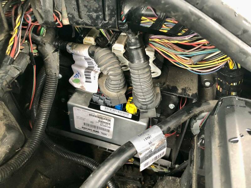

The replacement brake switch was delayed, so I stripped and rebuilt the ones I had:
The original had loads of soot on the contacts and tracks
Contact cleaner, IPA and dielectric grease later, we have two switches
Something of note was that the original switch had grease inside, the cheap pattern part didn’t. It might explain why the aftermarket ones have a reputation for a short life.
I tried the newer switch first and it’s still fucked, surprisingly though the old switch works perfectly for being rebuilt so I’m using that now.

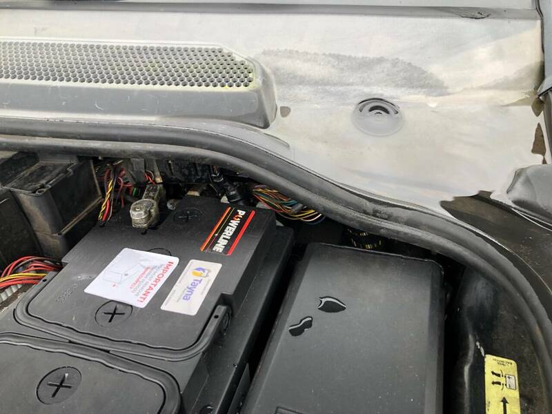

Water ingress is also a thing:
You can see it runs over the seal there and falls onto the lid below. Luckily, that’s only covers the battery, fuse box, some ECU’s…
This was the culprit last time I had mega canbus issues:
Ive had the connectors out of everything in there, plus all the surrounding body connectors. I cleaned everything with contact cleaner and then packed it with dielectric grease. I did the same to the body loom connectors that I could find on the chassis:
