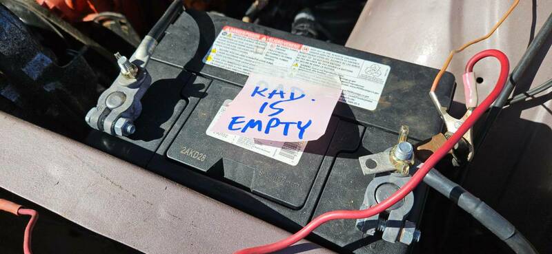

Uh. I moved the car to the other side of the driveway and charged the battery.
  • Congratulations 1
