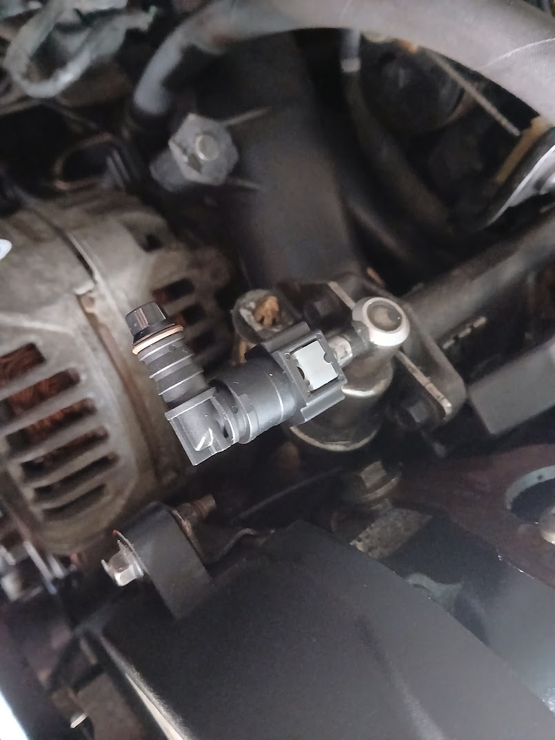

Just now, N19 said:
Standard quick release fuel hose clips. I’d probably try a breakers yard the look very similar to the return hose ones on the Mk4.
Ta muchly. I'll have a looksee. Look to be a number of different types online, maybe somebody sells a bag of assorted ones.

A selection arrived in the post today, this is the right size.
It does have a tiny amount of movement on the shaft, maybe 1mm, but the o-ring seals.

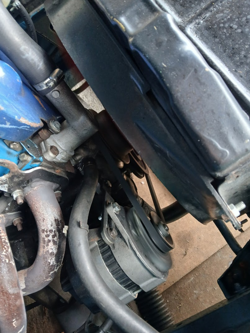

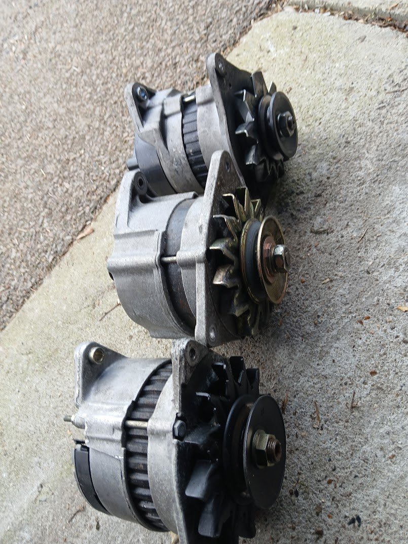

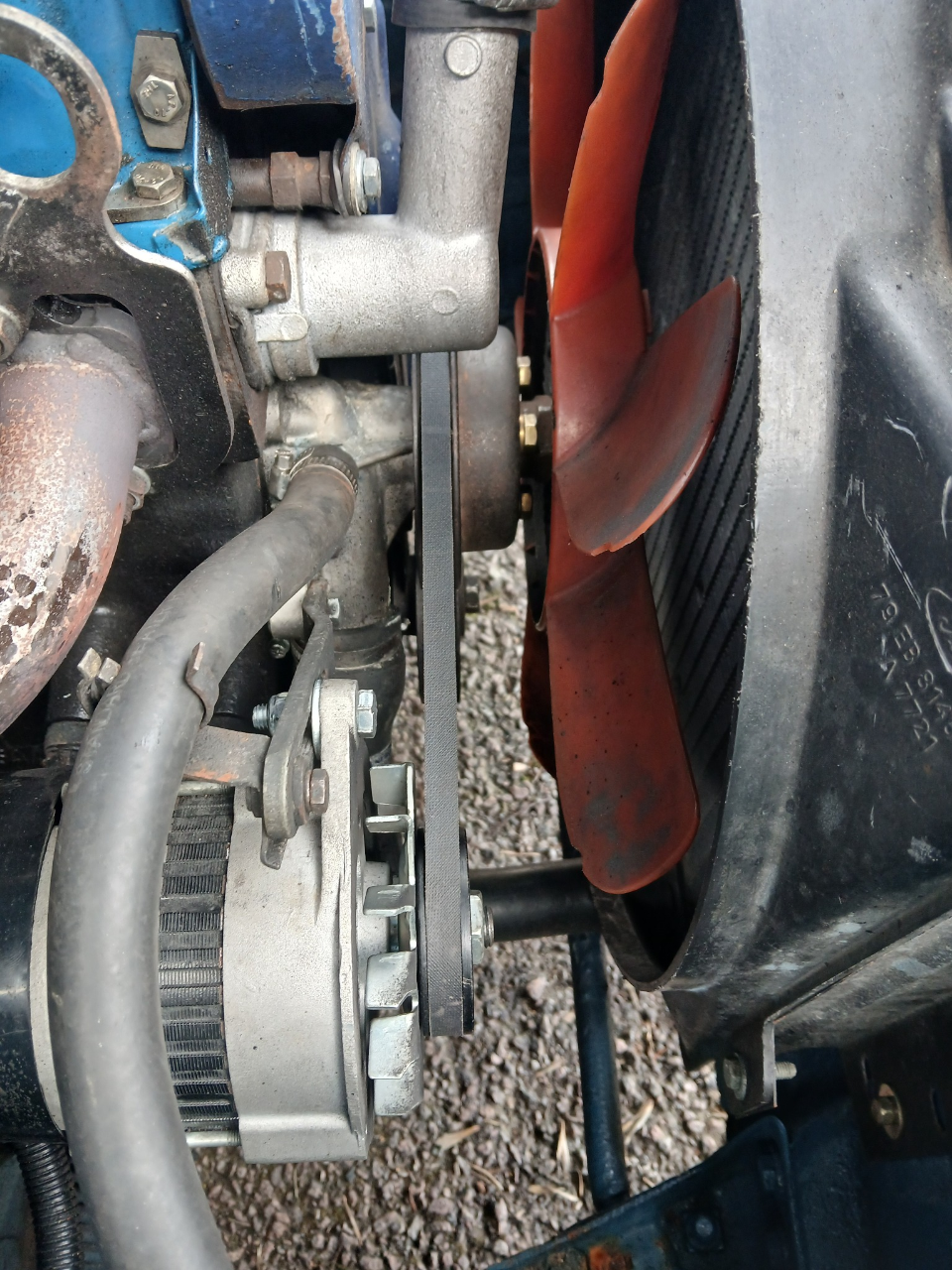

How can a simple v belt cause so many niggles. The new, shorter, correct* belt seemed to be fine until I took it on the motorway and the familiar squeak (on *engine* load, not *alternator* load) returned. A number of tweaks in laybys in the Hertsmere area followed but no, it was tight as a yorkshireman (I am one, so can say that!)
I returned home and scratched my head.
It seemed that the belt on the alternator pulley wasn't sitting right. As if it was being gently forced the wrong way.

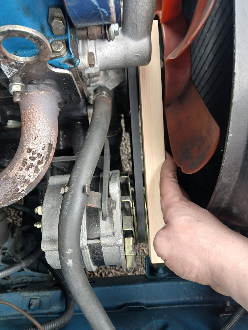

And on inspection with a handy bit of wood, yes, the pulleys were a few mm out of alignment.
I took the alternator off and looked at my selection of alternators sitting around. I have three, two with pulleys that are slightly further out, plus this one.
I fitted one of them, although the pulley is a little too large to use the correct fanbelt. I suspect that the other would fit ok however when spinning it feels like there's some resistance, so I decided to put the other one on and take that one to the reconditioners next week. I'll pop to the motorfactors tomorrow and see if they have a fanbelt which is slightly larger than the original, but not as big as the one I have on now...
Using handy bit of wood, it seems to now be perfectly straight.
Sadly, didn't have time for a motorway trip, although I have one planned next weekend.

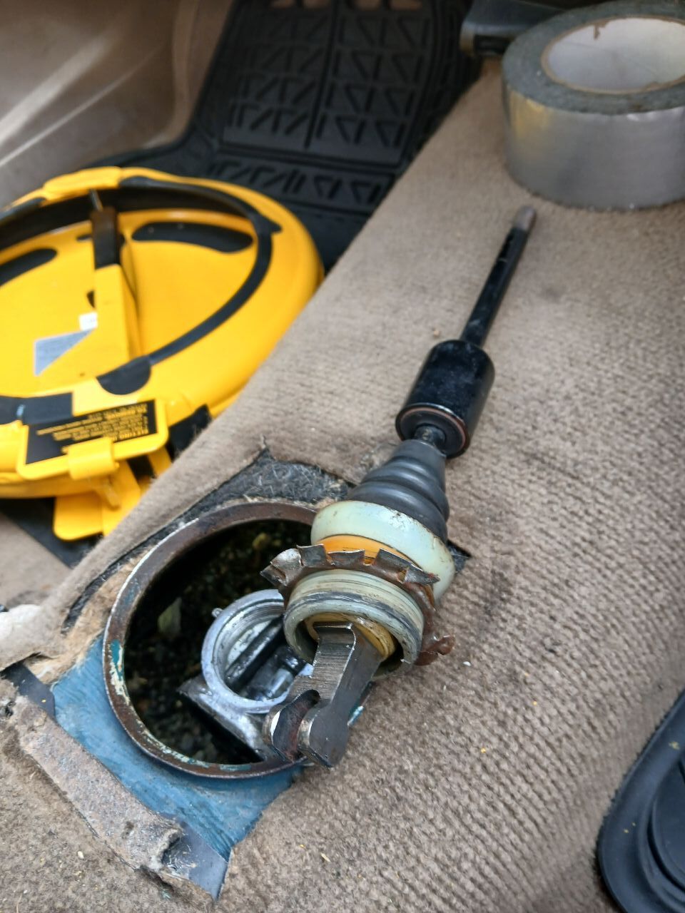

Went for an Easter Sunday run, stopped at Wenzels for a snack, got back in the car and felt the gear lever... disassociated from the gearbox. Managed to hold it in position to engage a gear and drive the car in second, aiming for a more convenient spot, although I actually went further from civilisation.
After a lot of fiddling I managed to get it loosely on and threaded into position, in such a way that I could at least select gears being very gentle. By this time I was outside Amersham, so the best way home was via the M25 (not the usual route I'd take, but it meant I'd be making far fewer gear changes) and got home without incident.

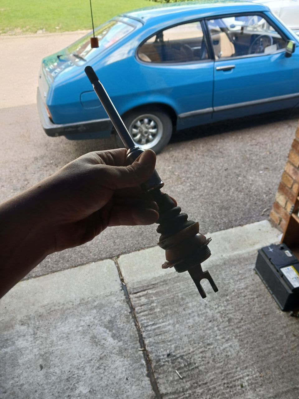

When I rebuilt the car, refitting this was a challenge. The thread was a bit mullered (as can be seen above) and I had actually ordered up a good spare, when I managed to get it in position. That foresight was very handy as when I got it back to my garage I was able to pop the good spare in. Then discovered I can't find my water pump pliers to tighten it properly, but luckily the local hardware shop is open even on Easter Sunday, so I've picked up a new pair and will pop down to tighten it up after the obligatory roast.

It was a bit of a challenge refitting it when we got the gearbox back on post refit, so luckily I'd ordered up a better spare one. The plastic thread grooves had become quite mullered and wouldnt sit especially well. It was then fine for over a year! It's not especially easy to tighten.

Insert an inordinate amount of commentary about fiddling with fanbelts, mounts, pulleys, washers for shims etc which overall left me with a very slight squeal under load that hopefully ill iron out.
The new gear lever popped out itself but was then properly screwed in and has been threadlocked.

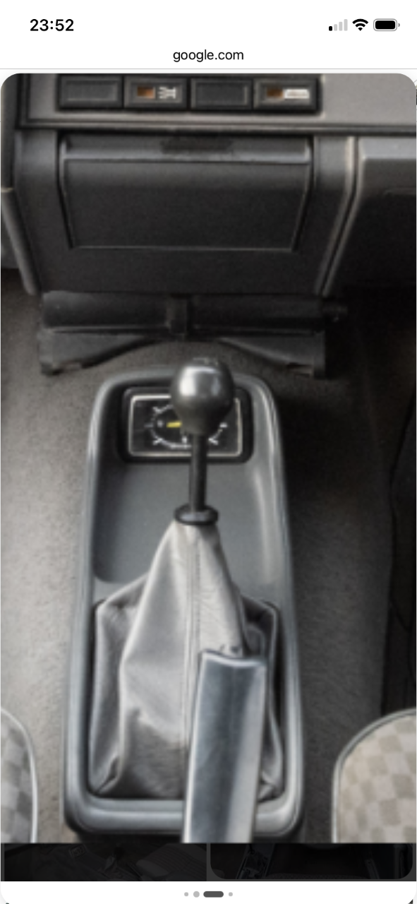

Phew! Thanks. It should be like this, the same as a Cortina or Escort of the era:
I’m sure @danthecapriman can confirm.

Did your car come with a centre console @N19? The gaiter is part of the console on cars that did have them. Only low spec cars didn’t have the console. Early cars had chrome sticks and the little round trim finisher around the top of the gaiter was chrome too. Sports and later cars were black or grey.
Some of the sticks themselves seem shorter or longer too.

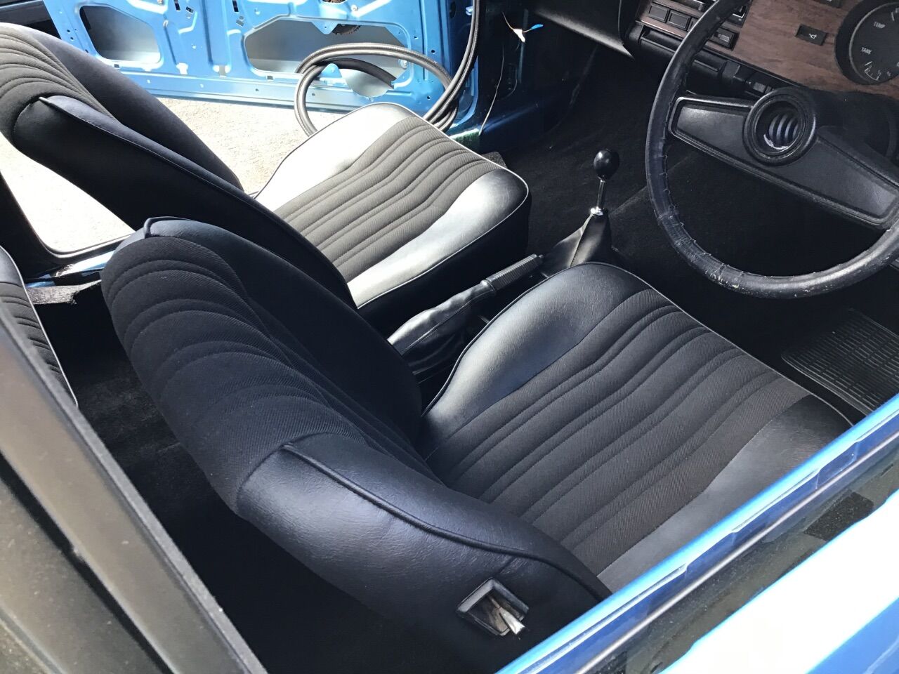

Here’s my stick (😆)
Mines an early basic car so no console but has the chrome sticks & trim with black gaiter.
