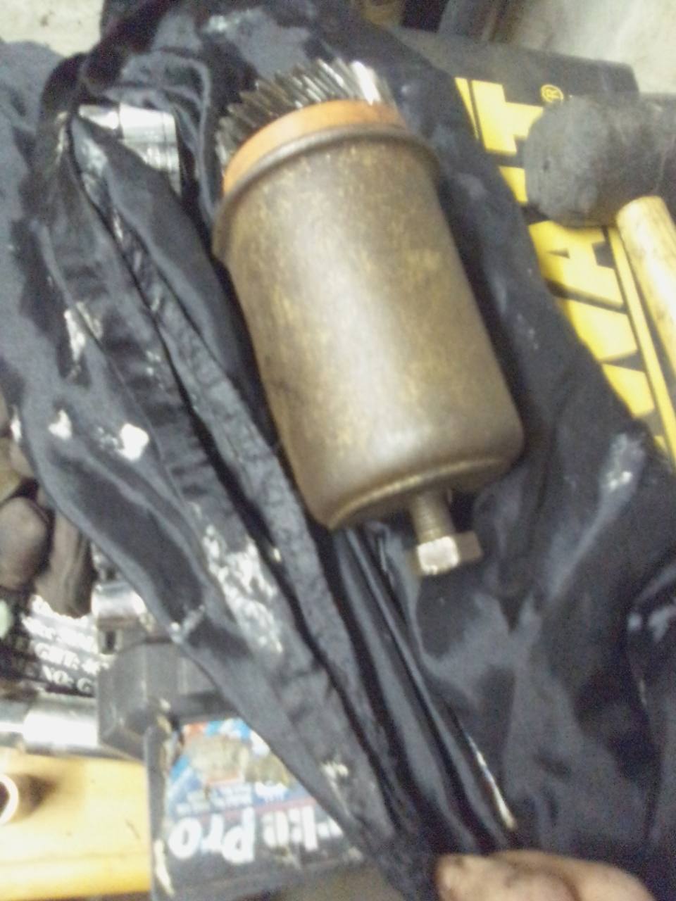

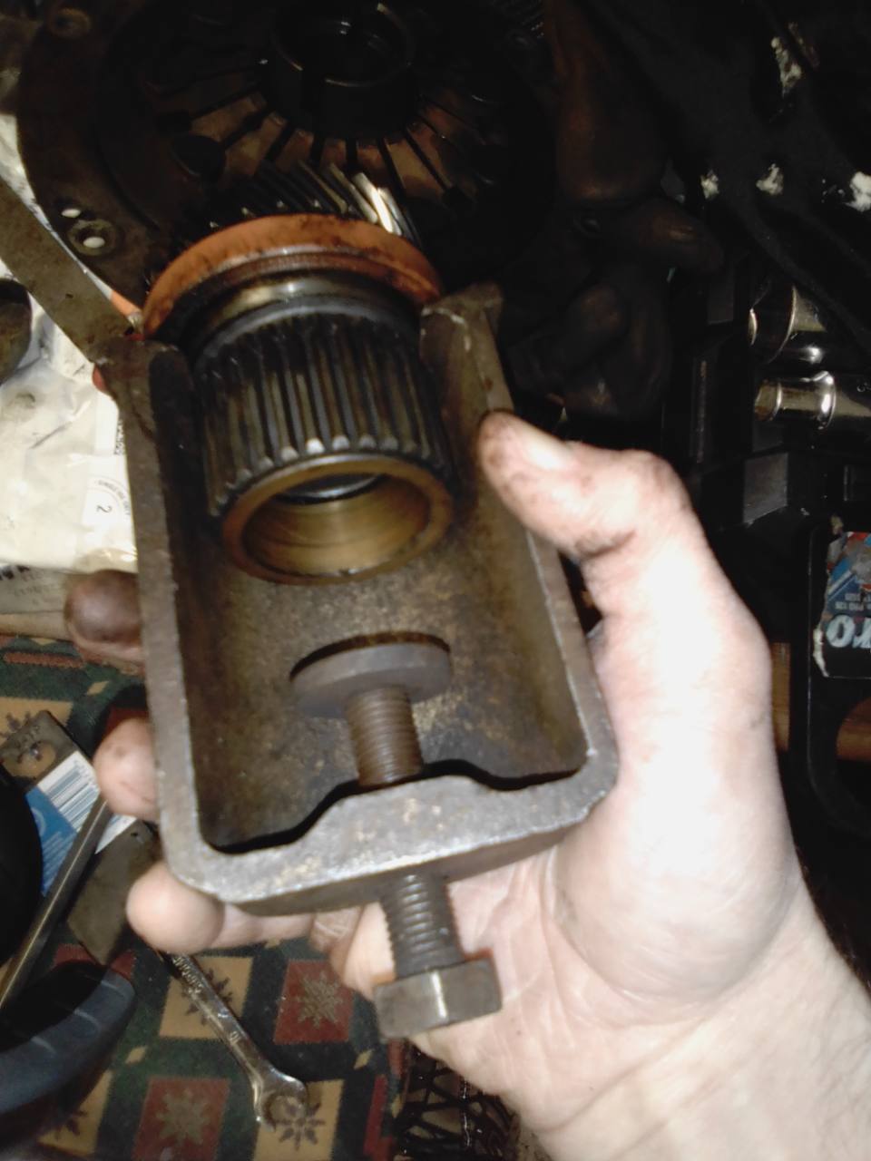

With the clutch and flywheel off I puller off the primary gear with my fairly rare Sykes pickevant puller. Very simple in design but did the job with ease and having the engine in situ, it makes replacing the oil seal easier.

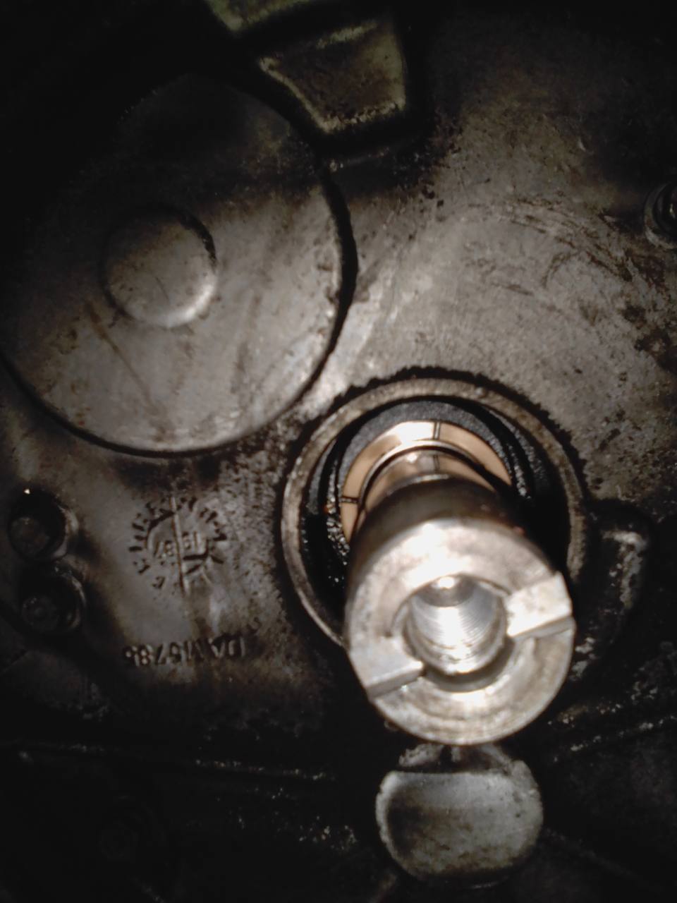

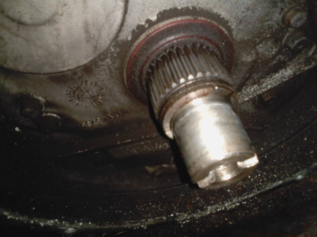

Having a nightmare now though and I don't know how it has even happened but I threaded the crankshaft bolt back in to keep it safe, but somehow the threads are a little chewed and cross threaded a little.

So it could be me being hamfisted . I used the protective caps over the flywheel puller too so I'm a bit annoyed.
Regardless I slit the bolt on the edges to try and make a chaser but it just feels like it's still crossthreading.

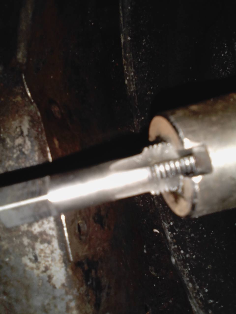

The thread for the tap is very odd too it's a  5/8 x 16 tpi whitworth. I've managed to find one for £10 but it's carbon steel. Touch wood it will be strong enough to sort the threads out!

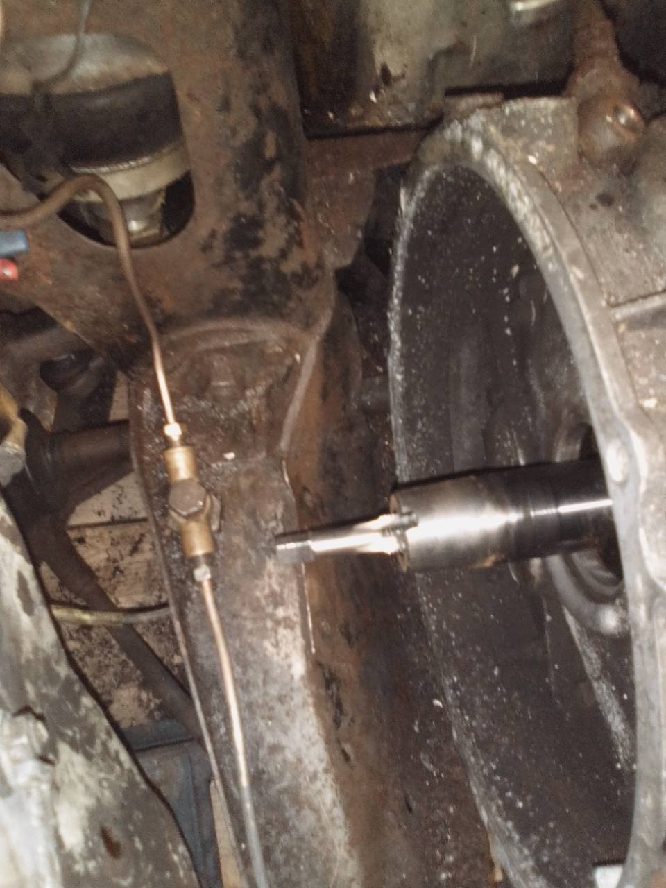

So being a tight wad I went against better judgement and just bough the £10 CS Tap. I ran the tap down the crank nose last night and it's still very tight. I used the old two steps forward one step backwards technique. But the tap doesn't actually have any swarf on it. And looking down the end of the crank nose, there's no sign of any swarf either. This is probably good as I didn't intend on cutting a new thread, just clean up the original. I'm also wondering whether the threads were actually damaged or whether the threads in there are tight in general. The tap goes in the length of the bolt threads but I'm going to to add the keyed washer tonight as advised by chaps on the miniforum and see if the whole bolt will tighten down in the taper. Not too tight of course because the flywheel is still off, so I can't really lock anything in place.
Good luck.  I would have thought the cheap tap should be fine as you were only trying to clean the thread, not cut it.
I will say that when they are ok, the bolt easily spins in by hand.  I'm not sure what's up with yours but maybe the hole is distorted and tightening things up?  I too would would just try to tighten things up and hope for the best...

Thanks mate, it seems like the tap was successful in cleaning up the threads as I put the bolt back in and it’s glides in really smooth all the way I’m, so the cheap tap did the trick. Just a matter of doing the oil seal now and bolting it all back together. Fingers crossed!
