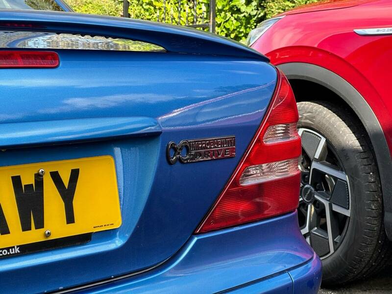

On 9/25/2023 at 3:43 PM, RichardK said:
ould be a keeper?
I need one of those for my Invacar, given how much of an Infinite improbability most people see it as LOL
that and I am a big HHGTTG fan :)
eBay or  etsy, but not cheap! Shipped from USA 😕
twitter got excited about my blue SLK and AutoPap getting offered a free one. Usual "confidence of mediocre men" types claiming it'll rust, that a silver car in a pic has a million issues. Not could have, has.
In fact I think that's the new collective noun for a load of blokes who have never changed a spark plug chanting pub-bore-lore about a car. A Confidence Of Mediocre Men.

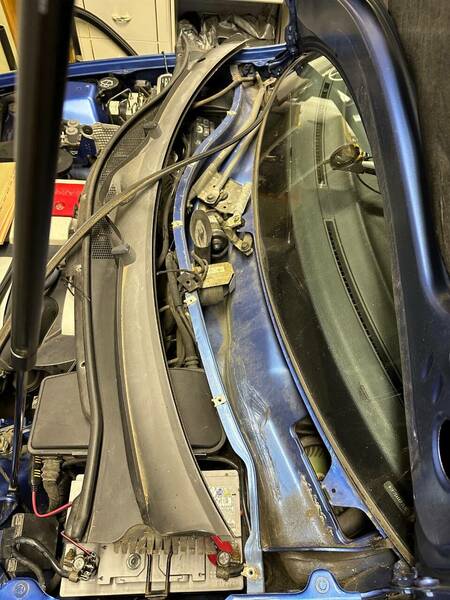

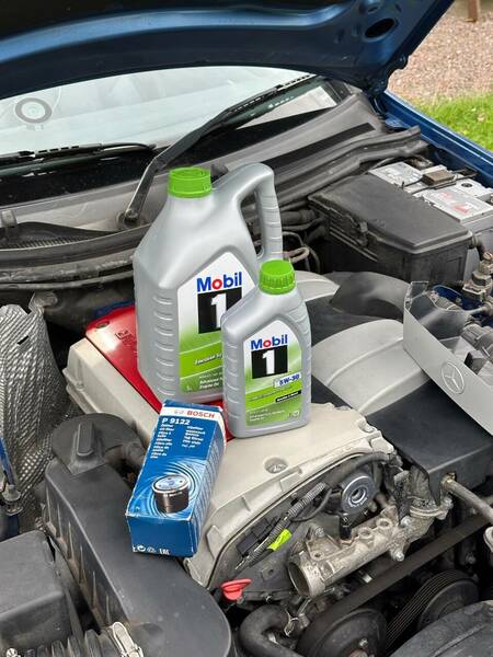

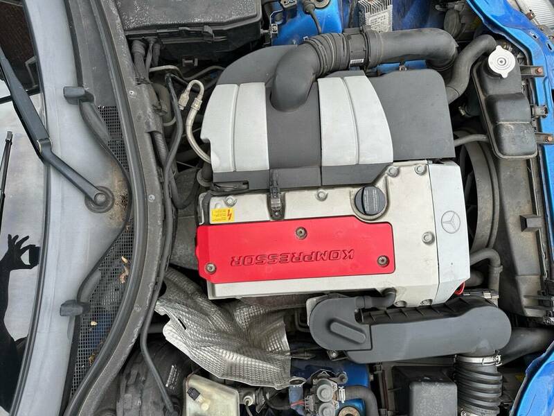

Open wide

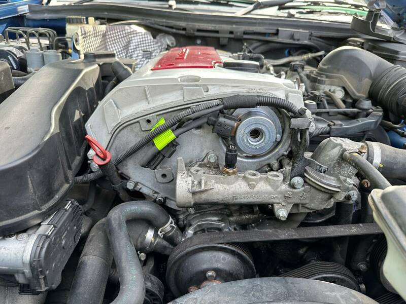

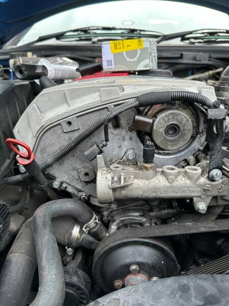

Engine bay
OMG such bad access to stuff!
Nice mostly dry engine too. Mostly.

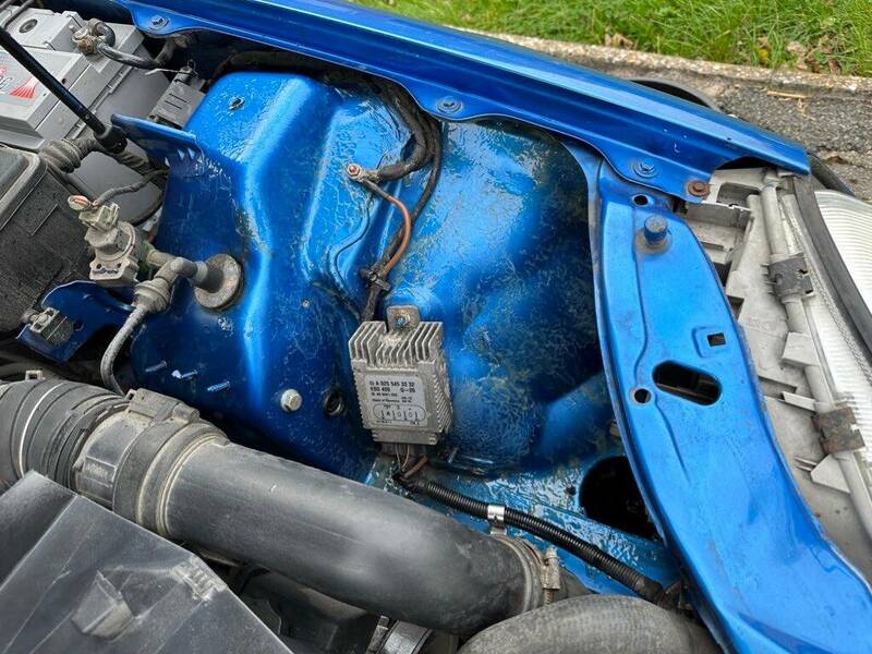

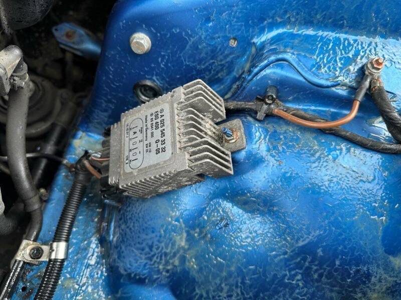

ECU box fan check (it spins - will check if it runs)
Battery vent pipe AWOL will fix when I pull the tray out and rustproof area.
Lookin' alright!

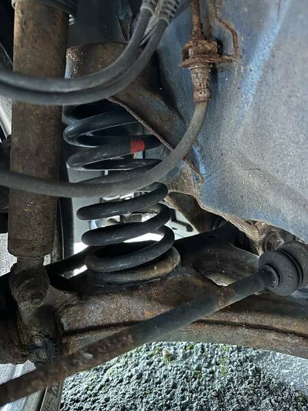

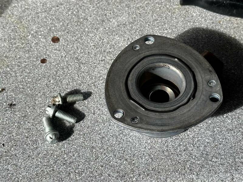

Those springs look recent. Will check red code and correct pad combo in place. Damper looks tired, all easy to sort. Arm would stand some jenolite or vatcan or something.

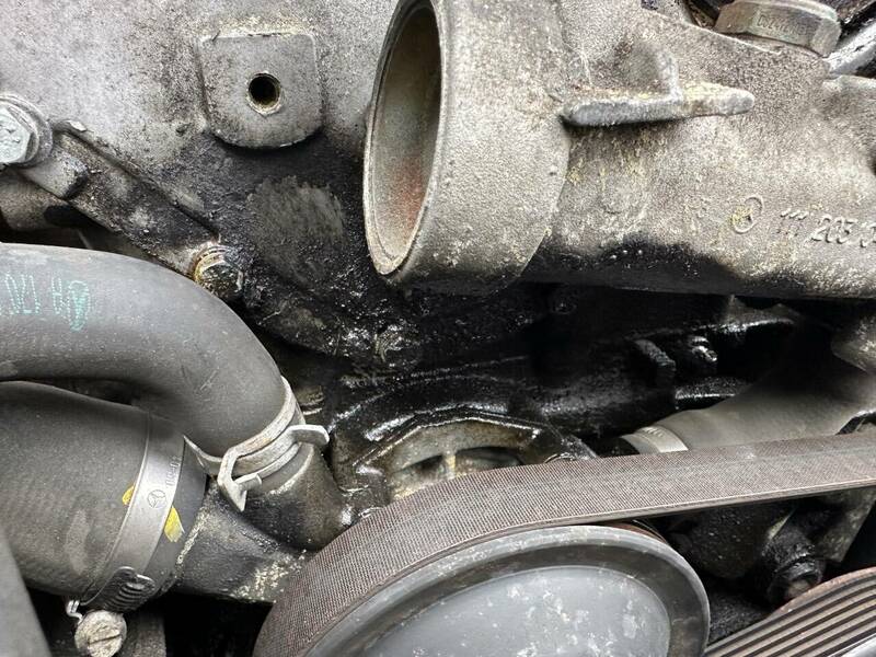

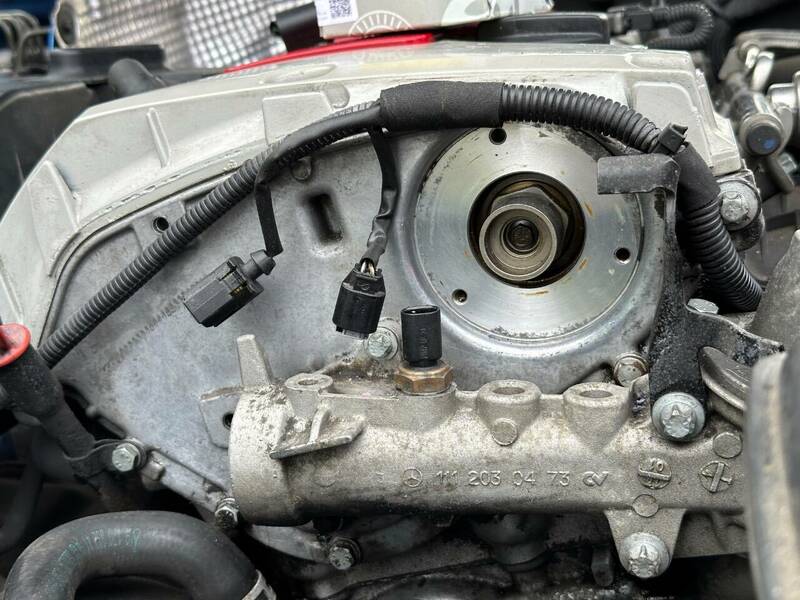

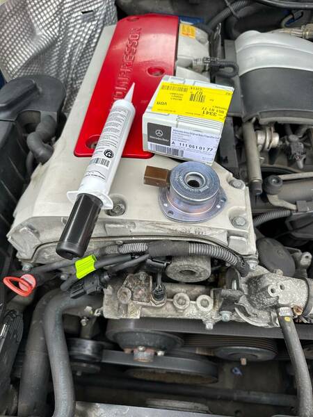

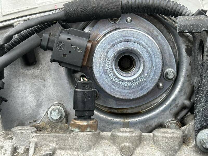

Mostly dry. Cam magnet gonna cam magnet. My first replacement job and a nice thowback to the yellow one @garellikatia now takes great care of.
The cam magnets on my 500SEL were drenched in oil. I've resealed the mating surfaces with the recommended sealer. I haven't put a ton of miles on it since but maybe worth trying in case they are pricey. Pretty sure they were on the early m119.
Great to see this level of attention put into the SLK btw, it's looking great! The spoiler is tasteful addition.
Mine is leaking into the loom anyway, so needs doing. IIRC it was £60 or so but that was a decade ago and I generally only buy genuine parts; my 500SL and 500 SEC were both dry but I had my suspicions about the SL having problems. Didn't know as much when I had that as I did when I got the SLK, though.
The sealing was like science for me, I was more diligent than almost anything I do usually to make sure it was 100% sealed, cured and done right.
Still £60 for a new genuine one. The tube of sealant with a Mercedes badge on is very expensive though. Pretty sure it's just black RTV right? In a deja vu moment I've also got a new windscreen lower seal incoming. Basically repeating all the things I did with my yellow car.

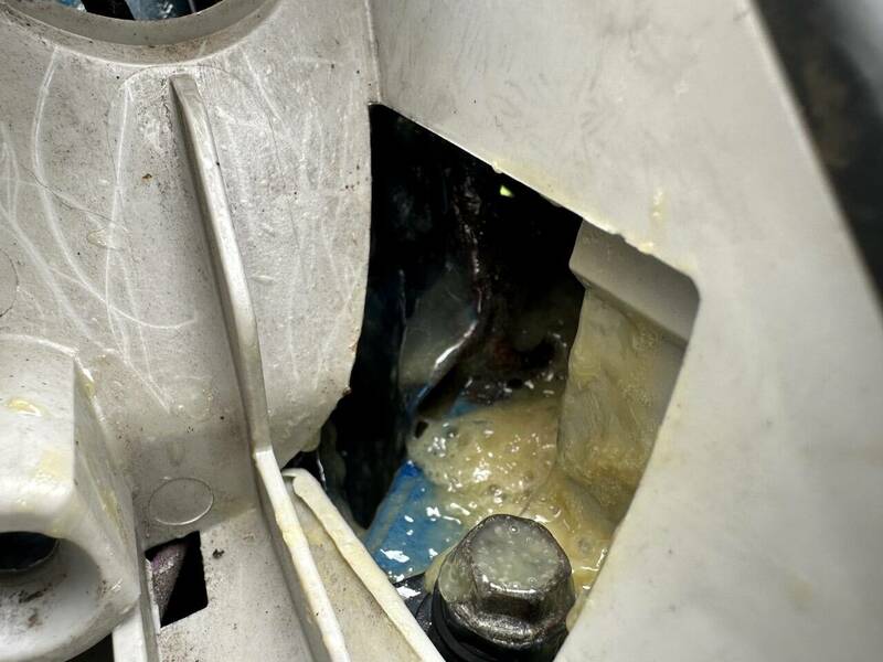

One other thing I found to keep on top of is the sill covers. The long black plastic ones. The water seems to drip and collect there especially around the clip holes. I've just managed to catch it before it'd fully pitted. 20230929_190551.thumb.jpg.39fc59795f20008119346635cb9f535d.jpg
I am pretty sure when I got the car I removed them and cleaned/checked underneath - haven't done this one yet, but that's a very good reminder!

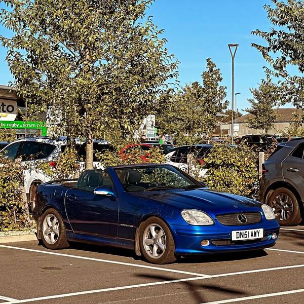

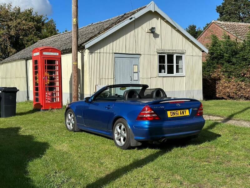

The SLK has been on many adventures...
York yesterday

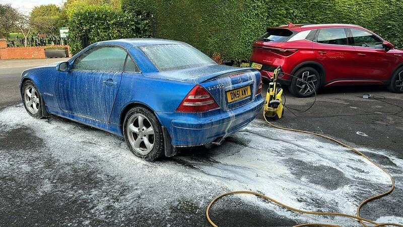

Cleaning up ready for wax attack.
Seal of approval applied.

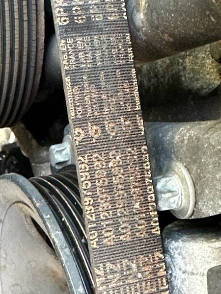

That's past due replacement though.

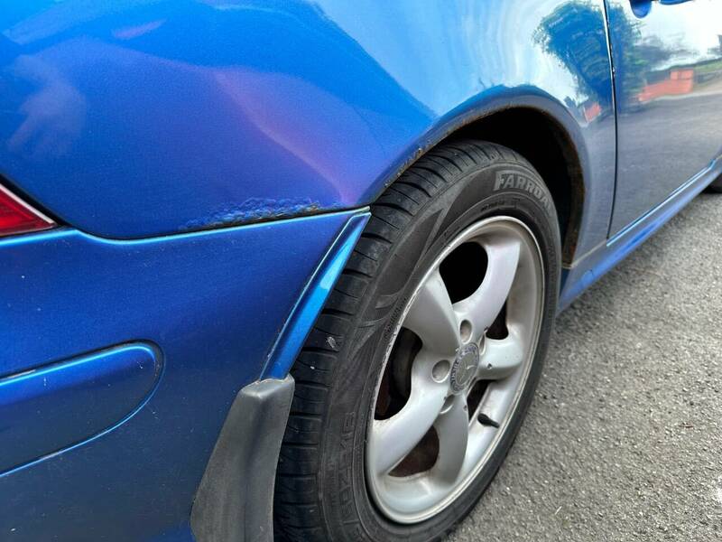

Looking great rich! What are your plans for the rear arches? I need to do mine properly at some stage!!
Ignore them studiously...
Realistically, make sure they're clean and not too crusty, rust convert and protect inner edge. Painting is not really an option as it'll just make the car look worse unless it has a full respray.
Your arches were done in 2012, sanded back, small fill and skim and paint, by the guy I got it from. I didn't think they would hold up as well as they did while I had it, but of course there's been another five years since and it was always kept garaged/not used if the weather was bad (though it got driven in plenty of foul weather, it wasn't on the road when roads were salted as a rule).

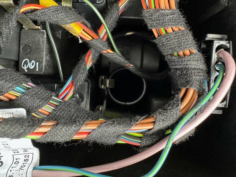

Clean Mating Surfacea
Clean intermediate loom

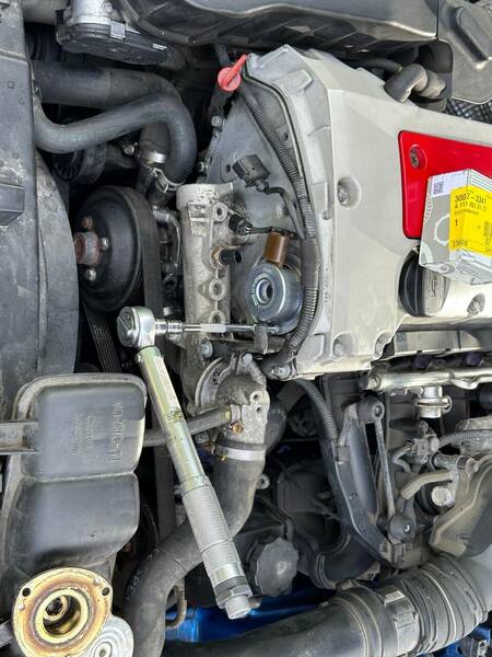

Now we're torquing (5nm + 90 degrees)
Hooked up
Covered up
Test drive time

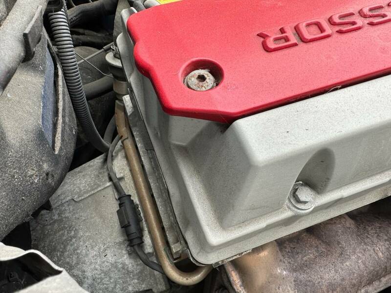

With this in mind
First this - leave on radiator and shake thoroughly
Usual technique - spray everywhere and use hairdryer to melt and direct into seams
But I need to redo this. Leak suggests RTV not in the right place (much like original.
New cam magnet and contact cleaner in connectors definitely seems to result in smoother running. Next it's inlet manifold off and clean the PCV systems

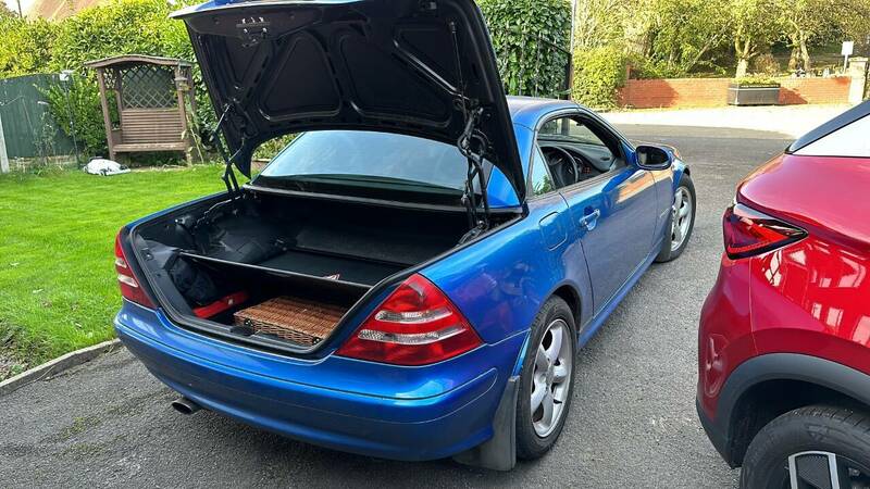

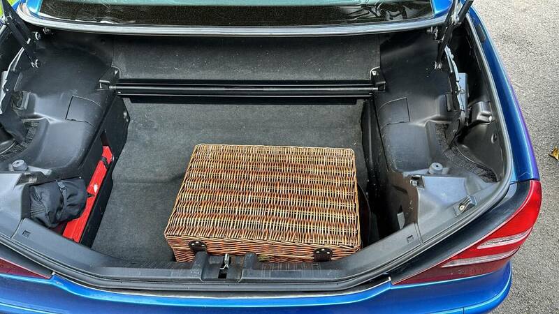

Found my picnic basket, and rustproofed the inside of the bootlid while lubricating the lock/handle and checking part number for new boot struts...

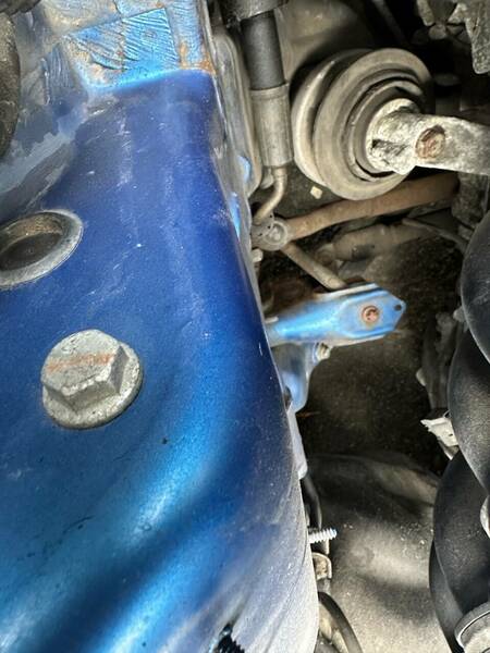

Not sure I want to ignore this bit of rust too long but fixing it properly probably 2x car's value. I am actively looking for an R129 500 SL or an AMG SLK to live in the garage as I think I won't sell the Cruiser fast enough or for enough to get the Boxster.

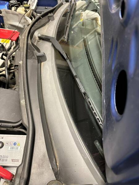

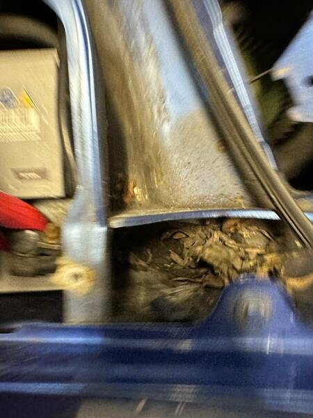

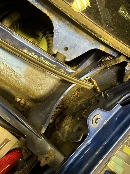

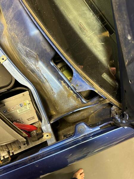

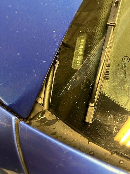

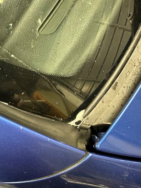

Did notice a weird bit of extra foam starting to fall off the parcel shelf to boot lid seam. Wonder what that was there for as it seems to be sealing just fine...

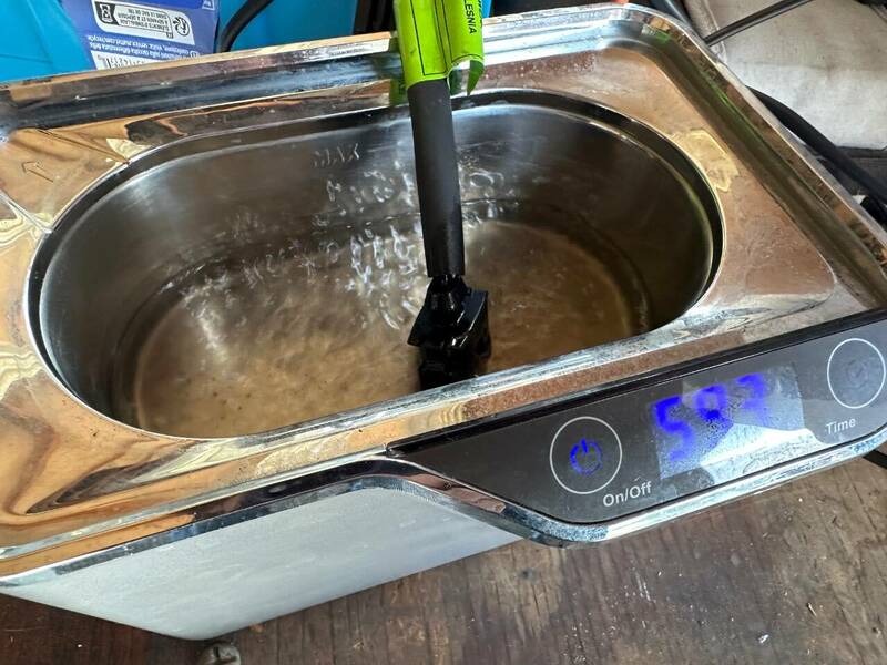

Waxoyl edges of metal, under windscreen, pop the black trim screws in the parts washer, waxoyl in spire clips and under rebate on bulkhead and around brake master cylinder and stuff...
No more gap either side of the windscreen (and bonus the rubber finger things feel like rubber again not moss).

Ah right, cool. To be honest I feel the rust is caused by the two skins of the inner and outer rear panels. The trapped moisture must cause it to rust from the inside causing it to creep up the arch.
I did see rear panels for about £150 a side  but as you quite rightly say Lower down on this thread, by the time you factor in a paint job, it's going to be 2x the car value is sometimes unrealistic isn't it.
Yep, I am fairly sure that's how it gets bad, and I will be waxoyling the blue one but externally there's not a lot I can do to improve it without making it look worse.
