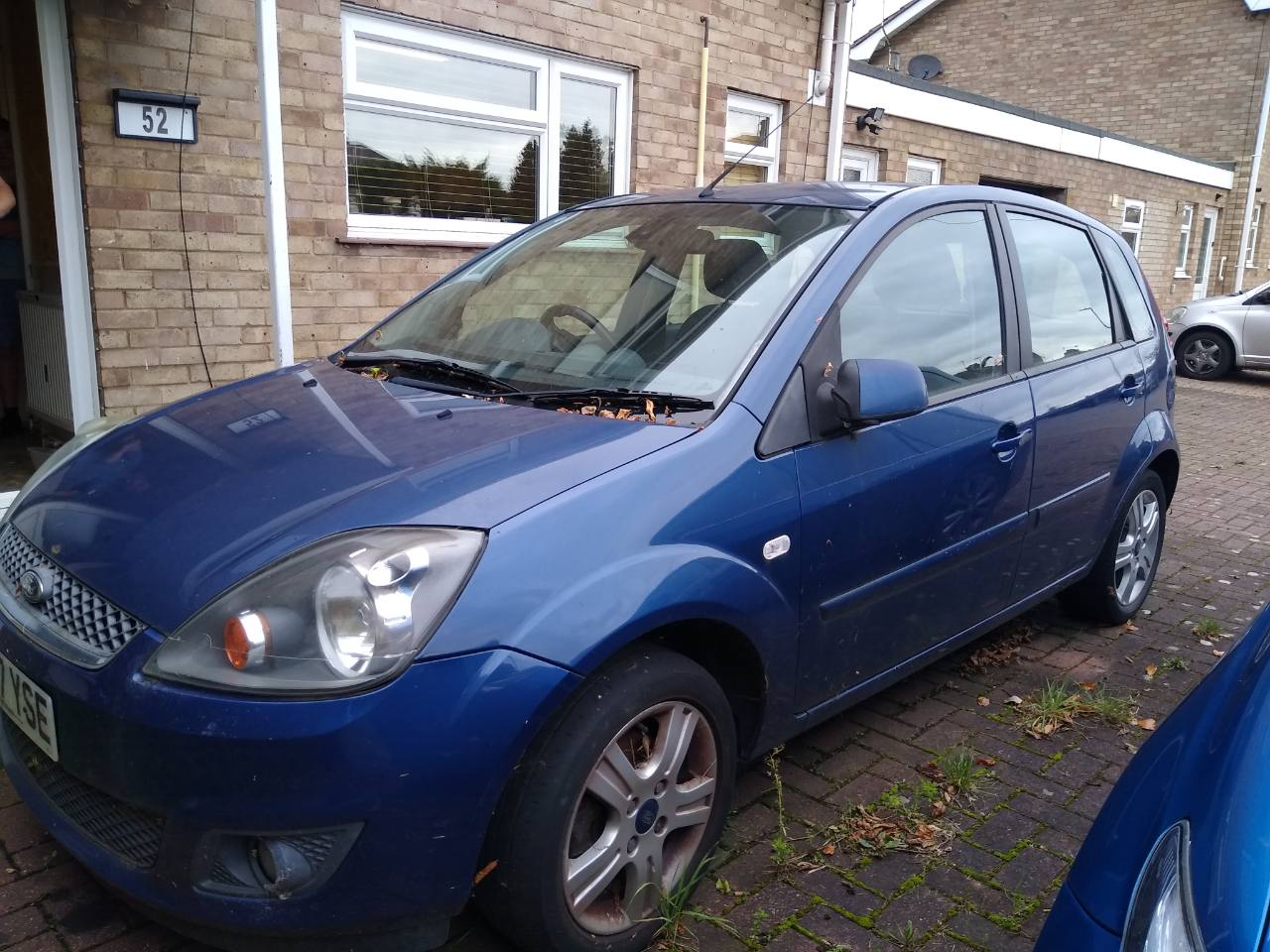

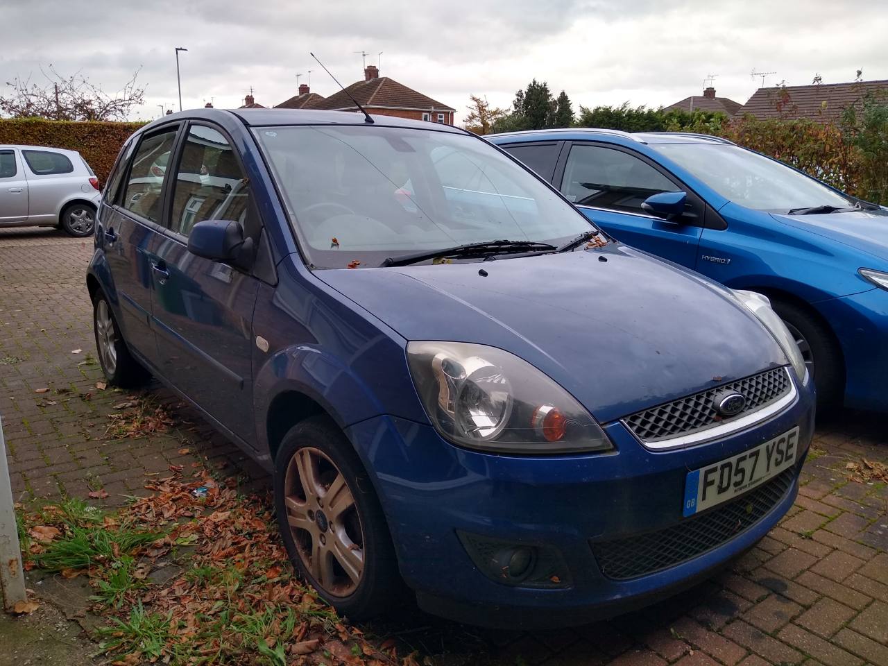

I've just been given this.
Needs tyres, engine surges sometimes like it's starved of fuel.  No MOT.
It's a Zetec climate... What do we reckon?
It had £700s worth of injector's last year apparently.  I suspect it's never has a fuel filter and as such it's fucked.

If anyone wants this as a going concern and can collect it from Peterborough I'm more than willing to sort out a price.   Car take back have offered something around £130 I think.  I'd have to check.
I think with a new fuel filter (it does run) and some front tyres and a good scrub it'd do someone a good turn.
If I have to spend a day out recovering it, put tyres on it, MOT it etc the cost goes up.
