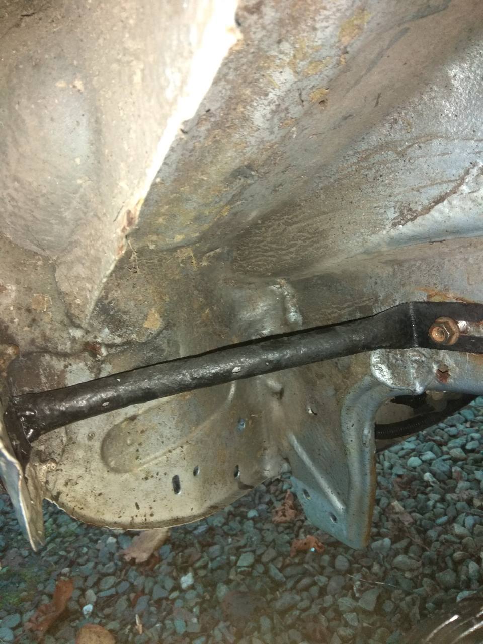

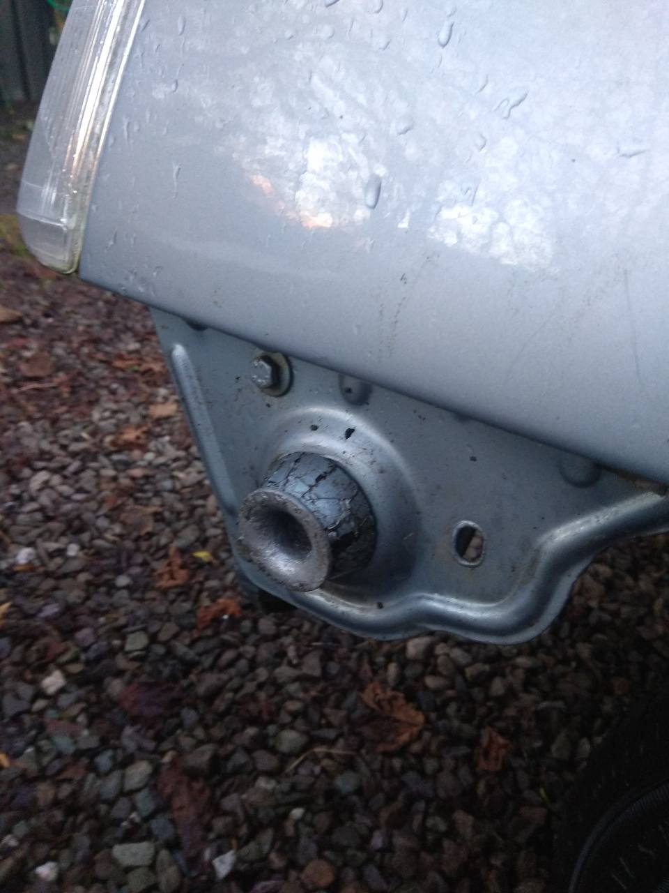

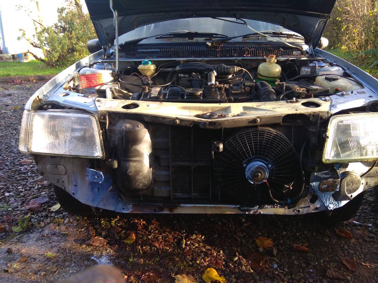

I took the front bumper off this as the  tubular reinforcement brackets that brace the bumper to the inner wing were rusty, also one of the bumper irons needed a new stud welding on.IMG_20201214_124448.thumb.jpg.c6355076b4ab7f2b35a058faa514a65c.jpg
Also found various bits of surface rust which needed treatment and painting.IMG_20201214_123601.thumb.jpg.1bedda2af41d40672c88445116ab12ad.jpg

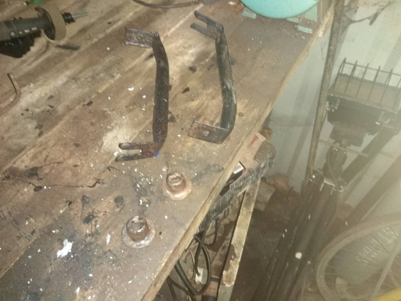

I had one of the braces in very good condition in the spares pile that came with the car, and I made one reasonable one out of the rusted remains I had unbolted earlier.IMG_20201214_200535.thumb.jpg.6ca3731b63e66c999095f18735d390f4.jpg
I painted them.IMG_20201216_161124.thumb.jpg.cf252a51271c6d08f4e7cd1f85d5986e.jpg
Then put them back in place. This is the worst of the two.
The  bumper bolts are inserted through the bumper from the outside, through the hole in the fitting here, through a hole in the end of the underwing braceand are secured with a nut. The weather and the fact that I worked 6 days a week through December meant I only got around to refitting the bumper today.IMG_20201230_161038.thumb.jpg.7e55924568c0373d2b8008ad0f900b3a.jpg
