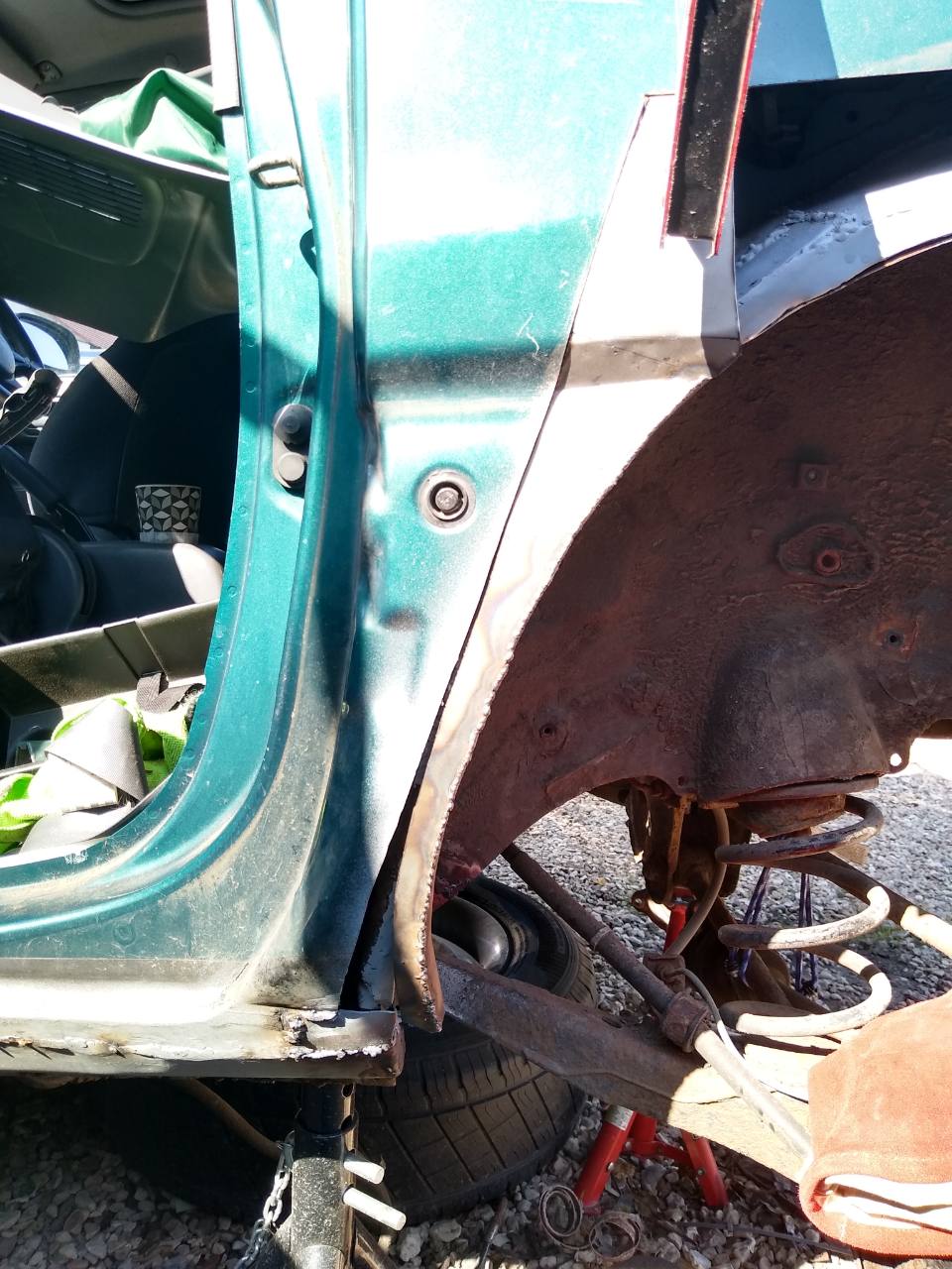

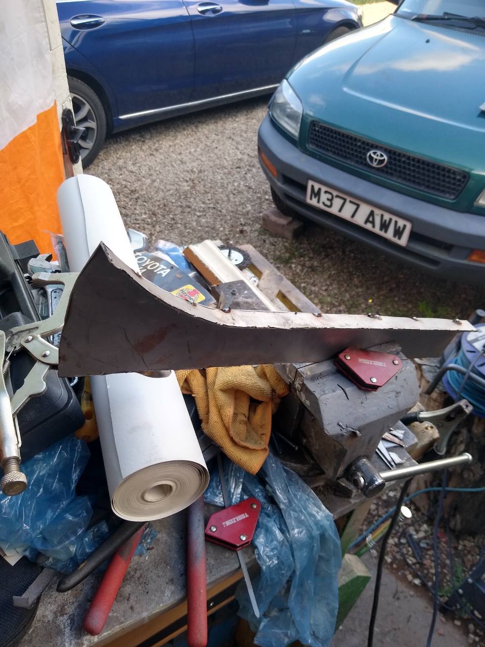

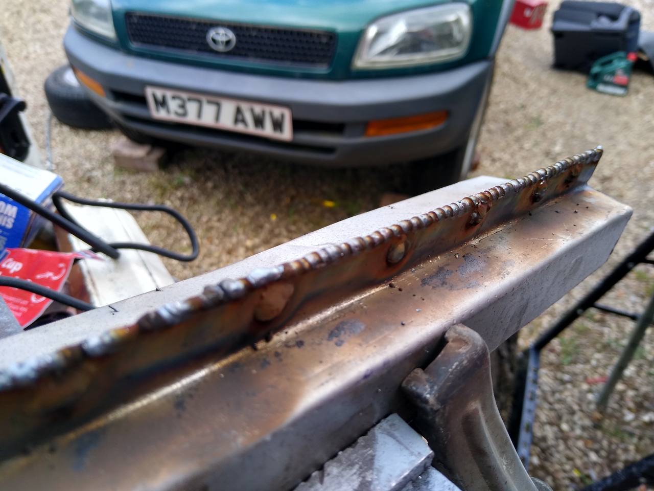

Well I mean, I was going great guns really.
Then I offered it up to the car, and it's at this point I remembered I should've just tacked the steel.
Don't know right what's happened. I think my template, which I made from the bit I cut off, may have had a drop.
That's enough for me today. I'm sunburnt again, and disappointed with that repair panel.
Anyway, onward!
Actually no, the bit I cut off hasn't bent.
I'm not sure how I screwed the pooch on that so badly to be honest. But I can cut a V at a specific part of that and bent it back and it should be good to go.
Measure... many times cut/weld  2 maybe 3 times. 🤷‍♂️ . A pain but easily rectified,  the thing is you are still making progress.

I'll cut the V tonight and try it again tonight, as we're blessed with actual sunshine!

Welding skillz improved beyond recognition. 11.5 out of 10.
I was quite impressed with myself when I did that - until I offered it back to the car :lol:
From the pics it Looks like the welding has just distorted and pulled it out of shape to me,  bit to much heat for thin sheet in a short time.
Great welding and the tin shaping is very good.
Top work!
Top work!

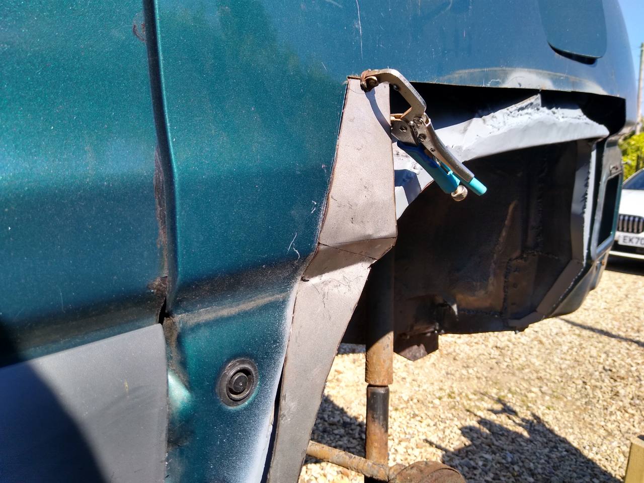

I had another look today as I left my bluetooth thing in the garage. I got the old piece, the new piece, and the paper template I made from the old piece. The paper template, when it's flat, matches the new piece I made. The paper template when flat, doesn't match the old piece. So I duffed it up on the template.

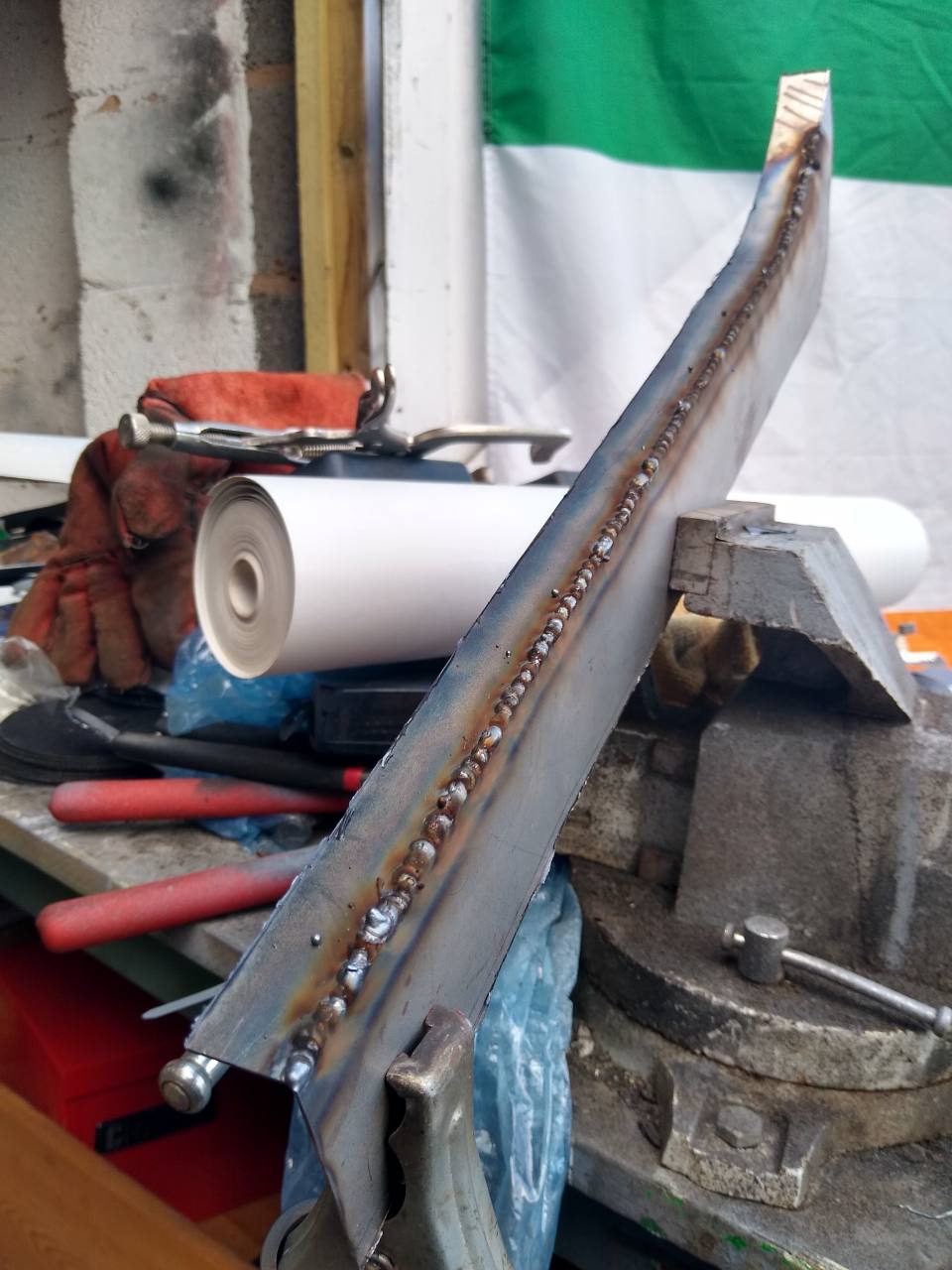

I rectified the cock up, but it's still got a little gap at the bottom. Nothing major, I've a strip of an off cut that will fit the gap without an issue.

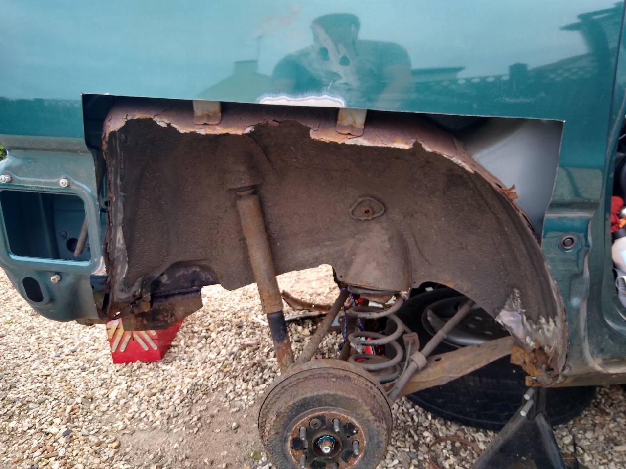

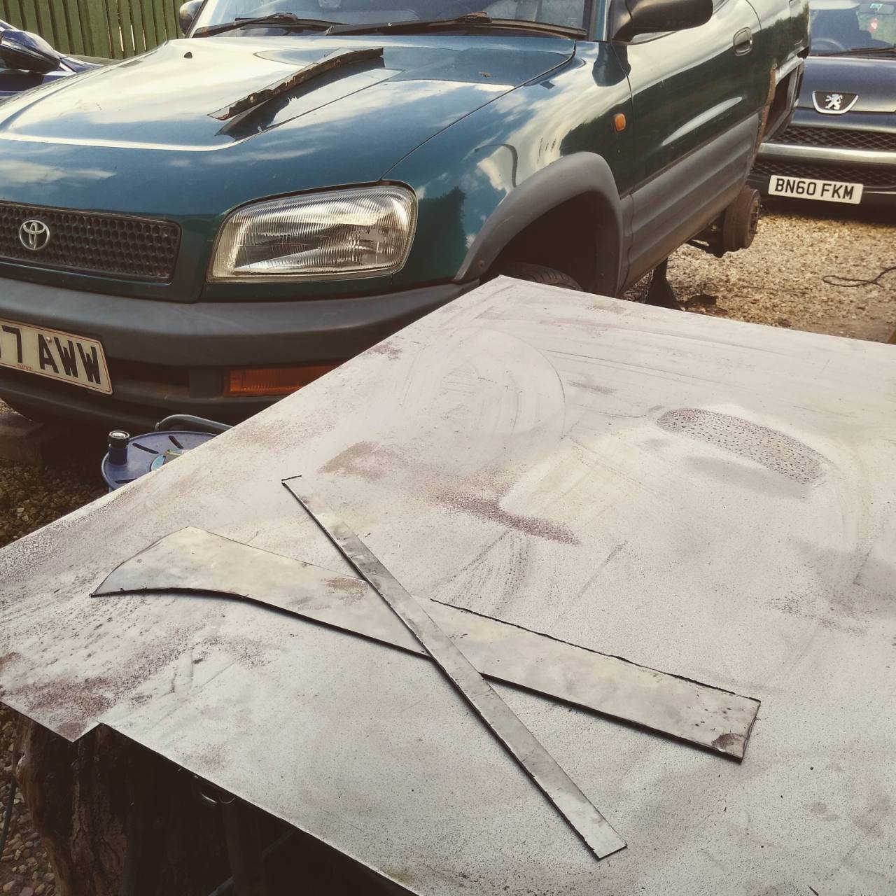

More going on.
I haven't quite finished with the one sheet I bought, but decided for speed I'd cut the strip from the fresh sheet.

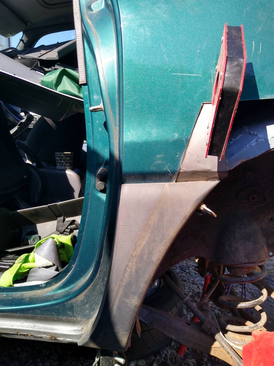

Made a new panel, and tacked it together, then checked it again. This time, thankfully, it was a good fit. Ish. Got a little to fettle but will do that when it's complete on the car.
And the violin - that's et viola isn't it? - another section offered up and welded on (not in this photo).
Tacked one bit on the underside of the arch. Light was crap and I needed to do a bench.
The rust is from the flash rain we had at the weekend, when I was drunk, and didn't even think I had left that unprotected. I'll Vactan in when I grid back the welds. All of that panel, by the way, is welded.
I'm so used to the panels flexing, now it's solid. Even the bit above, although I have warped it slightly. Nothing the filler won't sort out!

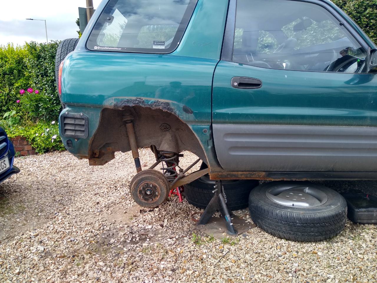

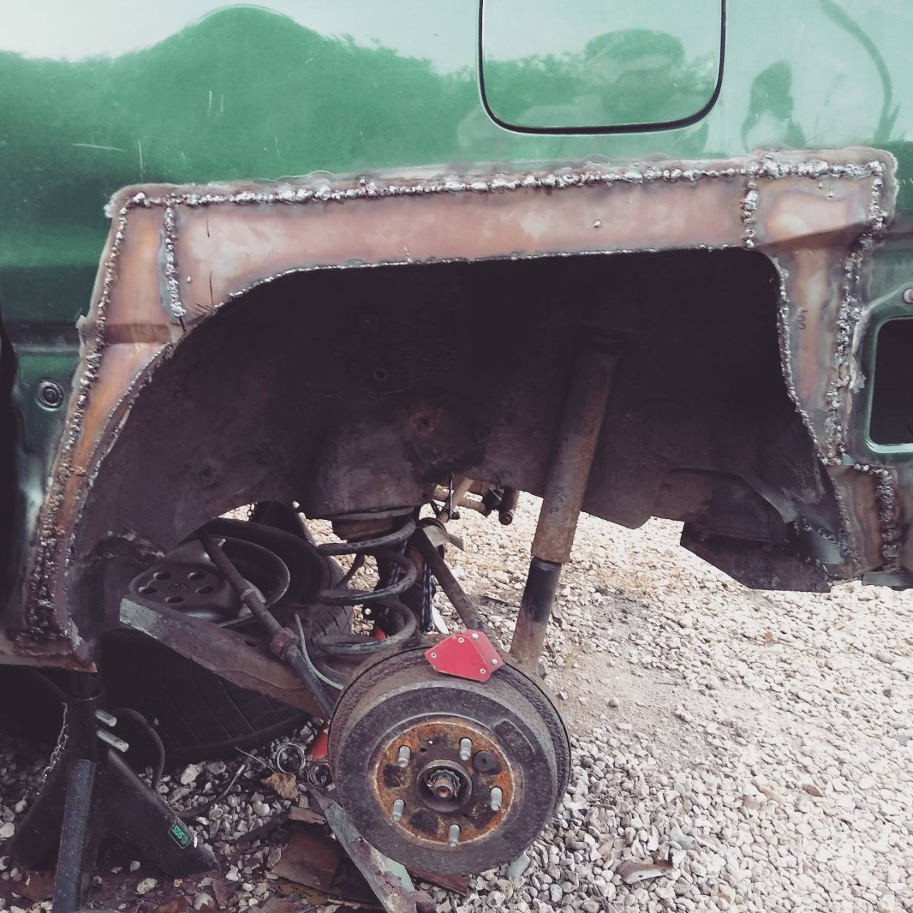

I am one piece away from a "completed" welded arch though. Which would then mean I can attack it with the flap disc, then the primer, filler, primer, paint. Which is a great position to be in.
Until I remember I've got to do this all again on the other side.
  • St.Jude changed the title to Toyota RAV4 GX "Jack" - Hobbyweld 15 isn't the same as Hobbyweld 5, and it costs you a good 6 hours of a Saturday to make the mistake right.

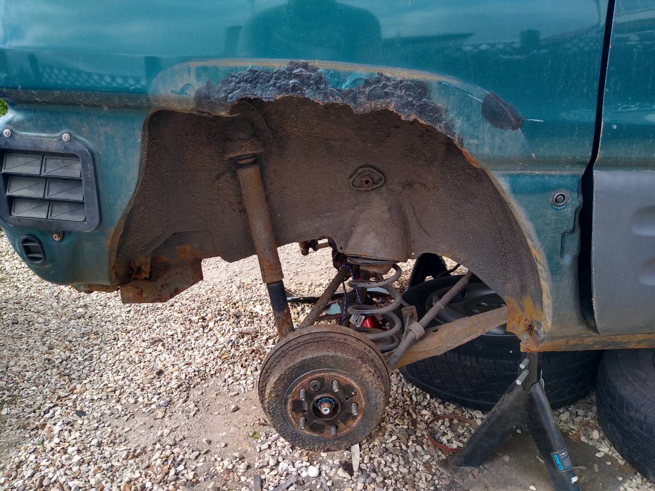

So for the first time since March, I've got an arch and wheel well made of 1mm steel. I dare say it's been years since it's had steel this thick right here too.
I've warped the panel at the top, I've got to add some spots to some places I've missed, and remind myself what I did with the sill. Then I can prime this all up and move on to the driver's side.

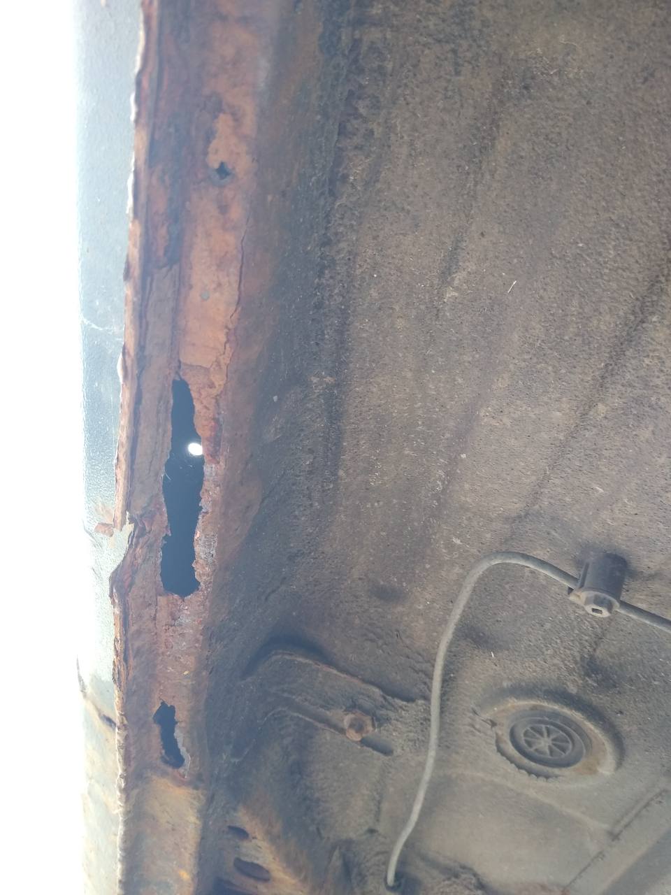

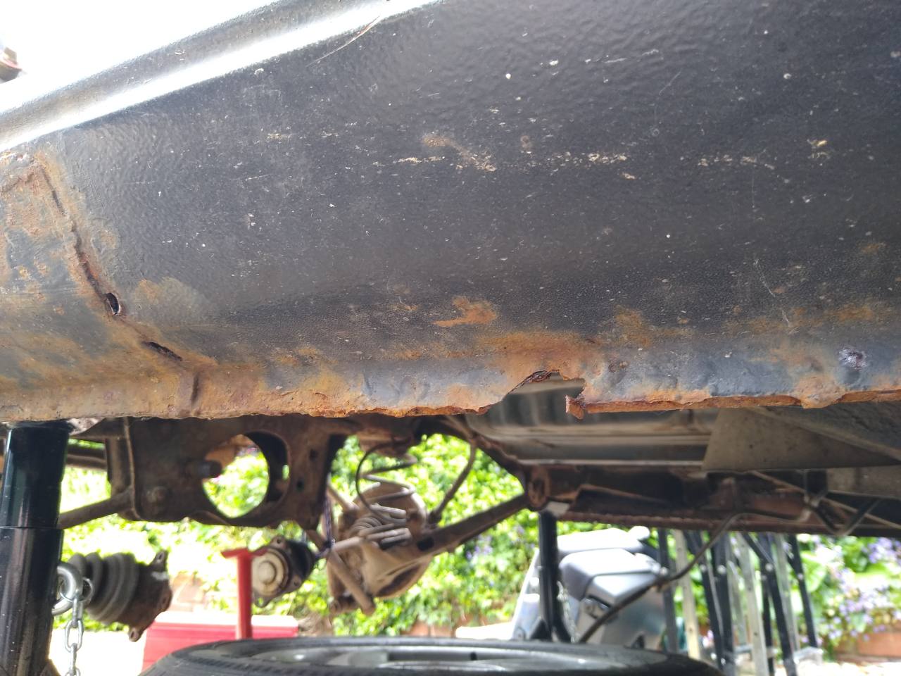

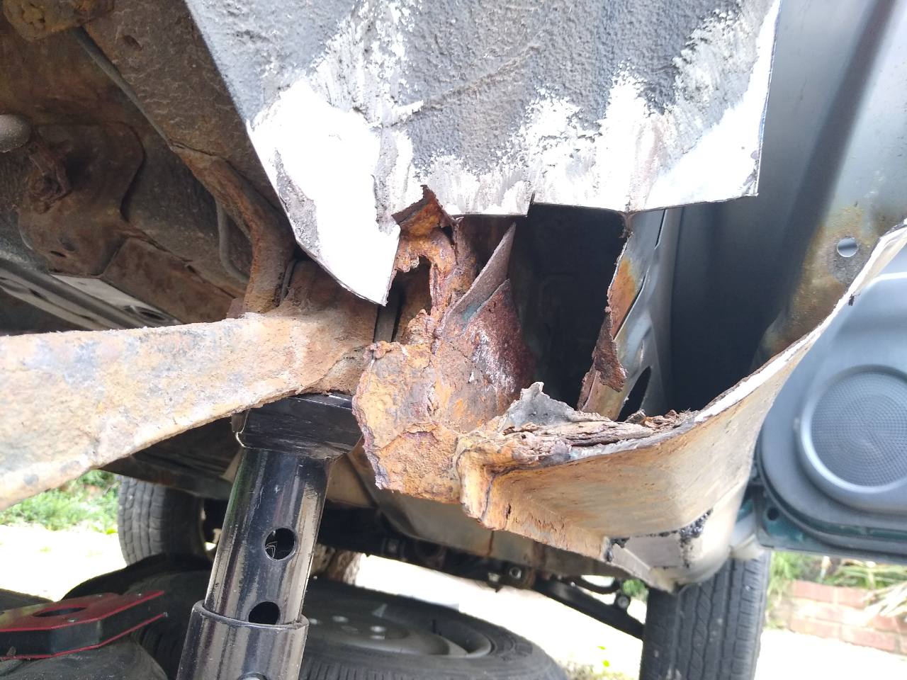

So the sill isn't that bad.
I mean it's still rusted to buggery, but the previous repair is far more robust than the passenger side. So I am leaving that in, and just cutting the rot either side of it.
Obviously got to cut in to the repair, but it's not too bad.
I notice though that, again, the middle bit of steel that was missing from the passenger side is missing here. I'm leaving it this time, as the repair here uses much thicker steel than the other side did. So that should be enough to balance that out.

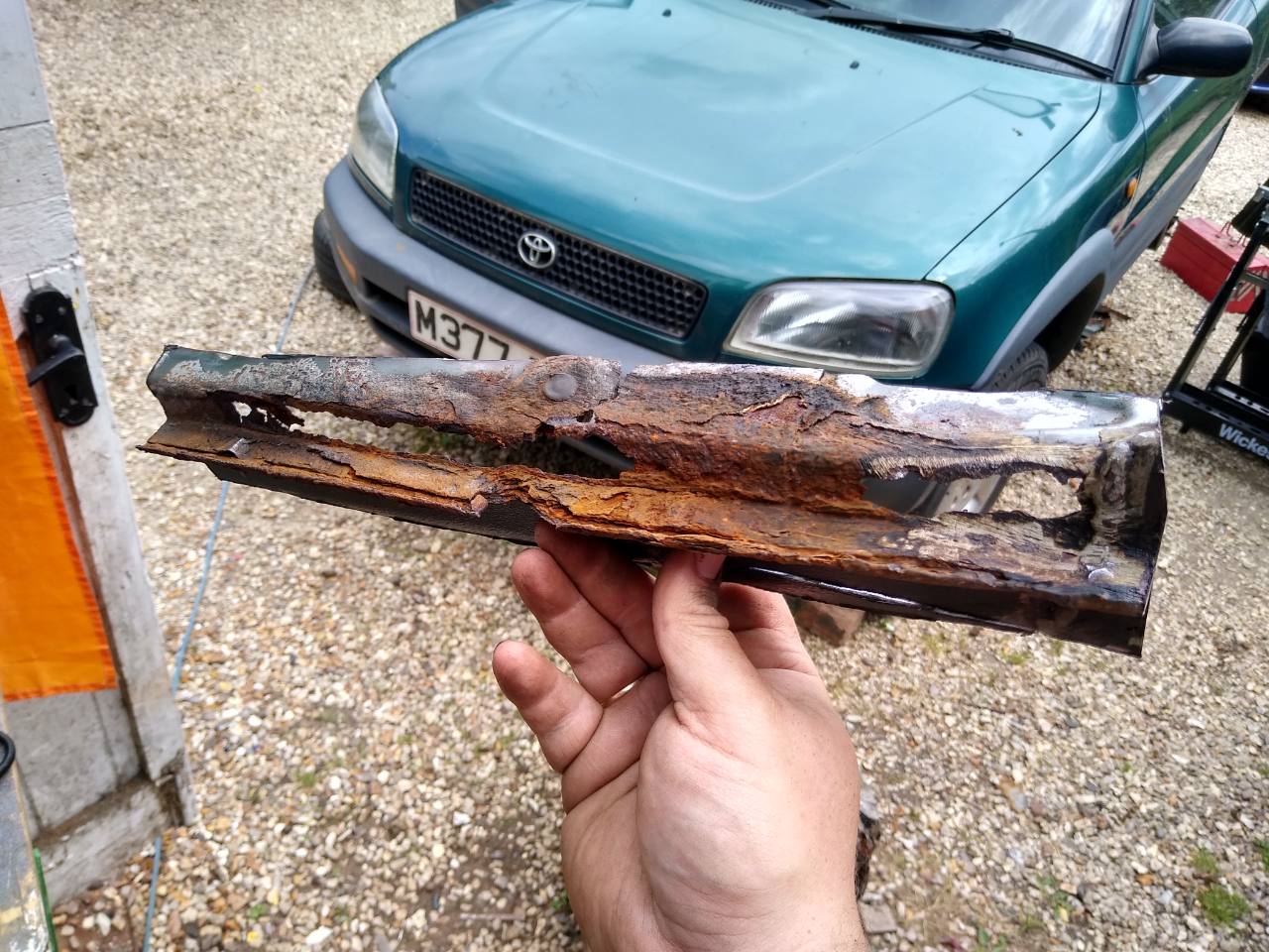

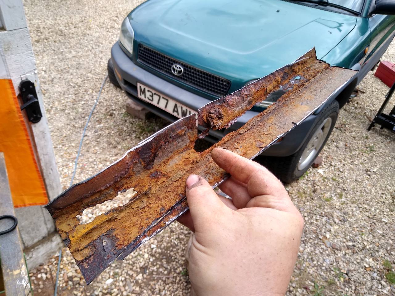

First piece off the car on the driver's side...
Managed to split as I was either cutting it or removing it. So now I have every confidence of surviving a crash in this moving forward!
Managed to wire brush the rest of the sill, it was all surface rust other than this so I will Vactan and treat appropriately after welding.
I'm quite impressed with myself, given the bit if sill I fixed today took half as long as the other side. Obviously I've not done the sheet of steel in the middle, as it isn't needed, but I managed to get a repair panel done and on the car in a day.

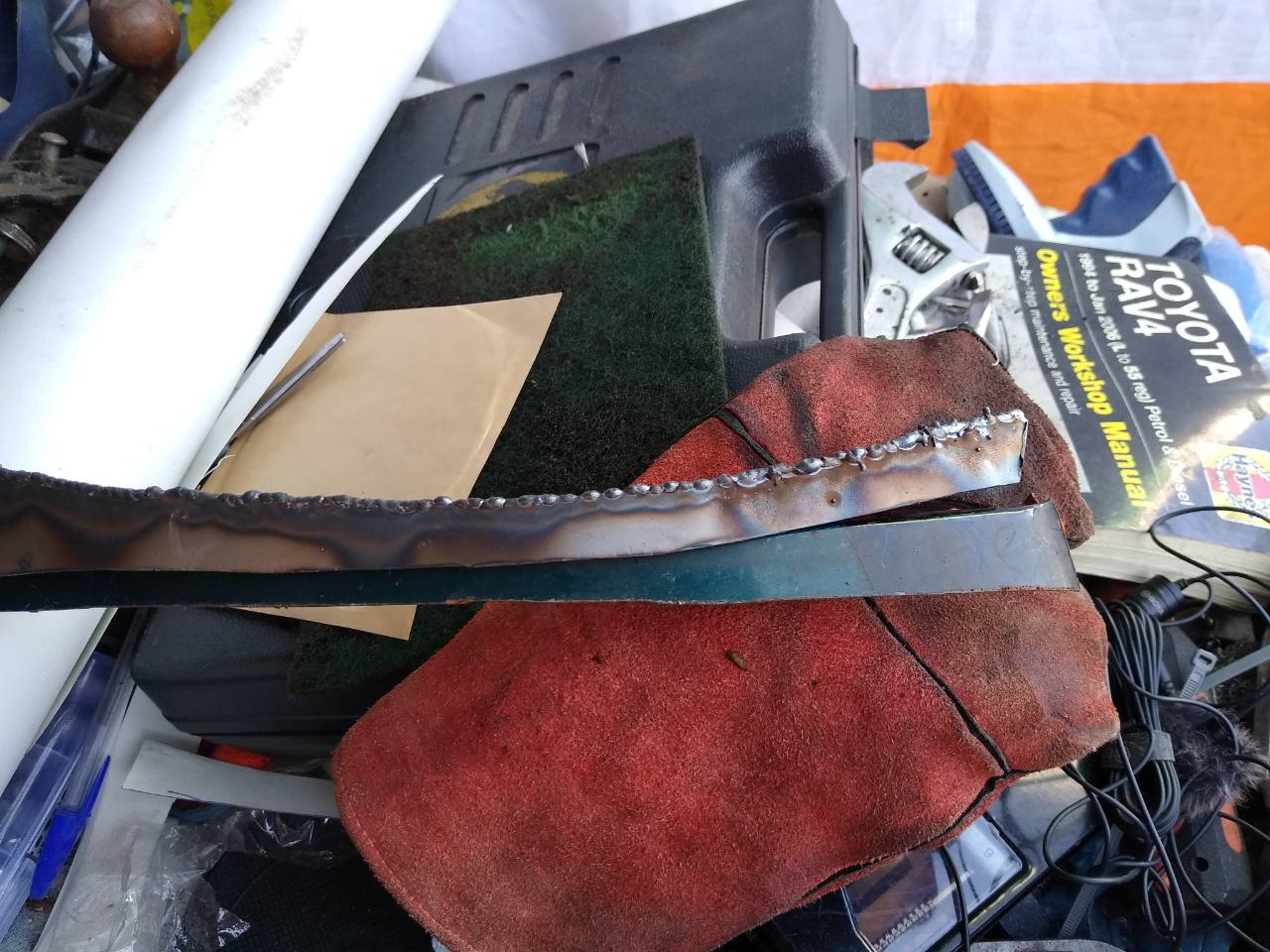

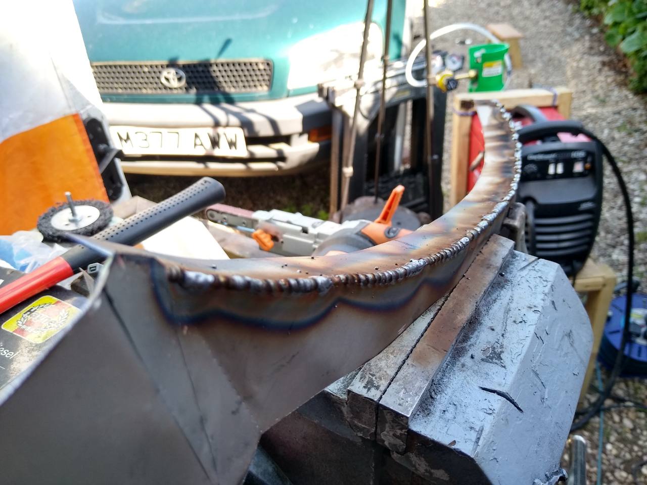

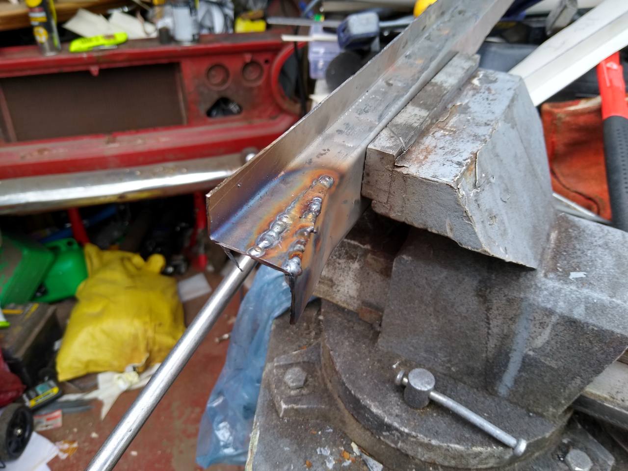

I decided, given how much I hate welding upside down, I thought I would try and make the panel on the bench, and then weld it on the car.
It worked more or less.
Quite proud of the last image, my welding has come on leaps and bounds.
Then I do this.
The left has a big glob, as it kept burning through and I was fixing the hole. Other side is better though, but it's all there.

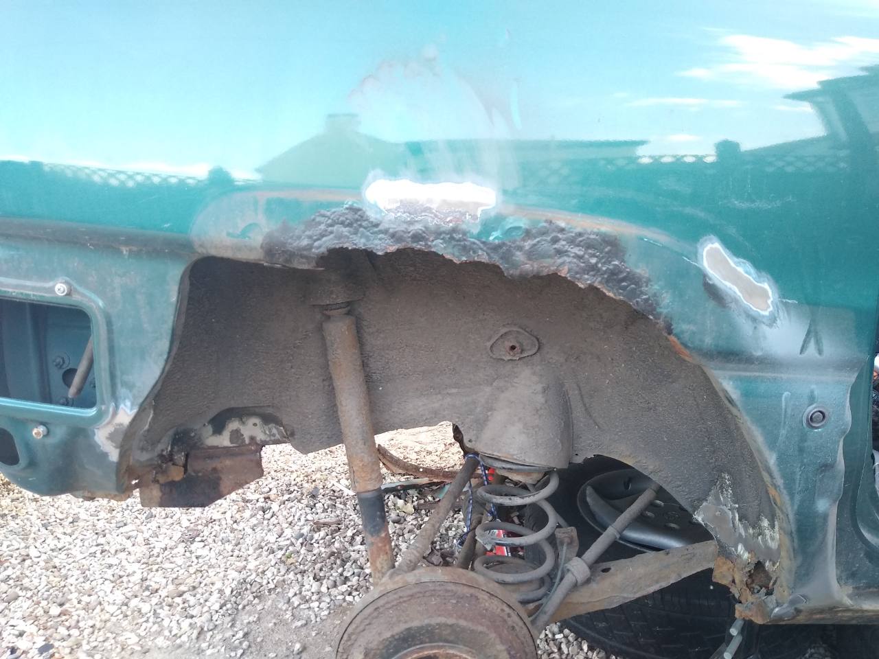

So as it pissed it down on the longest day of the year, I decided to try and do as much as I can today. I didn't do much, just tried to see how much of the arch is alright and how much is rotten, and working out as straight a line as I can to cut tomorrow.
So it's basically just as bad as the other side.
But as it's just a straight forward arch, as in there's no fancy curves for the fuel filler, I reckon I could just make  one or two large panels and throw it on.

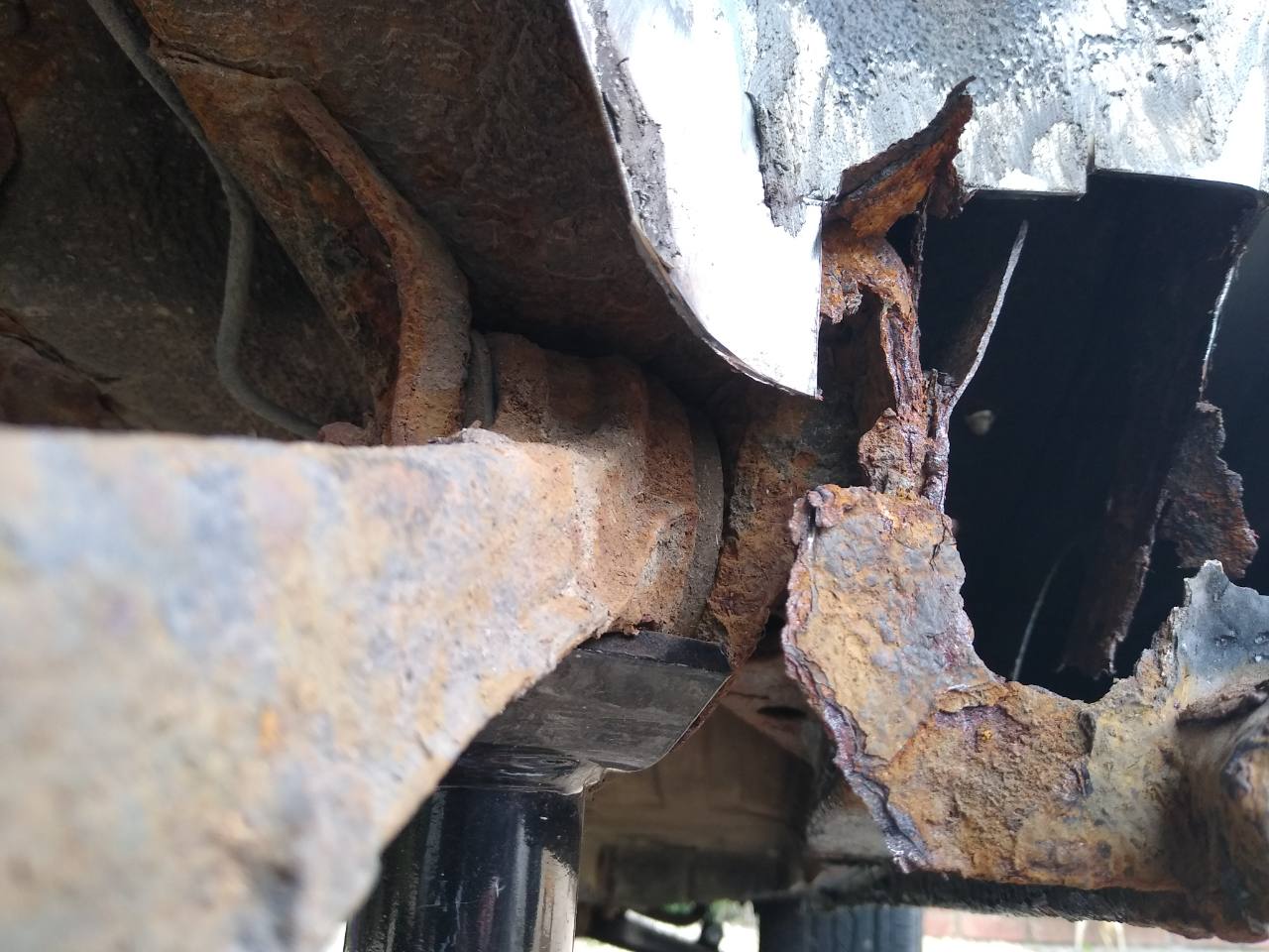

I know I'm not an expert but fuck me I am vexxed at the state of this right now.

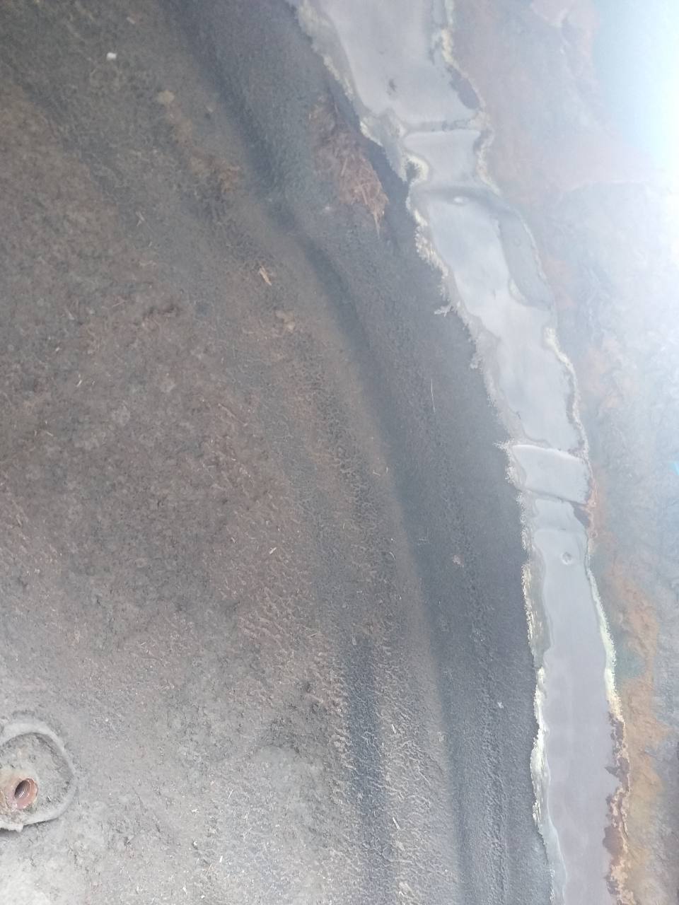

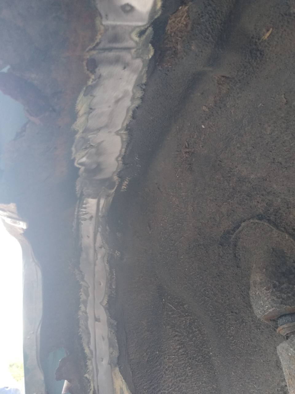

Started as I planned to go on, cutting the rust out of the arch, leading down to the sill.
When I spotted this treasure trove of orange steel.
It goes all the way up the side of the inner sill, which just so happens to join this triangular bit which JUST SO HAPPENS to be the place the trailing arm connects to.
I did not want to fuck about with the suspension on this. It doesn't knock, it's cruddy but it's functional. Now I've got to fuck about with PlusGas and various fluids to get these things off.
I now also have to deal with a thicker piece of steel, upside down, outside. I also now have to work out where to jack the car as so it doesn't kill me, and that I don't shit myself while under it.
For a few minutes I genuinely gave thought to just putting something over this, covering with Vactan, weld around it and forget about it. But this is on my side of the car now, right by my arse, and so I'd like it fixed properly.

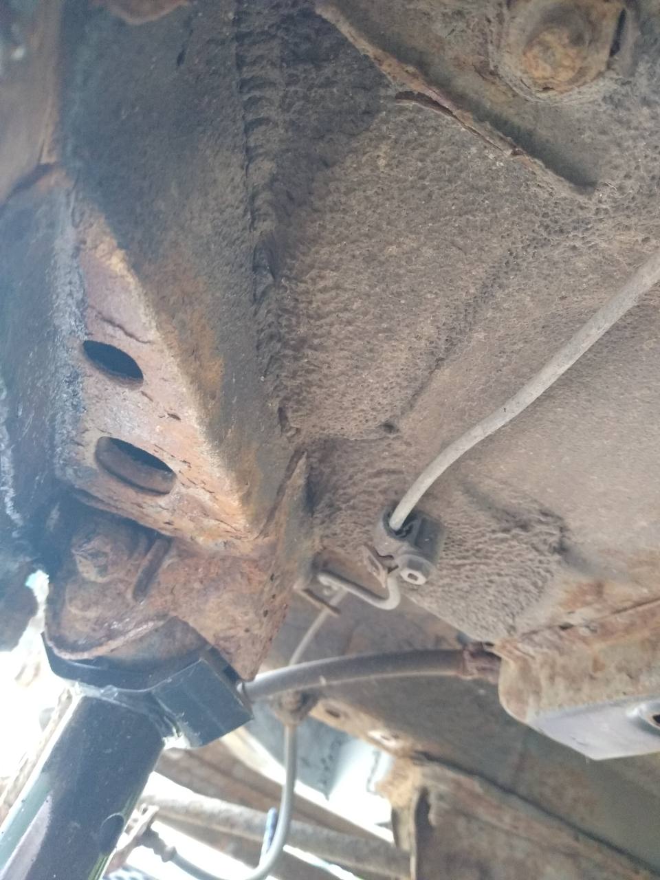

Can someone tell me if what I'm about to propose is adequate. That's the minimum for this, and you'll see why.
To avoid opening yet more cans full of worms, I'm thinking I cut most of the current repair out. Not all the way to the door shut, but enough for me to have good access to inside the sill.
At which point I can then cut out the inboard part of the sill which is next to the trailing arm bracket. The trailing arm is attached to that triangular gusset, not the sill. The gusset is connected to the sill.
This would then leave me with no inboard sill, but access to the back of the gusset.
At which point I would weld a butt joint to the inside of the sill, holes to allow spot welds to connect this sill back to the gusset. On the outside of this I would weld the gusset around nearly all of the new panel. I'm not sure how close I could get to the gusset when it gets to where the trailing arm is connected.
At which point I do what I did previously, replace the reinforcement steel inside which is missing, and weld the outer part of the sill back.
I think that would work? I think in my head I'm worried that the welds are on the inside of the sill, but then all of the welds are on the outside anyway?
I'd like guidance as otherwise I'm off to bang my head against my wall. Of which, I have many.

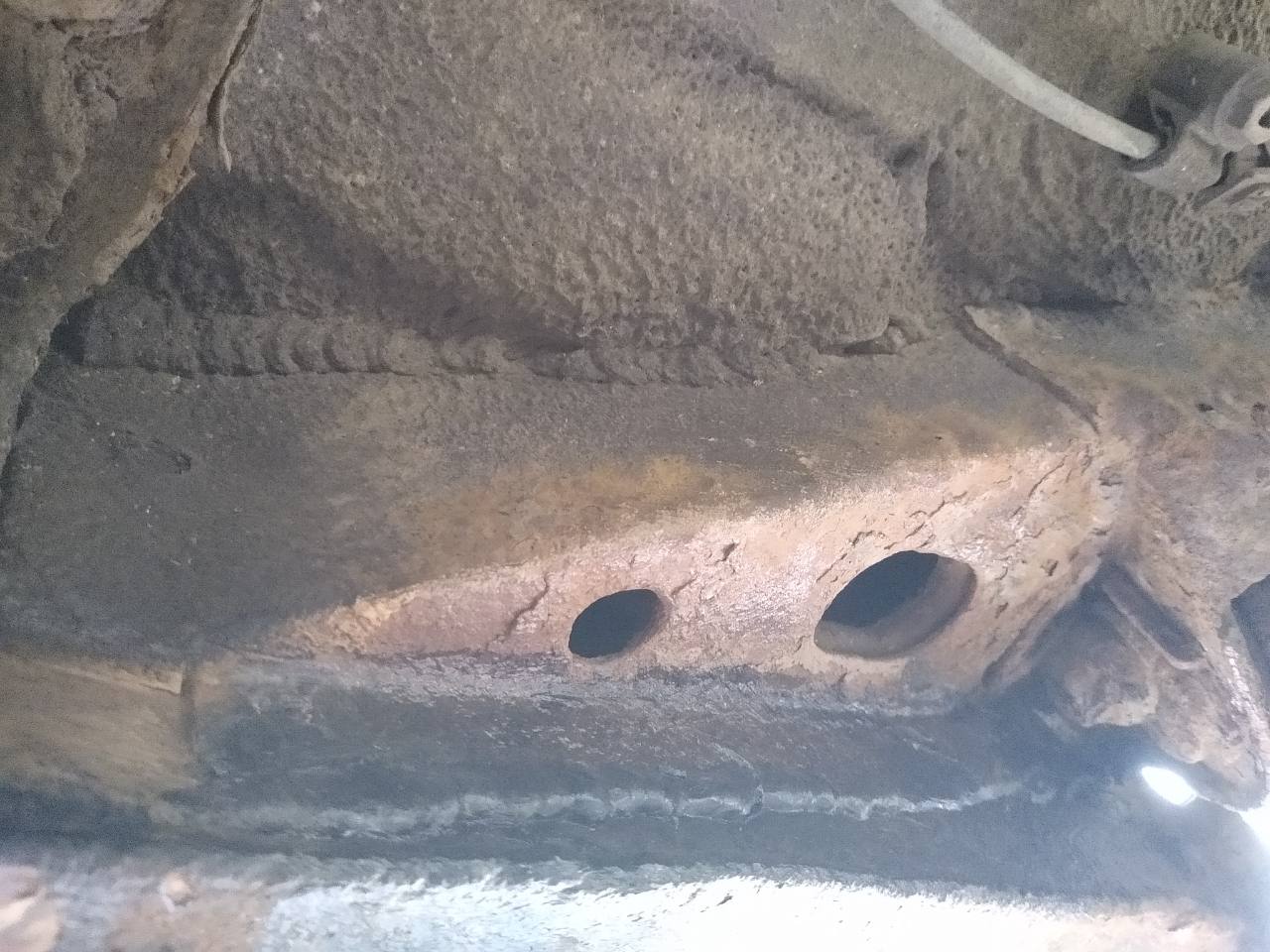

Here's a photo of the space involved and available.
I think it could work. It would mean having to get my die grinder out as the previous fucking wanker of a cockwomble already did some welding here.
I should also point out I've been vigorously smashing my screwdriver at all of this, the gusset and the trailing arm connection, and I can't make a hole in any of it.
I’d cut a good chunk of the outer sill off, and if needed weld it back on again after repairing it. Try and do as much as you can without being on your back welding, coz that’s just not fun.
Try to lop it off where you can easily weld it on, and grind back the welds after. Looks like the inner sill is spanked.

Providing the gusset is substantial I have no misgivings about your ability to repair safely as you suggest.
That's a massive pain in the arse for you. Well done on keeping the positivity going! I'd have found a cliff to push it over by this point I think.
