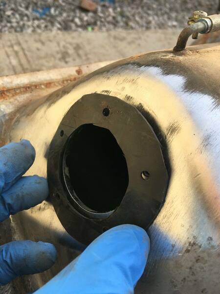

I have a friend that runs a fuel tank/repair/radiator repair business. He’s volunteering to clean and test the fuel tank for me one Saturday…. Thought I’d pull the level sensor out, I can start cleaning the gunk out myself. There’s a thick layer of gunk at the bottom! BD6EFF4F-24FA-42AA-BD03-38166FF34D50.thumb.jpeg.ced7bc7373c32b1078532bbd004c7337.jpeg
then all the breather pipes can be replaced as they’ve gone rock hard and fallen off.
So I’ve filled it with TFR, wheel cleaner and water. Jet washed the living shit out of the inside of the tank and left it for a few hours half full of water. Then drained it out. Made a new gasket out of fuel proof rubber for the level sender. Made it from card first

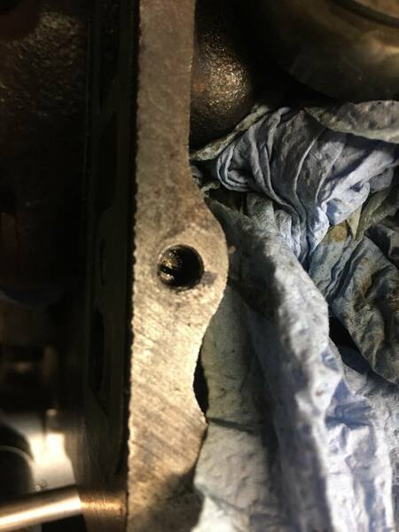

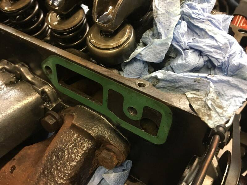

Small amount done on this today. Had to fix the water coming up through the rocker bolt thread hole.
So I cut about 3/4mm off the end of a bolt, put a slit into it and cleaned the hole.
sealed it with flange sealant. Then sent it home.
then I re did the timing and now it runs pretty perfect.

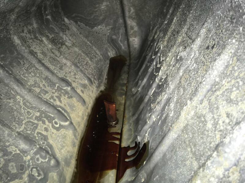

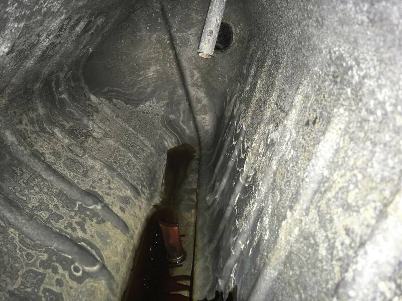

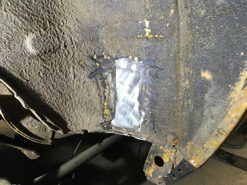

More work done today. Mrs sutty took me up to the unit and left me there until this evening. Thought nows a good time to get the rear seats in place, but what’s that at the bottom of the inner rear arches? Rust? Never! Oh…….
bummer! Same both sides. Better sort that out now. Start on the other side then. cut out the grotty bits. There is a seat belt mount here, which has a bung in it. I decided to cut that out and leave it out, as a 76 car doesn’t need rear seat belts.
new section in place
I hate underseal
but onwards we go!
made it a bit stronger then used the hammered effect underseal….
Bit of stone chip on that and it’ll be grand as owt.
view from inside, also now sealed.

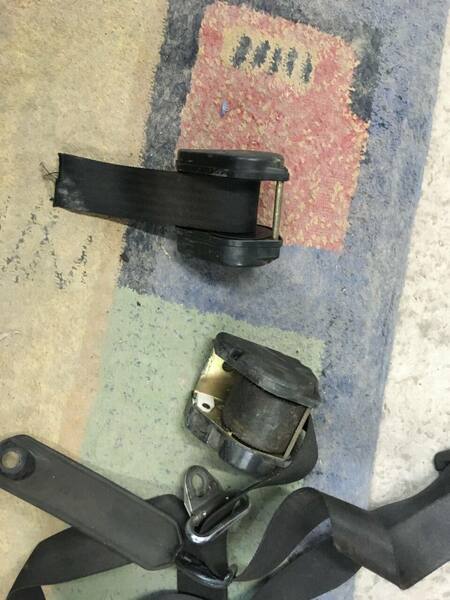

mrs sutty suggested I fit rear seat belts…….. thanks. Good job I kept these
rear end raised up for now. I can sort out the rear brake pipes and fuel pipes now.

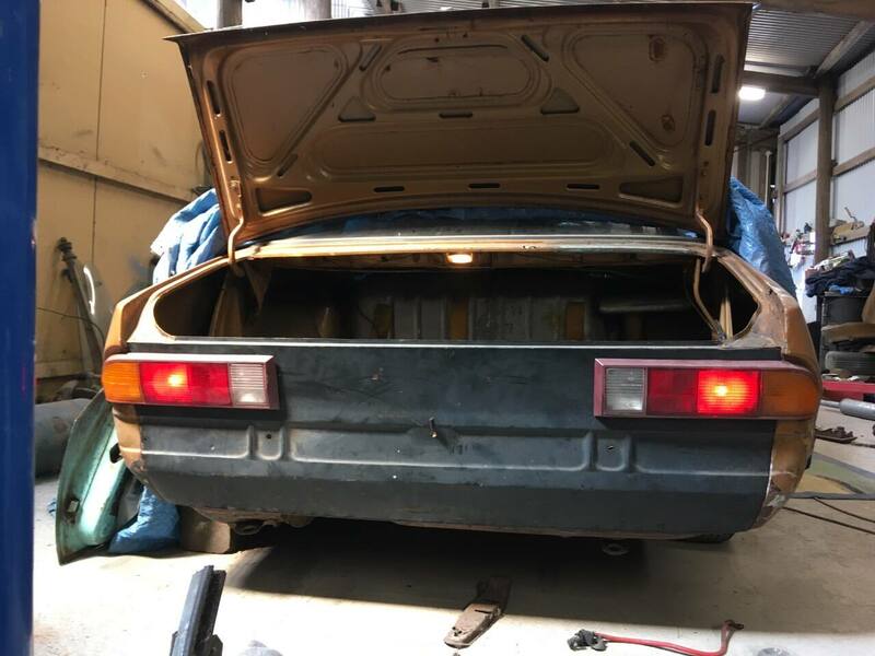

Also got the rear lights working. Including hazards which you can see currently in the “off” part of cycle. CB78FA8F-361C-4972-B568-49D0127034EA.thumb.jpeg.ff0248f5bf2d3dccf00ef1a13202fc87.jpeg
and refreshed the coil. The black box (transducer?) is known to have a heat sink paste between it and the body, so that’s been cleaned and reapplied.
and there were no seatbelts, so that’s had to be rectified with some seat belts I took out of one I broke over 10 years ago. Glad I kept those!

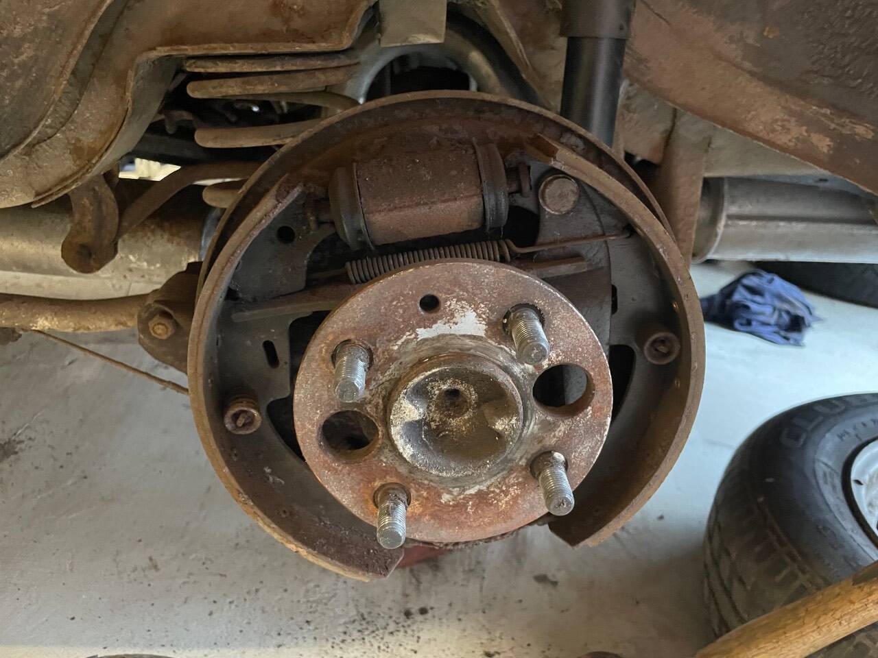

I need to renew the cylinders, so I’ve knocked the drum off. I was expecting it to be seized solid but it wasn’t.
No bear in mind, I’ve never removed these drums while I’ve owned it. So potentially been in there for 34 years. The shoes actually look ok, probably asbestos aswell, neat.
so at first glance, replace the cylinders then give everything a clean and freshen up. Winner.

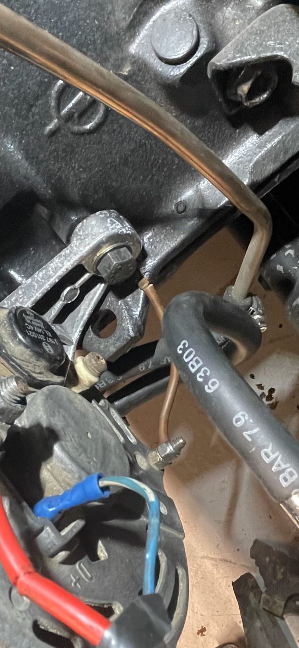

I had a little problem with charge, or lack of it.
I fitted a spare regulator of another alternator and it made no difference
so I buggered about with the earth wire from alt to block. And got some lightning from the charger whirler.
after shutting it down, then restarting, no charge. At all.
so I made a new earth wire up
fitted that, still no charge. Cleaned every connection up possible. Still no charge.
so I moved my theatre of operations into the dashboard. I pulled the top cover off and pulled the bulb out of the back. Looked ok. Seen it work once. But while I’m here, I’ll change it!
result?
full steam ahead!
volt gauge now displays charge, light works, and even my oil pressure light works now!
result.
