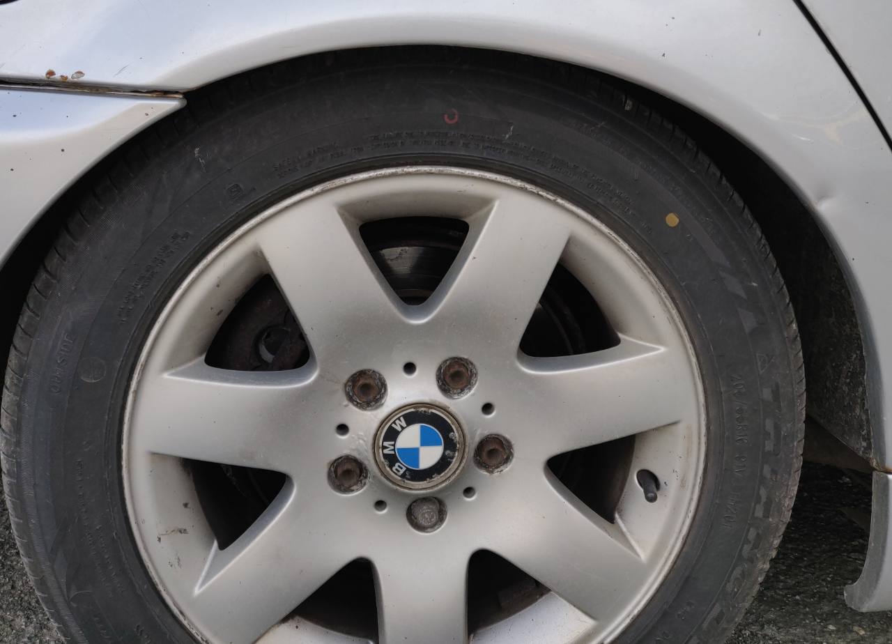

Next on the list was to replace the guibo Tim supplied with the car to try and cure the slight rumble coming from the rear end however in the last couple of days I've noticed a creak coming from the OSR suspension. I haven't had a chance to investigate it yet but today while washing the car I noticed that the OSR of the car appears to be sitting lower than the NSR - would that indicate a snapped spring?

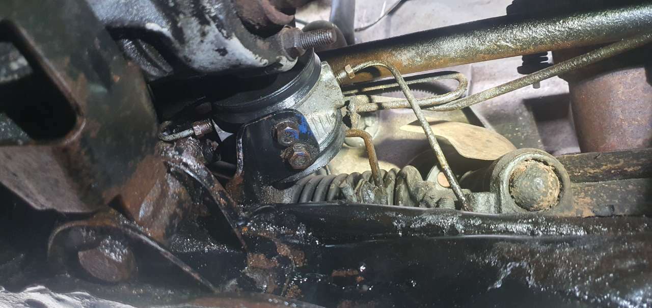

@Sunny Jim's BX has come to stay with me for a little while, to get a spot of TLC. We changed the drop links as it was doing the characteristic occasional clonking which happens when they get tired. Unfortunately that didn’t cure it, so a little more investigation was required. I thought I'd found the problem when I discovered play between the drop link upper taper and the ARB - it turned out that the nut had bottomed out on the thread before fully tightening on the taper. That was easily sorted with an extra washer but unfortunately the clonk remained.
It looks like it's one of the struts at fault - I've never stripped one down but wonder if there's a bit of a rebound bumper which isn't functioning as it should.
It actually drives really nicely, with a smooth ride so I would just try and get hold of a replacement strut at some point. (I know, easier said than done nowadays....)

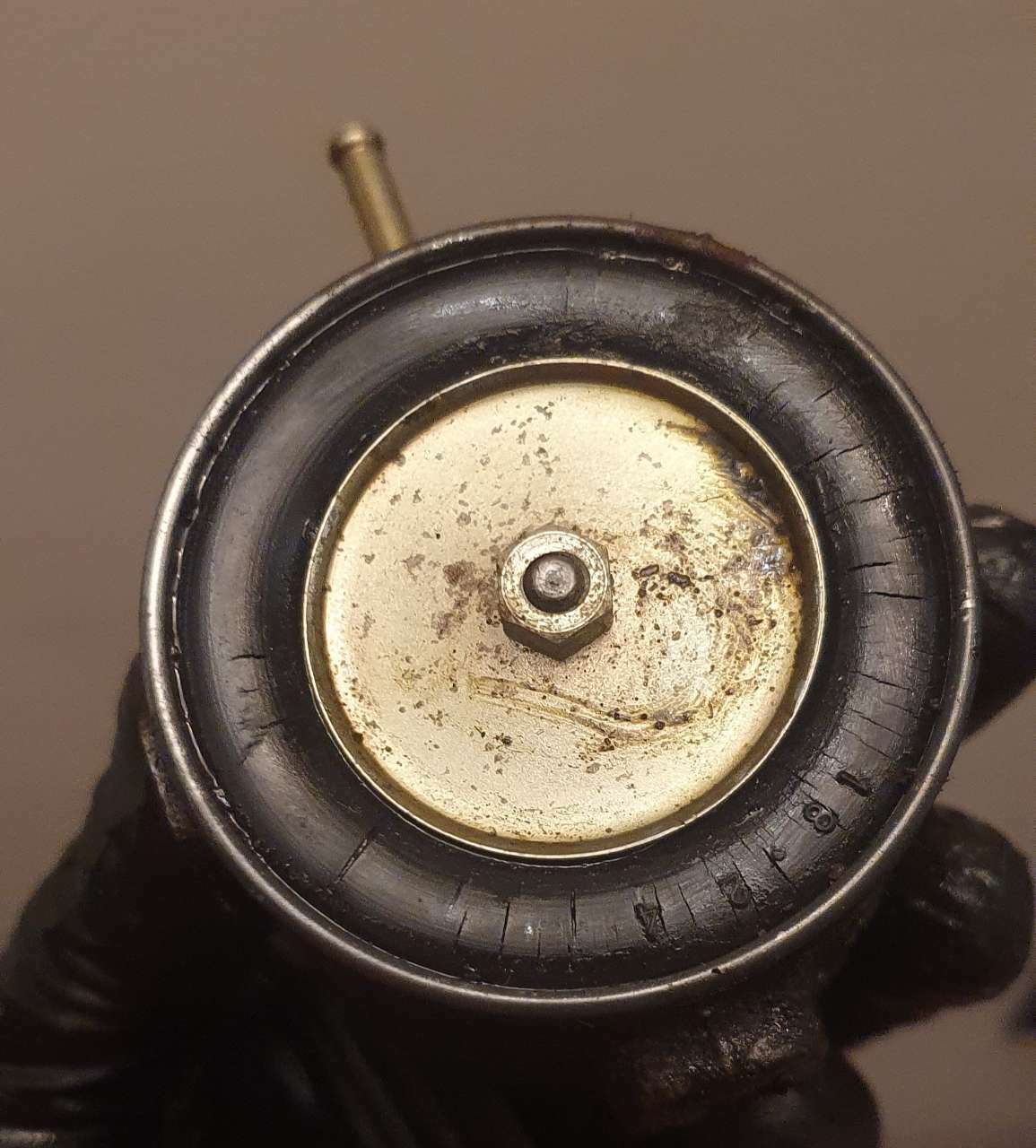

The other thing which needed investigation was an LHM leak from the front. I tidied up a repair to the octopus, but that wasn't the problem, or at least not the only leak. Popping the dust cover off the height corrector though, showed significant perishing of the diaphragm.
I had a rebuild kit on the shelf, so dunked it in petrol to clean it inside and out.
Hope I can remember how it all goes back together :lol:
There's some tiny orifices internally, which can get blocked with rubber fragments from wear of the various seals in the system.
This though, was the cleanest I've seen inside, with next to no rubber 'sludge' to clean out. Suggesting that it's been regularly maintained regarding LHM changes.

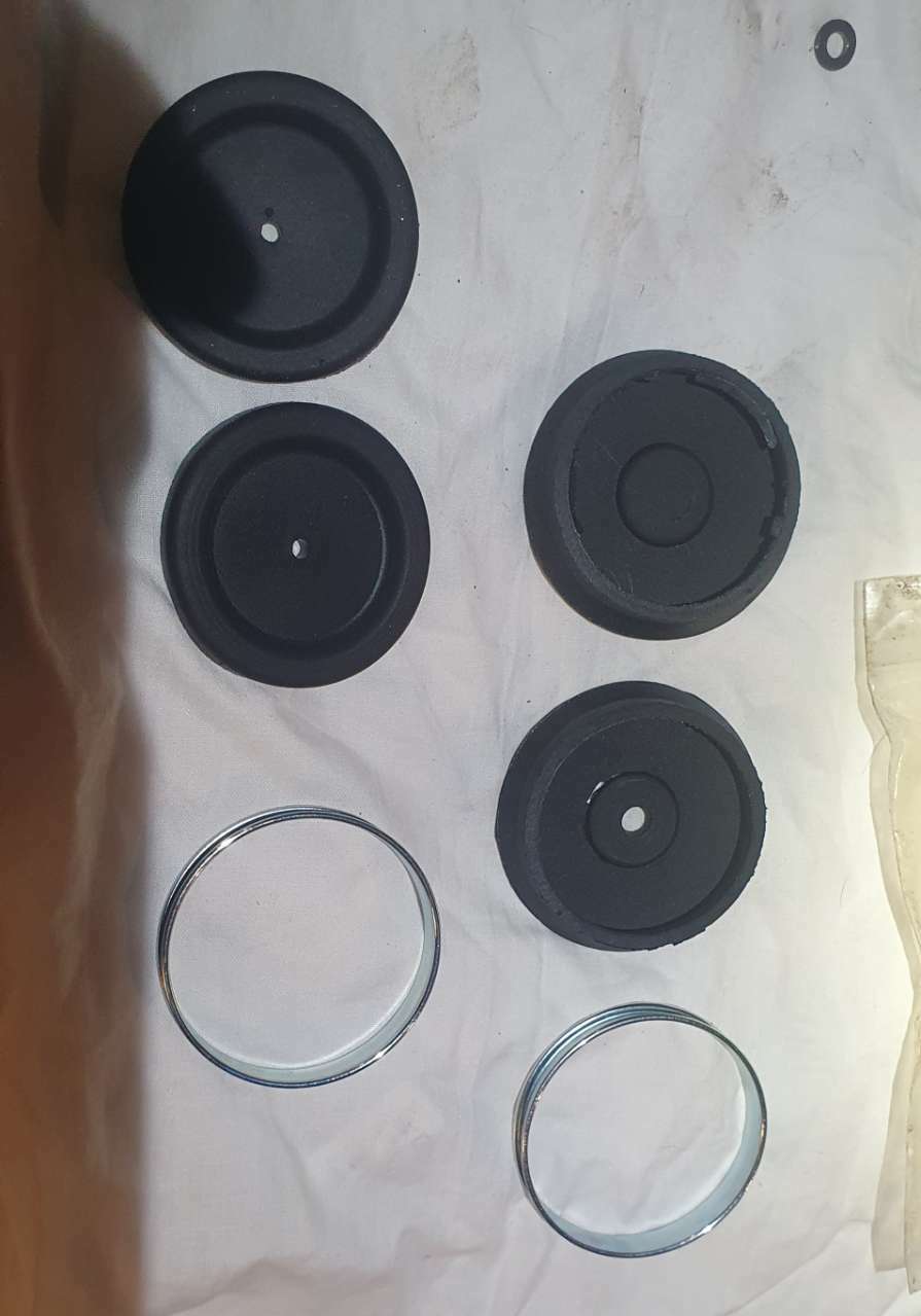

Here's the set of new rubbers.
And back together  before the dust seals go on.20221027_011857.thumb.jpg.e0f3358e24ba0e13a3d1776849af2aa6.jpg
Yep, not surprising that leaked!
