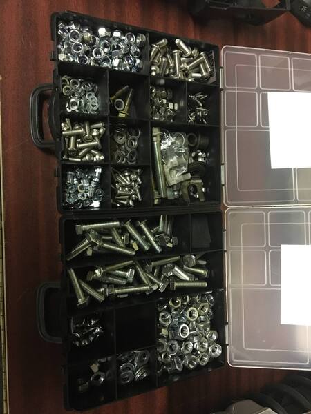

Not much to report today, I nabbed a couple of these parts boxes at poundland and organised my nuts :)

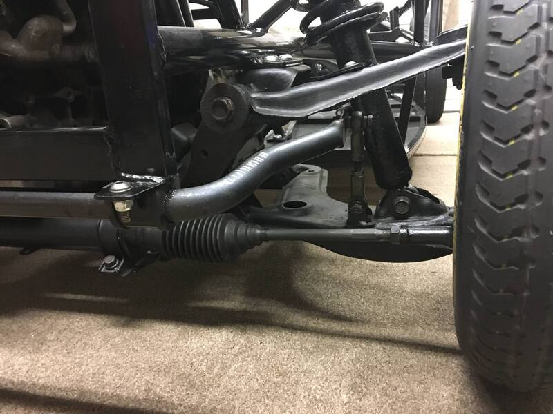

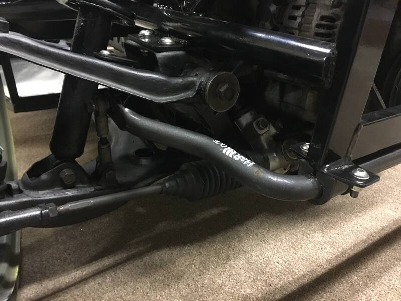

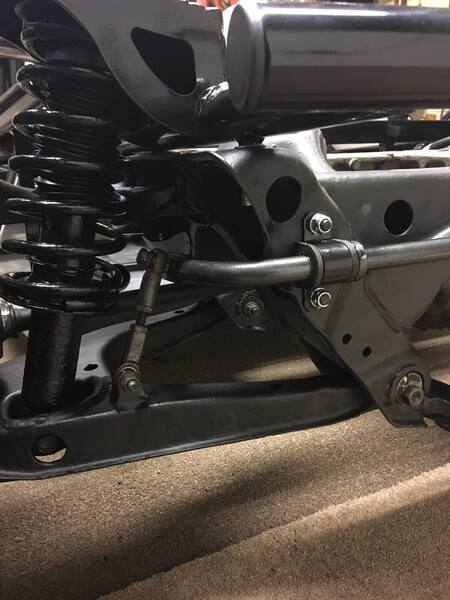

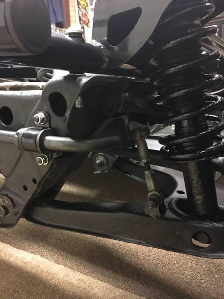

Then set about fitting the upgraded antiroll bars that came on the donor.
Adjustable ball jointed droplinks too, it's so nice to be working with clean parts now.

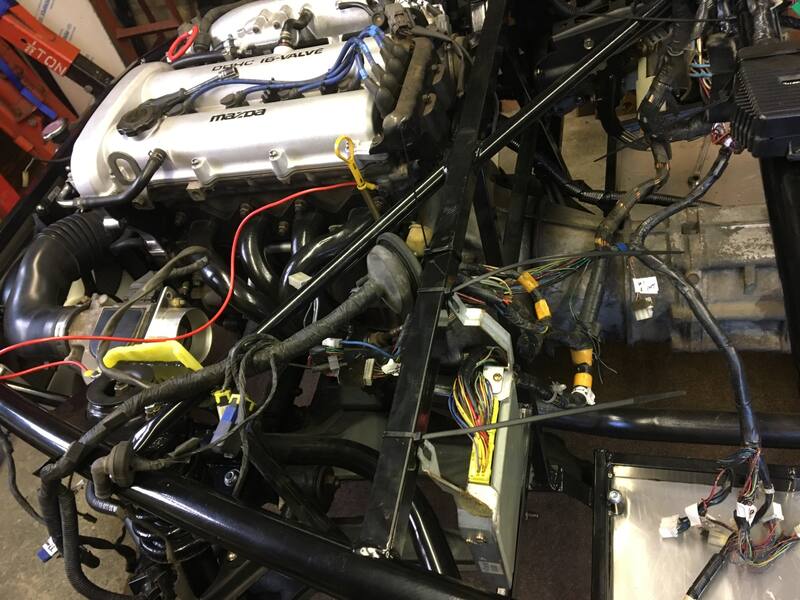

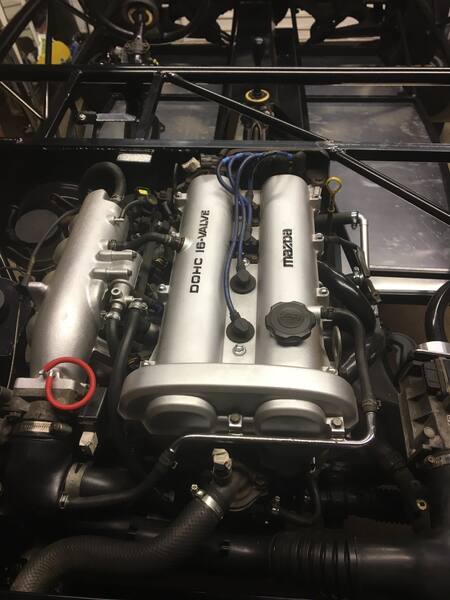

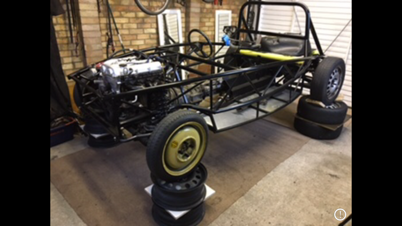

An up to date progress pic
look at all that space next to the exhaust manifold - it's crying out for a turbo really :)

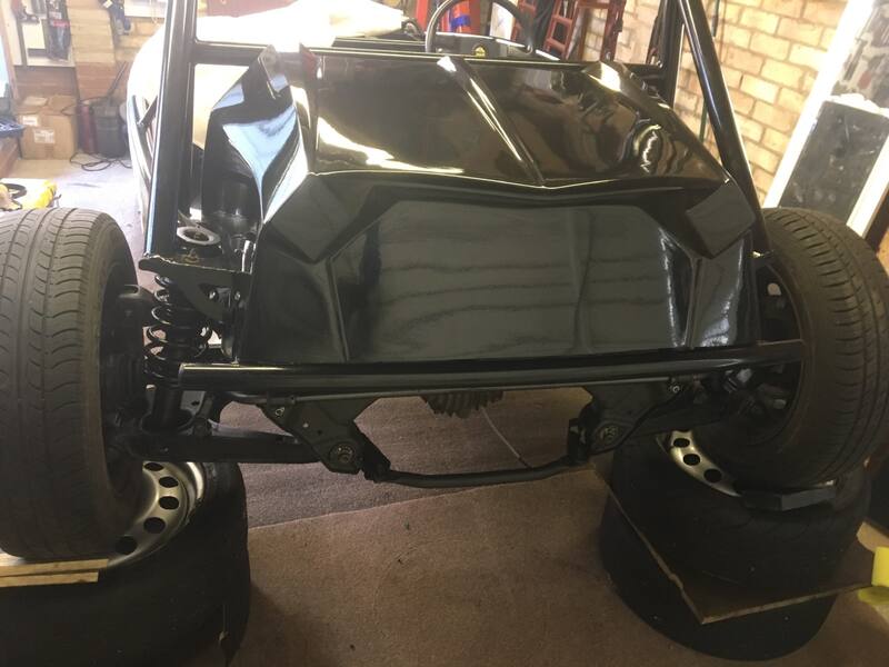

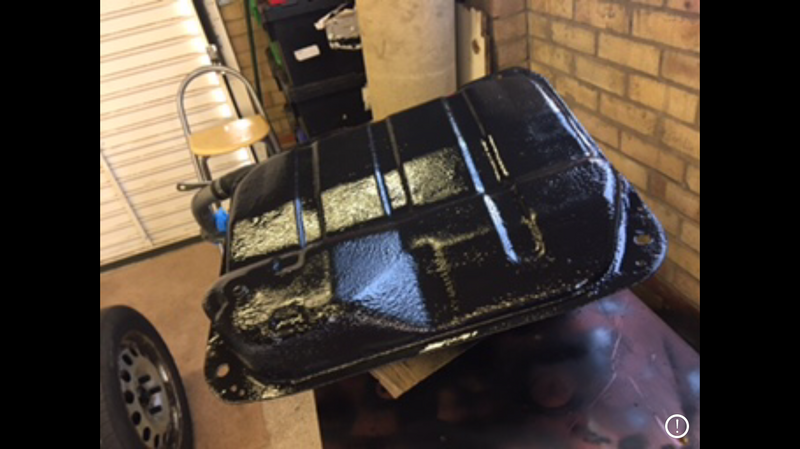

been a bit busy this week so not much progress to report :(

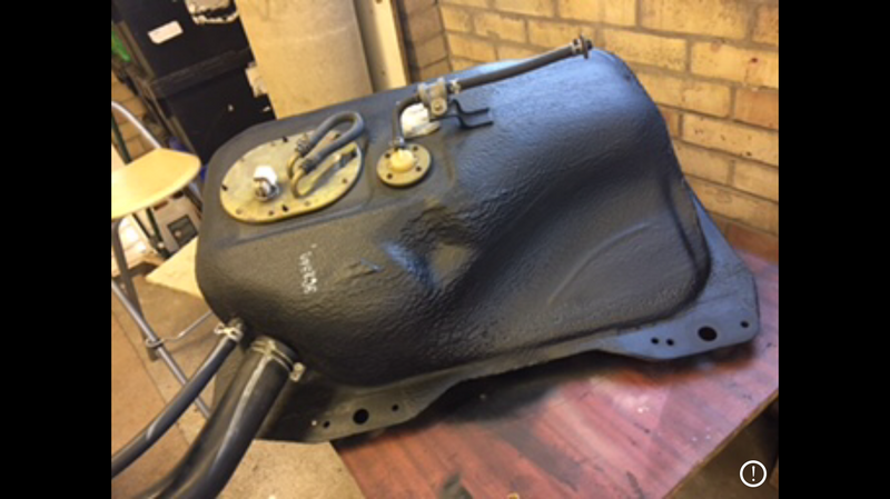

I can post pictures of a freshly painted fuel tank if anyone is desperate for an update but not much else has been happening

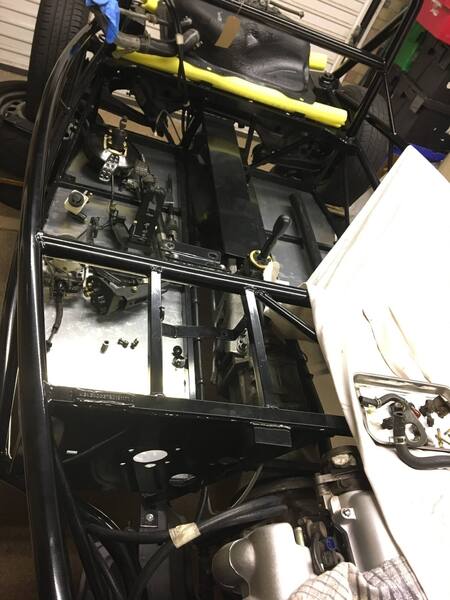

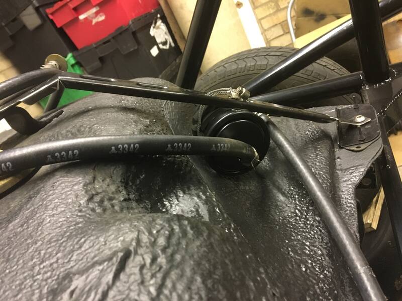

it looks like I’ll need to fiddle with the fuel lines a bit so did some very shonky lifting and got it at a sensible height to work on
all I need now is some free time !

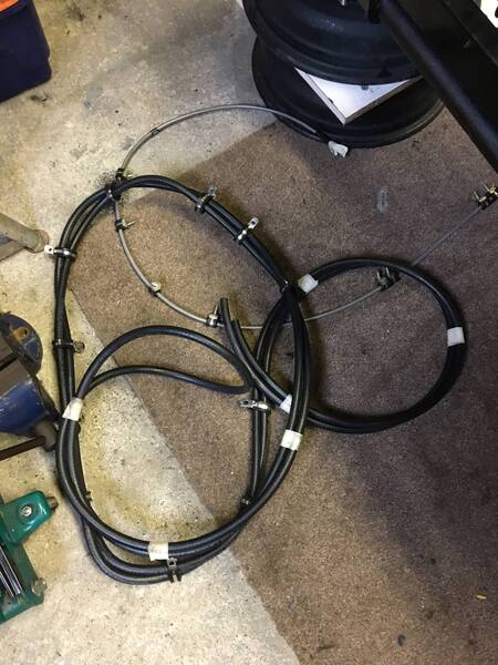

Remember those fuel lines i so carefully fitted while it was upside down ?
cocks !

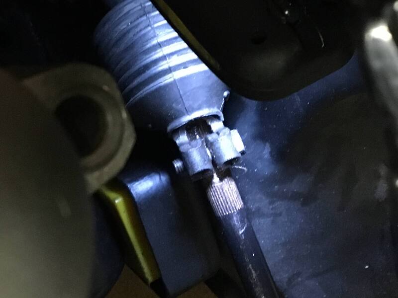

the reason being this little bugger

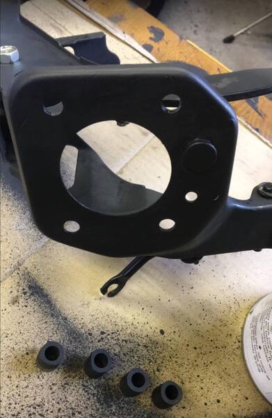

the steering column just isn't reaching far enough into that universal joint for my liking :(
The problem being those spacers on the brake pedal assembly should be on the other side of the bulkhead
some (surprisingly neat) grinder work later
and it's ready to go back on.
but first those fuel lines needed refitting once I'd fixed a few more P clips with the brake cylinder out of the way.
Currently it looks very similar to how it did last week but the steering is sorted and the fuel lines are connected at one end - little steps :)

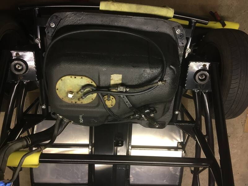

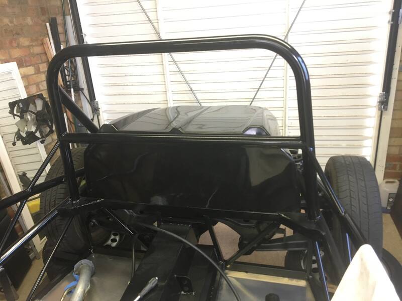

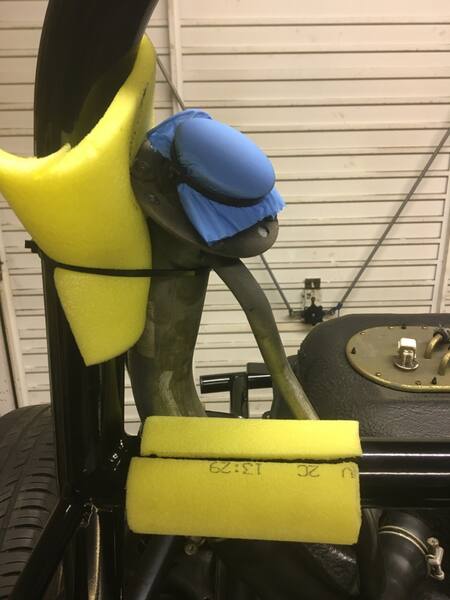

Time for a bit of an update - I've finally managed to fit in a bit of exo time over the last couple of days :)

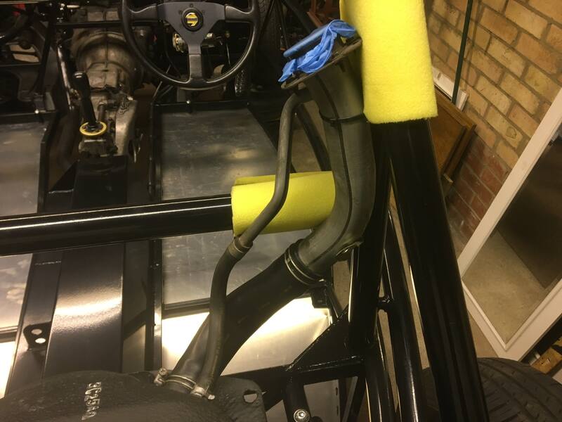

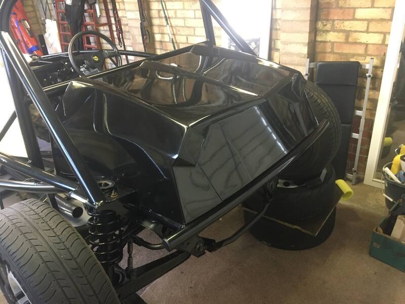

we'll start with the fuel tank, fitted nicely into place
I made a bracket for the fuel filter from the glove box bottom rail
then test fitted the cover
the fuel filler needs work :)
filler cap is missing in action ('cos some silly sod left his in the petrol station and needed a replacement :) )
I won't be using the standard filler, there are some fancy ones available, I just need to decide which to go for.

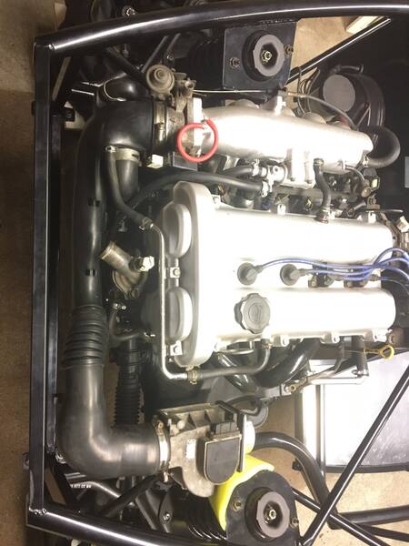

last job of the day was to fit the air intake ducting - I'll need to sort out some sort of bracket for the AFM
night, night, little exo, sleep well

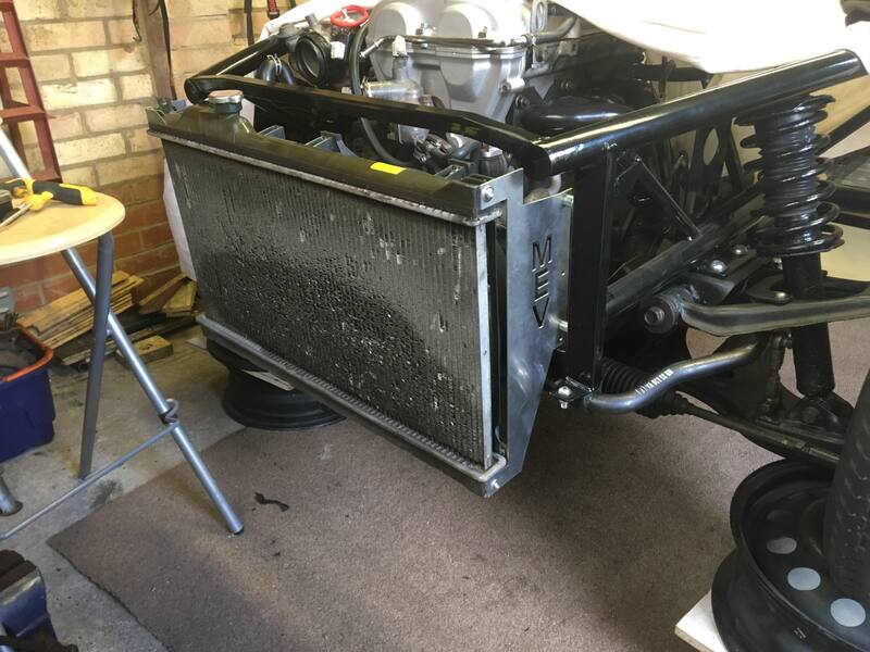

with the fuel tank sorted, the job I've been dreading edges worryingly closerIMG_9848.thumb.JPG.ed5fdb3301cb5cc64aba816e3e413aa7.JPG
But there's no point in doing the wiring unless I've got the cooling sorted :)

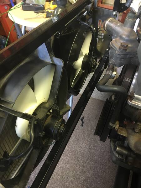

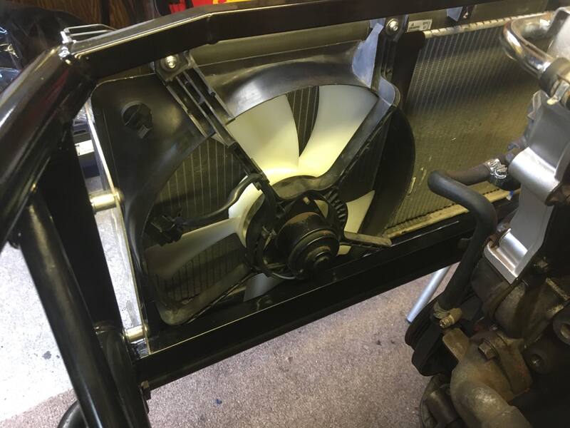

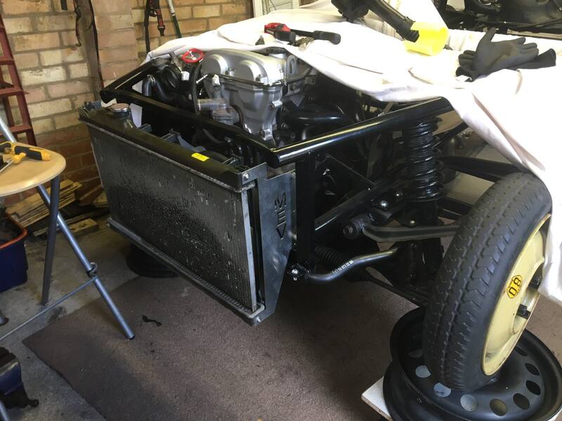

this is the old radiator off the donor car, I'll be replacing it with something a bit beefier but it will do for now. I stripped the fans for cleaning and gave the rad a good scrub and flush out.
Much drilling later
looks very exposed, I may need to make some sort of guard tray for the bottom.
cooling fan fitted
but seeing as I still had the aircon fan, it might as well go in there too
a bit of wiring and we are fanny-tastic
suction is good
air intake back in place (need to find a neater solution than all that black plastic gubbins)

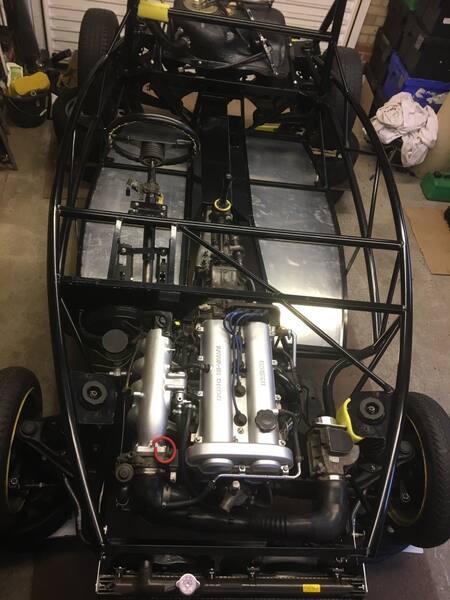

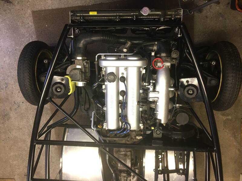

plan view

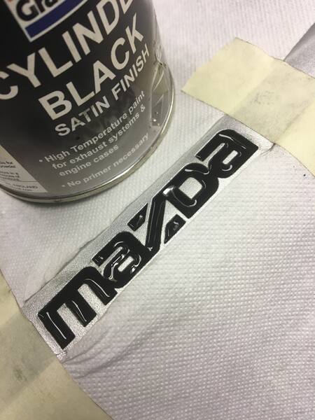

As further procrastination was required, I did a bit of colouring in
using a chopped up cotton bud and a steady hand...
I'm fairly pleased with that

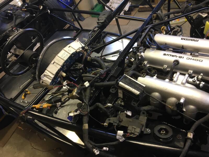

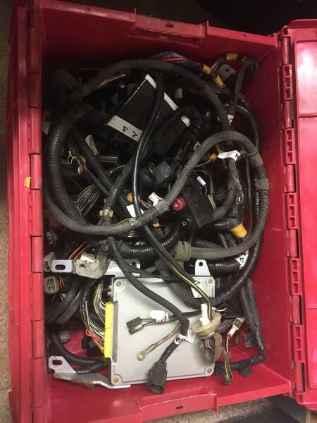

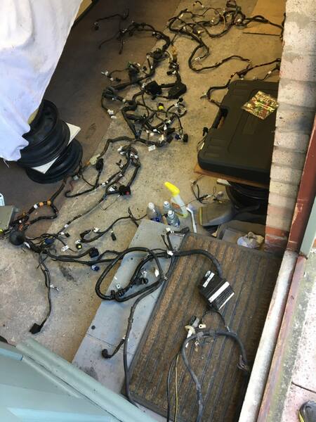

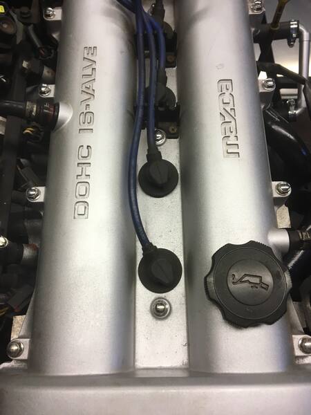

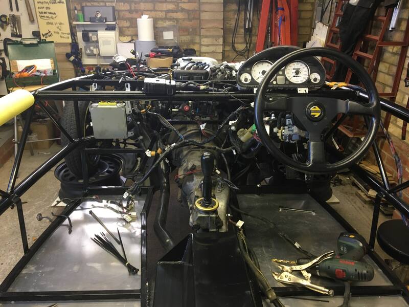

right then, Pandora, let’s have a look in that box of yours..........
holy shit ! run away !
this may take some time, if I go quiet for a while, send beer / pizza / the men in white coats :)
Thankfully most of the labels are still legible, a careful couple of hours has created this mess
will it start ?
you’ll just have to wait until after lunch to find out !
  • gm changed the title to gm's unhealthy obsession with mx5s - pandora's box of electrickery
wiring looms are great when they are well made, tested and labelled clearly and legibly, not scary. mate makes his own looms from scratch for rally and high spec cars, work of art seeing them getting built on the wall/bench
Amazingly, the electrics all seem to be behaving themselves, so it's time to nip along to the garage and purchase a can of pez and we'll see what happens next :)
  • gm changed the title to gm's unhealthy obsession with mx5s - pandora's box of electrickery (with bonus swearing caught on video)
