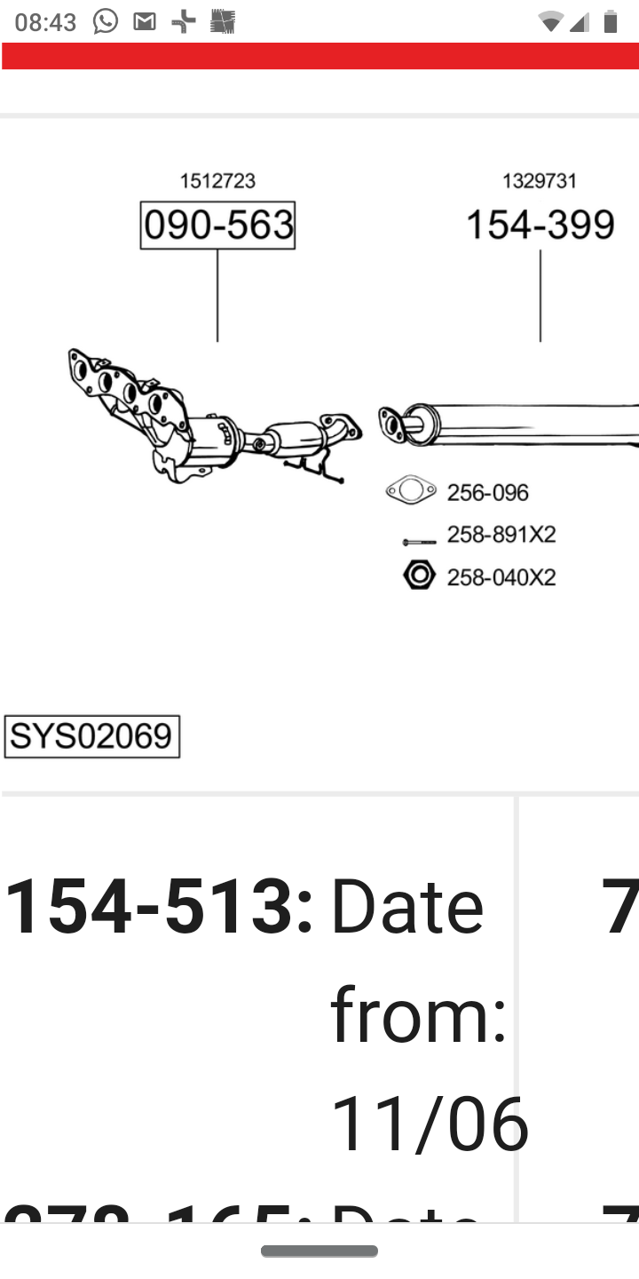

I think the exhaust manifold is a manicat,so the part will be expensive,but surely a broken mounting bracket will be able to be welded back together,if that's the problem.

This is the picture in the Bosal catalogue.It looks like manifold,cat and Flexi are all one.Which is around £500.
Even for Bosal shit £500 seems cheap for a combined manifold & cat.
