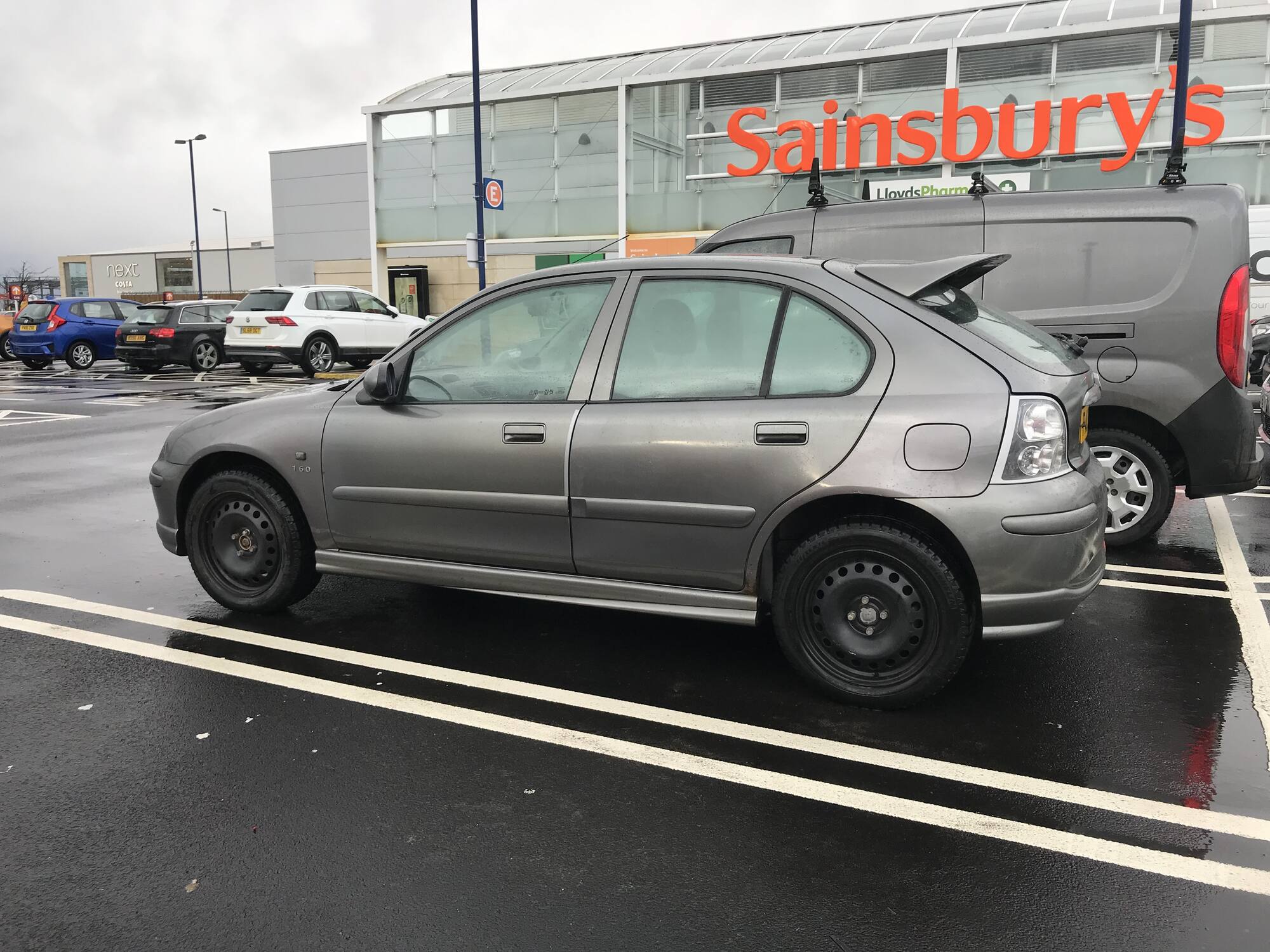

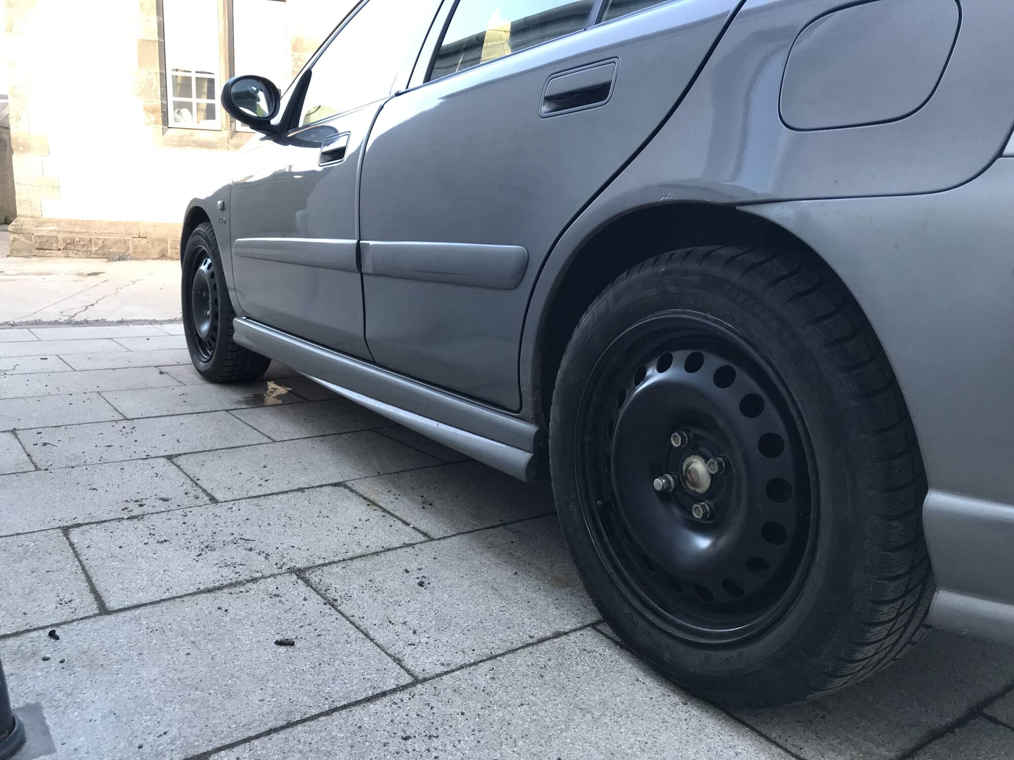

Today I replaced a perfectly suitable set of 17" alloys in factory silver with nice performance tyres for a shite set of poverty spec steelies with some crappy old Michelin winter tyres. I figure summer is just around the corner so these should see me through to when I weigh the ZR in, roughly early autumn time I'd guess. The nice alloys with expensive tyres I was just going to leave in my garden where the neighbours can see them until about 2023, at which point the council will have ceased to do home collections of bulky objects and I'll have to take them to the dump myself.

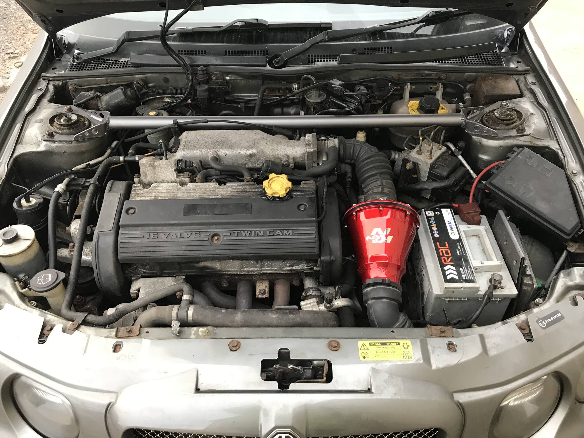

Air Filter - DONE
Fuel Filter – To Do
Coil Packs, Leads and Plugs - DONE
Coolant Change – To do
Remapped ECU - DONE
Secure Battery -  DONE
New exhaust – DONE, £50 stainless number from a scrappy. Slight concerns it won’t pass the noise level requirements.
Brake discs and pads – DONE
Winter tyres on steelies – DONE
Strut Brace - DONE
Harnesses – DONE.
Lights and stopwatches - DONE
Spare Wheels – DONE
Tool Kits – DONE
Graphics - DONE

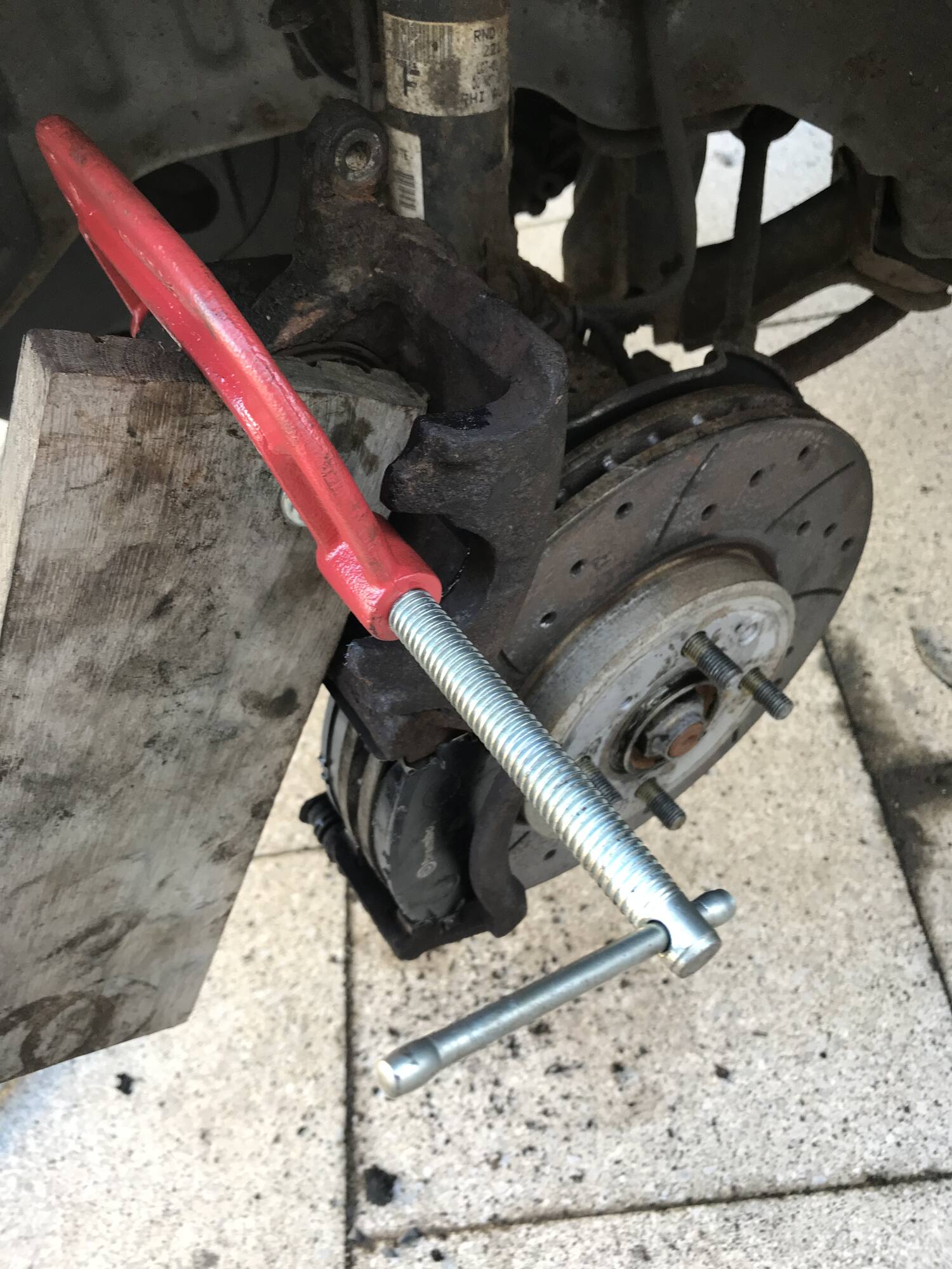

Fitted the discs and pads. Great increase in stopping power, expecting bite to improve with a bit of bedding in.

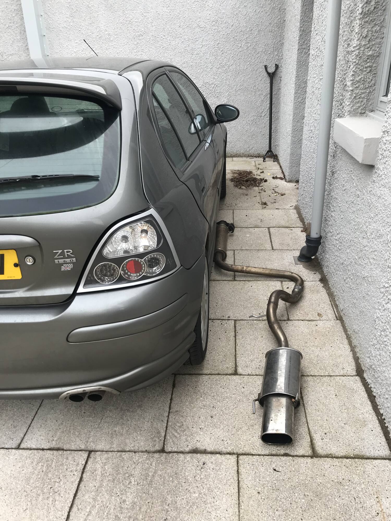

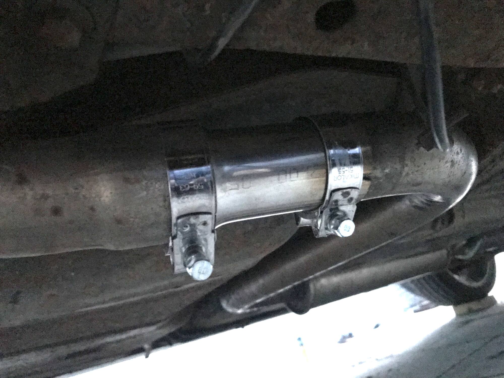

Remade the exhaust centre to rear joint using a custom swaged S/S reducer section and a couple of Mikalor clamps. Good strong joint now. Tested it with a dB meter and it measured under 90dB at 0.5m at 4500rpm so I think it should pass scrutineering ok, they might fail me for delinquent noises though.

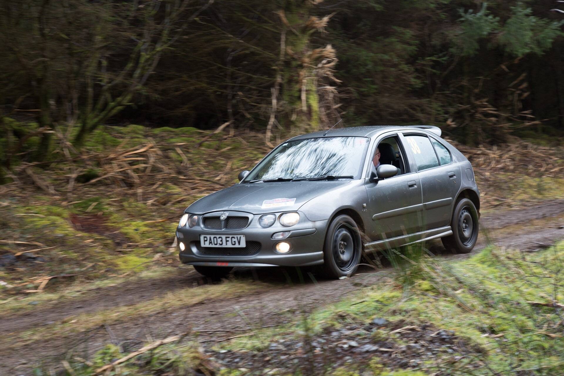

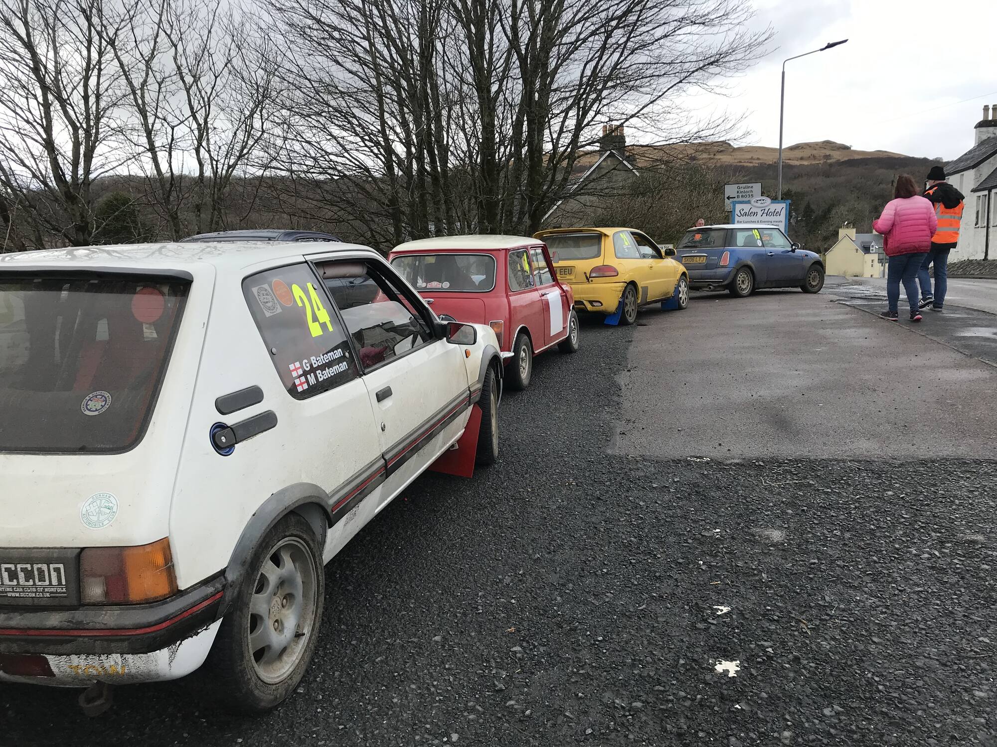

UPDATE: Mull Classic Rally - 1 day
Car prep has gone ok in the end. I took the car out on a few hard runs over mixed broken/undulating surfaces to see how the suspension coped and the answer was not that well. The front shocks bottomed out pretty quickly on the bumpy stuff and ground clearance was limited. As I don't have a sump guard I reckoned the easiest (and cheapest) option in the circumstances was to replace the struts with a set of low mileage Rover Streetwise struts (£50 for the set!). These have raised the ride height by approx 50mm + a bit from the big winter tyres. Ride is much better, rides the bumps with easy and you could probably lie underneath the car now! It also gave me a chance to go over the suspension and the rest of it seems fine. Car looks ridiculous now, a bit like something from the base model misery thread. Perhaps I need to remove the side skirts, spoiler and badges to complete the effect.
Everything else has gone to plan so hopefully scrutineering will pass without incident.
Safely home now, and just put the child seat back in!
First of all, a massive thanks to everyone on the organising team for putting on an exceptional event, and to all the marshalls that braved the rather moist weather!
The car was brilliant, didn't falter once despite taking quite a pounding. The last minute suspension change made all the difference and the car didn't bottom out at all. I've got a loose exhaust heatshield (which I'll have to rip off) and one of the rear brakes was slightly binding yesterday morning so I freed off the caliper sliding pins in Oban and now it seems fine again. As everyone said beforehand in reality with M+S tyres on the wet forest tracks you can't really get the power down and actually a small 1.3 or 1.4 is probably optimal for FWD cars.
The rally itself was challenging but the route and navigation was fair and not likely to catch out the participants. The forest stages were awesome, with more grip around corners than I expected but less under braking. My biggest problem was inability to execute a proper handbrake turn around the 270 and 360 cones, especially the really tight ones. I'm going to do some autotests to work on this skill. The regularities actually went pretty well, I think we were about 3 minutes out over the 5 sections which was better than I expected and I think with another stopwatch, a more accurate trip meter and a bit of practice we could improve on that. Overall, I'm really pleased to get around the course with no navigational errors and doing every test without any maximum times.
The winners in their Rapier were very impressive, but they were too far away from us to see them in action. I did however see the 2nd place finishers in the MX5 in action and they were really, really quick.
