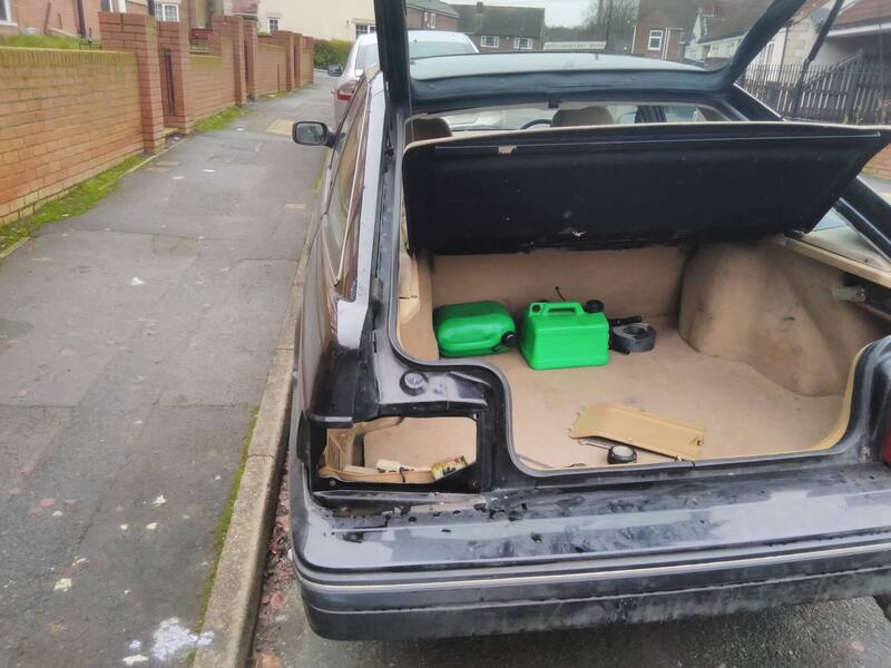

Motown Posted December 27, 2019 Posted December 27, 2019 So despite the cold weather and being full of flu i decided to fix the the rear light gasket which was leaking and filling the boot and spare wheel well with rain water. I bought some A4 sized 6MM thick foam off Ebay and cut a new gasket using the old one as a template. Upon removing the light from the car i was surprised how good the metal work is for a 30 year old car... No rust that i can see car needs a wash though... video-1577459174.mp4 The light was full of water and some horrible rotted green shite! video-1577459177.mp4 My throat was killing by this point ? video-1577459178.mp4 Skizzer, Dick Cheeseburger, The Moog and 4 others 7

Motown Posted December 27, 2019 Author Posted December 27, 2019 3 hours ago, Austin-Rover said: Just done this very job myself on my 820! Sadly, I had to follow it up with running a dehumidifier inside the car for two weeks... but it is watertight and dry now! Nice to see someone else from Yorkshire with an 800 I have heard some horror stories lucky for me i caught it early on the new gasket seems to have worked too so chuffed to bits. Glad you managed to get yours sorted unchecked it can cause alot of problems for the car and i think the Rover 800 Series is a car worth saving!
