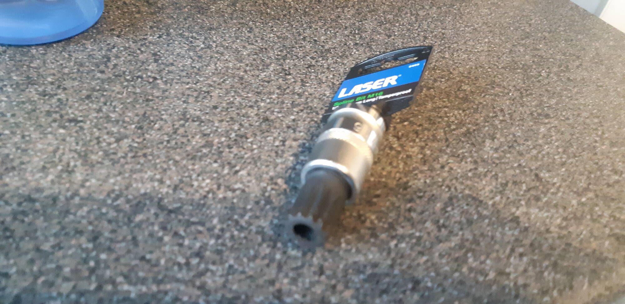

On ours it is same as the drain plug - 12 spline tamperproof plug. I have ordered the removal tool which is hopefully coming tomorrow - no point in buying the oil unless I can crack the filler and drain plugs.
This is what you need to undo the drain plug. And in my case, the filler plug. It cost a tenner.
I took the precaution of cracking both open before ordering the oil. £ 23 for 4 litres of 75w90 synthetic.
