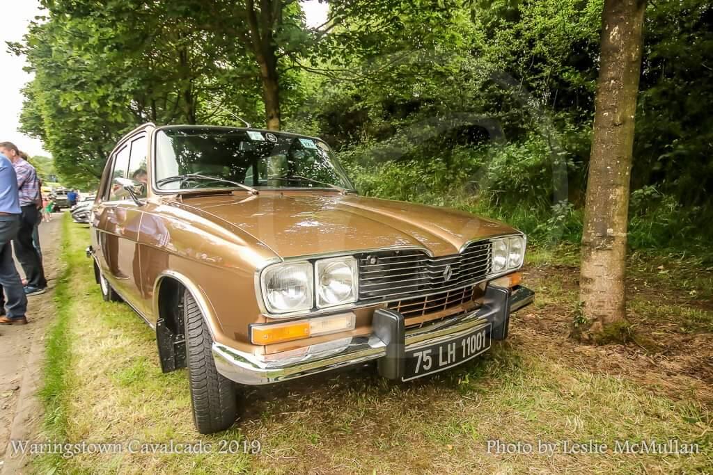

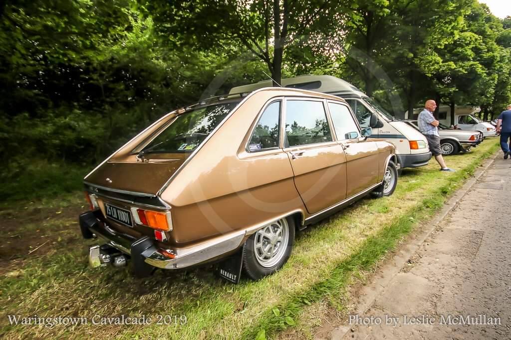

Here’s mine:
Thanks guys. That one is very similar to the one I’m looking at
1 hour ago, Faker said:
At a car show I attended in norn iron recently
