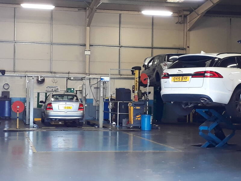

Brake pipe advisory on the Corsa and the two back tyres are getting on so priced up a new pair at 42 quid each. But as it only does about 3k a year there's a little while left in them.
Due to previous emissions fails/advisorie in the history of the Astra. A dam good thrashing prior to going in for the test saw it through. Front shocks are getting tired aswell.

Good news on the MOT front.
When I was cleaning the Corsa last weekend before the MOT I twinged my back, must have be scrubbing a bit at a funny angle and it just went. I then continued to work with said bad back changing hand brake cables and fixing the heater cable under the dash. Not fun.

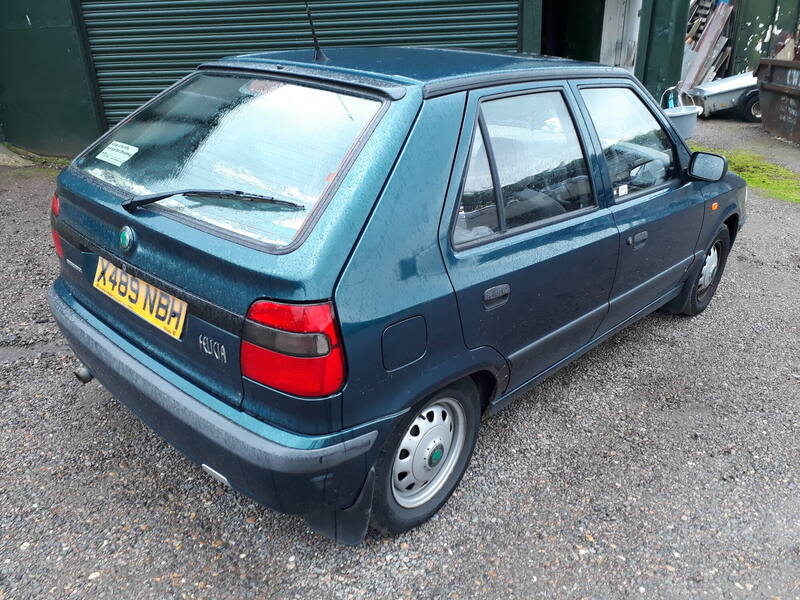

November sees mother-rews Felicia due for its MOT.The cars used for taking the grandkids to school, pottering about locally and to her weekend job at a local stables. I took the car up to the workshop for a check over and gave it a dam good thrashing  So the cars covered in kids crap and smells of horse poop inside. And outside it's grime, tree sap and moss.
Today was just to clean the car and give it a quick look over, next week I'll do a service, get the wheels off and give everything a check over.
Car was washed, clayed, waxed and the rear number plate was taken off and machine polished. You can see in the picture it had gone Matt and made the plate look pale. It's warped and the backing is lifting but I cant bring myself to fit a new one as it's the originals on the car.
They are good cars, simple to work on.
Although This one's only still alive because I won't let it die, mother-rews attached to it as it belong to my late grandfather and he gave it to her when he stopped driving.

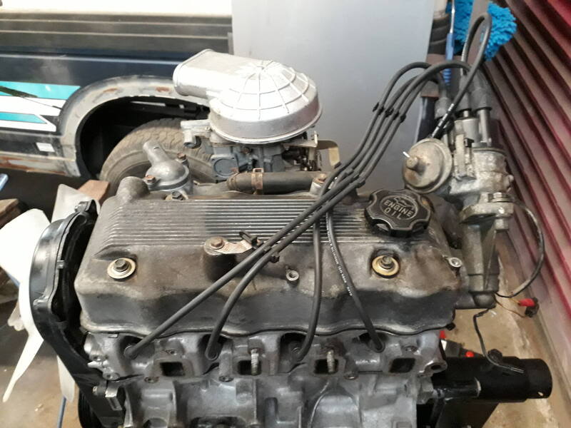

Some suzuki progess over the past few weeks. One out, one in.
With the old lump removed it was robbed of its sump and pick up pipe. The sump was full of almost tar like oil so I'm glad I never bothered with this engine.
Some more bits bolted to the new engine and the gearbox was given a quick clean up aswell. Suzuki alto aluminium rocker cover and Webber carb bolted up, found a dizzy in the pile and chucked on new leads cap and arm from work.
Cut out two blanking panels and bonded them too the bulkhead over the old pedal box, and columb holes. (this body was from a LHD Spanish car)  I then painted the bulkhead in black stone chip paint. And shove the engine and box back in.

Day off today, so time for some some more Suzuki fondling.  Today was cleaning up and refitting the little bits around the engine.
On this Sami I'm fitting power steering, a common mod on these and is fairly simple if using the Jimny steering box and you already have a vitara engine fitted. I don't have a vitara lump but this very late 1.3 import engine has the bottom pulley for A.C so some rework on the pump bracket will be needed.  for now the focus was the pipework.
These pipes are from a vitara and don't fit. A common thing to do is get a new flexible h.p line made up and fit that. But I took the cheapskate way and straighten out and re shaped the pipe. Not perfect but it's good enough.
With that in, I'd need to address the reservoir, but for that id need a rad to put in.  Cheaper on eBay than I can get one through work. But I wanted to get it in today. So . . .
I pinched the fairly new one that was in my other sadly now very rough samurai tin top.
Before putting the rad in I wanted to make a bracket for the N.s brake pipe. These normally have a kind of undertray that gets in the way and the pipe clips to that. Having binned that along time ago a simple bit of angle and some holes for P clips will be the replacement.  Handily I have  the chasis on the floor for my KJA sj. Did I mention I've had too many suzukis?
Fitted to the Sami the bracket it's a tad close to the sump so some angle was added to the angle.
