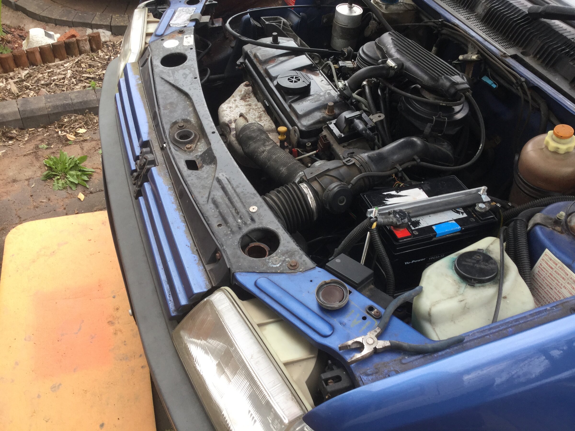

Tamworthbay Posted May 5, 2019 Author Posted May 5, 2019 So finally got around to changing the coolant. Apart from a very rusty hose clip all was good. Even the old coolant looked remarkably clean so I am guessing it’s not been in there long. Having seen it it probably didn’t need changing but it can’t harm can it? Also isolated the oil leak which is from the gearbox so I need to investigate that a bit more. It’s nothing major so not too urgent. GrumpiusMaximus, strangeangel, Aston Martin and 1 other 4
purplebargeken Posted May 5, 2019 Posted May 5, 2019 Rusty hose clips are the work of Old Nick. Just keep topping up the gearbox oil and in 6 months time you'll have done an oil change . Sorted!!! Good work mate. Tamworthbay 1
strangeangel Posted May 5, 2019 Posted May 5, 2019 I didn't change the coolant, but there was evidence of maintenance being performed before me - maybe there's something in the big folder? Good going, though - I never paid it such attention!
Tamworthbay Posted May 5, 2019 Author Posted May 5, 2019 1 hour ago, strangeangel said: I didn't change the coolant, but there was evidence of maintenance being performed before me - maybe there's something in the big folder? Good going, though - I never paid it such attention! It must have been at least a couple of years old then which is a really good sign. I wouldn’t have been surprised if it had been changed a couple of months back so the engine waterways must be nice and clean. I am happy to spend time on it, it’s such a nice little car I want to make sure it’s good for many years to come. I have fancied a 205 for years but never got around to one before, I have been missing out. GrumpiusMaximus and strangeangel 2

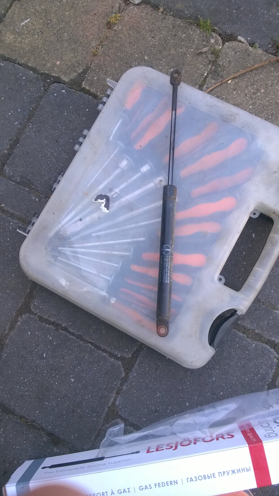

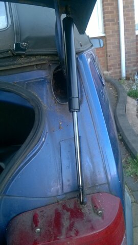

Tamworthbay Posted May 14, 2019 Author Posted May 14, 2019 Hi Another little job sorted tonight, the saggy boot lid is now nice and firm thanks to a new gas ram. I hate boots that droop and with a crap neck I don’t want it dropping on me. It took about 100 times as long to find one as to fit it. Also ready to go is a pair of new rear shocks to replace the aged and mismatched pair presently on there. I haven’t heard of Ridex before but they get decent reviews and were on offer for a third of Monroes so I thought they were worth a punt. With any luck they are going on on Friday. Lacquer Peel, rainagain, GrumpiusMaximus and 3 others 6
strangeangel Posted May 14, 2019 Posted May 14, 2019 Ah, well done on the gas ram - that was properly annoying. Not enough to motivate me to find and buy a replacement, mind ? Tamworthbay 1
Tamworthbay Posted May 14, 2019 Author Posted May 14, 2019 1 hour ago, strangeangel said: Ah, well done on the gas ram - that was properly annoying. Not enough to motivate me to find and buy a replacement, mind ? Weirdly it started holding after I ordered a replacement, then went back to normal after a couple of days. Finding it was the hardest part, none of the usual places had one but I clicked for an email update on it as an out of stock item at Autodoc not expecting them to get one, but a few days later they were in stock. And only £17 so not stupid money. Lacquer Peel and strangeangel 2
Marm Toastsmith Posted May 14, 2019 Posted May 14, 2019 48 minutes ago, Tamworthbay said: Weirdly it started holding after I ordered a replacement, then went back to normal after a couple of days. Finding it wasn’t the hardest part, none of the usual places had one but I clicked for an email update on it as an out of stock item at Autodoc not expecting them to get one, but a few days later they were in stock. And only £17 so not stupid money. Mine's OK with the roof up, but with the roof down the boot lid doesn't lift up quite as high, so it's supported fairly weakly, and occasionally drops it on your head. I'd like to replace the struts on the roof - I'm not sure they're doing anything much - but I couldn't find replacements anywhere.
Tamworthbay Posted May 14, 2019 Author Posted May 14, 2019 50 minutes ago, marm said: Mine's OK with the roof up, but with the roof down the boot lid doesn't lift up quite as high, so it's supported fairly weakly, and occasionally drops it on your head. I'd like to replace the struts on the roof - I'm not sure they're doing anything much - but I couldn't find replacements anywhere. I haven’t really looked at the roof mechanism beyond a simple oil of the joints. Mine seems to work ok but it helps to be directly behind when you start putting it back up and you have to gently lower it into position at the front - there doesn’t seem to be any damping.
purplebargeken Posted May 14, 2019 Posted May 14, 2019 A dropping boot lid is irritating, the 45 does it on occasion but it's a weird design thingy with no rams at all. I might see if a bodge roadside rectification with a spring or something might help. Tamworthbay 1
