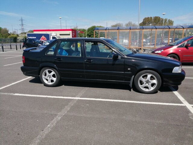

Finally fitted up the new to me 16s.
They fill the arches a bit better and the PREEMIYUM BRANDT tyres certainly grip better. The Landfail Death Grips on the front would just rotate in a stationary position if you tried to leave a junction swiftly in the rain. These are a lot better.
