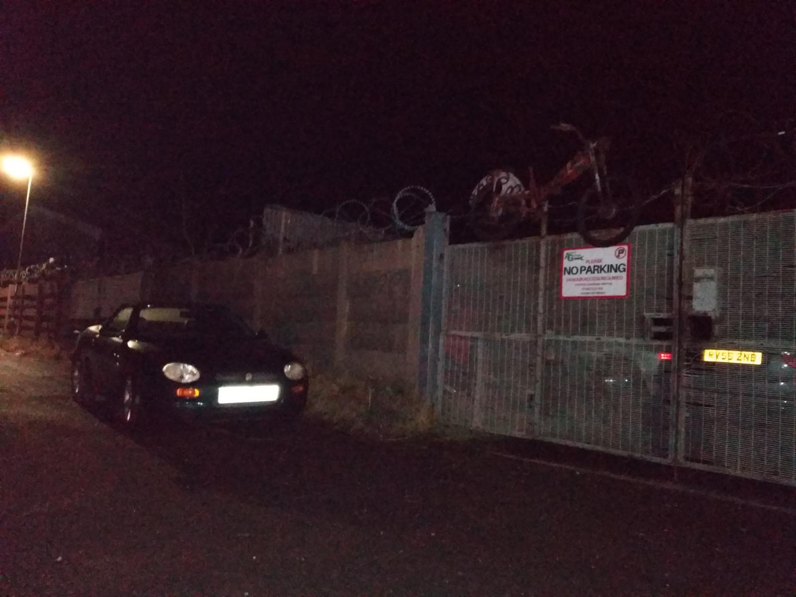

loserone Posted January 11, 2019 Author Posted January 11, 2019 Fob didn't seem to work when it arrived, so not just an interference issue. Doesn't mean it hasn't been broken by trying to fix it though. Apparently they set off with the back wheels in the air, but it was wobbling all over and turned it forwards instead. Not ideal weight distribution wise I suppose but if it keeps it stable.. recovered by just after 0300. Up at 0600 for work. Zzzz Jim Bell and Tam 2
chaseracer Posted January 11, 2019 Posted January 11, 2019 That shot with the MGF is the same "I don't really know how to do a selfie face" face as I pull in every selfie. Yep. Pillock, barefoot, Lacquer Peel and 2 others 5
