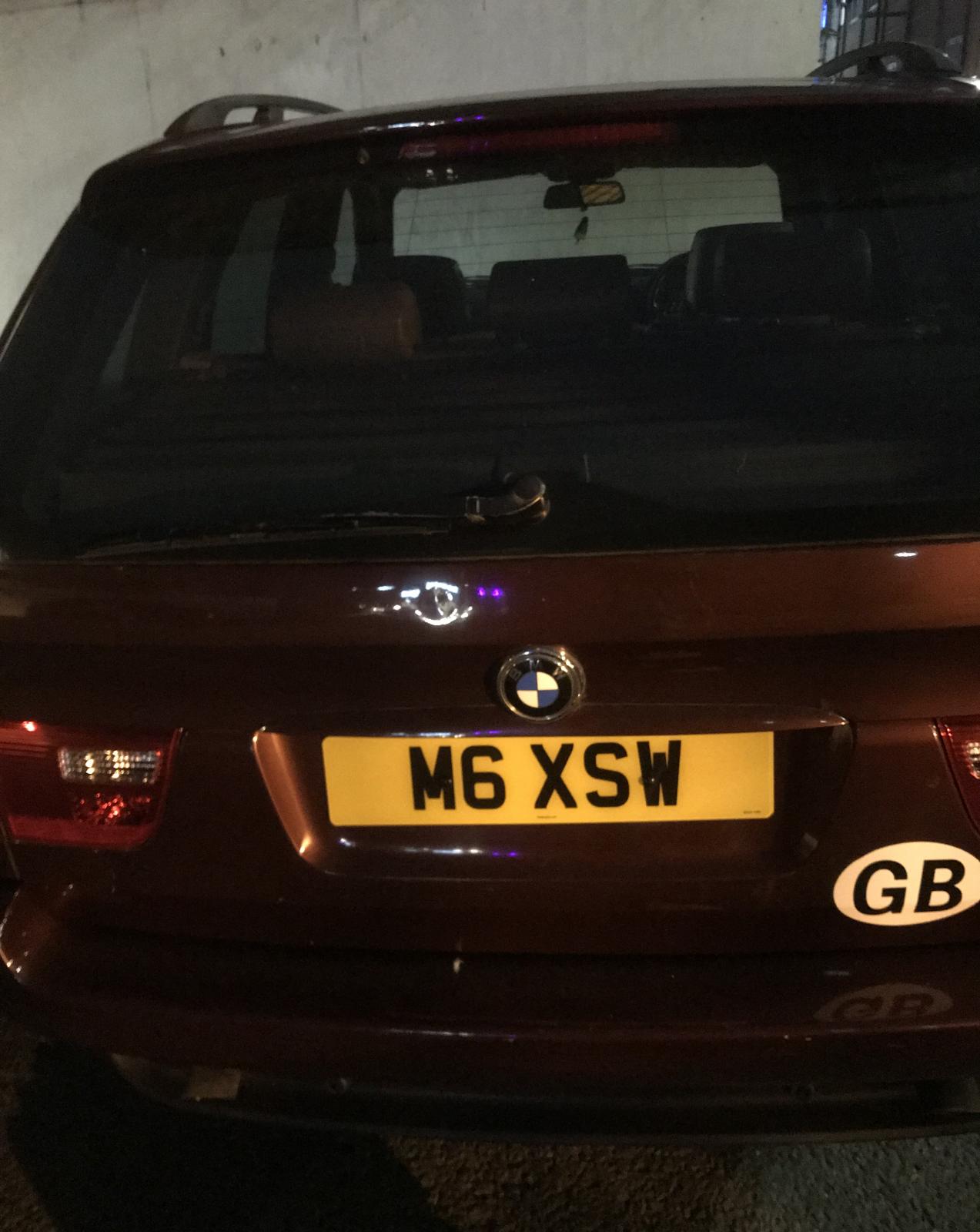

Brown as fuck: 2001 BMW X5 3.0 - Exxon5!
Private plate wanker
Really need to get rid of the GB sticker... it had EU flag plates on before so I don’t even know why it’s there!!
