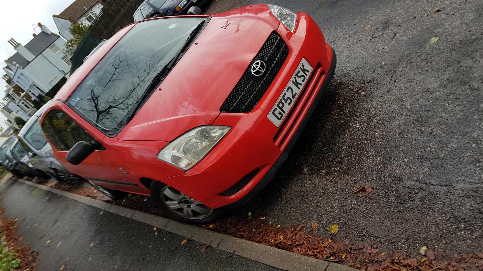

Toyota corolla not blowing onto windscreen??
Knob is selected for windscreen, but nothing coming through vents other than on ya feet, any ideas??
