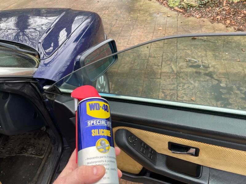

I thought I’d try the cheap fixes first so got myself a can of WD40 silicone spray and jetted the window runs with it, has made a fair improvement and shave about a second and a half of the close time of the passenger side but I think it really needs a new motor or regulator as it’s squeaky and slows badly.
I’ll get the multimeter out when the weather is better and do some proper tests.
I also sprayed the silicone over the window by accident and wiped it off, it makes a bloody good rain x product 🤣

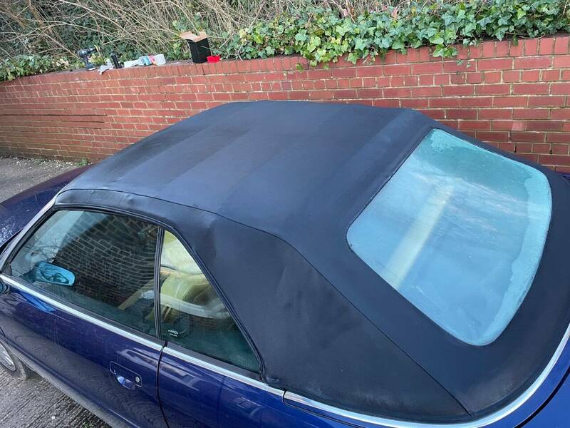

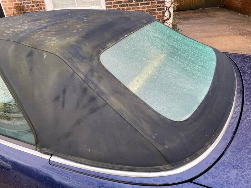

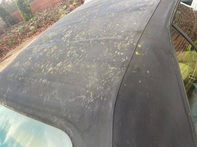

Aside from it being rather cold to be faffing with buckets of water and hose pipes, the wind and extended forecast of dry weather made for an excellent day to try and sort the roof.
Pressure washer didn’t really do much to clear the grot once it dried after my first go so I shelled out for some proper cleaner and restorer.
Here goes…
Before 🤢
Rinse the hood
Pat down and paint on the muck shifter
Attack it with the scrubbing brush
Mmmm…green
Hot water rinse
Dry it, Paint it, Dye it and see what we get
It takes up to three hours to go off, hence the dry spell being handy so we’ll see how it evens out.
It looks a bit patchy in places despite three/four goes over with the dye.
I think some of the patchiness is the age of the hood itself and streaks on the fold lines, a bit like the silver streaks you get when ironing your trousers like a fanny for the first time and ruining them cos your mum used to do it for you.

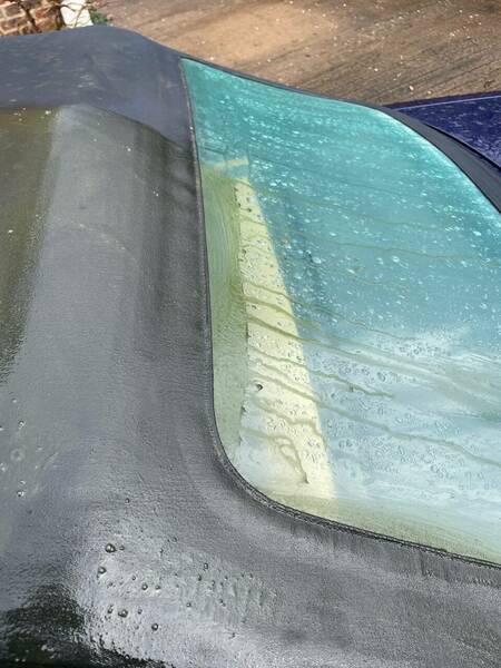

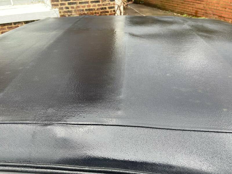

Finished off the work on roof with a waterproofing layer and it may even fix up some of the good colour a bit more. It looks more even but we’ll see how it dries out.
Half Moon
Total Eclipse
Lets hope it dries like that.

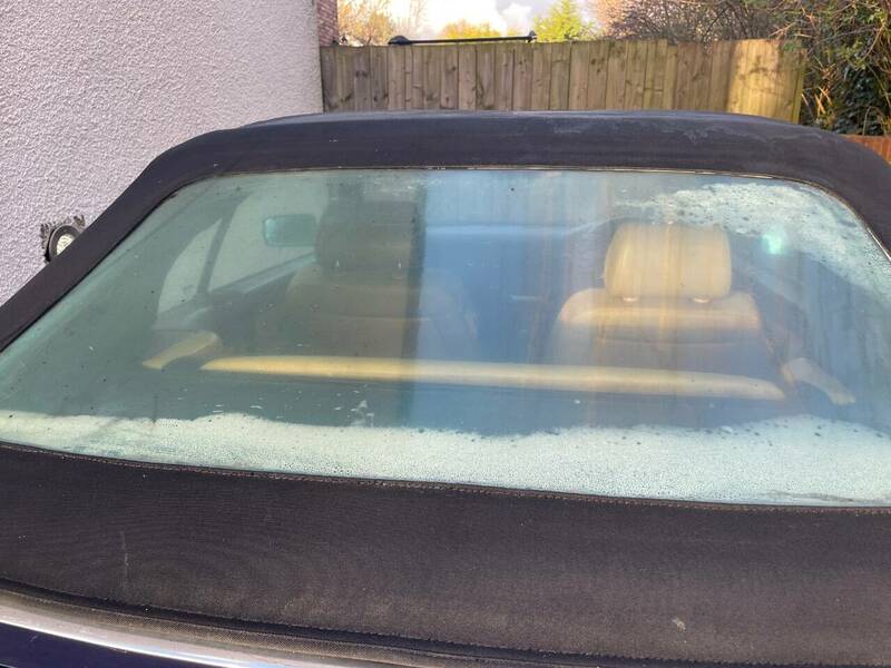

Also had a crack at the cloudy lemonade that is the rear window with some plant polish and a drill swizzer (no DA for me)
Before
during
After - Results? Dunno.IMG_3268.thumb.jpeg.7052114f9294065875616cd94bc5148b.jpeg

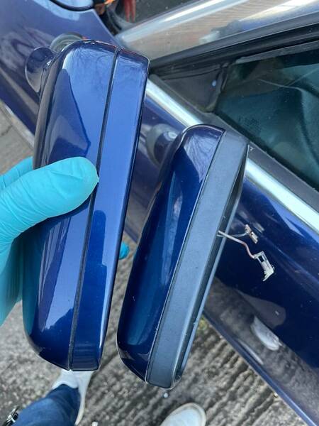

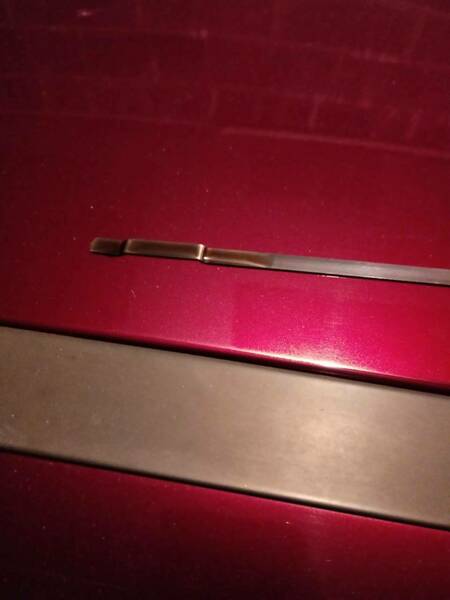

Attention then turned to the mirror, the replacement housing was not quite like for like so I went for the popping out the glass approach, always a gamble with 20 year old plastics.
Amazingly a year old autoshite Santa gift of a plastic trim removal tool was on hand to prise off the mirrors.
Same but different
Popping off revealed the wires on the existing had been secured with clips and some kind of glob glue.
It wouldn’t come off so snapped the mirror bit off complete with glue glob and then used a blow torch to melt the glue and then pulling, wiggling and making “ooh ahh, hot hot noises” to get the clip off.
No photo of finished as I moved swiftly on.

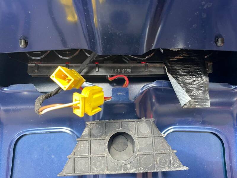

I popped off the boot cover to explore and noticed the 3rd brake light wasn’t connected.
Evidence of prior attempts at finding a solution* An NOS part for this type is about £200, so I’m also looking for economic solutions.
£6 of bulbs at my local autofactor later and a some vigorous wet and dry action yielded…4 out of 6 bulbs operational.
The rust on the terminals makes me think the seal around the middle light lens may be a factor in all the water retention.
Insettled for four and reinstalled, thought I’d check with the boot up to see how it looked…
Oh.
Basically, the contacts are fubared. I’m not paying full whack, so some Heath Robinson solution will be found - with an eBay add on stick and some internal fettling.
One to watch for future.

I think the fittings are shot. The plastic screw thread has snapped.
I’m going to get an eBay led light bar and wire that behind in place of the knackered bulb unit I think.
£6 versus £200!

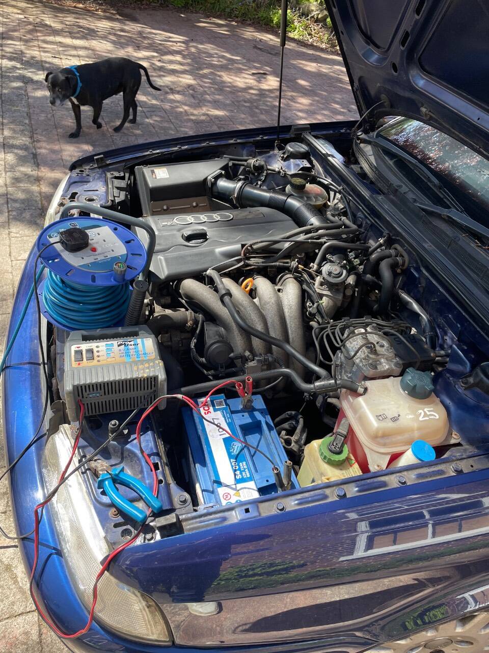

Battery has been on charge today - I put it back on earlier for a test and she started fine after a few cranks.
As it is warm, the airbag light isn’t on from startup so this mini heatwave will be getting used to rush it through the MOT before any red light gremlins appear on dash.

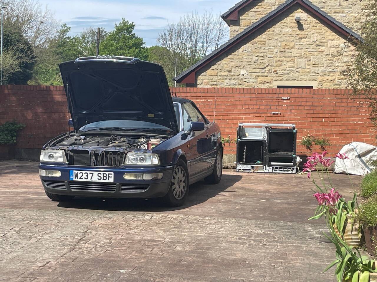

Here is a hunk of metal and a range cooker shell.
Here’s the Audi - quite impressed at the engineering quality under the bonnet - if you gloss over the cable tied throttle cable…

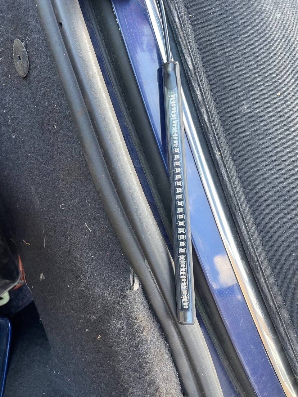

As for the brake light…China to the rescue.
Cheap £3 Amazon light for motorbikes
Snip the dead one and wire in
Run around with elegant* recording solution
Much success!!!
