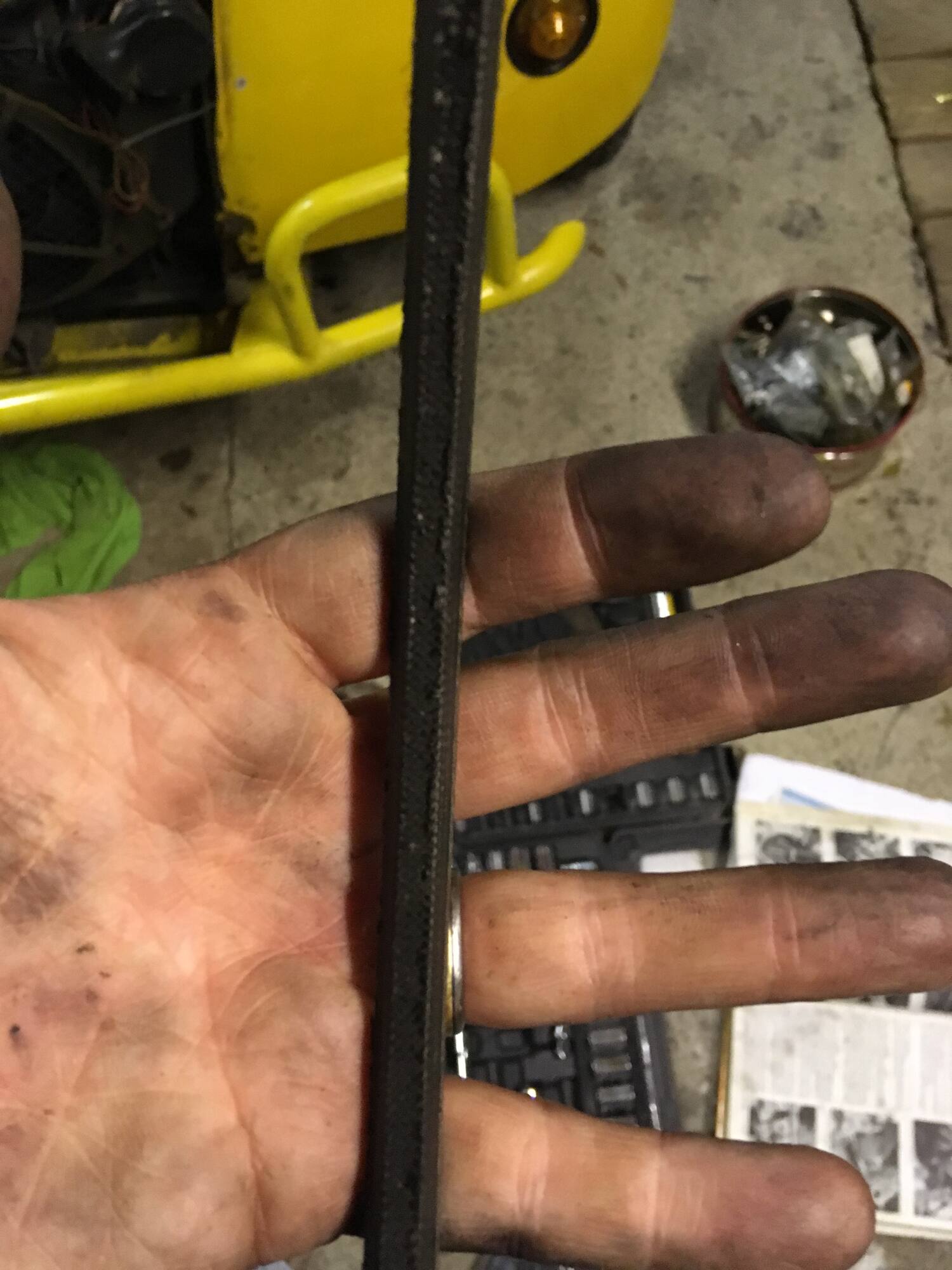

My fan belt was the obvious culprit for the low voltage reading on my on board volt meter. To be honest I’d seen more teeth on a wizened old hag than on this fan belt, so it needed a change.
Simple case of fan off, loosen alternator swap belt. HBOL says theres no need to remove the fan to swap the belt but as I’ve never removed my fan, it seemed like a good opportunity.
Problem the first. My 14mm ratchet is too big to fit in the hole.
Break out the smaller ratchet.
Once I eventually loosened the nut (after jamming the flywheel to stop the fan spinning which thwarted my first attempts) I set about trying to free the fan. The videos I watched both involved hammers and tapping. I’d also read a method of wiggling.
But no. The bastard would not budge. It just looked so easy on YouTube.
I got a bigger bar in there, I wiggled and tapped, and whacked. I even summonsed Mrs_b and she did the same, all to no avail. It won’t come off.
“Fuck it” quoth I, I’ll do it the HBOL way.
Loosen the alternator, slip the belt off, manoeuvre it past each blade of the fan individually, yep that’s pretty smooth....
and refit by doing the reverse (which was easier.) and voila! New fan belt.
After retrieving a lost socket, we fired up and....
Still underreading. I’m concluding faulty volt meter.
