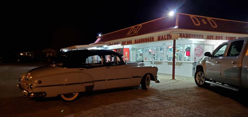

PhilA Posted December 8, 2020 Author Posted December 8, 2020 Went get donuts. And a chocolate malt. Carburetor is definitely jetted for slightly colder weather, as it's buzzing along really happily in this (8°C) weather. Heater is ferociously hot. Gearbox works perfectly when it's cooler, so yes. Valve block out again and I'm going to polish the governor slugs. Brake needs adjusting a little more but it's fun to drive in cool dry weather! Phil eddyramrod, busmansholiday, Skizzer and 8 others 11
