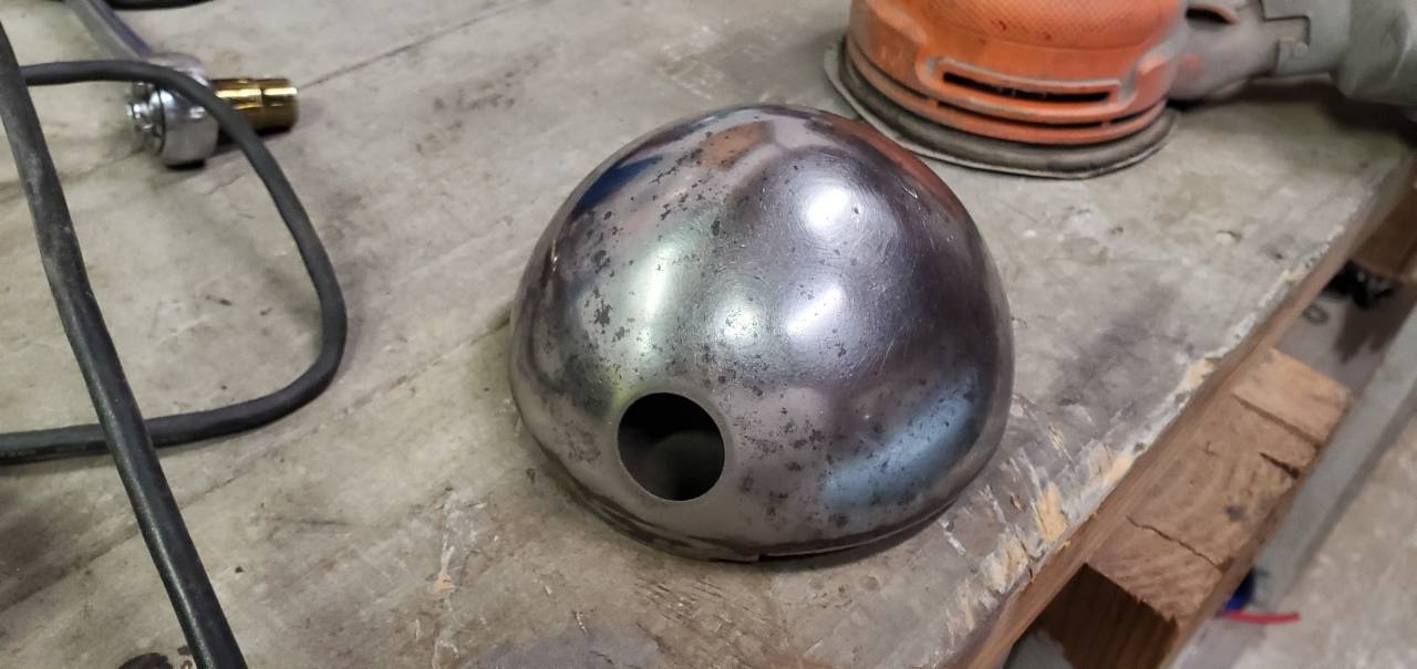

PhilA Posted November 17, 2020 Author Posted November 17, 2020 I polished it a bit then got bored of polishing. It's disproportionately shiny now though. Phil LightBulbFun and mercedade 2

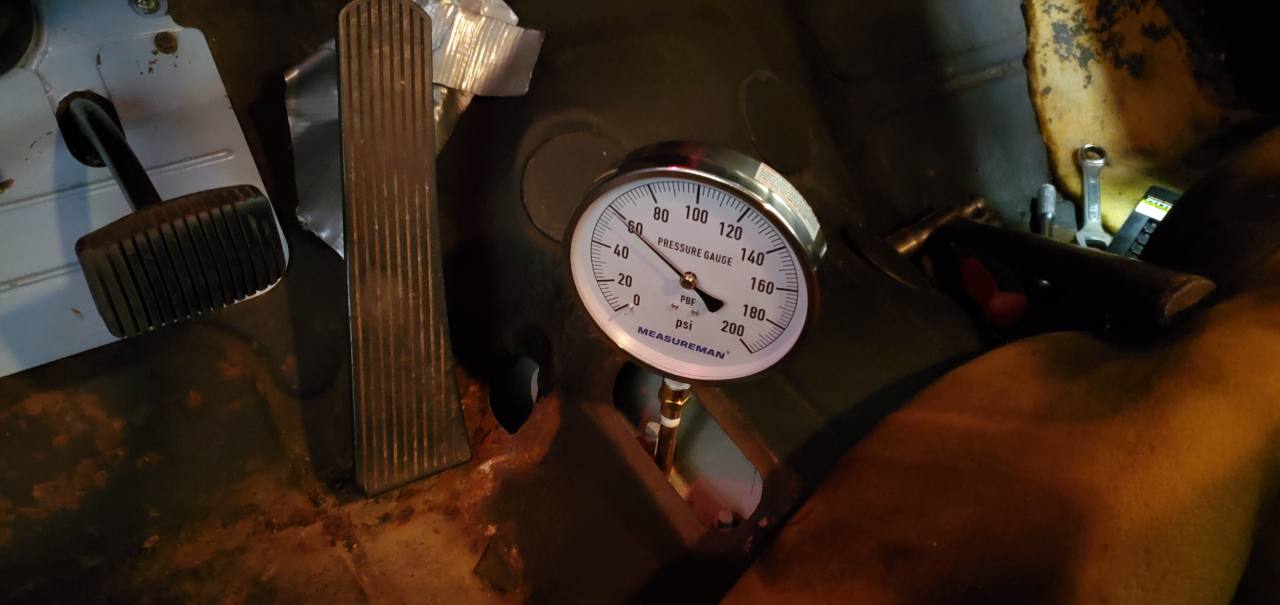

PhilA Posted November 18, 2020 Author Posted November 18, 2020 I now have a gauge. Phil LightBulbFun, Tepper, Jenson Velcro and 1 other 4
PhilA Posted November 19, 2020 Author Posted November 19, 2020 Gauge installed on an extension and adapter. It regulates nicely to 60psi in N, Dr and Lo as it should, there's the correct dips and wobbles shifting between positions. Reverse, the high pressure valve opens as it should and shuttles to and fro as per the manual's description, keeping between 130-160psi, as per spec. Driving, the TV valve modulates the line pressure between 60 and 100psi, as it should. It decided to misbehave one time, with the line pressure perfectly regulated, which leaves the fault within the main valve block, particularly the 1-2 main shuttle. There's not a great deal I can do about that so between getting a new one and now I'm take it apart again and try massage the divot out of the valve again. Phil puddlethumper, busmansholiday, RayMK and 3 others 6

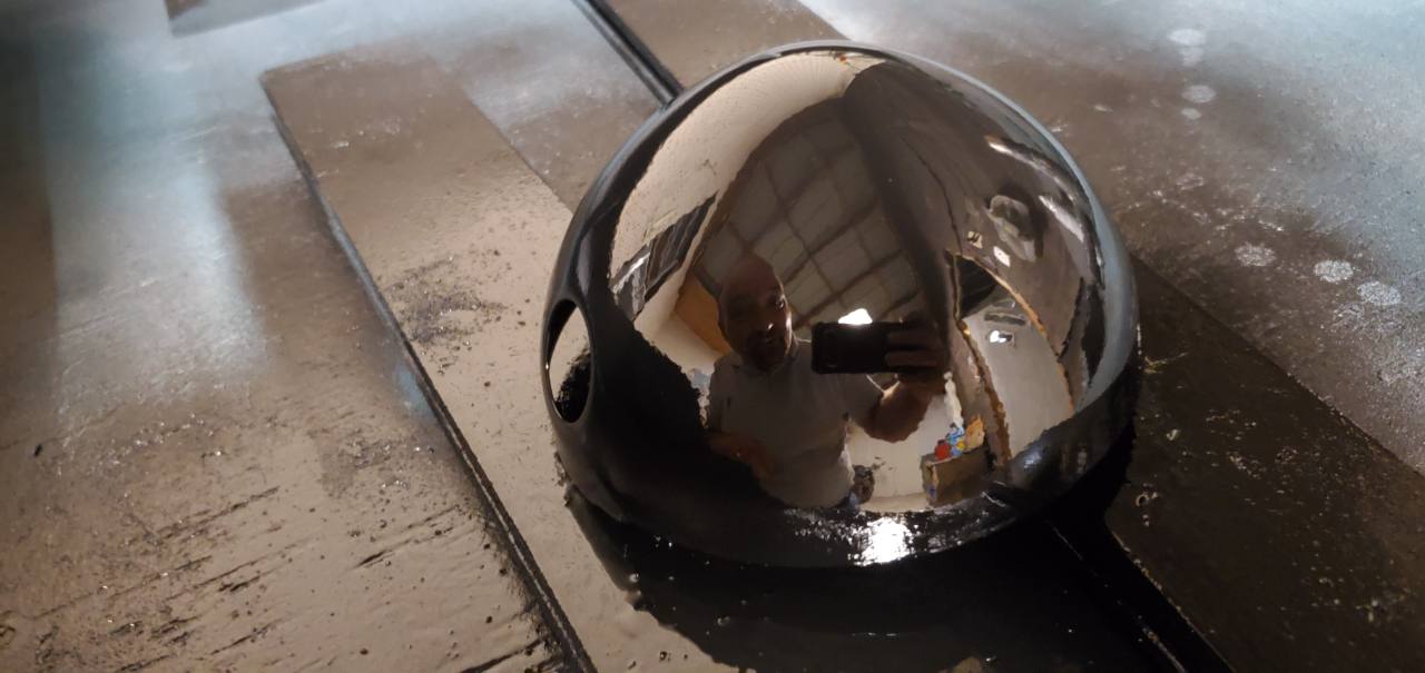

PhilA Posted November 20, 2020 Author Posted November 20, 2020 Made a start on the other horn. Plenty to do yet, but shiny pot metal is always good. Phil LightBulbFun and hairnet 2

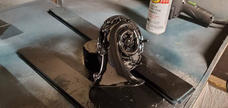

PhilA Posted November 20, 2020 Author Posted November 20, 2020 Sanded down Painted That can dry overnight then I'll do the other side. Need to sand the lid down next. Phil LightBulbFun 1
PhilA Posted November 21, 2020 Author Posted November 21, 2020 First buzz down, 120 grit. Got it to here, bashed the dents out. 220 grit to here First coat of black. Phil Tickman, mercedade, GrumpiusMaximus and 4 others 7
PhilA Posted November 21, 2020 Author Posted November 21, 2020 Arse. I dropped the horn body moving it, and now need to wait for it to fully harden, rub it down and repaint. That sucks! Rocket88 and Asimo 2

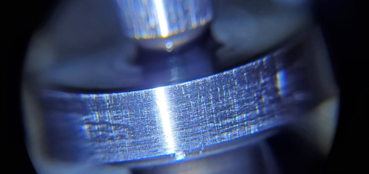

PhilA Posted November 22, 2020 Author Posted November 22, 2020 So, to work! All the valves have a lot of miles on. They're all worn. Found a couple burrs and high spots, took them down carefully. First impressions are good, we'll see how that continues. Phil spartacus, Tickman, LightBulbFun and 2 others 5
