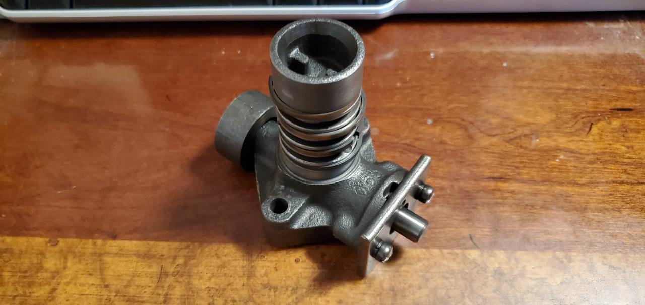

PhilA Posted October 21, 2020 Author Posted October 21, 2020 Replacement governor arrived in today's mail. It has a very positive action (like it should), and doesn't get stuck anywhere in its travel on either piston. Happy with that. Feels like it's got many fewer miles on it than the one in the car right now. Phil egg, spartacus, LightBulbFun and 2 others 5

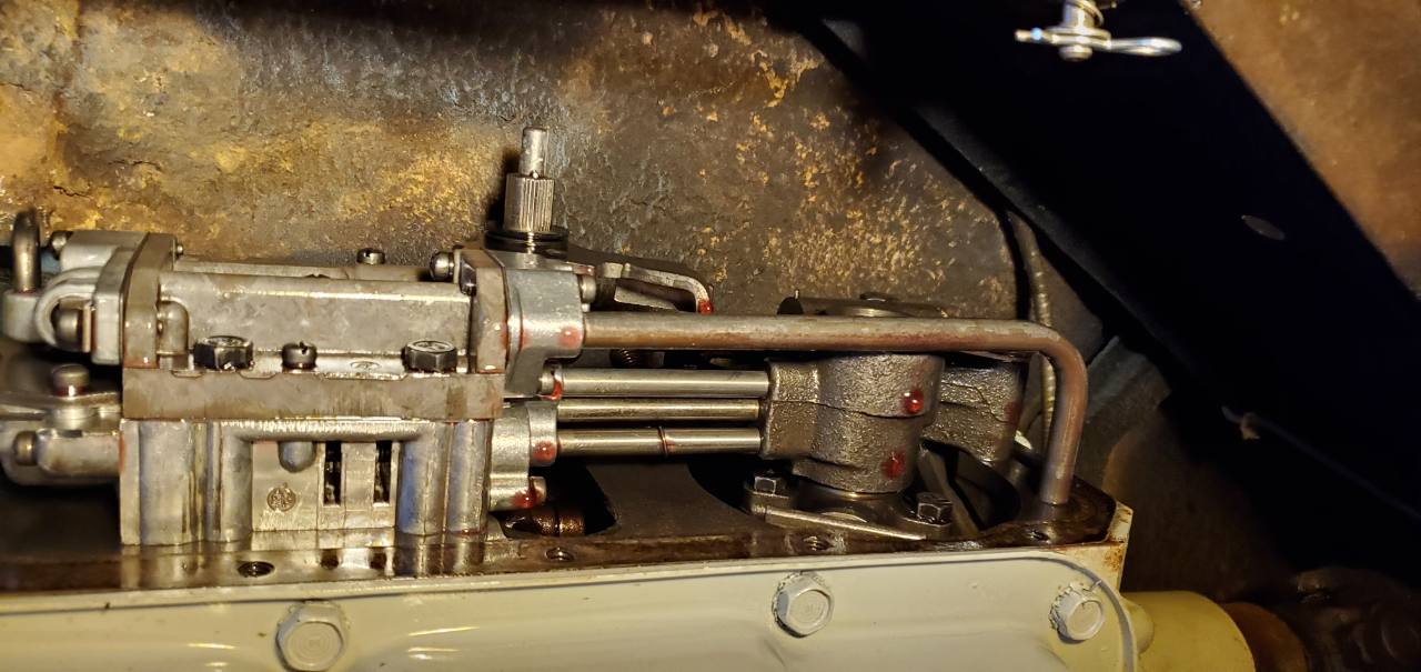

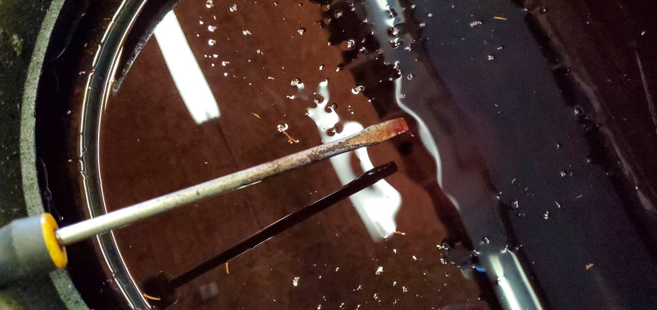

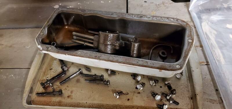

PhilA Posted October 22, 2020 Author Posted October 22, 2020 Dropped the oil tonight. Looks pretty reasonable still, which is good. Flushing it won't hurt though. Side pan off. Access could be better... It was easier on the bench. Have worked in worse spaces though. Pipework removed, but not without a fight. Reverse lockout pawl is sitting on top of a tooth. I need to see if it'll rotate with the slack in the rear axle to sit in a gap for reassembly. New governor, old governor and valve block. The old governor appears to be a hybrid of new weights and old body. The new one is all the later variant. It's not moving freely, that'll be the issue. I'm going to pull the valve block apart to make sure it's clean inside then throw it all back together again. Phil mercedade, somewhatfoolish, grizgut and 3 others 6

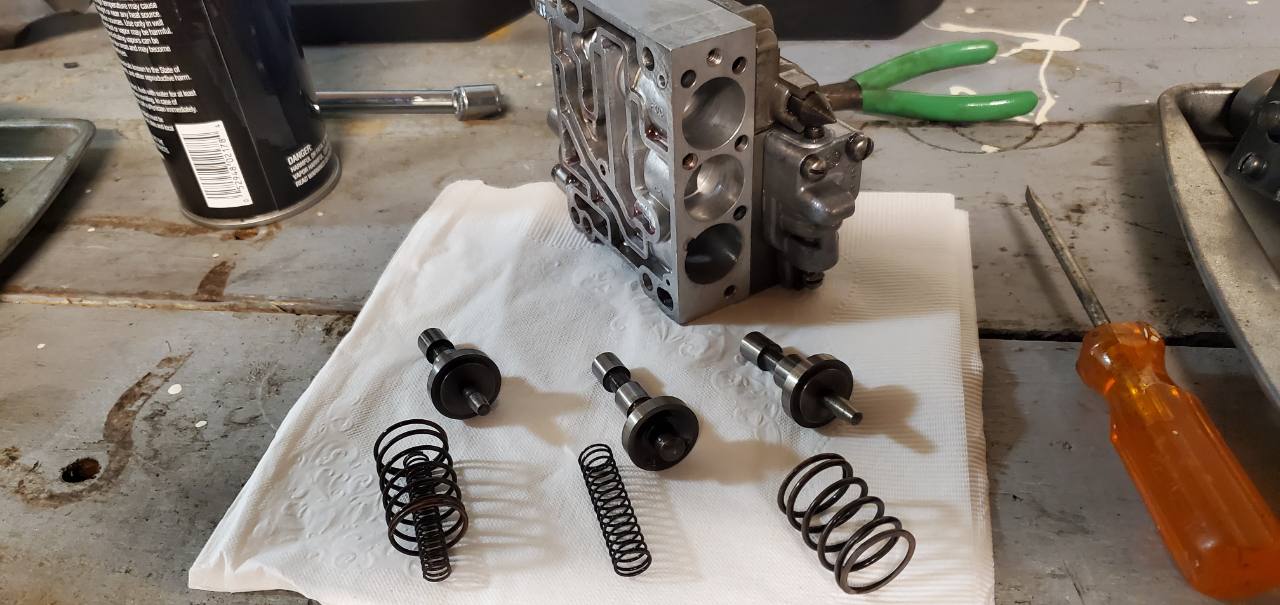

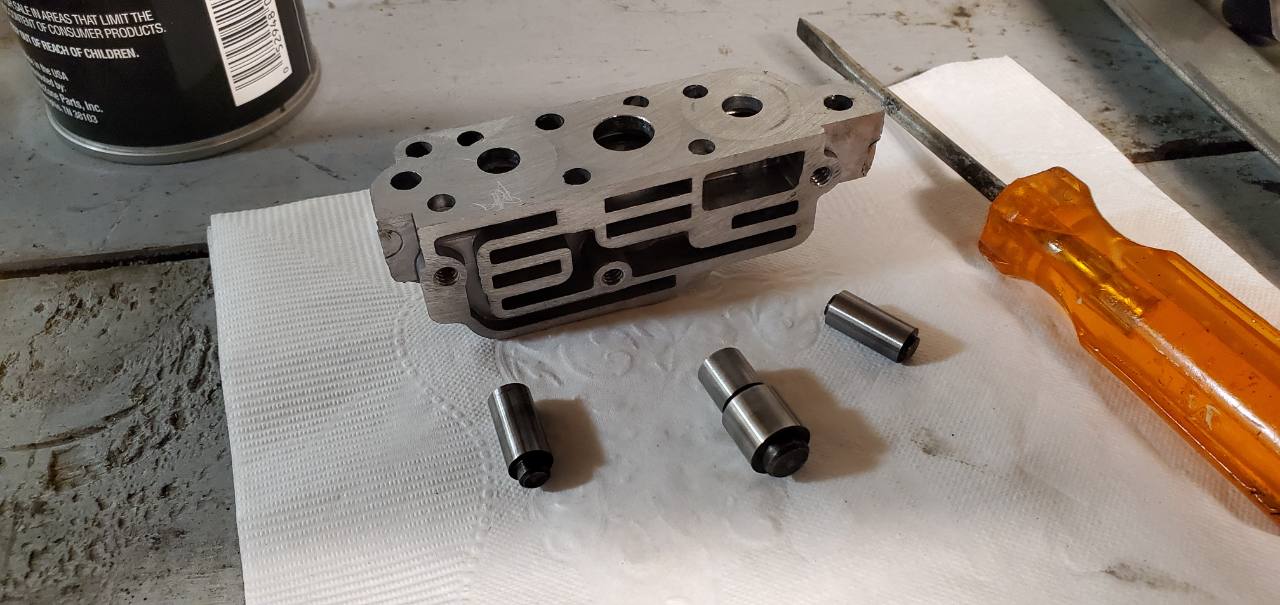

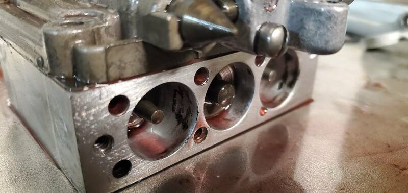

PhilA Posted October 23, 2020 Author Posted October 23, 2020 I took the valve block apart last night. That's the end cap of the main valve set and the pistons are meant to fall into their bores under their own weight. That wasn't happening. They're fairly scored from years of use, the manual says not to use abrasives but there were a few burrs that were preventing correct operation so I carefully removed those. Those now move smoothly. The finish on them is still pretty good considering their age. The main valves were dirty and again lightly scored, so they recieved the same treatment. They move freely now without sticking so that's gone back together and is ready for reassembly. Phil egg, Tepper, LabRat and 8 others 11

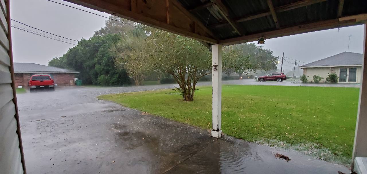

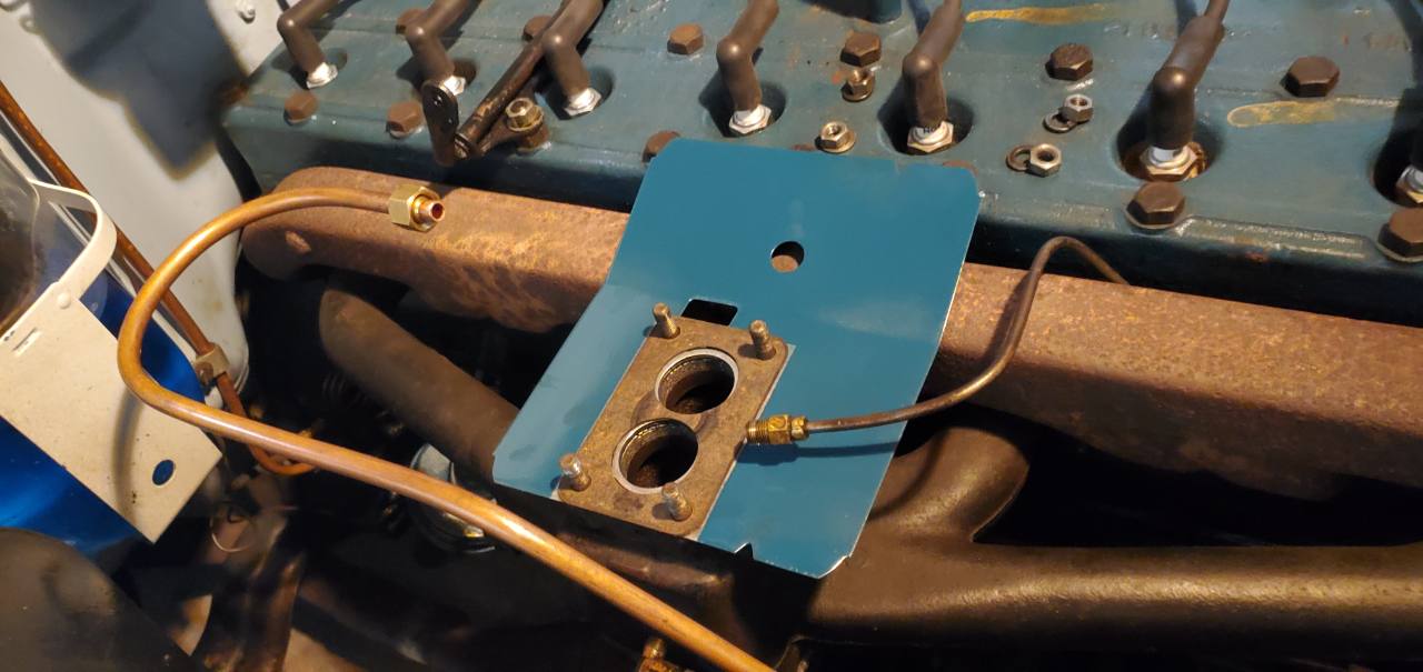

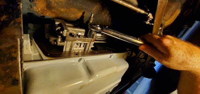

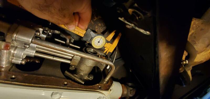

PhilA Posted October 24, 2020 Author Posted October 24, 2020 This afternoon, we had 3" of rain in 30 minutes. Just a small storm, then. During this, I got the new governor in, the fluid sleeve centered on the governor, valve block in and the reverse lockout stop set to the prerequisite 1/2". Torqued everything down as per the book and put the lid back on. Pulled the carb off and installed the heat shield. Got it all back together and awaiting transmission fluid. Phil busmansholiday, egg, GrumpiusMaximus and 5 others 8

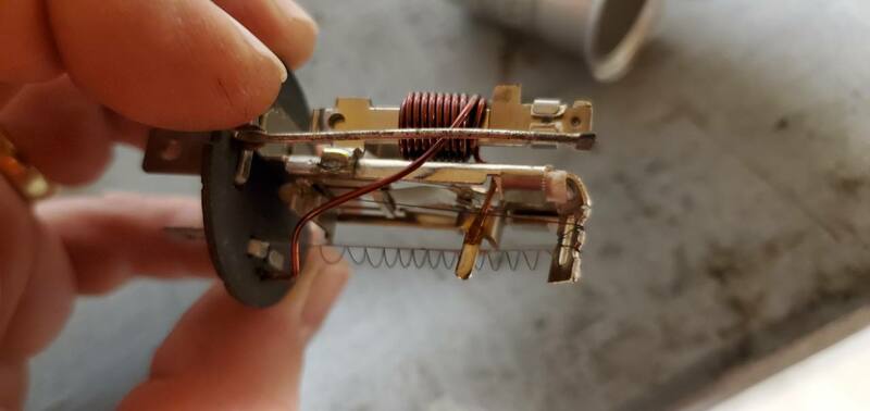

PhilA Posted October 26, 2020 Author Posted October 26, 2020 13 minutes ago, somewhatfoolish said: What was the the old system and what noise did it make? It was the horrifically complicated type that has the litz wire heater, two sets of points, a big coil, lots of junk inside and it went plik-toink. Very similar to the type found on Morris Minors and the like. LightBulbFun 1
