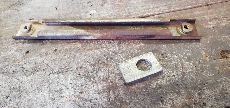

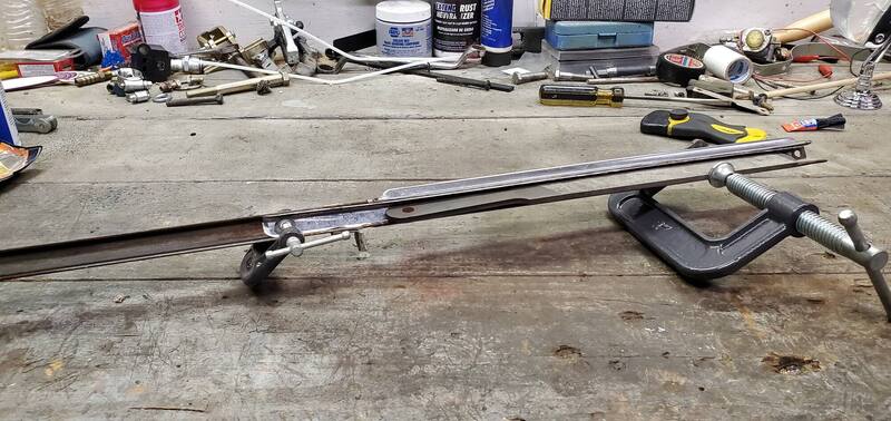

PhilA Posted September 12, 2020 Author Posted September 12, 2020 Tonight, I decided to strike one thing off the to do list. The rear right glass now winds down but with the lower stop missing the mechanism would fall out the end of the upper runner and the window would jam in the fully down position. I didn't have enough metal to make a closing panel with a stop, so I decided to improvise. Started with a piece of flat steel bar. Marked and cut it to size, with a 9/16" hole in. You can see my line of thought here against the upper runner. Slots in and pops over the mounting point, braced with strength. Filed down a little and using a longer bolt that went further through, a washer and nut do up onto the other side and lock it in place. Now the window winds all the way down but doesn't get stuck at the bottom. Gonna put that door back together tomorrow, that leaves the driver's door to finish. Phil somewhatfoolish, LightBulbFun and Tickman 3

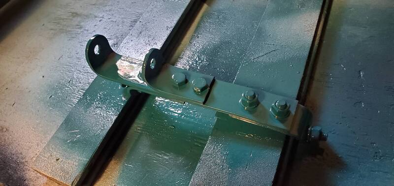

PhilA Posted September 12, 2020 Author Posted September 12, 2020 There you go, all back together on that door, all working (winds up and down remarkably well considering the glass is broken). Phil Tickman, LightBulbFun, paulplom and 2 others 5

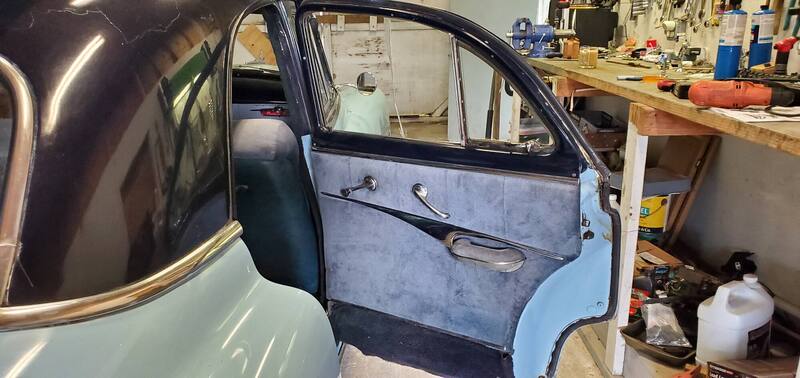

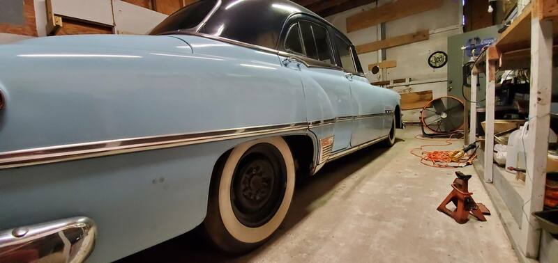

PhilA Posted September 13, 2020 Author Posted September 13, 2020 Tonight, I pulled the driver's side door glass. For what it's worth, glued the chunk that recently fell out back in. I found a very rusty sash channel in the bottom of the rear right door. It still had the rubber in so I cleaned that up and replaced the wire insulation and fitted the sash channel, which gripped nicely. This is a replacement glass. Little wonder it got caught, look how straight* it was cut. I cut a length of metal and applied marine pu sealant to the back. Got that clamped in place to set overnight. Phil LightBulbFun and paulplom 2
PhilA Posted September 13, 2020 Author Posted September 13, 2020 Fitted the window back in, the modified runner works well enough for now; got the handles and door card back on and secure. The bottom of the door card is bad but eh. The door closes with a nice clunk now, no rattles. Some firsts today too. First time all the doors function correctly and all work as they are meant to (99%). Also, I have locked all the doors with the key and have secured the car for the first time since I've owned it. Not too bad Phil puddlethumper, Tickman, LightBulbFun and 7 others 10

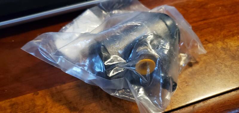

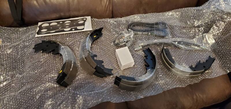

PhilA Posted September 16, 2020 Author Posted September 16, 2020 Box of things arrived. Typical, one brake cylinder is on back order. Phil somewhatfoolish, BlankFrank, LightBulbFun and 1 other 4

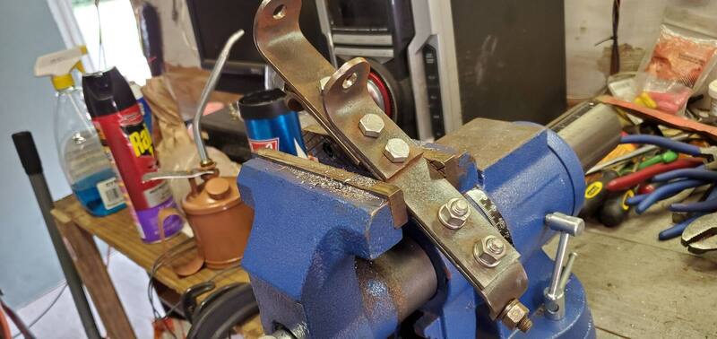

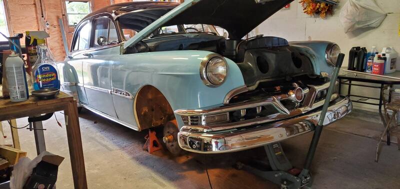

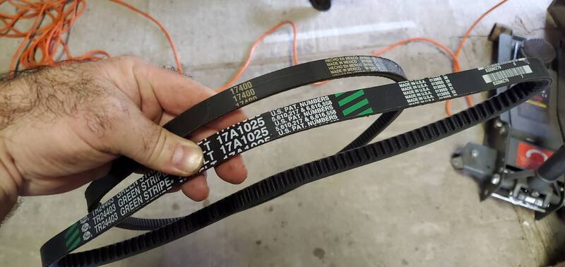

PhilA Posted September 16, 2020 Author Posted September 16, 2020 Removed the fan belt and alternator. New belt is the correct width. Added the additional bolt through the alternator arm and put lock washers on all the nuts. Gave the thing a coat of paint; ready to go on for long term service now. Phil LightBulbFun, Dan_ZTT, Asimo and 2 others 5

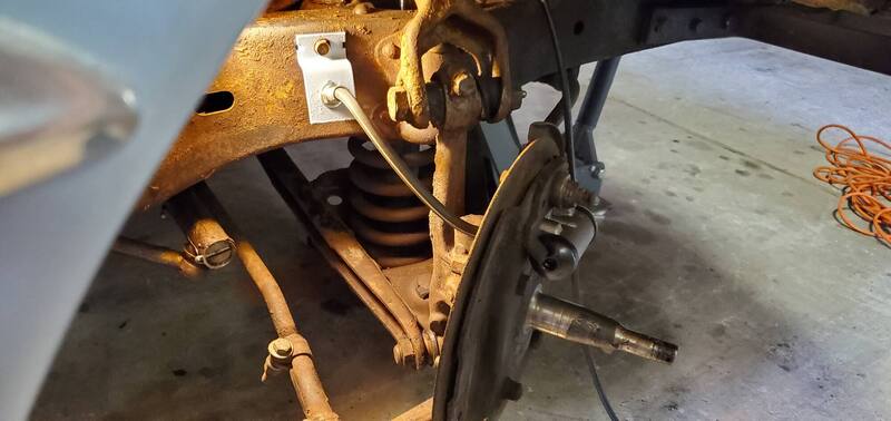

PhilA Posted September 18, 2020 Author Posted September 18, 2020 Familiar sight again today. Pulled the wheel and brake drum off the passenger side front. Removed the old flexi, fixed the mounting bracket, got the new cylinder in. Old one was leaking. Got everything back together, checked clearances. All good. Going to move on to the other side tomorrow if time allows. Phil LightBulbFun 1

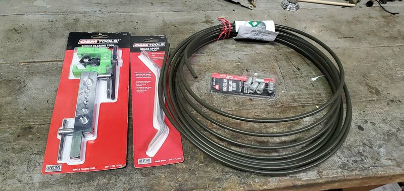

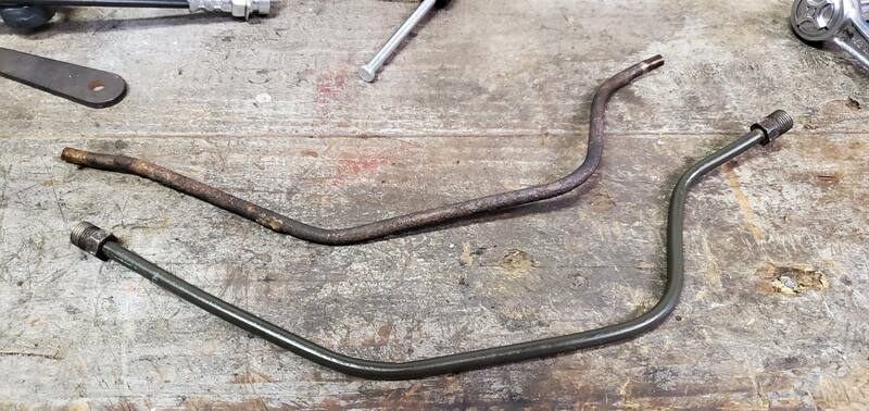

PhilA Posted September 18, 2020 Author Posted September 18, 2020 Old, gone. New, much better. Bollocks. Well, we've all been THERE, haven't we. I'll get some new fittings, pipe and a flaring tool tomorrow. Phil LightBulbFun 1

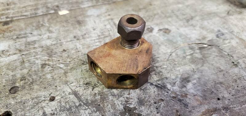

PhilA Posted September 20, 2020 Author Posted September 20, 2020 I ran new hard line from the master cylinder to the front left, front to rear and rear to left. Bent pipes to shape and flared them. Cleaned up the rear tee, it was a wad of gunge. Rear shoes looked fairly new but were falling apart. Stripped it all down. The bias adjuster at the top there took an eight foot breaker bar and my foot to shift. Beaten with hammers it finally came out. Cleaned and greased up. That hadn't been adjusted in.. forever. Forgot to take a photo with it all back together, but it's now in. Phil paulplom, Dan_ZTT, egg and 6 others 9
PhilA Posted September 20, 2020 Author Posted September 20, 2020 Work is on halt because the last wheel cylinder shipped. Might as well wait until that arrives and do everything in one go. Phil hairnet 1
PhilA Posted September 21, 2020 Author Posted September 21, 2020 Look what was in my mailbox today. Genuinely surprised at that. Delivery schedule was Wednesday. Phil LightBulbFun, paulplom, GrumpiusMaximus and 2 others 5
PhilA Posted September 21, 2020 Author Posted September 21, 2020 That's just lovely* All new. Bosh. Need to make the hard line up, then it's time to adjust brakes, bleed brakes. Phil Dan_ZTT, LightBulbFun, somewhatfoolish and 5 others 8
