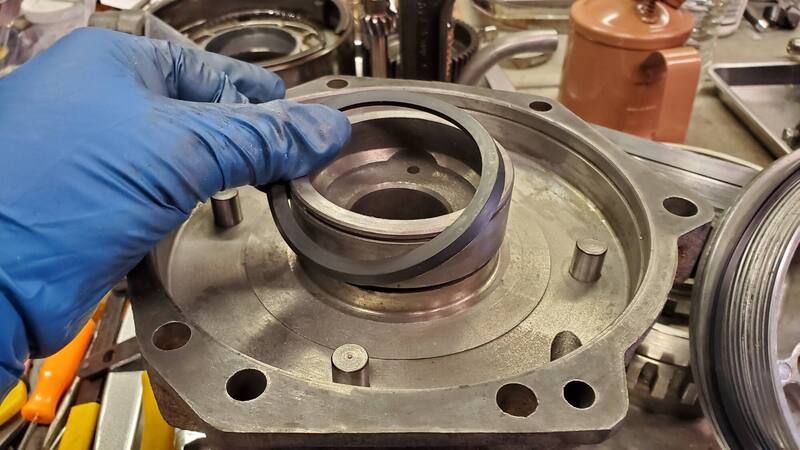

PhilA Posted August 17, 2019 Author Posted August 17, 2019 Started today by cutting a groove in the bearings I wanted to remove. Cold chisel to split it all the way. Hammered out flat you can see just how bad this bearing actually was. Removed all the seals and cleaned the grooves they sit in. Rubbed all the sealing surfaces down smooth with 1000 grit because they were a bit fouled with alloy corrosion and dirt. Refitted the piece with new seals Fitting the piston was a pfaff, there is a step in the outer case where the outer static band locates, and something needed to be put in to remove the step. I didn't have the correct Special Tool so bits of cut up plastic of the correct thickness were added the piston then settled down into the bore happily. Back together as much as I can put it for now. Typically in all this I missed one piece which needs to be replaced, a wavy spring washer that sits behind a retainer (that I forgot to pull off before this afternoon). I think I will get some dry ice to put the bearings into before fitting them, that should help. Phil scdan4, RobT, Skizzer and 11 others 14

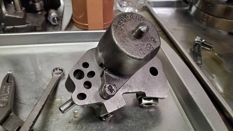

PhilA Posted August 18, 2019 Author Posted August 18, 2019 I decided to revisit the governor. Having sat a little while it was again sticking in the bottom of the bore. The smaller weight on the right does the what-speed-the-gears-change-at pressure. It must move smoothly throughout its entire range. Getting stuck is not an option. I lapped the surface that it hits into at a rolling angle and that appears to have remedied the issue. It now clik clak's happily from end to end, even if given a firm prod. That should help with making the gears actually change. I think it was getting stuck before, would certainly explain the behavior. Phil purplebargeken, BL Bloke, Mally and 9 others 12

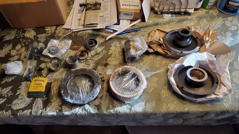

PhilA Posted August 21, 2019 Author Posted August 21, 2019 Spares arrive! DSdriver, LightBulbFun, Zelandeth and 3 others 6

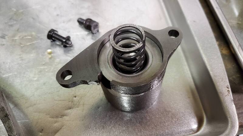

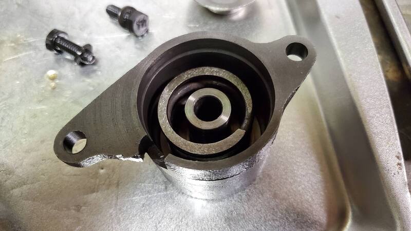

PhilA Posted August 22, 2019 Author Posted August 22, 2019 New pieces fitted! New big return spring in the front servo ready to go in. First, put the opposite end piston in place, then fight with the back end one to get the rings to seat correctly in the bore. Main return spring goes in. Locator hat sits on top and keeps the main spring in place. Smaller booster piston spring sits in the hat. The booster piston gets pressure from the compensation valve, connected to the gas pedal; makes for a more positive gear change when you're accelerating hard and grips the band tighter the more you push down on the pedal. The two halves them come together and bolt down. One down, many to go! Phil Zelandeth, scdan4, paulplom and 3 others 6

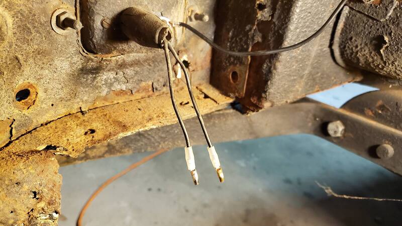

PhilA Posted August 24, 2019 Author Posted August 24, 2019 New brake light switch. This one works. Phil somewhatfoolish, Skizzer and LightBulbFun 3

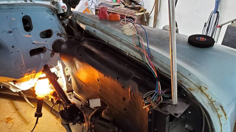

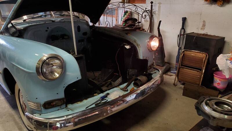

PhilA Posted August 25, 2019 Author Posted August 25, 2019 Rewired the headlight connector on the driver's side with new wire. Loomed it all up with proper looming tape. Crimped a ground on. Tidied it up with heat shrink. Result. Turn and park lights were all miles of butt connectors and Scotch-Loks and tape. Color coded some new bullet connectors. Loomed up and added a ground. That also works. Finished up by connecting it all to the terminal block. Phil somewhatfoolish, mercedade, Tickman and 4 others 7

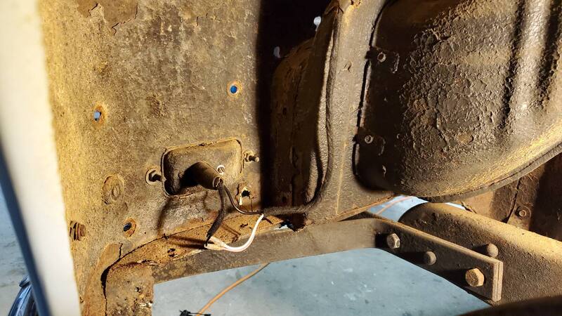

PhilA Posted August 25, 2019 Author Posted August 25, 2019 Identified, tested and put new connectors on the wiring that goes to the back of the car. Added bonus, this got the interior light working. ...and the light in the trunk! Built up the wiring for the front of the car. Got it all loomed up nice. Connected up to the switch on the floor and tested that satisfactorily. Ordered some 3/16" brass eyelets so I can rebuild the connectors in the dashboard lighting. Onward and upward Phil somewhatfoolish, adw1977, tooSavvy and 5 others 8

PhilA Posted August 26, 2019 Author Posted August 26, 2019 Moderate, case of working out what wires need to go what, trying to keep mostly to the original wiring schema. That's the hard bit. Phil
