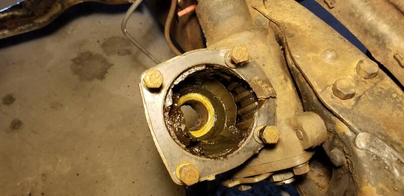

PhilA Posted May 15, 2019 Author Posted May 15, 2019 I cleared the crep off the pitman arm nut and measured it. 1 1/4" which is just slightly bigger than any tool I own. I found my exploded diagram, I need to study it because it does look like the lower race is ball bearings. If the cage has collapsed that would explain the lash. With the pitman arm removed I should be able to take the steering box apart, clean the grease out and fix it up. Hopefully. Phil LightBulbFun and purplebargeken 2
PhilA Posted May 15, 2019 Author Posted May 15, 2019 Tool! Coupled with judicious application of torque: Just hitting the pitman arm resulted in a few dents in the pitman arm. I think I'll need a puller... Diagram was sideways. Top and bottom are plain bearings. Phil Exiled_Tat_Gatherer, Joey spud and LightBulbFun 3
PhilA Posted May 16, 2019 Author Posted May 16, 2019 Second tool of the evening. A modest 2/3 leg puller, rated 2 ton. Puller, along with a 4lb lump hammer meant that it finally decided to yield. I've left it here tonight, I want to clean it up a little and mark the splines. Phil somewhatfoolish, Joey spud, rainagain and 8 others 11
PhilA Posted May 17, 2019 Author Posted May 17, 2019 I tried to make a little time this afternoon after work on the car. I pulled the lid off the steering box and cleaned all the old grease and dirt out. With the pitman arm removed, the shaft just pulled straight up and out. It was covered in a mix of grease types; some correct but dried up with the consistency of old toffee, some newer chassis grease which is just wrong. The insides of the steering box case are similarly horrible. With the shaft out it's possible to feel the lash in the top bearing. Cleaned up I'll push the lower part of the shaft into the lower bearing and feel how loose it is. The shaft itself is worn but not overly bad. I need to work on the roller wheel as the bearing has a little free play in. I'm not sure if it's all just adding up. Once it's cleaned up properly it'll be a little easier to tell. Phil scdan4, purplebargeken, LightBulbFun and 2 others 5
