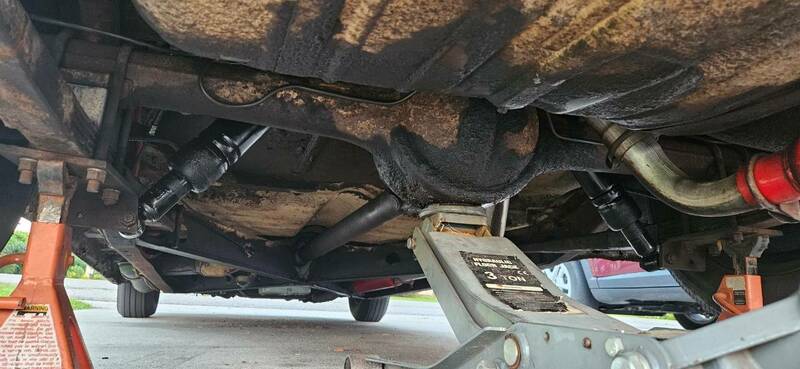

PhilA Posted September 20, 2023 Author Posted September 20, 2023 Just been out and about adding miles to the car. Little bit of maintenance today, replaced the rear shocks. The right hand one had seized up and the left one wasn't far behind. Rides a lot better now, funny that. Rust Collector, LightBulbFun, Asimo and 5 others 8
