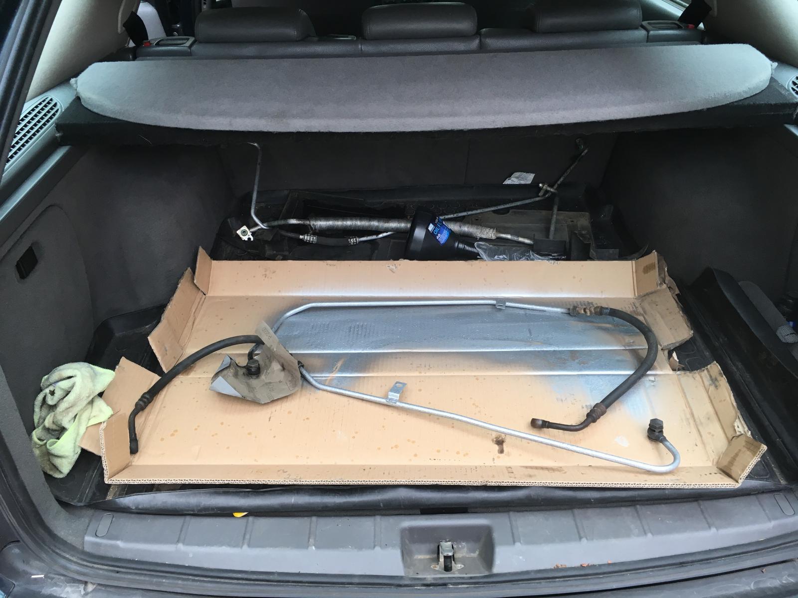

Ohdearme Posted August 18, 2018 Author Posted August 18, 2018 The wait for replacement pipes is almost over. A kindly gent has sent me the requisite parts, or more accurately has entrusted them for delivery to myhermes so sometime next week I’ll probably be searching the local hedgerows to find where my item was ‘delivered’ Pretty much just in time as I can’t really call the leak anything other than severe now. Mmm, ketchup

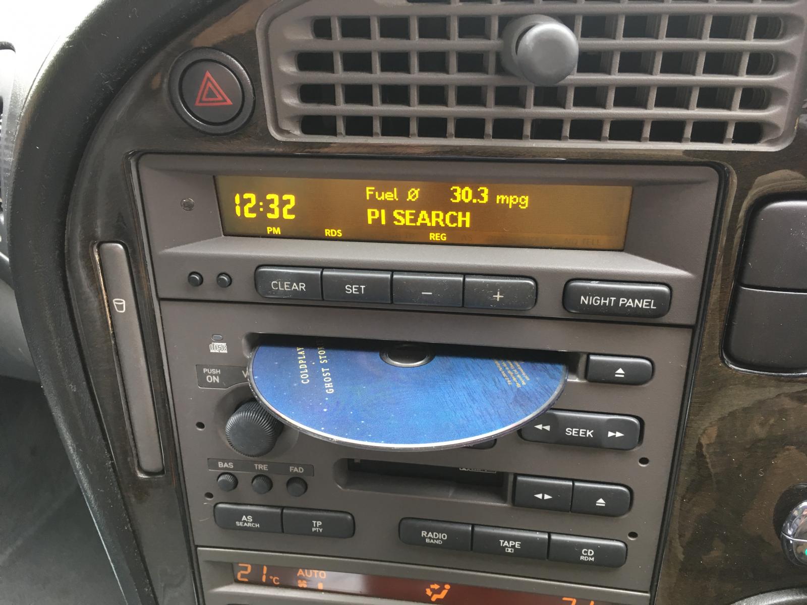

Ohdearme Posted August 20, 2018 Author Posted August 20, 2018 Hermes delivered package with no damage and to my front door, not a hedgerow. Good work for a fiver. Old pipes not sexy but less Swiss cheesey than my own. Assumed CD player was empty as buttons to date have done nothing. Got in this morning, Coldplay ejected at me. Suspect intermittent CD player fault or car is haunted by Chris Martin loving ghost. Shep Shepherd 1

Guest Hooli Posted August 20, 2018 Posted August 20, 2018 Oh my CD player does that, the CD sticks very slightly ejected so it thinks it's empty but you still can't see it. I'm thinking it's the mech gummed up with old grease but I've not bothered to take it out & look. A smoll squirt of WD40 at the outside edges of the slot might help soften things up. Or I just use a thick bit of card/plastic to push the CD back in & eject it again.

Ohdearme Posted August 22, 2018 Author Posted August 22, 2018 Booked car in to a local Indy for pipes to be fitted. Could probably have had a crack at it myself (not hard, just a bit fiddly). Reality would be pipes off, kids interrupt, car not fixed, need to go work, panic buy £266 323. Should be two hours of expert labour whilst I go decadently swig a Starbucks and cake. I did some diy though, £4 on knock off hammerite, hammered finish for a touch of class* and a bit of wet and dry sanding. Hopefully pipes will fare better this way. Started raining immediately post spray so boot is doubling as dryer. Drive will probably rinse off... Shep Shepherd and theshadow 2

Ohdearme Posted August 23, 2018 Author Posted August 23, 2018 It’s back and the pipes are done but so is the bank balance. Like a punter sending a hooker to the clinic and being surprised at results, I asked the man to have a sniff about while it was on the ramps and in car buying terms I should have rubbered up. Anti roll bar bushes wornOSF track rod end boot splitNSF driveshaft boot splitFront subframe mounting bushes failedFront pipe blowingRear suspension upper and lower rose joints wornNSR tyre worn inside edge (see suspension knackerage above) Hmm, no less than seven exclamation marks on my report, best I’ve had yet. Fixed the handbrake for free though. £180 lighter and joy compounded when I got home to find a nip from North York’s for 80 on the A1, in an A1 - cock. MOT in October so will do some gradual fixes but the subframe is going to be a bend over job.
