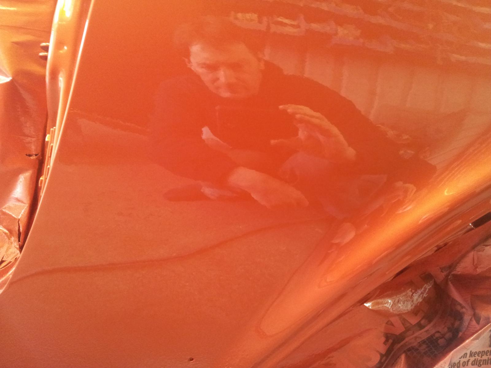

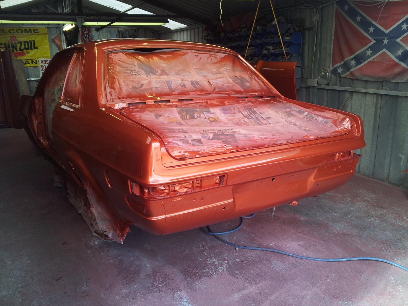

This is the from the gun finish on my Viva,
used a cheap Sealey gravity feed gun and a Lidl compressor.
The base coat was cellulose based,and the clear coat is 2k.
You can get a decent finish with very basic tools.
The prep work is the hard bit,
get that right,the rest is a doddle.
