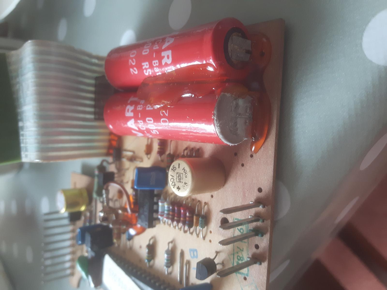

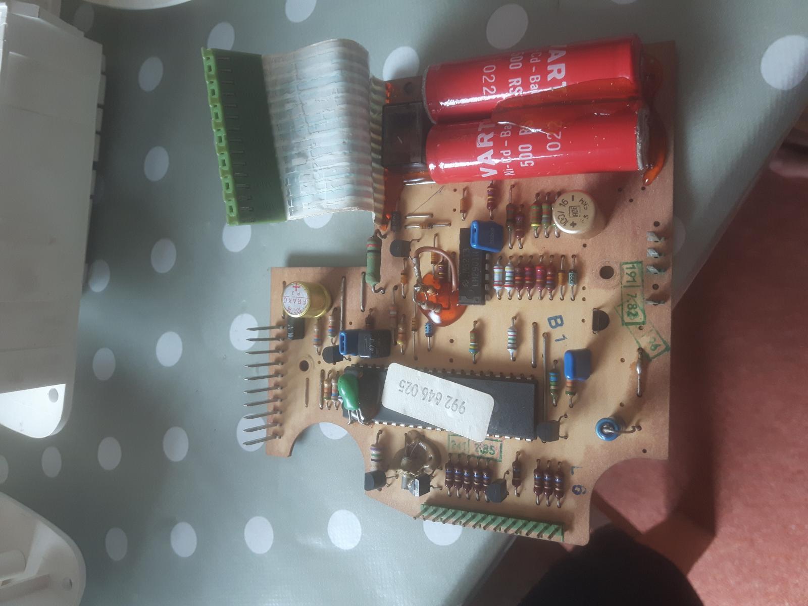

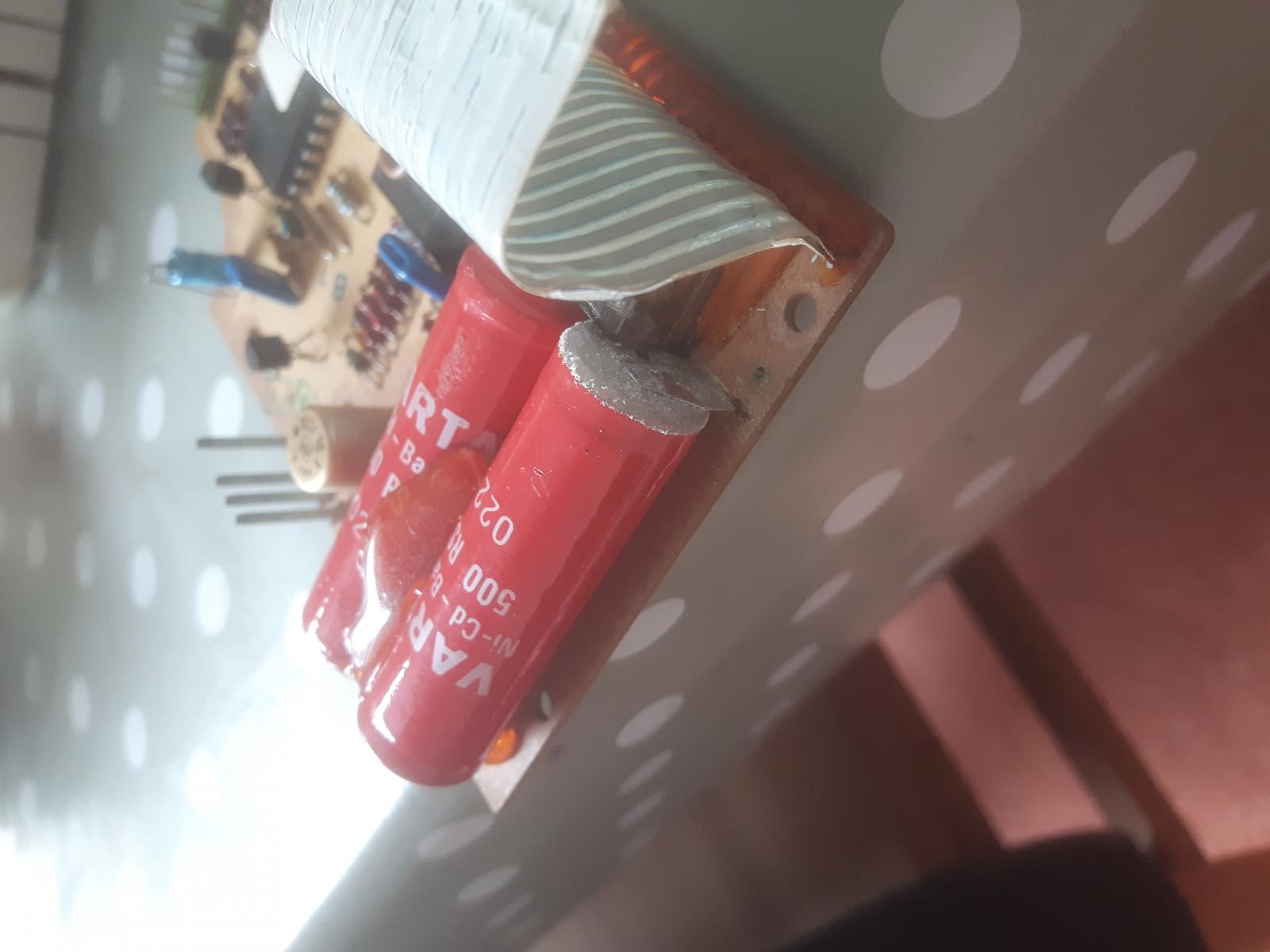

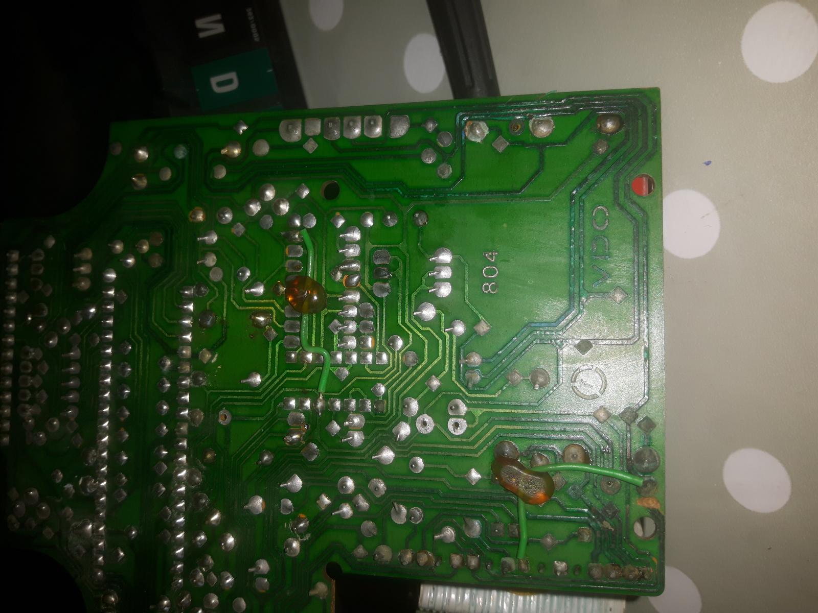

Finally managed to get the cluster apart this afternoon.
As predicted the battery have leaked. They are red varta's so I believe this denotes an early SI board.
There are about 4 dry joints but it looks like some of the tracks are also damaged.
Not sure if this is terminal or fixable?
That looks eminently repairable to me. It's a pretty simple single sided board. Just bypassing the damaged tracks with suitable wire is probably the best bet. Just make sure everything is suitably well secured against vibration etc.

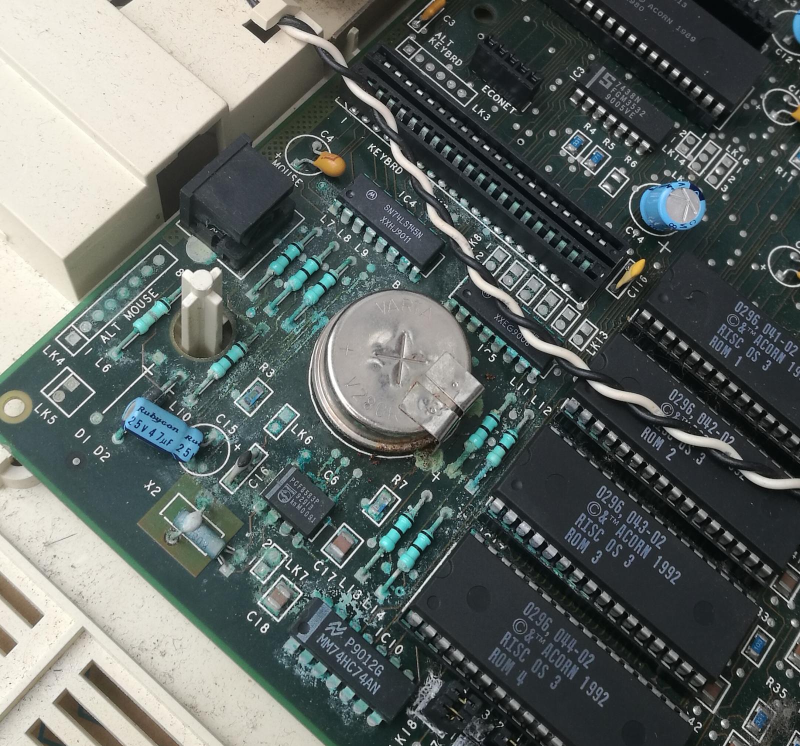

This is the board I'm currently repairing battery damage to...
That has dissolved a load of traces, including a bunch under the socketed ROM chips to the right. Fiddly is not the word!
