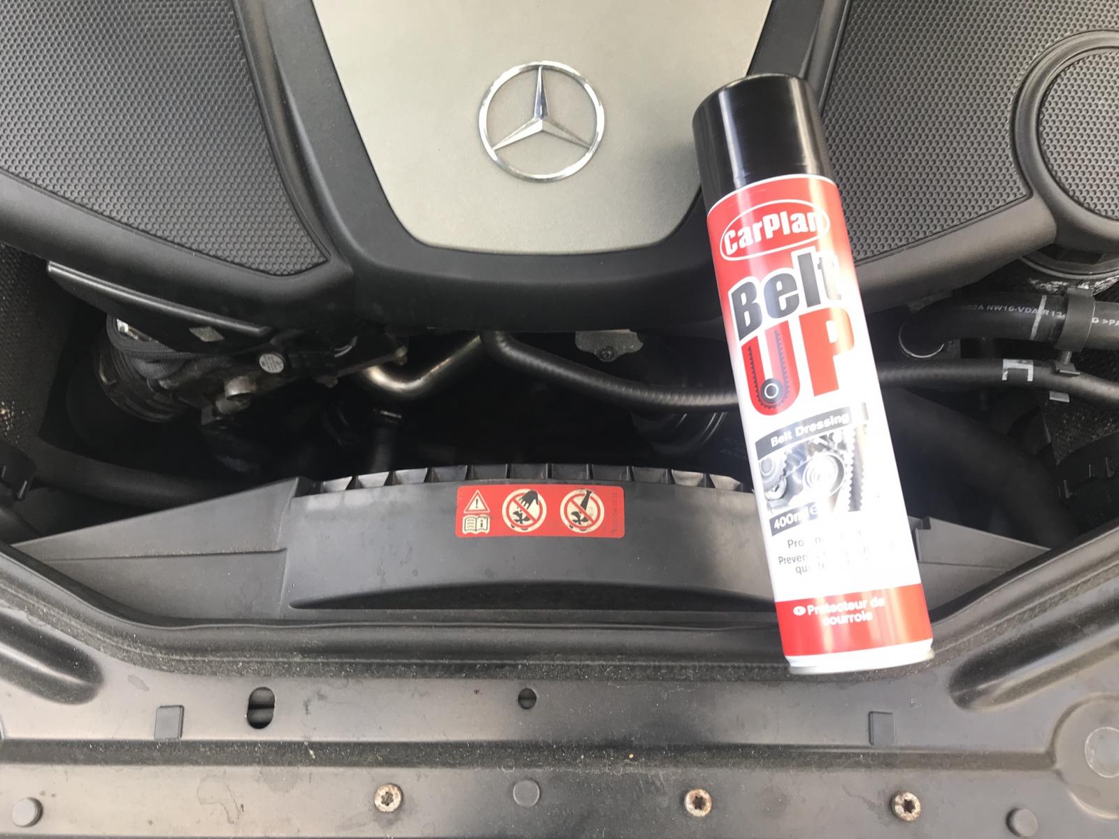

Peter C Posted February 1, 2018 Author Posted February 1, 2018 Sorted! I bought a can of this stuff: You can barely see the auxiliary belt let alone spray this stuff on it with the engine static. I masked off various parts of the engine bay and liberally sprayed the belt along the only exposed section. Now everything works fine and the belt stays quiet regardless how far the steering wheel is turned. Thank you to those who gave me good advice and up yours to those who didn’t.
