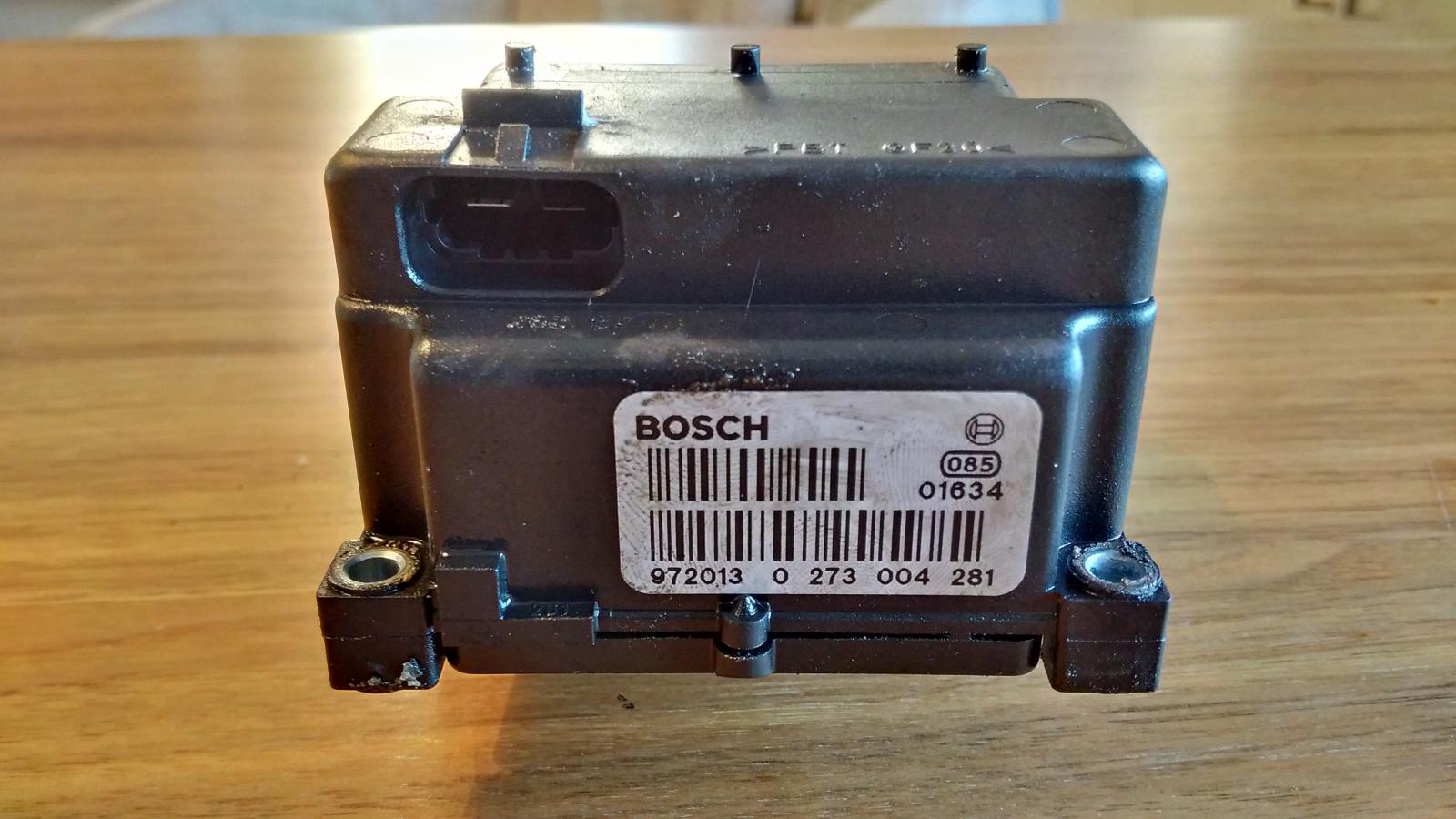

My ugly heap of German metal recently decided it didn't want to have ABS anymore. In an attempt to remedy this, I replaced all of the ABS sensors with new ones. No change, ABS light still on. And so, some internet research having been done, I realise that what I need to do is get the control unit repaired.
The unit is made by Bosch, with a model number of: 0 273 004 281
I was wondering whether any of you wonderful autoshite folks knew of a decent place to send the unit to get it repaired? I can't seem to find one in the UK...

Fair enough, just sent BBA and enquiry, as the model number for my part is not on their site.

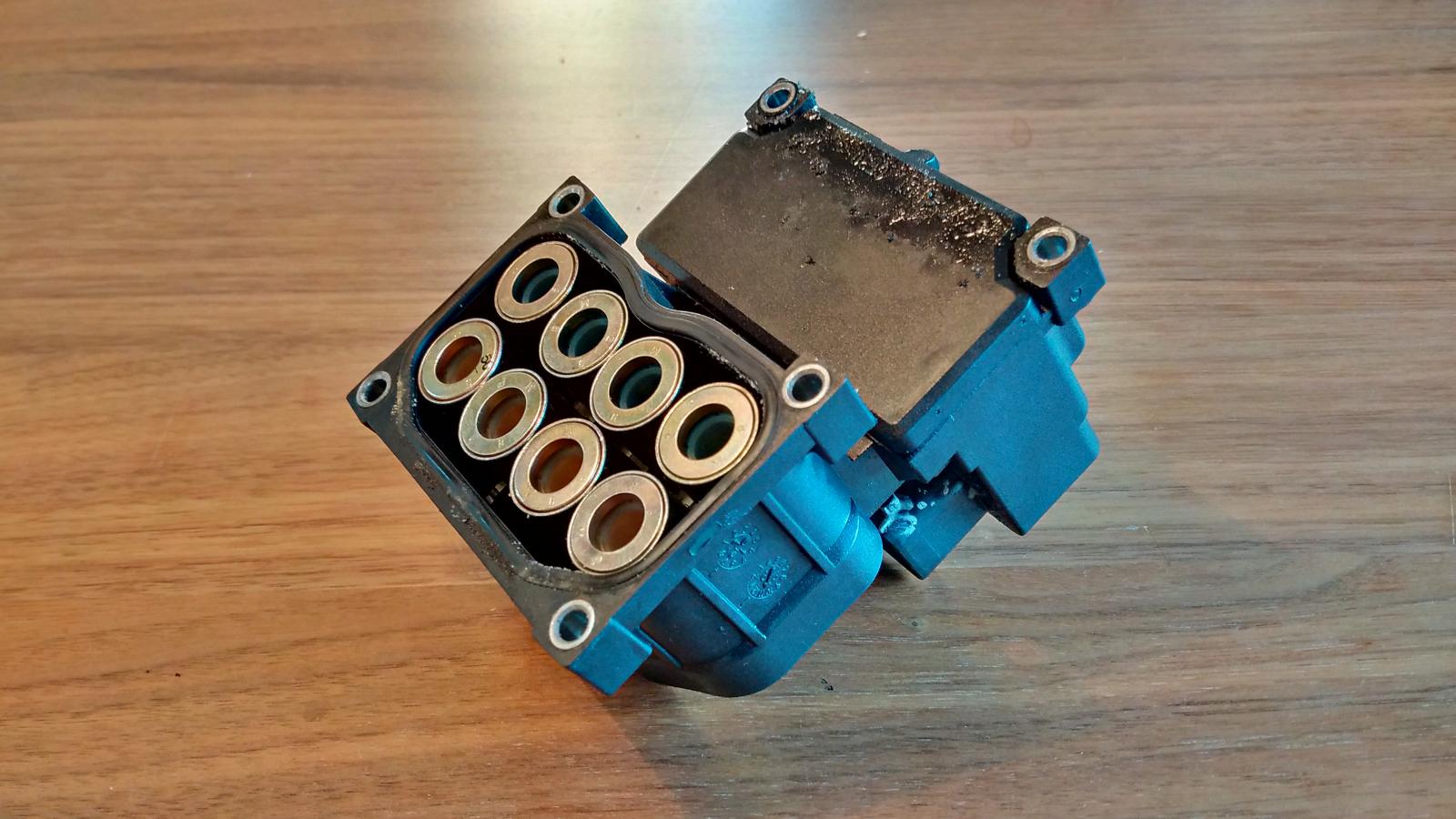

Looks remarkably similar to a Vaux Omega ABS ecu, I wonder how different they all are internally !
