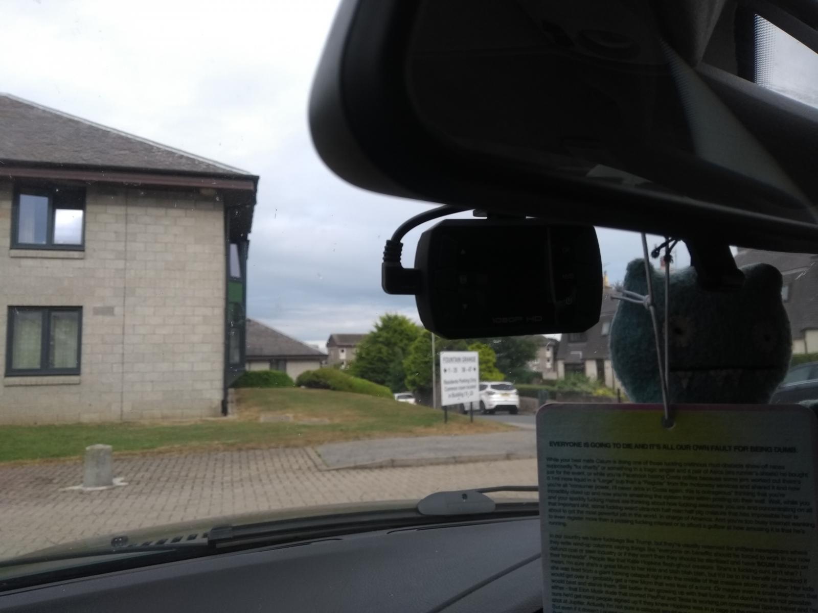

I've been thinking about getting a dashcam for a while, and it was Prime day on Amazon earlier in the week, thus:
They were also doing fire extinguishers for not a lot. I mounted it on the passenger seat, under the thigh rest thing.
Here it is with the thigh rest all the way back:
Then forward:
Now for a musical interlude.
You can dance.  You can dance.  Everybody look at your pants.
Dashcam seems alright. The G meter on it thought this bit included a crash, though, as it had saved it to the CRASH folder on its SD card.
