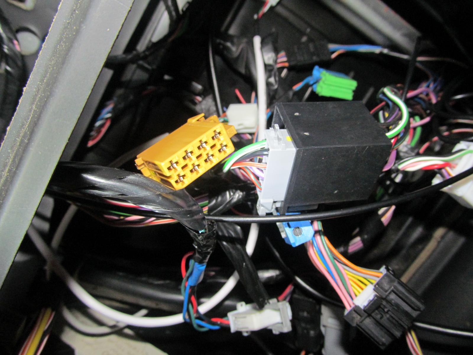

Sorry.  Behind the dash (actually behind the ashtray etc), there is an iso harness that runs from the dashboard to the back of the car (boot) where the BMW "head unit" actually is.  it's a plug/socket arrangement - if you find it, you can fish it out and unplug the rear unit - and just plug the iso connectors into a standard stereo.  You can get adapter plates on ebay, but the better ones are the actual MG Rover ones that were fitted to the lower line cars as they have a little shelf and are better made.
I don't have a better wider view picture - but this is what you are looking for-
Excellent Info ta very much - I might look into that!
