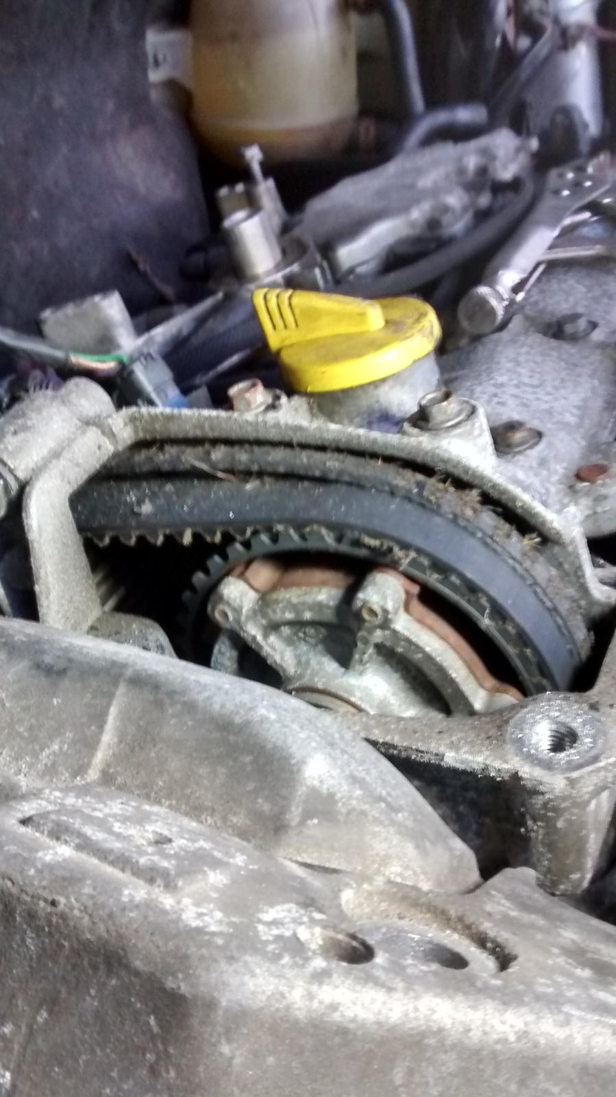

Sorry for the delay with this. I don't have much spare time and a dose of man flu stopped play recently. So the diagnosis of the borked engine is confirmed. Auxillary belt intact, these f4r's are renound for auxillary belt failure and this in turn gets caught up in the cambelt - i think you get the picture. But not this time. Anyway cambelt cover was removed and this is what i found.

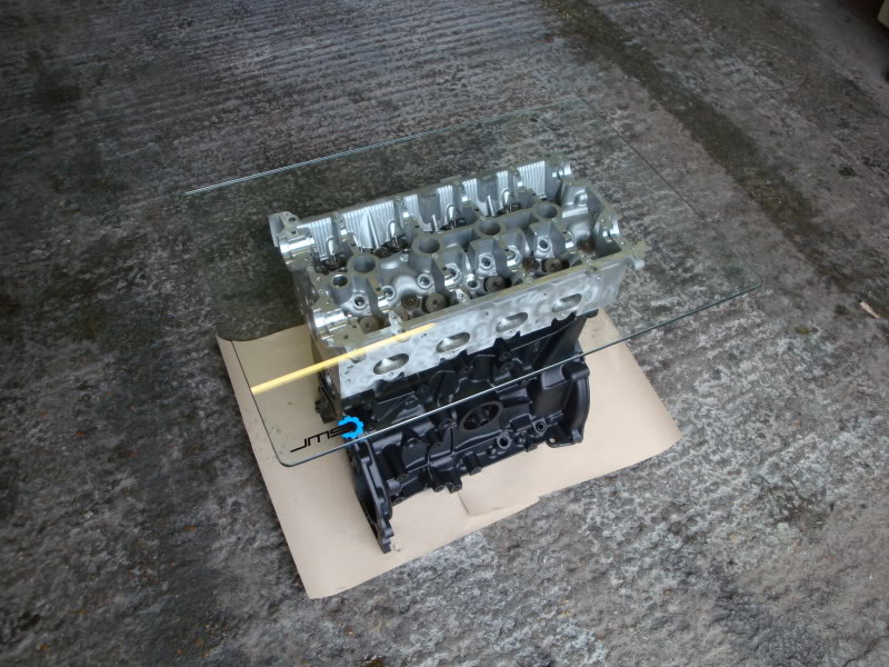

Any Renner lickers want to build an F4R coffetable?? Cos this is all its good for.
That dephaser looks well fucked, i think that's been on their a while!

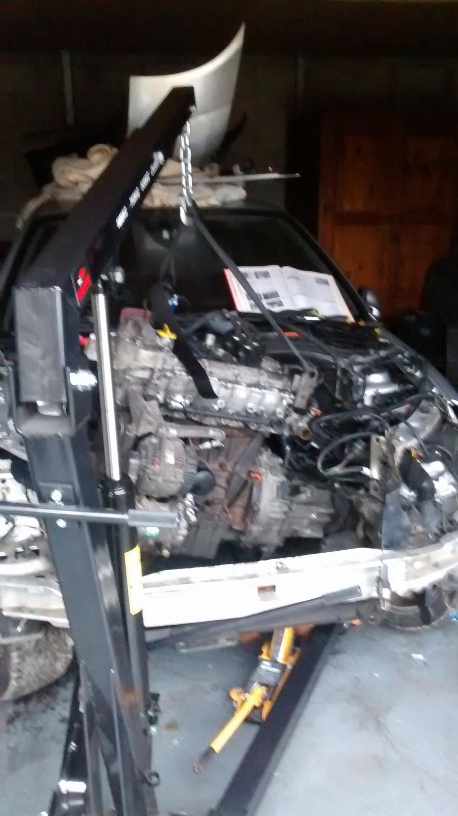

With those pesky wheel bolts out of the way, the driveshafts could be removed after dealing with quite a few stubborn suspension components, then much strippage of the engine bay started.
Then boom!! out she comes. Didn't manage to drop it on my toes which is always a bonus.

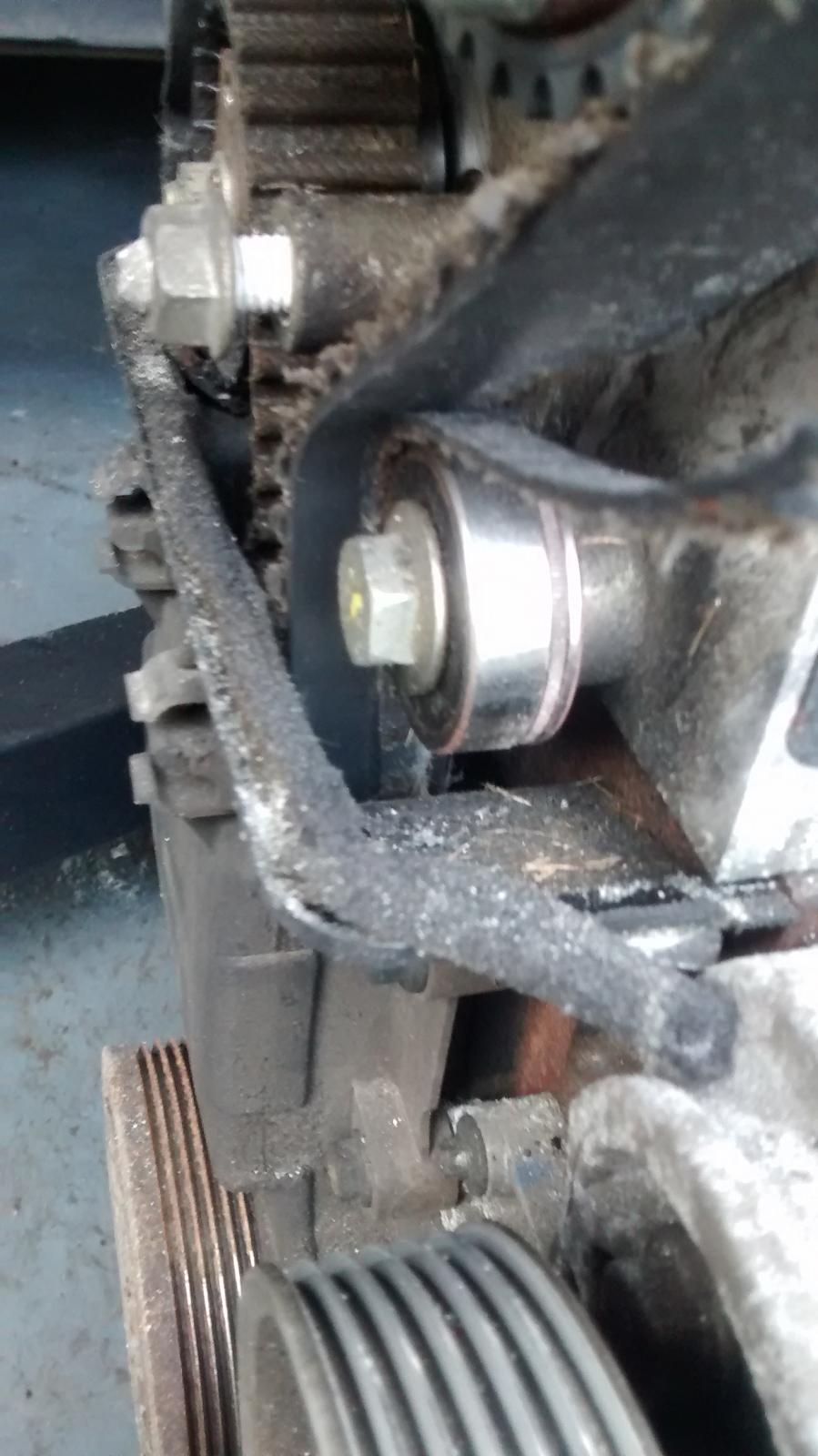

While the broken engine was out i wanted to have a sneaky peak at the cambelt and tensioners to see what the deal was with the cambelt failure. This don't look right.
Why is this pulley half the width of the others eh??

Anyway after swapping cambelt covers on the engines as the one on the old engine was in a bit better condition than the new one i discovered the remains of one of the plastic pulleys and thats why the cambelt got shredded. So its safe to say the cambelt was not at fault.
This is what it should look like, i.e the non bolloxed engine.

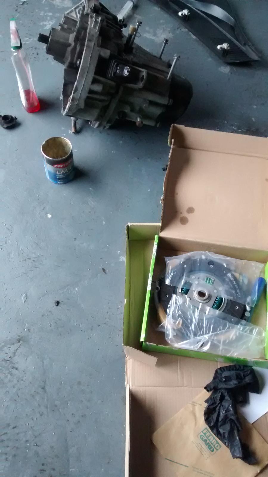

While the engine was out of the car it would have been silly not to change the clutch, especially as taking the gearbox off one of these while the engine in situ is an arse of a job apparently, and at £60 quid for a new Valeo clutch and release bearing it seemed like a no brainer. Also the old clutch wasn't down to the rivets but it was more than likely original and the release bearing looked like a bit borked.

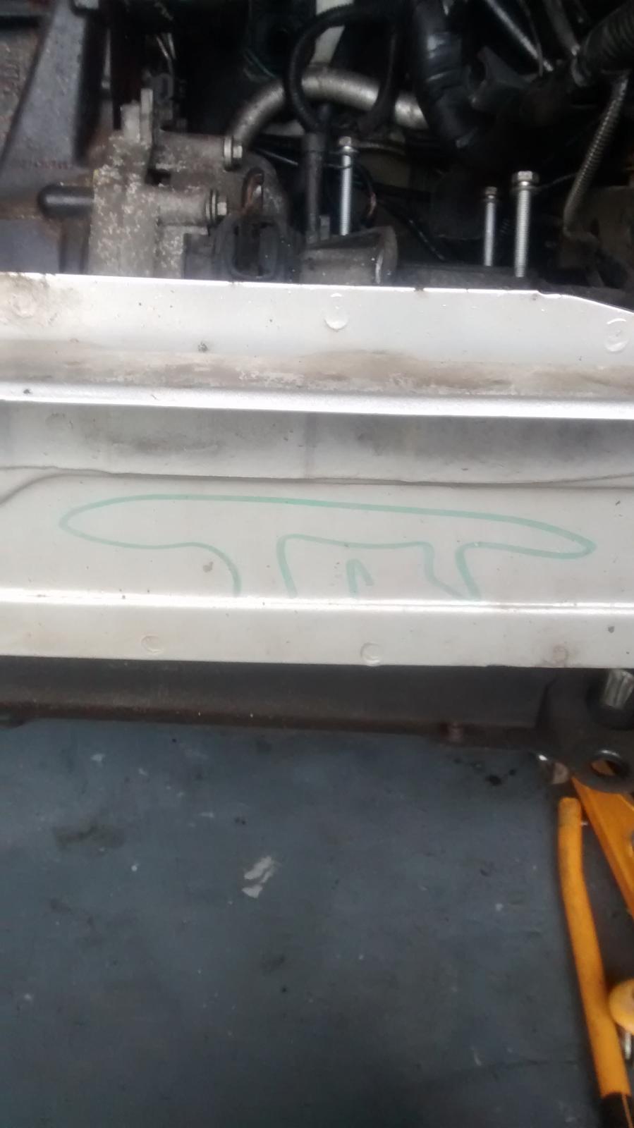

Anyway can anyone identify the drawing on the front bumper support? Did consider converting it to a giant jizzing cock after trying to change the front inner ARB bushes.
