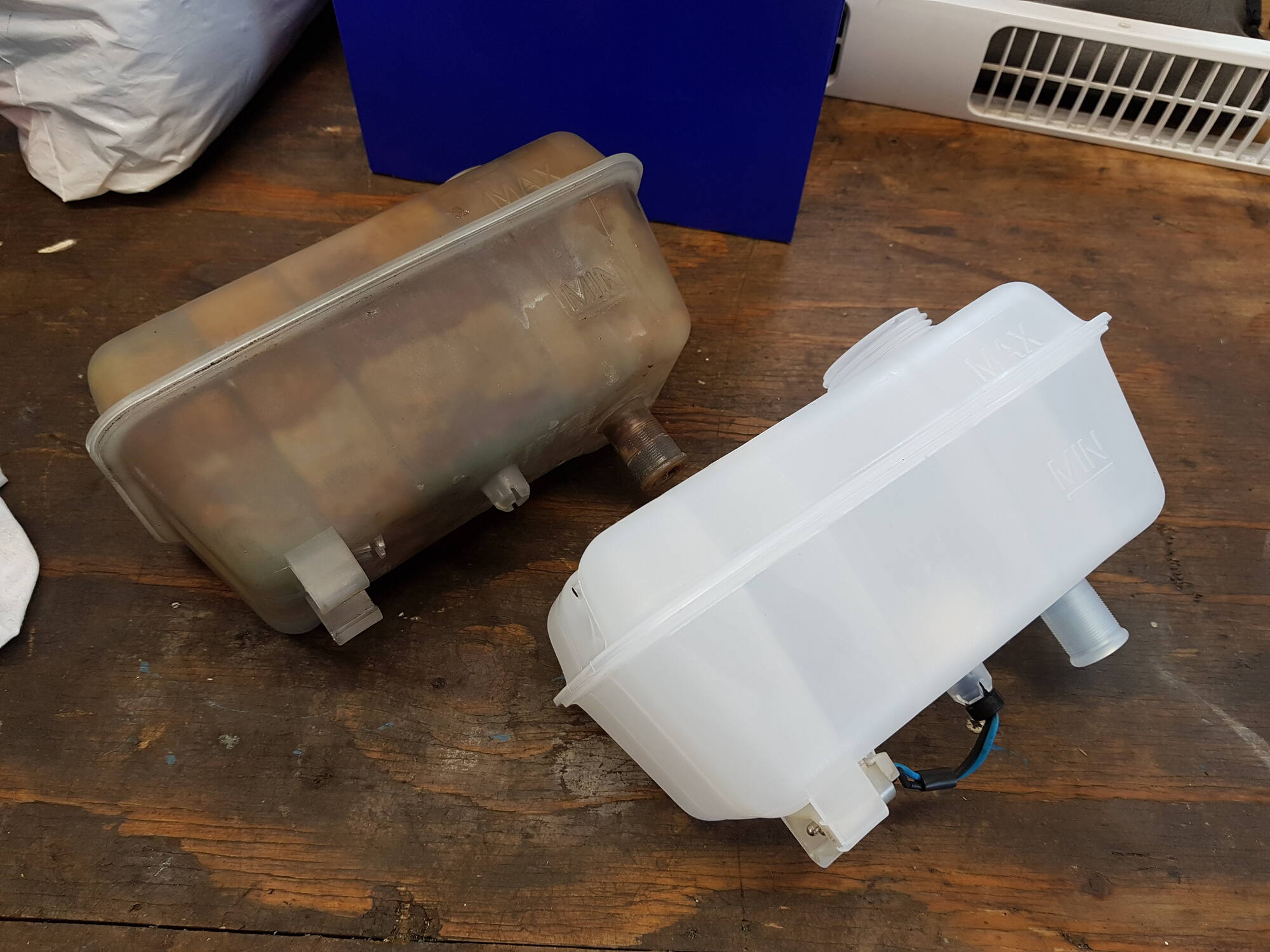

More jobs ticked off in the last couple of months; new drop links means less clunking and banging on the high quality highways of West Yorkshire. The expansion tank was on its way out - I noticed a tiny pinhole that would leak fine bubbles of coolant, and on closer inspection, the old tank was degraded and full of hairline fractures. A new one was thirty quid from the main dealer.

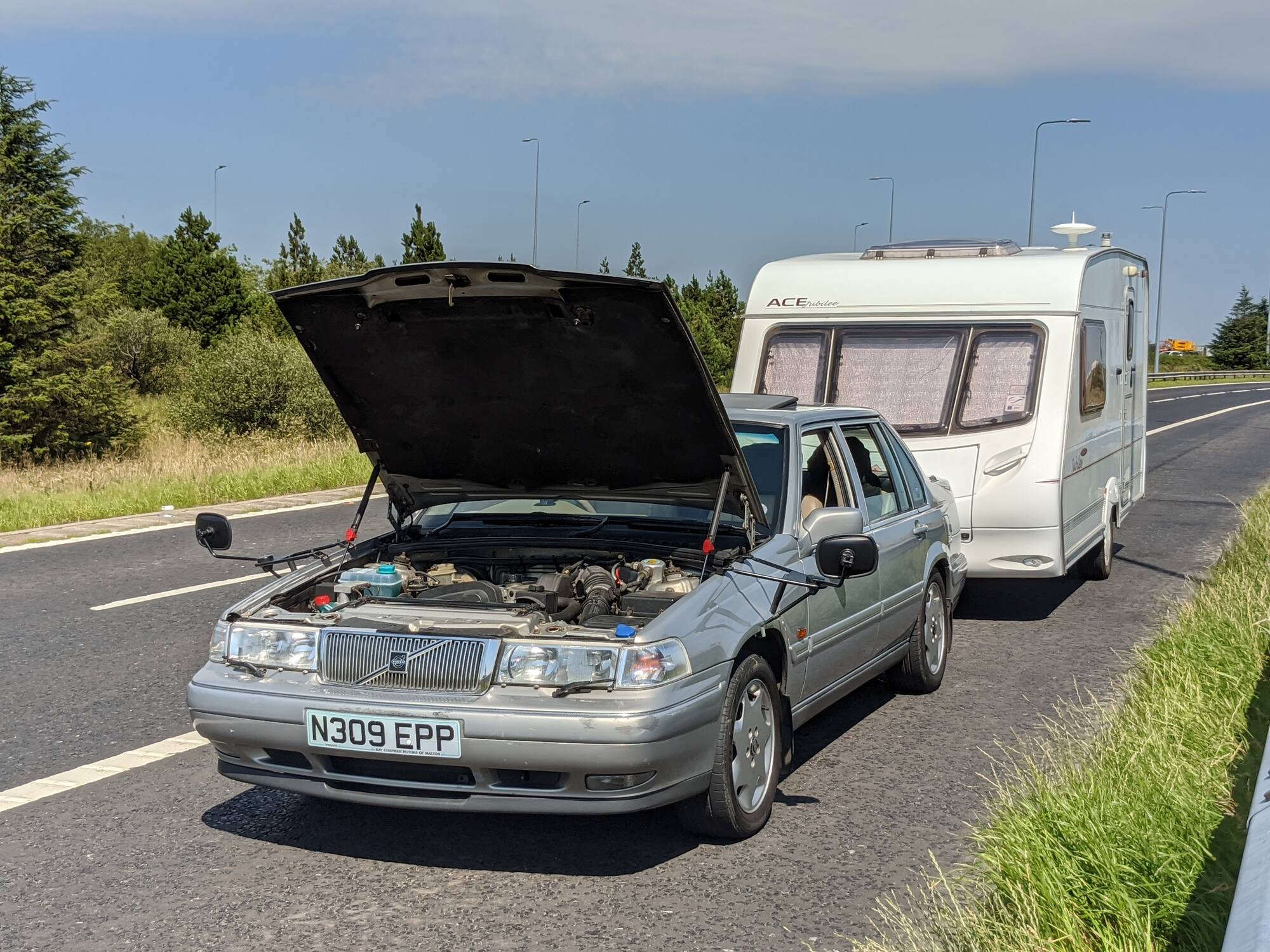

I had a baaad feeling about today even before I set off and I was proven correct when I rolled to a stop at Jct 22 on the M62 this afternoon. For local people, lets set the scene; The caravan lives in Elland. Elland is at the bottom of a very steep hill from the M62. Normally not a problem as the Elland bypass offers a reasonable climb up the side of the valley to Jct 24 Ainley Top. Not this week, however. It is being resurfaced. The 'other' way out of Elland is up an 11% incline, single carriageway, parked cars, all the usual bollocks. Anyway, I manage that. Next, up the slip road, emphasis on even more of the 'up' stuff. The M62, again, mostly more of the 'up' including the long slog up to the summit at Jct 22. Not far from Jct22, I have to move out a lane to pass a slow moving HGV. The first indication that something is wrong is that the gearbox doesn't kick down a gear when I move out to pass. The second, is the gearbox warning light is now flashing. Thirdly there's plumes of smoke coming from under the car. I get past the truck and bail out on to the hard shoulder, I figure I can keep it moving a bit further to the junction so I can park on the slip road rather than the motorway proper - it's going to be much safer. A quick look under shows there to be oil from the gearbox steadily dripping out. The smoke was it burning off on the exhaust.
I got to work on my tan for a couple of hours before I was recovered home. (trying again with the towing tomorrow with the Disco). Once home, the Volvo drove on to the driveway without a problem. It selects all gears and is seemingly undamaged. Current thinking is that I've cooked the gearbox oil (it's now black, so ruined anyway) and it's either come out of the breather, or from a pipe to/from the oil cooler. If following that line of enquiry, was it the hot weather and the act of towing that tipped it over the edge? or was there an underlying problem with the pipes to/from the radiator, or the radiator itself?

Had a look at the Volvo today, starting with checking the oil level in the box; just about on the dip stick and way under the MIN level. It didn't look or smell burnt, so things might be okay!
After rigging up Volvo Special Tool #2 for refilling the gearbox (pictured), a litre of the correct oil went in. After checking the level again, it was spot on and during a quick drive all seems well so perhaps it has survived unscathed?
