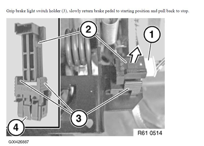

I can recommend sticking a magnet onto the part of the pedal that pushes the switch to adjust it just a little bit.
From what I can gather from Mini2.com and my downloaded USA dealer manual (lots of pdf's) it is a hall effect sensor, and because it goes off when the ignition is off it (probably isn't an inline diode or the body control unit full of water)
A switch is £18 with the gsf discount code that I have at work or £36 without.  Looking at the pictures I don't think it requires tools.
Who thinks a Pharmacy student will be able to sort it without going to a garage ?
I'm confused by this. Will this help the hall effect ? or are you assuming it's a proper old fashion switch ?

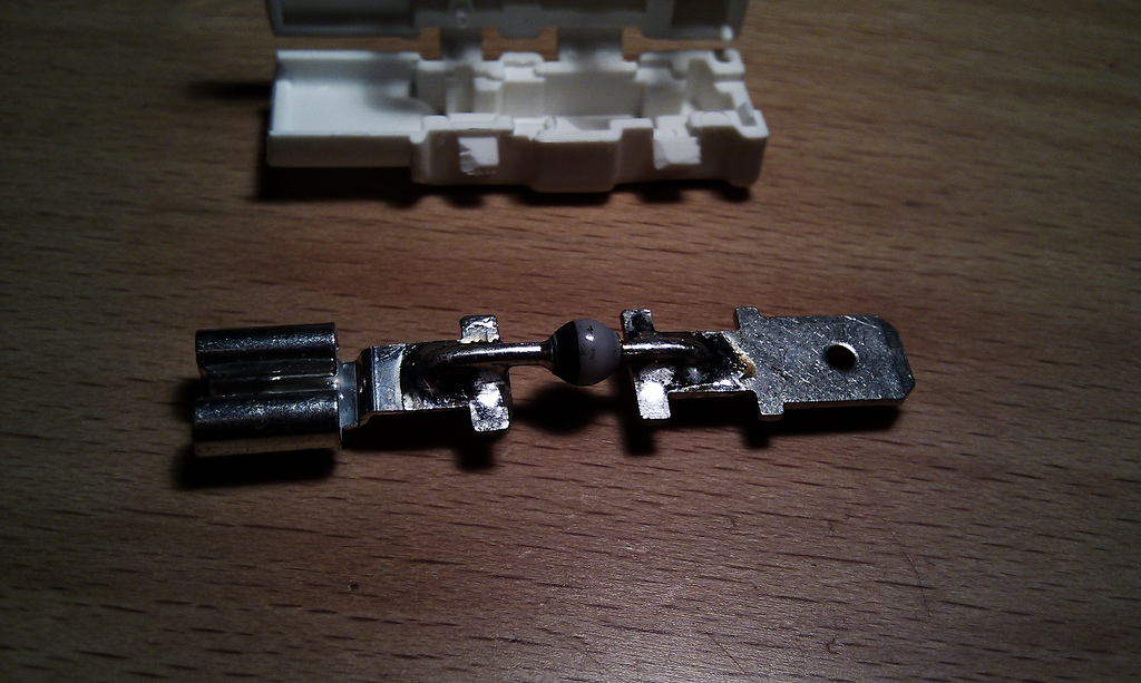

Diode 1n5626 ... pretty much bog std diode 3A rating .. brake switch also feeds into abs
I'm assuming proper switch & this is an easy adjust.

thats a rip for a 10p diode ,  I look at this photo and its no wonder they fail !!!
glass package diode soldered to 2 floating connectors , "supported" by a loose fitting cover !!!!
